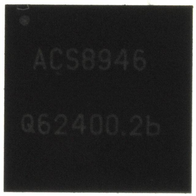

ACS8946 JAM PLL Jitter Attenuating, Multiplying Phase Locked Loop, with Protection Switch, for OC-12/STM-4 and GbE ADVANCED COMMUNICATIONS Introduction FINAL Features The ACS8946 JAM PLL is a Jitter-Attenuating, Multiplying differential Phase-Locked Loop, for generating low jitter output clocks compliant up to SONET OC-12 and STM-4 622.08 MHz specifications. Its primary function is to clean up clock jitter for high performance optical line cards with OC-12 framers and serializers. It also provides reference switching functionality for line card protection, and frequency translation. Typical output jitter generation is within OC-12/STM-4 specifications, at 2.8 ps rms, making it an ideal dejittering solution for use with Semtech clock and line card parts: ACS8510, ACS8520, ACS8522 and ACS8530. The ACS8946 can also be used as a basic line card protection device in some applications. The ACS8946 JAM PLL has two differential, frequency programmable, LVPECL reference inputs and one differential sync input. It has four outputs, programmable as LVPECL or CML, and frequency programmable to any common SONET/SDH rate i.e. 19.44 MHz, 38.88 MHz, 77.76 MHz, 155.52 MHz, 311.04 MHz and 622.08 MHz. Jitter cleaning of Gigabit Ethernet (GbE) 125 MHz and 156.25 MHz is also possible, with output frequency multiplication up to 625.00 MHz available. The device's operating bandwidth (and consequently the jitter attenuation point relating to this bandwidth) is fully configurable, and is set by external passive components. Note...For items marked [1],[2], etc. references are given in full in the Reference Section on page 38. DATASHEET ‹ Meets rms jitter requirements of: ‹ Telcordia GR-253[8] for OC-3 and OC-12 ‹ ITU-T G.813[4]/G.812[3] for STM-1 and STM-4 rates ‹ ETSI EN300-462-7[1]/EN302-084[2] up to STM-16 rates ‹ PLL bandwidth and jitter peaking fully adjustable— supports PLL loop bandwidths from 2 kHz for superior input jitter filtering ‹ Typical jitter generation down to: ‹ 0.3 ps rms for 250 kHz to 5 MHz band for G.813, or EN300 462, at STM-4 (OC-12) rates ‹ 2.8 ps rms for 12 kHz to 20 MHz band (against 4.02 ps rms for GR-253-CORE at OC-48 rate) ‹ ITU, ETSI and Telcordia frequency band results shows exceptional performance in a “Real World” environment (low PLL bandwidth of 2 KHz and a typical input from an ACS8525 partner IC): ‹ 0.4 ps rms for 250 kHz to 5 MHz band for G.813, or EN300 462, at STM-4 (OC-12) rates ‹ 2.8 ps rms for 12 kHz to 20 MHz band ‹ Tracking range ±400 ppm about a wide range of input frequencies ‹ Manual or automatic control of reference selection ‹ External feedback option ‹ LOS alarms for each input, and for selected reference ‹ 3.3 V operation, - 40 to +85°C temperature range ‹ Small outline leadless 7 mm x 7 mm QFN48 package ‹ Lead (Pb)-free version available (ACS8946T), RoHS[11] and WEEE[12] compliant Block Diagram Figure 1 Simplified Block Diagram of the ACS8946 JAM PLL Loop Filter RESETB VC 1 x CMOS Single-ended Sync Output 1 x LVPECL Differential Sync Input Re-timing SYNC 2 x LVPECL Differential CLK1 Input References Programmable: CLK2 19.44 MHz to 156.25 MHz Input Selector Device Configuration Select: CFG_IN[7:0] CFG_OUT2 Divider PFD Charge Pump Control and Monitor Note: LOS alarm outputs are also used for device config. select Clock Input Configuration for: - Manual selection - Auto Ref selection - External feedback mode (SEL_CLK2, AUTO_SEL) Revision 3/November 2006 © Semtech Corp. Lock Alarm (LOCKB) LOS Alarms for: - CLK1 (ALARM1_CO0) - CLK2 (ALARM2_CO1) - Currently selected reference (ALARMC_CO3) Page 1 2.5 GHz VCO SYNC_OUT 4 x LVPECL or CML Output Clocks, Independently Programmable Frequency Dividers OUT[4:1] from: 625.00 MHz 622.08 MHz Clock 311.04 MHz Drivers 155.52 MHz 77.76 MHz 38.88 MHz 19.44 MHz 125 MHz 156.25 MHz Frequency Select Others Ethernet rates (RATE[2:1]A, RATE[2:1]B) available using divider F8946D_004Blockdiag_06 www.semtech.com Table of Contents ADVANCED COMMUNICATIONS Table of Contents FINAL Section ACS8946 JAM PLL DATASHEET Page Introduction................................................................................................................................................................................................ 1 Block Diagram............................................................................................................................................................................................ 1 Features ..................................................................................................................................................................................................... 1 Table of Contents ...................................................................................................................................................................................... 2 Pin Diagram ............................................................................................................................................................................................... 3 Pin Description........................................................................................................................................................................................... 3 Description ................................................................................................................................................................................................. 8 Inputs ..................................................................................................................................................................................................8 Outputs ...............................................................................................................................................................................................8 Clock Multiplication ...........................................................................................................................................................................9 Voltage Controlled Oscillator.............................................................................................................................................................9 Jitter Filtering......................................................................................................................................................................................9 Jitter Filtering: Partnering with Semtech Line Card Protection Parts .......................................................................................... 10 Input Jitter Tolerance...................................................................................................................................................................... 10 Jitter Transfer .................................................................................................................................................................................. 10 Phase Noise Performance.............................................................................................................................................................. 11 Lock Detector .................................................................................................................................................................................. 11 PLL Bandwidth Setting ................................................................................................................................................................... 12 RC Components Required to Achieve Bandwidth at Given Input Frequencies (Tables 6 to 9). ...................................... 12 Source Switching - State Diagram ................................................................................................................................................. 13 Configuration................................................................................................................................................................................... 13 Output Configuration............................................................................................................................................................. 13 Example Configuration.......................................................................................................................................................... 14 Output Jitter..................................................................................................................................................................................... 21 System Reset .................................................................................................................................................................................. 21 Layout Recommendations ............................................................................................................................................................. 21 Applications ..................................................................................................................................................................................... 22 Example Schematic ........................................................................................................................................................................ 23 Electrical Specifications ......................................................................................................................................................................... 24 Maximum Ratings ........................................................................................................................................................................... 24 Operating Conditions ...................................................................................................................................................................... 25 Thermal Characteristics ................................................................................................................................................................. 25 AC Characteristics........................................................................................................................................................................... 25 DC Characteristics .......................................................................................................................................................................... 26 Input and Output Interface Terminations...................................................................................................................................... 27 Jitter Performance .......................................................................................................................................................................... 30 Input/Output Timing ....................................................................................................................................................................... 35 Package Information .............................................................................................................................................................................. 36 Thermal Conditions......................................................................................................................................................................... 37 References and Related Standards ...................................................................................................................................................... 38 Abbreviations .......................................................................................................................................................................................... 38 Revision Status/History ......................................................................................................................................................................... 39 Trademark Acknowledgements ............................................................................................................................................................. 39 Notes ....................................................................................................................................................................................................... 39 Ordering Information .............................................................................................................................................................................. 40 Disclaimers...................................................................................................................................................................................... 40 Contacts........................................................................................................................................................................................... 40 Revision 3/November 2006 © Semtech Corp. Page 2 www.semtech.com ACS8946 JAM PLL ADVANCED COMMUNICATIONS Pin Diagram FINAL DATASHEET VSSOSC VDDOSC IC1 39 38 37 SYNCN 42 SYNCP VDDP2 43 RESETB SYNC_OUT 44 40 RATE2A 45 41 RATE1A RATE2B 46 RATE1B 47 48 Figure 2 ACS8946 Pin Diagram 1 VDDO1 36 2 OUT1N 35 VCP 3 OUT1P 34 VDDARF 4 VDDO2 33 AUTO_SEL 5 OUT2N 32 SEL_CLK2 6 OUT2P 31 CLK2P 7 VDDO3 30 CLK2N 8 OUT3N 29 VDDP1 9 OUT3P 28 CLK1P ACS8946 VCN CFG_IN6 24 23 CFG_IN5 22 CFG_IN4 CFG_IN3 21 Dimensions: 7 mm x 7 mm Lead Pitch: 0.5 mm (Leads centered on package) 17 Connect large central pad (Pin 49 VSSO) to GND 20 CFG_IN2 CFG_IN7 19 CFG_IN1 25 18 CFG_IN0 12 OUT4P LOCKB VDDADIV 16 ALARMC_CO3 26 15 CFG_OUT2 CLK1N 11 OUT4N 14 ALARM2_CO1 27 13 ALARM1_CO0 10 VDDO4 F8944_D_002PINDIAG_01 Pin Description Table 1 Power Pins Pin No. Symbol I/O Type Description 1, 4, 7, 10 VDDO1, VDDO2, VDDO3, VDDO4 P - Supply Voltage: Independent supplies to power each clock output (differential pair of pins) OUT1N/P to OUT4N/P respectively. +3.3 Volts ±5%. To disable an output and save power, tie associated VDD to 0V. 26 VDDADIV P - Supply Voltage: Supply for internal Dividers in VCO loop, kept as an isolated supply to allow for low supply noise for the output divider stages. +3.3 Volts ±5%. 29 VDDP1 P - Supply Voltage: Supply to differential inputs, alarm and config. pins. +3.3 Volts ±5%. 43 VDDP2 P - Supply Voltage: Supply to Sync input and Sync output pins, rate selection pins, input selection pins and reset pin. +3.3 Volts ±5%. 34 VDDARF P - Supply Voltage: Supply for phase and frequency detector (PFD), kept as an isolated supply to allow for low supply noise. +3.3 Volts ±5%. 38 VDDOSC P - Supply Voltage: Supply input to the internal VCO. +3.3 Volts +5/-10%. 39 VSSOSC P - Supply Ground: 0 V for the internal VCO. 49 VSS0 P - Supply Ground: Common 0 V. This is the central leadframe pad on the underneath of the package. Note...A= Analog, I = Input, O = Output, P = Power, LVTTL/LVCMOSU = LVTTL/LVCMOS input with pull-up resistor, LVTTL/LVCMOSD = LVTTL/LVCMOS input with pull-down resistor. Revision 3/November 2006 © Semtech Corp. Page 3 www.semtech.com ACS8946 JAM PLL ADVANCED COMMUNICATIONS FINAL DATASHEET Table 2 Internally Connected (IC) Pin Pin No. 37 Symbol IC1 I/O Type Description - - I/O Type Description Internally Connected: Connect to ground. Table 3 Functional Pins Pin No. Symbol 2 OUT1N O CML or LVPECL One of four CML or LVPECL differential outputs, partnered with pin 3; programmable at spot frequencies from 19.44 MHz up to 625.00 MHz. For outputs OUT1 and OUT2 only, output frequency can be instantly configured using Rate Selection pins (pins 47 and 48 for OUT1), from a set of four pre-configured “Available Rates”. See“Configuration” on page 13. Output is on when VDD01 is supplied with 3.3 V, or off when VDD01 is tied to zero volts. If VDD01 is connected to 0 V remove external biasing resistors. 3 OUT1P O CML or LVPECL CML or LVPECL differential output partnered with pin 2. See pin 2 description for more detail. 5 OUT2N O CML or LVPECL One of four CML or LVPECL differential outputs, partnered with pin 6; programmable at spot frequencies from 19.44 MHz up to 625.00 MHz. For outputs OUT1 and OUT2 only, output frequency can be instantly configured using Rate Selection pins (pins 45 and 46 for OUT2), from a set of four pre-configured “Available Rates”. See“Configuration” on page 13. Output is on when VDD02 is supplied with 3.3 V, or off when VDD02 is tied to zero volts. If VDD02 is connected to 0 V remove external biasing resistors. 6 OUT2P O CML or LVPECL CML or LVPECL differential output partnered with pin 5. See pin 5 description for more detail. 8 OUT3N O CML or LVPECL One of four CML or LVPECL differential outputs, partnered with pin 9; programmable at spot frequencies from 19.44 MHz up to 625.00 MHz. For outputs OUT3 and OUT4 only, the output frequency selection is controlled at power-up or on reset from a set of four pre-configured “Available Rates”. See“Configuration” on page 13. Output is on when VDD03 is supplied with 3.3 V, or off when VDD03 is tied to zero volts. If VDD03 is connected to 0 V remove external biasing resistors. 9 OUT3P O CML or LVPECL CML or LVPECL differential output partnered with pin 8. See pin 8 description for more detail. 11 OUT4N O CML or LVPECL One of four CML or LVPECL differential outputs, partnered with pin 12; programmable at spot frequencies from 19.44 MHz up to 625.00 MHz. For outputs OUT3 and OUT4 only, the output frequency selection is controlled at power-up or on reset from a set of four pre-configured “Available Rates”. See“Configuration” on page 13. Output is on when VDD04 is supplied with 3.3 V, or off when VDD04 is tied to zero volts. If VDD04 is connected to 0 V remove external biasing resistors. 12 OUT4P O CML or LVPECL CML or LVPECL differential output partnered with pin 11. See pin 11 description for more detail. 13 ALARM1_CO0 O LVTTL/ LVCMOS Activity alarm output for the CLK1P/CLK1N input reference clock. Active high; high indicating clock failure. It is also used to configure the device at power-up, where it is used as a configuration output pin, that may be connected to CFG_IN[0:7] input pins as required. See “Configuration” on page 13. 14 ALARM2_CO1 O LVTTL/ LVCMOS Activity alarm output for the CLK2P/CLK2N input reference clock. Active high; high indicating clock failure. It is also used to configure the device at power-up time, where it is used as a configuration output pin, that may be connected to CFG_IN[0:7] input pins as required. See “Configuration” on page 13. Revision 3/November 2006 © Semtech Corp. Page 4 www.semtech.com ACS8946 JAM PLL ADVANCED COMMUNICATIONS FINAL DATASHEET Table 3 Functional Pins (cont...) Pin No. Symbol I/O Type Description 15 CFG_OUT2 O LVTTL/ LVCMOS Configuration pin, used in the configuration on power-up of expected input clock frequency and Resync selection, by connecting to appropriate pin from the CFG_IN[0:7] pins as required. See “Configuration” on page 13. 16 ALARMC_CO3 O LVTTL/ LVCMOS Activity alarm output for the currently selected input reference clock. Active high; high indicating clock failure. It is also used to configure the device at power-up, where it is used as a configuration output pin that may be connected to CFG_IN[0:7] input pins as required. See “Configuration” on page 13. 17 LOCKB O Analog Lock detect output. This is a pulse-width modulated output current, with each pulse typically +10 µA. The output produces a pulse with a width in proportion to the phase error seen at the internal phase detector. This pin should be connected via an external parallel capacitor and resistor to ground. The pin voltage will then give an indication of phase lock: When low, the device is phase locked; when high the device has frequent large phase errors and so is not phase locked. The value of the RC components used determines the time and level of consistency required for lock indication. If LOCKB is disabled by configuration the LOCKB output is held low. 18 CFG_IN0 I LVTTL/ LVCMOSD Configuration pin for setting up the device just after power-up or after a system reset (via pin 40, RESETB). This configuration pin is analyzed during the configuration phase, just after power-up, so that the device works out whether this pin is connected to ground, power, or one of the configuration outputs at pins 13 to 16. This pin is used with pin 19 to set the available output rates as shown in Table 11. 19 CFG_IN1 I LVTTL/ LVCMOSD Configuration pin for setting up the device just after power-up or after a system reset (via pin 40, RESETB). This configuration pin is analyzed during the configuration phase, just after power-up, so that the device works out whether this pin is connected to ground, power, or one of the configuration outputs at pins 13 to 16. This pin is used with pin 18 to set the available output rates as shown in Table 11. 20 CFG_IN2 I LVTTL/ LVCMOSD Schmitt Trigger Configuration pin for setting up the device just after power-up or after a system reset (via pin 40, RESETB). This configuration pin is analyzed during the configuration phase, just after power-up, so that the device works out whether this pin is connected to ground, power, or one of the configuration outputs at pins 13 to 16. This pin is used with pin 21 to set the input divider and output pad mode (CML or LVPECL) configuration for OUT1 and OUT2 as in Table 10. 21 CFG_IN3 I LVTTL/ LVCMOSD Configuration pin for setting up the device just after power-up or after a system reset (via pin 40, RESETB). This configuration pin is analyzed during the configuration phase, just after power-up, so that the device works out whether this pin is connected to ground, power, or one of the configuration outputs at pins 13 to 16. This pin is used with pin 20 to set the input divider and output pad mode (CML or LVPECL) configuration for OUT1 and OUT2 as in Table 10. 22 CFG_IN4 I LVTTL/ LVCMOSD Configuration pin for setting up the device just after power-up or after a system reset (via pin 40, RESETB). This configuration pin is analyzed during the configuration phase, just after power-up, so that the device works out whether this pin is connected to ground, power or one of the configuration outputs at pins 13 to 16. This pin is used with pin 23 to set the clock edge used for SYNC sampling, and the output clock frequency of OUT3 (pins 8 and 9) and OUT4 (pins 11 and 12), as shown in Table 12. 23 CFG_IN5 I LVTTL/ LVCMOSD Configuration pin for setting up the device just after power-up or after a system reset (via pin 40, RESETB). This configuration pin is analyzed during the configuration phase, just after power-up, so that the device works out whether this pin is connected to ground, power or one of the configuration outputs at pins 13 to 16. This pin is used with pin 22 to set the clock edge used for SYNC sampling, and the output clock frequency of OUT3 (pins 8 and 9) and OUT4 (pins 11 and 12), as shown in Table 12. Revision 3/November 2006 © Semtech Corp. Page 5 www.semtech.com ACS8946 JAM PLL ADVANCED COMMUNICATIONS FINAL DATASHEET Table 3 Functional Pins (cont...) Pin No. Symbol I/O Type Description 24 CFG_IN6 I LVTTL/ LVCMOSD Configuration pin for setting up the device just after power-up or after a system reset (via pin 40, RESETB). This configuration pin is analyzed during the configuration phase, just after power-up, so that the device works out whether this pin is connected to ground, power or one of the configuration outputs at pins 13 to 16. This pin is used with pin 25 to to set the value of the odd divider, which applies a division of 1/3/5/7/9/11/13 or 15 to the otherwise selected spot frequency, on each of the four outputs OUTN/P[4:1]. It is also used to enable or disable the lock detector (pin 17 LOCKB), and to set the output pad mode (CML or PECL) for OUT3 and OUT4 as shown in Table 13. 25 CFG_IN7 I LVTTL/ LVCMOSD Configuration pin for setting up the device just after power-up or after a system reset (via pin 40, RESETB). This configuration pin is analyzed during the configuration phase, just after power-up, so that the device works out whether this pin is connected to ground, power or one of the configuration outputs at pins 13 to 16. This pin is used with pin 24 to to set the value of the odd divider, which applies a division of 1/3/5/7/9/11/13 or 15 to the otherwise selected spot frequency on each of the four outputs OUTN/P[4:1]. It is also used to enable or disable the lock detector (pin 17 LOCKB) and to set the output pad mode (CML or PECL) for OUT3 and OUT4 as shown in Table 13. 27 CLK1N I LVPECL Input reference clock that the PLL will phase and frequency lock to. Can accept 19.44 MHz, 38.88 MHz, 77.76 MHz, 125.00 MHz, 155.52 MHz or 156.25 MHz, and frequencies near to these so long as the chosen frequency remains stable to within the tracking range of ±400 ppm. (See “Inputs” on page 8 and Table 10). Can accept LVPECL or LVDS or CML inputs given suitable external interface components. Partnered with pin 28. This clock or CLK2 can be automatically or manually selected as the reference clock, see Table 4. 28 CLK1P I LVPECL Input reference clock that the PLL will phase and frequency lock to. Can accept 19.44 MHz, 38.88 MHz, 77.76 MHz, 125.00 MHz, 155.52 MHz or 156.25 MHz and frequencies near to these so long as the chosen frequency remains stable to within the tracking range of ±400 ppm. (See “Inputs” on page 8 and Table 10). Can accept LVPECL or LVDS or CML inputs given suitable external interface components. Partnered with pin 27. This clock or CLK2 can be automatically or manually selected as the reference clock, see Table 4. 30 CLK2N I LVPECL Second Input reference clock that the PLL will phase and frequency lock to. Input reference clock that the PLL will phase and frequency lock to. Can accept 19.44 MHz, 38.88 MHz, 77.76 MHz, 125.00 MHz, 155.52 MHz or 156.25 MHz, and frequencies near to these so long as the chosen frequency remains stable to within the tracking range of ±400 ppm. (See “Inputs” on page 8 and Table 10). Can accept LVPECL or LVDS or CML inputs given suitable external interface components. Partnered with pin 31. This clock or CLK1 can be automatically or manually selected as the reference clock, see Table 4. 31 CLK2P I LVPECL Second Input reference clock that the PLL will phase and frequency lock to. Input reference clock that the PLL will phase and frequency lock to. Can accept 19.44 MHz, 38.88 MHz, 77.76 MHz, 125.00 MHz, 155.52 MHz or 156.25 MHz, and frequencies near to these so long as the chosen frequency remains stable to within the tracking range of ±400 ppm. (See “Inputs” on page 8 and Table 10). Can accept LVPECL or LVDS or CML inputs given suitable external interface components. Partnered with pin 30. This clock or CLK2 can be automatically or manually selected as the reference clock, see Table 4. 32 SEL_CLK2 I LVTTL/ LVCMOSD Revision 3/November 2006 © Semtech Corp. Used in combination with pin 33, AUTO_SEL, either to select the CLK2 clock (high) or CLK1 clock (low) in manual control mode, or to select automatic switching mode, as described in Table 4. Page 6 www.semtech.com ACS8946 JAM PLL ADVANCED COMMUNICATIONS FINAL DATASHEET Table 3 Functional Pins (cont...) Pin No. Symbol I/O Type Description Used in combination with pin 32, SEL_CLK2, to select automatic switching mode, as described in Table 4. 33 AUTO_SEL I LVTTL/ LVCMOSD 35 VCP A Analog Connection for external loop filter components. This is the differential control voltage input to the internal VCO and the internal differential charge pump output up to a level of 210 µA. 36 VCN A Analog Connection for external loop filter components. This is the differential control voltage input to the internal VCO and the internal differential charge pump output up to a level of 210 µA. 40 RESETB I LVTTL/ LVCMOSU Schmitt Trigger 41 SYNCP I LVPECL Additional differential input (2 kHz or 8 kHz) where the Sync signal on this input is sampled and resynchronized by clock output OUT1. The resynchronization can be configured via CFG_IN4 and CFG_IN5 to be with the rising or falling edge of output OUT1; see Table 12. Will also accept CML or LVDS signal types when used in conjunction with external biasing components as described in Figures 14 to 19. 42 SYNCN I LVPECL Additional differential input (2 kHz or 8 kHz) where the Sync signal on this input is sampled and resynchronized by clock output OUT1. The resynchronization can be configured via CFG_IN4 and CFG_IN5 to be with the rising or falling edge of output OUT1; see Table 12. Will also accept CML or LVDS signal types when used in conjunction with external biasing components as described in Figures 14 to 19. 44 SYNC_OUT O LVTTL/ LVCMOS A sampled and therefore lower jitter and resynchronized version of the SYNC signal selected from the SYNC1 input. The clock selected on OUT1 (see pins 2 and 3) is used to perform the resynchronization. The resynchronization can be configured to be with the rising or falling edge of output OUT1; see Table 12. The maximum output frequency on OUT1 = 77.76 MHz when the Sync function is used. 45 RATE2A I LVTTL/ LVCMOSD Inputs to control the frequency of the signal produced on pins 5 (OUT2P) and 6 (OUT2N). See Table 11. 46 RATE2B I LVTTL/ LVCMOSD Inputs to control the frequency of signal that is produced on pins 5 (OUT2P) and 6 (OUT2N). See Table 11. 47 RATE1A I LVTTL/ LVCMOSD Inputs to control the frequency of signal that is produced on pins 2 (OUT1P) and 3 (OUT1N). See Table 11. 48 RATE1B I LVTTL/ LVCMOSD Inputs to control the frequency of signal that is produced on pins 2 (OUT1P) and 3 (OUT1N). See Table 11. Active low reset signal with pull up and Schmitt type input. Used to apply an active-low Power-on Reset (POR) signal during system initialization. Should be connected via a capacitor to ground. Note...A= Analog, I = Input, O = Output, P = Power, LVTTL/LVCMOSU = LVTTL/LVCMOS input with pull-up resistor, LVTTL/LVCMOSD = LVTTL/LVCMOS input with pull-down resistor. Revision 3/November 2006 © Semtech Corp. Page 7 www.semtech.com ACS8946 JAM PLL ADVANCED COMMUNICATIONS Description FINAL The ACS8946 is a low-jitter integrated PLL for dejittering and clock rate translation, meeting the jitter requirements for SONET up to and including OC-12 (622.08 MHz) systems. It is compliant to the relevant ITU, Telcordia/Bellcore and ETSI standards for at least OC-3 (155.52 MHz) and OC-12 (622.08 MHz) - equivalent to the corresponding STM1 and 4 rates. It may also be used as an initial clock clean-up device in, for example, in OC-48 systems, where the CMU PLL in the Serializer/Framer has a suitable bandwidth. The ACS8946 can be configured for a range of applications using a minimal number of external components and is available in a small form factor QFN48 package at 7 mm x 7 mm x 0.9 mm outer dimensions. DATASHEET Either clock input may be manually or automatically selected as the reference based on the detection of clock activity at the inputs. The signals AUTO_SEL and SEL_CLK2, shown in Table 4, are used to control the input clock selection. In automatic mode the clock selection between CLK1 and CLK2 is non-revertive, i.e. if the PLL is locked onto CLK1 and CLK1 fails so that the PLL switches over to CLK2, then when CLK1 becomes operational again the PLL will not switch back to CLK1. Table 4 Input Selection Decoding AUTO_SEL SEL_CLK2 Selected Reference Feedback Clock 0 0 CLK1 Internal Path 0 1 CLK2 Internal Path 1 0 CLK1 CLK2 1 1 AUTOMATIC SELECTION (Activity Monitor determines) Internal Path An evaluation board and GUI software is available on request for hands-on device assessment. Figure 3 Example EVB GUI Software Configuration of expected input clock frequency, which has to be the same for both clock inputs, is set by the wiring of configuration pins described in Table 10. Unused differential inputs from CLK[2:1]N/P and SYNCN/P should be wired P to GND and N to VDD. In addition to the main clock inputs CLK1, and CLK2, a single differential SYNC input is provided. Inputs The ACS8946 has two LVPECL differential inputs (CLK1N/P, pins 27 and 28, and CLK2N/P, pins 30 and 31). These are programmable to accept input frequencies of 19.44 MHz, 38.88 MHz, 77.76 MHz, 125.00 MHz, 155.52 MHz or 156.25 MHz. Frequencies near to these spot frequencies can also be accepted (see Table 5) so long as the chosen frequency supplied to each input remains stable to within the ±400 ppm tracking range. LVDS and CML inputs can be accepted given suitable passive resistive and capacitive interface components. Phase comparisons are performed directly at the selected spot frequency rates in the internal Phase and Frequency Detector (PFD), unless GbE (Gigabit Ethernet) rates are selected for output rates, in which case the input frequencies are divided as required prior to the PFD. Revision 3/November 2006 © Semtech Corp. The permitted input frequency range either side of the selected spot frequency depends on the input clock rate. Table 5 presents the list of configurable input spot frequencies, and shows the maximum and minimum range about each input spot frequency that can be allowed as input to the device as a percentage of the configured input spot frequency. An External Feedback mode is available and may be used for greater control of phase discrepancies for example when using external buffers. In External Feedback mode the external feedback signal is received at the CLK2 input, hence CLK1 can be the only input in this mode. Outputs The ACS8946 has four, LVPECL or CML, differential outputs: OUT[4:1]N/P, pins 11/12, 8/9, 5/6, and 2/3. Outputs are produced in a CML or LVPECL output format on up to four outputs concurrently. Interfacing to LVDS is Page 8 www.semtech.com ACS8946 JAM PLL ADVANCED COMMUNICATIONS FINAL Table 5 Permitted Input Frequency Range Selected Input Spot Frequency/ MHz Selected FEC Ratio (*or Divider Ratio using Odd Divider) Max and Min Permitted Input Frequency Expressed as a Percentage Above (+%) or Below (-%) the Selected Input Spot Frequency +% configuration. Refer to the ACS8946 EVB Document and associated software. Unused outputs should be left floating with their associated VDD connected to GND. For example, if OUT4 is not required, connect VDD04 to GND and leave OUT4N and OUT4P unconnected. -% 19.44, 38.88 77.76, 155.52 1:1 12.0 3.0 125.00 5:4* 10.0 3.0 156.25 1:1 12.0 3.0 Clock Multiplication also possible using suitable passive components (see “Input and Output Interface Terminations” on page 27). Output clock rates at 19.44 MHz, 38.88 MHz, 77.76 MHz, 125.00 MHz, 155.52 MHz, 156.25 MHz, 311.04 MHz, 622.08 MHz or 625.00 MHz are selectable. Additionally, odd number division of these frequencies up to divide-by15 can also be configured. Note that if odd number division is used, the frequency adjustment factor will apply to all outputs, adjusting all selected output frequencies proportionally. The output frequency of each output is determined by a combination of the wiring of the configuration pins CFG_IN[7:0] read at power-up, and state of the asynchronously set RATE[2:1]A and RATE[2:1]B pins. The user configures a set of “Available Rates” (four frequencies that are available for selection at every Clock Output) and then configures each output individually to output one of these four rates. OUT1 and OUT2 are asynchronously controllable allowing the output frequency to be switched among the “Available Rates” under control from the rate selection pins (RATE[2:1]A and RATE[2:1]B). To determine the correct wiring of configuration pins to configure the device involves the use of several look-up tables, and for completeness the datasheet includes all of these, with worked examples (See “Configuration” on page 13). However, to make configuring the device much more simple than this description and look-up tables suggest, Semtech provides a user-friendly Graphical User Interface (GUI) software package to accompany the ACS8946 in which the User enters the required I/O frequencies, dividers settings etc. as required for a particular application, and the GUI responds by displaying the interconnections required to achieve that Revision 3/November 2006 © Semtech Corp. DATASHEET The ACS8946 provides options to multiply a 19.44 MHz input by 2, 4, 8, 16, or 32 for standard SONET SDH spot frequency configurations. 125.00 MHz dejittered output for Gigabit Ethernet (GbE/10 GbE) is also supported if 125.00 MHz is provided as the input reference, and 156.25 MHz input (for 12.5 GbE) is also supported. These rates are configured by the wiring of CFG_IN[3:2], see Table 10. If the input frequency used is a percentage away from the configured spot frequency, then the resulting output frequency will change by the same percentage. Refer back to Table 5 for permitted input frequencies. Note...GbE rates are not directly available as conversions from SONET/SDH rates. Voltage Controlled Oscillator The internal VCO operates at 2.48832 GHz when the device is configured for standard SONET/SDH spot frequencies. The VCO frequency is divided down to the selected rate giving a precise 50/50 balanced mark/space ratio for the output. For 125.00 MHz operation the VCO operates at 2.500 GHz. Jitter Filtering Input jitter is attenuated by the PLL with the frequency cutoff point (Fc), at which jitter is either tracked or attenuated, defined by the -3 dB point i.e. the position of the first pole of the PLL loop filter. The bandwidth (frequency at which the first pole occurs) is defined by the component value selected for the filter in Tables 6 and 7. For 19.44 MHz input, using a loop filter bandwidth of 2 kHz and damping factor of 1.2 gives: z High input jitter attenuation and roll off: • - 20 dB/decade from first loop filter pole, (Fc) • - 40 dB/decade from 2nd pole (typically 10 x Fc) z Page 9 Jitter peaking is less than 1 dB (dependent on the loop filter components) www.semtech.com ACS8946 JAM PLL ADVANCED COMMUNICATIONS z FINAL Typical final output jitter. e.g. 2.8 ps rms measured over the integration range of 12 kHz -20 MHz offset from carrier. Jitter Filtering: Partnering with Semtech Line Card Protection Parts One possible line card solution is to use the ACS8946 on the line card to provide line card protection and direct jitter filtering of references received from a Semtech SETS device (ACS8520/30) on the sync card. If a Semtech LC/P part (ACS8525) is used on the line card, another possible solution uses the ACS8946 after the Semtech LC/P part to dejitter the LC/P device’s output. In the first solution, Master/Slave phase alignment on reference switchover is taken care of by a redundant pair arrangement of SETS devices, which use their output phase alignment features to ensure the ACS8946 is supplied with input clocks that are very closely tied in phase. Then, on a line card reference switch, the ACS8946 acts as a simple MUX adding negligible phase offset between the references, giving very low output disturbance for the combined system, as well as performing its dejittering function. In the second, more sophisticated solution, the reference switching capability of ACS8946 is not used, as this is carried out by the SETS or LC/P part. z Typical final output jitter, e.g. 2.9 ps rms (measured over the integration range 12 kHz - 20 MHz) dictated by the ACS8946. z High frequency stability when all input clocks fail; holdover frequency control to Stratum 3—dictated by the ACS8525. Input Jitter Tolerance Jitter tolerance is defined as the maximum amplitude of sinusoidal jitter that can exist on the input reference clock above which the device fails to acquire/maintain lock. For the stand-alone device, the jitter tolerance is shown in Figure 4. for an undivided reference i.e. full rate PFD. For frequencies below the PLL bandwidth, jitter tolerance is seen to decrease at a rate of -20 dB per decade. For jitter frequencies above the PLL bandwidth, jitter tolerance is limited to 0.9 UI p-p. Note...If the reference clock is divided, then the jitter tolerance will be improved. When the ACS8946 follows an ACS8525, the input jitter tolerance is wholly defined by the ACS8525. The system jitter tolerance is dramatically increased due to the extended phase capture range of the digital PLL within the ACS8525. Figure 4 Jitter Tolerance ACS8946 Input Jitter Tolerance With 2kHz PLL Bandwidth In both cases, the ACS8946 can be used as both an output jitter cleaner, and as a rate converter (19.44 MHz and above). z 1000 100 Input Jitter Amplitude p-p (U I) One “Real World” application for the ACS8946 is to use it to dejitter the 19.44 MHz output from a Semtech ACS8525 LC/P device. In this case it is recommended to set the ACS8946 PLL bandwidth to around 2 kHz to provide a low jitter total solution. The test results detailed in the Electrical Specifications section show the “Real World” performance of this combination of parts which is a superior solution to those traditionally using simple discrete PLLs, and has the following advantages: High input jitter attenuation and roll-off: z First, second and third order roll-off points: • - 20 dB/decade 18 Hz to 2 kHz, • - 40 dB/decade 2 kHz to 200 kHz and • - 60 dB/decade for >200 kHz. Revision 3/November 2006 © Semtech Corp. ACS8946 Jitter Tolerance 10 OC_12 Tolerance Mask OC_48 Tolerance Mask 1 10 100 1000 10000 100000 1000000 0.1 Low overall bandwidth, 18 Hz for example—dictated by the ACS8525. z DATASHEET 0.01 Jitter Frequency Offset from Carrier (Hz) Jitter Transfer Jitter transfer is a ratio of input jitter present on the reference clock to the filtered jitter present on the output clock. Standalone, the ACS8946 Jitter Transfer Page 10 www.semtech.com ACS8946 JAM PLL ADVANCED COMMUNICATIONS FINAL Characteristic is defined solely by the loop filter bandwidth and is shown in Figure 5, which shows the transfer characteristic using the recommended loop filter bandwidth of 2 kHz with a damping factor of 1.2. DATASHEET 155.52 MHz output clock using an input reference of 19.44 MHz. Figure 7 Phase Noise Offset from Carrier of ACS8946 622.08 MHz output clock Figure 5 Jitter Transfer Characteristic, ACS8946 Stand-alone Typical Phase Noise @ 155.52MHz 1.0E+02 1.0E+03 1.0E+04 1.0E+05 Frequency (Hz) 1.0E+06 1.0E+07 0 ACS8946 JitterTransfer TransferCurve Curve ACS8944 RMS RMS Jitter -20 -6.0 TBIL H(s) dB -9.0 -12.0 -15.0 -18.0 -21.0 -24.0 -27.0 100 (dBc/Hz) 0.0 -3.0 -40 Phase Noise 3.0 -80 TBIL -60 -100 -120 -140 1000 10000 100000 -160 Frequency (Hz) In the combined solution, the ACS8525 device provides additional low frequency jitter filtering. The Jitter Transfer Characteristic of the combined ACS8946 and ACS8525 is shown in Figure 6. Figure 6 Jitter Transfer Characteristic, ACS8525 and ACS8946 combined In the combined line card solution, the inherent jitter generated by the ACS8525 is attenuated by the ACS8946 as shown in the phase noise plot in Figure 8. Figure 8 Phase Noise Offset from Carrier, ACS8525 155.52 MHz output clock, with and without ACS8946 Clock Cleaner Typical Phase Noise Cleaning of ACS8525 1.0E+02 1.0E+03 1.0E+04 1.0E+05 1.0E+06 1.0E+07 Frequency (Hz) 1.0E+08 -10 Phase Noise (dBc/Hz) -30 -50 -70 TBIL -90 -110 -130 -150 -170 ACS8525 + ACS8946 ACS8525 alone Phase Noise Performance Lock Detector The inherent jitter generation by the ACS8946 is shown in the phase noise plot in Figure 7 measured on a A simple lock detector is incorporated which combines the plus and minus phase errors from the phase detector, Revision 3/November 2006 © Semtech Corp. Page 11 www.semtech.com ACS8946 JAM PLL ADVANCED COMMUNICATIONS FINAL such that if any phase error signal is present, the LOCKB output drives out a +10 µA current, otherwise it is off. Consequently this output (LOCKB) is a pulse width modulated (PWM) pulse stream whose mark/space ratio indicates the current input phase error. Filtering this signal with a simple external RC parallel filter as shown in Figure 9 will give a signal whose output level indicates PLL phase and frequency lock. damping factor of 1.2 (phase margin 80.2°). Higher damping factors may be used if lower transfer peaking is required. Contact Semtech Sales Support for further details. RC Components Required to Achieve Bandwidth at Given Input Frequencies (Tables 6 to 9). Table 6 77.76 MHz or 19.44 MHz Input Frequency Figure 9 Lock Filter Components Bandwidth JAM PLL LOCK_B R1 & R2/ Ω Closed Loop C1 220nF C2 & C4/ µF C1 & C3 nF 1500 56 33 200 2000 75 15 100 4000 150 4.7 33 8000 270 0.68 7.5 LOCKB R1 470K GND F8944_011Lockfilter_02 The filtering components are external so that the time to indicate lock or not locked can be optimized for the application. The output indicates both phase and frequency lock. During off-frequency conditions the LOCKB output will be predominately high in its PWM generation with the filtered version giving a constant high state. PLL Bandwidth Setting The bandwidth is set by two identical sets of passive RC components that connect to the differential charge pump outputs and internal VCO control inputs. Pins VCN and VCP are the combined differential charge pump outputs and VCO control voltage inputs. Figure 10 shows the arrangement. Figure 10 Loop Filter Components R1 C2 Closed Loop C2 & C4/ µF C1 & C3 nF 1500* 110 15 91 2000 150 6.8 47 4000 300 2.2 15 8000 560 0.47 3.9 Note...* not available at 155.52 MHz input JAM PLL R1 & R2/ Ω C2 & C4/ µF C1 & C3 nF 1500 68 22 150 2000 91 15 91 4000 180 3.3 20 8000 360 0.68 6.2 GND All capacitors should be low leakage and low ESR (Equivalent Series Resistance). Tantalum, or ceramic where possible, are suitable. Tables 6 to 9 are based on a Revision 3/November 2006 © Semtech Corp. R1 & R2/ Ω Closed Loop C4 F8943_010Loopfilter_02 Bandwidth Bandwidth R2 C3 Table 7 155.52 MHz or 38.88 MHz Input Frequency Table 8 125 MHz Input Frequency VCP VCN C1 DATASHEET Note...All bandwidths are subject to ± 20% variation due to component tolerancing. Page 12 www.semtech.com ACS8946 JAM PLL ADVANCED COMMUNICATIONS FINAL Table 9 156.25 MHz Input Frequency Bandwidth R1 & R2/ Ω Closed Loop C2 & C4/ µF The ACS8946 GUI software presents the configuration information in the most user-friendly manner, though the following tables can be used instead to work out the connectivity required for a particular configuration. For example, the last five columns in Table 10 give the results of the wired connections shown in the second and third columns. E.g., taking the row 7, connecting pin CFG_IN2 to VDD and CFG_IN3 to ALARM2_C01, gives an input frequency of 19.44 MHz, a highest output frequency of 622.08 MHz and configures the outputs as LVPECL. C1 & C3 µF 2000 75 15 100 4000 150 4.7 33 8000 270 0.68 7.5 Source Switching - State Diagram Figure 11 Simplified State Diagram of Source Switching ALARMC_CO3 = 1 ALARM1_CO0 = 0 CLK 1 ALARMC_CO3 = 1 ALARM2_CO1 = 0 CLK 2 ALARM SIGNALS: ALARMC_CO3 -- Activity alarm for the currently selected clock (from PFD) ALARM1_CO0 -- Activity alarm for CLK1 ALARM2_CO1 -- Activity alarm for CLK2 F8946D_012SimpStateDiag_01 The state diagram in Figure 11 shows a simplified view of the automatic switching behavior in the presence of activity alarms. The ALARMC_CO3 signal from the PFD is used to disqualify a clock, and the signals ALARM1_CO0 and ALARM2_CO1 representing no activity on input clocks CLK1 and CLK2 respectively, are used to determine whether or not to select the remaining clock. Switching between CLK1 and CLK2 is non-revertive. With ALARMC_CO3 providing a view of the currently selected clock that is independent to ALARM1_CO0 and ALARM2_CO1 signals, source selection behavior can be more complex when these alarm signals disagree, and so the state machine is necessarily more complex than the one shown here in order to accommodate such behavior e.g. when a clock signal is disconnected for a very short period of time, or when an input clock is running at the wrong frequency. If further details are required contact Semtech Sales Support. Output Configuration The output spot frequency selection for OUT1 is asynchronously controlled by the RATE1A/B select pins (pins 47 and 48), which select one from a set of four “Available Rates” that have been pre-selected at powerup by the wiring configuration of pins 18 and 19 (CFG_IN[1:0]). The wiring configuration of these two pins preselects a set of any four out of seven rates: 19.44 MHz, 38.88 MHz, 77.76 MHz, 155.52 MHz, 311.04 MHz, 622.08 MHz and disabled, which means that each of the four outputs can run independently at any one of the four pre-selected rates - chosen by the AB value in Table 11 and odd divisions thereof as defined by the start-up configuration of CFG_IN2/CFG_IN3 and/or CFG_IN6/CFG-IN7 respectively). OUT2 is asynchronously controlled by the RATE2A/B select pins (pins 45 and 46) in the same way as OUT1. Outputs OUT3 and OUT4 cannot be controlled asynchronously; the output frequency selection is controlled at power-up or on reset by a combination of the connections of CFG_IN[1:0] and CFG_IN[5:4] to either VSS, VDD, ALARM1_CO0 (pin 13) or ALARM2_CO1 (pin 14). Given the four Available Rates have been configured as described previously, which one of these four rates is available on OUT3 is then dependent on the connections of the CFG_IN4 and CFG_IN5 pins to either VSS, VDD, ALARM1_CO0 (pin 13) or ALARM2_CO1 (pin 14)—see Table 12. The method to configure the device is summarized as follows: Configuration A higher degree of flexibility and programmability is possible via the use of configuration pins on the device. Permanent connections made externally from CFG_IN[7:0] pins to the configuration output pins ALARM1_CO0, ALARM2_CO1, CFG_OUT2, ALARMC_CO3 or to ground or VDD set up the device. Revision 3/November 2006 © Semtech Corp. DATASHEET z Select the required “Available Rates” that will be made available for selection at all four outputs using CFG_IN[1:0] (See Table 11). z Define the frequencies of the fixed outputs OUT3/OUT4 using CFG_IN[5:4] (See Table 12) and the required RESYNC Edge result. Page 13 www.semtech.com ACS8946 JAM PLL ADVANCED COMMUNICATIONS z z z FINAL Define/change the frequencies of the dynamically controllable outputs OUT1/OUT2 by driving the RATE[2:1]A/B pins high or low in accordance with the AB pattern for the required frequency as given in Table 11. Using CFG_IN[3:2], select the output interface type (CML/LVPECL) for outputs OUT1 and OUT2. (See Table 10). Using CFG_IN[7:6], enable/disable LOCKB, select the required output interface type for OUT3/OUT4 and set any odd division. If odd division is not required, set to 1. (See Table 13). Example Configuration Decide which set of four output rates is most appropriate for the application and look for the configuration that provides these “Available Rates” in Table 11. E.g. If 77.76 MHz, 38.88 MHz, 19.44 MHz and 0ff are required, then configuration No. 34 in Table 11 will suffice, i.e. connect CFG_IN0 to ALARMC_CO3 and connect CFG_IN1 to CFG_OUT2. To set OUT3 or OUT4 requires the additional configuration of CFG_IN4 and CFG_IN5 as given by Table 12 (which also configures RESYNC Edge). If OUT4 is required to be set to “Off”, since “Off” has already been defined by previous selection as AB=00 in Table 11, then look up the 00 pattern in Table 12, under “resulting RATE 4[AB]” (giving DATASHEET rows 0 to3 and 16 to 19). Now refine the selection such that OUT 3 provides 19.44 MHz output (AB=01) and a rising RESYNC edge is required - this points to row 17 only, i.e. connect CFG_IN4 to ALARM1_CO0 and connect CFG_IN5 to ALARMC-CO3. Set each of OUT[2:1] to one of these four Available Rates, as required using the rate selection pins, e.g. to set Output OUT2 to output 38.88 MHz, set RATE2A =1 and RATE2B=0. To configure an input to the required frequency of 77.76 MHz (and Output technology for OUT 1 and OUT2 only to CML), configure CFG_IN2 to GND and CFG_IN3 to CFG_OUT2 as per row 2 in Table 10. Table 13 provides the configuration information for using pins CFG_IN[7:6] to configure whether LOCKB is enabled or disabled, the value of the odd divider, and the port interface type for OUT3 and OUT4. For example, assuming LVPECL interface type is required, LOCKB is to be enabled and the output rates (set previously according to Tables 11 and 12) are to be divided by 5 to give “Available Rates” of Off, 3.888 MHz,7.776 MHz, 15.552 MHz, then use the configuration in row 9 of Table 13, i.e. wire CFG_IN6 to VDD and CFG_IN7 to ALARM2_CO1. The corresponding frequency selections made for OUT[4:1] will be divided by 5. The configuration of row 15 would be used if the odd divider is not required (i.e. set to divideby-1). Table 10 Input Divider, and OUT 1 and OUT2 Output Interface Type Configurations Row no. Wiring of Configuration Pins CFG_IN2 Output Application CFG_IN3 Required Input Frequency/ MHz Resulting Highest Available Output Frequency/MHz (when no further division is selected) Output Interface Type for OUT1 and OUT2 0 GND ALARM1_CO0 SONET/SDH 155.52 622.08 CML 1 GND ALARM2_CO1 SONET/SDH 155.52 622.08 LVPECL 2 GND CFG_OUT2 SONET/SDH 77.76 622.08 CML 3 GND ALARMC_CO3 SONET/SDH 77.76 622.08 LVPECL 4 VDD GND SONET/SDH 38.88 622.08 CML 5 VDD VDD SONET/SDH 38.88 622.08 LVPECL 6 VDD ALARM1_CO0 SONET/SDH 19.44 622.08 CML 7 VDD ALARM2_CO1 SONET/SDH 19.44 622.08 LVPECL 8(i) CFG_OUT2 ALARM1_CO0 Ethernet 125.00 625.00 CML Revision 3/November 2006 © Semtech Corp. Page 14 www.semtech.com ACS8946 JAM PLL ADVANCED COMMUNICATIONS FINAL DATASHEET Table 10 Input Divider, and OUT 1 and OUT2 Output Interface Type Configurations (cont...) Row no. 9(i) Wiring of Configuration Pins CFG_IN2 Output Application CFG_IN3 Required Input Frequency/ MHz Resulting Highest Available Output Frequency/MHz (when no further division is selected) Output Interface Type for OUT1 and OUT2 CFG_OUT2 ALARM2_CO1 Ethernet 125.00 625.00 LVPECL (i) 10 GND ALARM1_CO0 Ethernet 156.25 625.00 CML 11(i) GND ALARM2_CO1 Ethernet 156.25 625.00 LVPECL Note: (i) Use odd divider to divide output by 5 to get 125.00 MHz output. (ii) It is not possible to have 125.00 MHz and 625.00 MHz concurrently on separate outputs. Table 11 Output Configuration and Selection Row no. Wiring of Configuration Pins CFG_IN0 CFG_IN1 “Available Rates” and Associated “AB” Values (see note[i]) AB = 11 AB = 10 AB = 01 AB = 00 0 GND GND 622.08 311.04 155.52 77.76 1 GND VDD 622.08 311.04 155.52 38.88 2 GND ALARM1_CO0 622.08 311.04 155.52 19.44 3 GND ALARM2_CO1 622.08 311.04 155.52 Off 4 GND CFG_OUT2 622.08 311.04 77.76 38.88 5 GND ALARMC_CO3 622.08 311.04 77.76 19.44 6 VDD GND 622.08 311.04 77.76 Off 7 VDD VDD 622.08 311.04 38.88 19.44 8 VDD ALARM1_CO0 622.08 311.04 38.88 Off 9 VDD ALARM2_CO1 622.08 311.04 19.44 Off 10 VDD CFG_OUT2 622.08 155.52 77.76 38.88 11 VDD ALARMC_CO3 622.08 155.52 77.76 19.44 12 ALARM1_CO0 GND 622.08 155.52 77.76 Off 13 ALARM1_CO0 VDD 622.08 155.52 38.88 19.44 14 ALARM1_CO0 ALARM1_CO0 622.08 155.52 38.88 Off 15 ALARM1_CO0 ALARM2_CO1 622.08 155.52 19.44 Off 16 ALARM1_CO0 CFG_OUT2 622.08 77.76 38.88 19.44 17 ALARM1_CO0 ALARMC_CO3 622.08 77.76 38.88 Off 18 ALARM2_CO1 GND 622.08 77.76 19.44 Off 19 ALARM2_CO1 VDD 622.08 38.88 19.44 Off Revision 3/November 2006 © Semtech Corp. Page 15 www.semtech.com ACS8946 JAM PLL ADVANCED COMMUNICATIONS FINAL DATASHEET Table 11 Output Configuration and Selection (cont...) Row no. Wiring of Configuration Pins CFG_IN0 “Available Rates” and Associated “AB” Values (see note[i]) CFG_IN1 AB = 11 AB = 10 AB = 01 AB = 00 20 ALARM2_CO1 ALARM1_CO0 311.04 155.52 77.76 38.88 21 ALARM2_CO1 ALARM2_CO1 311.04 155.52 77.76 19.44 22 ALARM2_CO1 CFG_OUT2 311.04 155.52 77.76 Off 23 ALARM2_CO1 ALARMC_CO3 311.04 155.52 38.88 19.44 24 CFG_OUT2 GND 311.04 155.52 38.88 Off 25 CFG_OUT2 VDD 311.04 155.52 19.44 Off 26 CFG_OUT2 ALARM1_CO0 311.04 77.76 38.88 19.44 27 CFG_OUT2 ALARM2_CO1 311.04 77.76 38.88 Off 28 CFG_OUT2 CFG_OUT2 311.04 77.76 19.44 Off 29 CFG_OUT2 ALARMC_CO3 311.04 38.88 19.44 Off 30 ALARMC_CO3 GND 155.52 77.76 38.88 19.44 31 ALARMC_CO3 VDD 155.52 77.76 38.88 Off 32 ALARMC_CO3 ALARM1_CO0 155.52 77.76 19.44 Off 33 ALARMC_CO3 ALARM2_CO1 155.52 38.88 19.44 Off 34 ALARMC_CO3 CFG_OUT2 77.76 38.88 19.44 Off Notes: (i) Use the “Available Rates” columns as follows: Select a row of 4 “Available Rates”, then, to assign any one of these four frequencies to a particular output, read off the AB value associated with that frequency and apply this value to the rate selection pins or internal signals for that output, e.g. set as High(1) or Low (0) the signals on pin pairs RATE1A and RATE1B for OUT1, RATE 2A and RATE2B for OUT2, and internal signal pairs RATE3A and RATE3B for OUT3, and RATE4A and RATE4B for OUT4. (ii) Available Rates shown assume standard SONET rates and no odd dividers. Table 12 SYNC Edge and Clock Output Configurations Row No. Wiring of Configuration Pins CFG_IN4 CFG_IN5 RESYNC Edge Result Resulting RATE4[AB] Resulting RATE3[AB] 4A 3A 4B 3B 0 GND GND Falling 0 0 0 0 1 GND VDD Falling 0 0 0 1 2 GND ALARM1_CO0 Falling 0 0 1 0 3 GND ALARM2_CO1 Falling 0 0 1 1 4 GND CFG_OUT2 Falling 0 1 0 0 5 GND ALARMC_CO3 Falling 0 1 0 1 6 VDD GND Falling 0 1 1 0 7 VDD VDD Falling 0 1 1 1 Revision 3/November 2006 © Semtech Corp. Page 16 www.semtech.com ACS8946 JAM PLL ADVANCED COMMUNICATIONS FINAL DATASHEET Table 12 SYNC Edge and Clock Output Configurations (cont...) Row No. Wiring of Configuration Pins CFG_IN4 RESYNC Edge Result CFG_IN5 Resulting RATE4[AB] Resulting RATE3[AB] 4A 3A 4B 3B 8 VDD ALARM1_CO0 Falling 1 0 0 0 9 VDD ALARM2_CO1 Falling 1 0 0 1 10 VDD CFG_OUT2 Falling 1 0 1 0 11 VDD ALARMC_CO3 Falling 1 0 1 1 12 ALARM1_CO0 GND Falling 1 1 0 0 13 ALARM1_CO0 VDD Falling 1 1 0 1 14 ALARM1_CO0 ALARM1_CO0 Falling 1 1 1 0 15 ALARM1_CO0 ALARM2_CO1 Falling 1 1 1 1 16 ALARM1_CO0 CFG_OUT2 Rising 0 0 0 0 17 ALARM1_CO0 ALARMC_CO3 Rising 0 0 0 1 18 ALARM2_CO1 GND Rising 0 0 1 0 19 ALARM2_CO1 VDD Rising 0 0 1 1 20 ALARM2_CO1 ALARM1_CO0 Rising 0 1 0 0 21 ALARM2_CO1 ALARM2_CO1 Rising 0 1 0 1 22 ALARM2_CO1 CFG_OUT2 Rising 0 1 1 0 23 ALARM2_CO1 ALARMC_CO3 Rising 0 1 1 1 24 CFG_OUT2 GND Rising 1 0 0 0 25 CFG_OUT2 VDD Rising 1 0 0 1 26 CFG_OUT2 ALARM1_CO0 Rising 1 0 1 0 27 CFG_OUT2 ALARM2_CO1 Rising 1 0 1 1 28 CFG_OUT2 CFG_OUT2 Rising 1 1 0 0 29 CFG_OUT2 ALARMC_CO3 Rising 1 1 0 1 30 ALARMC_CO3 GND Rising 1 1 1 0 31 ALARMC_CO3 VDD Rising 1 1 1 1 Table 13 LOCKB, Output Technology for OUT3 and OUT4, and Odd Divider Configurations Row No. Wiring of Configuration Pins CFG_IN6 CFG_IN7 Output Interface Type for OUT3 and OUT4 LOCKB Odd DIvider 0 GND GND LVPECL Disable 3 1 GND VDD LVPECL Disable 5 Revision 3/November 2006 © Semtech Corp. Page 17 www.semtech.com ACS8946 JAM PLL ADVANCED COMMUNICATIONS FINAL DATASHEET Table 13 LOCKB, Output Technology for OUT3 and OUT4, and Odd Divider Configurations (cont...) Row No. Wiring of Configuration Pins CFG_IN6 CFG_IN7 Output Interface Type for OUT3 and OUT4 LOCKB Odd DIvider 2 GND ALARM1_CO0 LVPECL Disable 7 3 GND ALARM2_CO1 LVPECL Disable 9 4 GND CFG_OUT2 LVPECL Disable 11 5 GND ALARMC_CO3 LVPECL Disable 13 6 VDD GND LVPECL Disable 15 7 VDD VDD LVPECL Disable 1 8 VDD ALARM1_CO0 LVPECL Enable 3 9 VDD ALARM2_CO1 LVPECL Enable 5 10 VDD CFG_OUT2 LVPECL Enable 7 11 VDD ALARMC_CO3 LVPECL Enable 9 12 ALARM1_CO0 GND LVPECL Enable 11 13 ALARM1_CO0 VDD LVPECL Enable 13 14 ALARM1_CO0 ALARM1_CO0 LVPECL Enable 15 15 ALARM1_CO0 ALARM2_CO1 LVPECL Enable 1 16 ALARM1_CO0 CFG_OUT2 CML Disable 3 17 ALARM1_CO0 ALARMC_CO3 CML Disable 5 18 ALARM2_CO1 GND CML Disable 7 19 ALARM2_CO1 VDD CML Disable 9 20 ALARM2_CO1 ALARM1_CO0 CML Disable 11 21 ALARM2_CO1 ALARM2_CO1 CML Disable 13 22 ALARM2_CO1 CFG_OUT2 CML Disable 15 23 ALARM2_CO1 ALARMC_CO3 CML Disable 1 24 CFG_OUT2 GND CML Enable 3 25 CFG_OUT2 VDD CML Enable 5 26 CFG_OUT2 ALARM1_CO0 CML Enable 7 27 CFG_OUT2 ALARM2_CO1 CML Enable 9 28 CFG_OUT2 CFG_OUT2 CML Enable 11 29 CFG_OUT2 ALARMC_CO3 CML Enable 13 30 ALARMC_CO3 GND CML Enable 15 31 ALARMC_CO3 VDD CML Enable 1 Revision 3/November 2006 © Semtech Corp. Page 18 www.semtech.com ACS8946 JAM PLL ADVANCED COMMUNICATIONS FINAL DATASHEET Table 14 Output Configuration and Selection for Ethernet Rates (156.25 MHz or 125 MHz input) Row no. Wiring of Configuration Pins CFG_IN0 CFG_IN1 “Available Rates” and Associated “AB” Values (See Note (i)) AB = 11 AB = 10 AB = 01 AB = 00 0 GND GND 625.00 312.50 156.25 78.13 1 GND VDD 625.00 312.50 156.25 39.06 2 GND ALARM1_CO0 625.00 312.50 156.25 19.53 3 GND ALARM2_CO1 625.00 312.50 156.25 Off 4 GND CFG_OUT2 625.00 312.50 78.13 39.06 5 GND ALARMC_CO3 625.00 312.50 78.13 19.53 6 VDD GND 625.00 312.50 78.13 Off 7 VDD VDD 625.00 312.50 39.06 19.53 8 VDD ALARM1_CO0 625.00 312.50 39.06 Off 9 VDD ALARM2_CO1 625.00 312.50 19.53 Off 10 VDD CFG_OUT2 625.00 156.25 78.13 39.06 11 VDD ALARMC_CO3 625.00 156.25 78.13 19.53 12 ALARM1_CO0 GND 625.00 156.25 78.13 Off 13 ALARM1_CO0 VDD 625.00 156.25 39.06 19.53 14 ALARM1_CO0 ALARM1_CO0 625.00 156.25 39.06 Off 15 ALARM1_CO0 ALARM2_CO1 625.00 156.25 19.53 Off 16 ALARM1_CO0 CFG_OUT2 625.00 78.13 39.06 19.53 17 ALARM1_CO0 ALARMC_CO3 625.00 78.13 39.06 Off 18 ALARM2_CO1 GND 625.00 78.13 19.53 Off 19 ALARM2_CO1 VDD 625.00 39.06 19.53 Off 20 ALARM2_CO1 ALARM1_CO0 312.50 156.25 78.13 39.06 21 ALARM2_CO1 ALARM2_CO1 312.50 156.25 78.13 19.53 22 ALARM2_CO1 CFG_OUT2 312.50 156.25 78.13 Off 23 ALARM2_CO1 ALARMC_CO3 312.50 156.25 39.06 19.53 24 CFG_OUT2 GND 312.50 156.25 39.06 Off 25 CFG_OUT2 VDD 312.50 156.25 19.53 Off 26 CFG_OUT2 ALARM1_CO0 312.50 78.13 39.06 19.53 27 CFG_OUT2 ALARM2_CO1 312.50 78.13 39.06 Off 28 CFG_OUT2 CFG_OUT2 312.50 78.13 19.53 Off 29 CFG_OUT2 ALARMC_CO3 312.50 39.06 19.53 Off 30 ALARMC_CO3 GND 156.25 78.13 39.06 19.53 Revision 3/November 2006 © Semtech Corp. Page 19 www.semtech.com ACS8946 JAM PLL ADVANCED COMMUNICATIONS FINAL DATASHEET Table 14 Output Configuration and Selection for Ethernet Rates (156.25 MHz or 125 MHz input) (cont...) Row no. Wiring of Configuration Pins CFG_IN0 CFG_IN1 “Available Rates” and Associated “AB” Values (See Note (i)) AB = 11 AB = 10 AB = 01 AB = 00 31 ALARMC_CO3 VDD 156.25 78.13 39.06 Off 32 ALARMC_CO3 ALARM1_CO0 156.25 78.13 19.53 Off 33 ALARMC_CO3 ALARM2_CO1 156.25 39.06 19.53 Off 34 ALARMC_CO3 CFG_OUT2 78.13 39.06 19.53 Off Note: (i) Odd divider = 1 (see Table 13) Table 15 Output Configuration and Selection for Ethernet Rates (156.25 MHz or 125 MHz input) Row no. Wiring of Configuration Pins CFG_IN0 CFG_IN1 “Available Rates” and Associated “AB” Values (See Note (i)) AB = 11 AB = 10 AB = 01 AB = 00 0 GND GND 125.00 62.50 31.25 15.63 1 GND VDD 125.00 62.50 31.25 7.81 2 GND ALARM1_CO0 125.00 62.50 31.25 3.91 3 GND ALARM2_CO1 125.00 62.50 31.25 Off 4 GND CFG_OUT2 125.00 62.50 15.63 7.81 5 GND ALARMC_CO3 125.00 62.50 15.63 3.91 6 VDD GND 125.00 62.50 15.63 Off 7 VDD VDD 125.00 62.50 7.81 3.91 8 VDD ALARM1_CO0 125.00 62.50 7.81 Off 9 VDD ALARM2_CO1 125.00 62.50 3.91 Off 10 VDD CFG_OUT2 125.00 31.25 15.63 7.81 11 VDD ALARMC_CO3 125.00 31.25 15.63 3.91 12 ALARM1_CO0 GND 125.00 31.25 15.63 Off 13 ALARM1_CO0 VDD 125.00 31.25 7.81 3.91 14 ALARM1_CO0 ALARM1_CO0 125.00 31.25 7.81 Off 15 ALARM1_CO0 ALARM2_CO1 125.00 31.25 3.91 Off 16 ALARM1_CO0 CFG_OUT2 125.00 15.63 7.81 3.91 17 ALARM1_CO0 ALARMC_CO3 125.00 15.63 7.81 Off 18 ALARM2_CO1 GND 125.00 15.63 3.91 Off 19 ALARM2_CO1 VDD 125.00 7.81 3.91 Off 20 ALARM2_CO1 ALARM1_CO0 62.50 31.25 15.63 7.81 21 ALARM2_CO1 ALARM2_CO1 62.50 31.25 15.63 3.91 22 ALARM2_CO1 CFG_OUT2 62.50 31.25 15.63 Off Revision 3/November 2006 © Semtech Corp. Page 20 www.semtech.com ACS8946 JAM PLL ADVANCED COMMUNICATIONS FINAL DATASHEET Table 15 Output Configuration and Selection for Ethernet Rates (156.25 MHz or 125 MHz input) (cont...) Row no. Wiring of Configuration Pins CFG_IN0 “Available Rates” and Associated “AB” Values (See Note (i)) CFG_IN1 AB = 11 AB = 10 AB = 01 AB = 00 23 ALARM2_CO1 ALARMC_CO3 62.50 31.25 7.81 3.91 24 CFG_OUT2 GND 62.50 31.25 7.81 Off 25 CFG_OUT2 VDD 62.50 31.25 3.91 Off 26 CFG_OUT2 ALARM1_CO0 62.50 15.63 7.81 3.91 27 CFG_OUT2 ALARM2_CO1 62.50 15.63 7.81 Off 28 CFG_OUT2 CFG_OUT2 62.50 15.63 3.91 Off 29 CFG_OUT2 ALARMC_CO3 62.50 7.81 3.91 Off 30 ALARMC_CO3 GND 31.25 15.63 7.81 3.91 31 ALARMC_CO3 VDD 31.25 15.63 7.81 Off 32 ALARMC_CO3 ALARM1_CO0 31.25 15.63 3.91 Off 33 ALARMC_CO3 ALARM2_CO1 31.25 7.81 3.91 Off 34 ALARMC_CO3 CFG_OUT2 15.63 7.81 3.91 Off Note: (i) Odd divider = 5 (see Table 13) Output Jitter Layout Recommendations The output jitter meets all requirements of ITU, Telcordia and ETSI standards for SONET rates up to 622.08 MHz (OC-12/STM-4). See the “Electrical Specifications” sections for details on the jitter figures across the different output jitter frequency bands relevant to each specification. It is highly recommended to use a stable and filtered 3.3 V power supply to the device. A separate filtered power and ground plane is recommended with supply decoupling capacitors of 10 nF and 100 pF utilizing good high frequency chip capacitors (0402 or 0603 format surfacemount package) on each VDD. Good differential signal layout on the input and output lines should be used to ensure matched track impedance and phase. Contact Semtech directly for further layout recommendations. The recommended bandwidth of around 2 kHz is suitable for both meeting the specification on output jitter generation requirements and for filtering out the input jitter from the input clock. System Reset After power-up or a system reset via the RESETB (pin 40), the internal control logic waits for the presence of an input signal of approximately the correct frequency (at least 40% of the nominal) and then allows a further settling time of 60 ms before allowing internal frequency tuning, frequency-locking and phase-locking on to the input clock. Consequently reset should be removed only when the input frequency is within 400 ppm of the nominal frequency. Revision 3/November 2006 © Semtech Corp. Page 21 www.semtech.com ACS8946 JAM PLL ADVANCED COMMUNICATIONS Applications FINAL The ACS8946 is targeted at applications requiring clock cleaning, where input jitter is filtered out or attenuated at frequencies above the ACS8946 PLL bandwidth, and at those requiring protection switching. It also performs the function of a clock multiplying unit (CMU) translating from one common spot frequency to one of six spot frequencies (and/or odd divisions thereof) independently on each of its four outputs. The ACS8946 can save space when compared with discrete analog + VCXO solutions or module-based solutions. In the example in Figure 12 the ACS8946 is shown symbolically as a line card dejittering and clock multiplying device, providing additional jitter cleaning and DATASHEET frequency translation of the output clocks from a Semtech Line Card Protection device. Figure 13 shows a non-specific example schematic which represents a generic line card design, and demonstrates the I/O connections, configuration controls on the device and the appropriate terminations in different CML/LVPECL technologies, with only the parts relevant to the handling of clocks being shown. This example could be used as a solution for less stringent applications where the ACS8946 could carry out the basic clock protection function in place of a Semtech Line Card Protection device, although it could not, for example, perform group (Clock and Sync) switching, frequency monitoring, or other functions available with members of the Semtech LC/P family of parts. Application Diagram Figure 12 Typical Application for Semtech JAM PLLs Multiple Line cards Line Card (0C-12) Recovered Clock Sync Master Clock Slave Clock FRAMER Sync ACS8946 SERDES 4 x Programmable Clocks JAM PLL with PROTECTION SWITCH Low Jitter/Low Skew To/from SONET/SDH/PDH Network Low Jitter spot frequencies to 625.00 MHz Backplane Slave Sync Card Master Sync Card Input CLK Sources Config. Priorities uP/Serial Bus SSM Primary Ref. Input/ output Slave Clock Master Clock DATA ACS8510 ACS8520 ACS8522 ACS8530 Priorities TCLK CLK Line I/F Unit SETS Output CLKs SSM Processing Clock Distribution DATA SEC SetsLinecardGenApp_11 Revision 3/November 2006 © Semtech Corp. Page 22 www.semtech.com ACS8946 JAM PLL ADVANCED COMMUNICATIONS Example Schematic FINAL DATASHEET Figure 13 Generic Line Card Clock Source with Protection - Example Schematic UPSTREAM DEVICE (e.g. SETS function) CLK2 SYNC CLK1 R3 82R R31 82R VDDA REFERENCE CLOCK INPUT to ACS8946 (Differential) VDDA R8 130R R5 82R R9 130R R6 82R R33 130R R10 130R Source Selection AGND R30 82R CLK1 C1 CLK2 C2 R1 VDDA2 VDDA SW1 C7 10nF EXT. FB. AUTO VDDA C8 10nF AGND + Loop Filter Components (place as close as possible to device pins) AGND R7 130R R4 82R SYNC CLOCK INPUT to ACS8946 (Differential) R32 130R Transmission Line Transmission Line Transmission Line C5 10nF C3 C9 100pF C6 100pF C10 100pF + VDDA2 C23 10nF C24 AGND 100nF AGND2 CMOS RECEIVER VDDA SYNC CLOCK OUTPUT (Single ended) AGND VDDA3 R27 130R R26 130R LVPECL RECEIVER SW3 (Rate2A Rate2B) SW2 (Rate1A Rate1B) Instant Rate Control for OUT1 and OUT2 AB Frequency 00 01 10 11 19.44 MHz 77.76 MHz 155.52 MHz 622.08 MHz 37 IC1 38 VDDOSC 39 VSSOSC 40 RESETB 41 SYNCP 42 SYNCN 43 VDDP2 44 SYNC_OUT 45 RATE2A 46 RATE2B 47 RATE1A 48 RATE1B (PIN 49) DOWNSTREAM DEVICE C21 10nF C22 100uF R28 10K SW4 RESET R29 Zero Ohm Link ACS8946 C25 100pF VCN 36 VCP 35 VDDARF 34 AUTO_SEL 33 SEL_CLK2 32 CLK2P 31 CLK2N 30 VDDP1 29 CLK1P 28 CLK1N 27 VDDADIV 26 CFG_IN7 25 VDDA AGND CFG_IN6 24 CFG_IN5 23 CFG_IN4 22 CFG_IN3 21 CFG_IN2 20 CFG_IN1 19 CFG_IN0 18 LOCKB 17 ALARMC_CO3 16 CFG-OUT2 15 ALARM2_CO1 14 ALARM1_CO0 13 R11 470KR AGND AGND OUT4 = 622.08 MHz VDDA R12 51R AGND VDDA4 DOWNSTREAM DEVICE R13 51R = Logic 0 = Logic 1 Transmission Line OUT1P R25 82R C11 220nF OUTPUTS 3 and 4 Rate selection on Power-up OUT1N R24 82R LOCKB VDDA 1 VDD01 2 OUT1N 3 OUT1P 4 VDDD2 5 OUT2N 6 OUT2P 7 VDD03 8 OUT3N 9 OUT3P 10 VDD04 11 OUT4N 12 OUT4P AGND2 C20 100pF Outputs from Input Activity Alarms: ALARMC ALARM2 ALARM1 R2 C4 R14 51R R15 51R CML RECEIVER Transmission Line AGND3 OUT3 = 19.44 MHz VDDA VDDA3 R16 51R DOWNSTREAM DEVICE LVPECL RECEIVER VDDA4 VDDA R22 130R R17 51R R23 130R OUT2N C19 C18 C17 10nF 100pF 10nF C16 C15 100pF 10nF C14 10nF C13 C12 100pF 10nF Transmission Line R18 51R R19 51R CML RECEIVER OUT2P R20 82R R21 82R Transmission Line DOWNSTREAM DEVICE All decoupling capacitors to be placed as close as possible to the ACS8946 device. Where possible, star connect VDDA2 and AGND2 to clean power and ground sources. AGND3 F8946D_021ExSchematicMG_05 Note...For optimal performance use a Low Voltage Dropout (LDO) Regulator to supply VDDA2 Revision 3/November 2006 © Semtech Corp. Page 23 www.semtech.com ACS8946 JAM PLL ADVANCED COMMUNICATIONS Electrical Specifications FINAL Maximum Ratings Important Note: The Absolute Maximum Ratings, Table 16, are stress ratings only, and functional operation of the device at conditions other than those indicated in the Operating Conditions sections of this specification are DATASHEET not implied. Exposure to the absolute maximum ratings for an extended period may reduce the reliability or useful lifetime of the product. Table 16 Absolute Maximum Ratings Parameter Symbol Minimum Maximum Units Supply Voltage (D.C.): VDD01, VDD02, VDD03, VDD04, VDDP1, VDDP2, VDDADIV, VDDARF, VDDOSC VDD -0.5 3.6 V Input Voltage (non-supply pins): Digital Inputs: CFG_IN0, CFG_IN1, CFG_IN2, CFG_IN3, CFG_IN4, CFG_IN5, CFG_IN6, CFG_IN7, SELCLK2, AUTO_SEL, RESETB, RATE1A, RATE1B, RATE2A, RATE2B VIN -0.5 5.5 V Input Voltage (non-supply pins) LVPECL Inputs: CLK1N, CLK1P, CLK2N, CLK2P, SYNCN, SYNCP ANALOG I/O: VCN, VCP, LOCKB VIN -0.5 VDD + 0.5 V Output Voltage (non-supply pins): Digital Output: ALARM1_C01, ALARM2_CO1, CFG_OUT2, ALARMC_CO3, SYNC_OUT LVPECL Outputs: OUT1N, OUT1P, to OUT 4N/P VOUT -0.5 VDD + 0.5 V TA -40 +85 °C Storage Temperature TSTOR -50 +150 °C Reflow Temperature (Pb) TREPB - +245 °C TREPBFREE - +260 °C ESDHBM 2 - kV ILU ±100 - mA Ambient Operating Temperature Range Reflow Temperature (Pb Free) ESD HBM (Human Body Model) (i), (ii) Latchup(iii) Notes: (i) All pins pass 2kV HBM except VCN/VCP which are rated at 500 V HBM. (ii) Tested to JEDEC standard JESD22-A114. (iii) Tested to JEDEC standard JESD78. Revision 3/November 2006 © Semtech Corp. Page 24 www.semtech.com ACS8946 JAM PLL ADVANCED COMMUNICATIONS Operating Conditions FINAL DATASHEET Table 17 Operating Conditions Parameter Symbol Minimum Typical Maximum Units VDD 3.135 3.3 3.465 V VDDOSC 3.0 3.3 3.465 V VDD 3.135 or 0 V* 3.3 3.465 V Ambient Temperature Range TA -40 - +85 °C Supply Current IDD - 330 400 mA IDDOSC - 20 25 mA PTOT - 1145 1390 mW Symbol Minimum Typical Maximum Units Thermal Resistance Junction to Ambient θJA - - 25 °C/W Operating Junction Temperature TJCT - - 125 °C Symbol Minimum Typical Maximum Units Output to Output Skew(i) tOSK - - 100 ps Input to Output Delay tPDIO 0.5 - 3.0 ns SYNC_OUT to OUT1 Delay tPDSO -2.9 - -0.4 ns tSS 3.2 - - ns tSH 2.8 - - ns tCRF - - 10 ns LVPECL Output Rise/Fall Time(ii), (iii) tPECLRF - 0.8 1.2 ns CML Output Rise/Fall Time(ii), (iv) tCMLRF - 0.7 1.2 ns SYNC_OUT Rise/Fall Time(ii), (v) tSRF - 3.0 5.0 ns Input Clock Duty Cycle (CLK1, CLK2, SYNC) tCDF 40 50 60 % Supply Voltage (D.C.): VDDP1, VDDP2, VDDADIV, VDDARF, Supply Voltage (D.C.): VDDOSC Supply Voltage (D.C.): VDD01, VDD02, VDD03, VDD04. * 3.135. V min required to enable output. Supply may be connected to 0 V to disable the associated output. VDDOSC Supply Current Device Total Power Dissipation. (All outputs on @625.00 MHz. Excluding power dissipation in external biasing components). Thermal Characteristics Table 18 Thermal Conditions Parameter AC Characteristics Table 19 AC Characteristics Parameter CLKx to SYNC Set-up CLKx to SYNC Hold Input Clock Rise/Fall Time (ii) (CLK1, CLK2, SYNC) Revision 3/November 2006 © Semtech Corp. Page 25 www.semtech.com ACS8946 JAM PLL ADVANCED COMMUNICATIONS FINAL DATASHEET Table 19 AC Characteristics (cont...) Parameter Symbol Minimum Typical Maximum Units Output Clock Duty Cycle tODC 48 50 52 % RESETB Pulse Width after Power-up tRPW 100 - - ms tFT 10 - 60 ms Settling Time before Start of Frequency Tuning after RESETB High Notes: (i) Outputs running at same frequency. (ii) Rise/fall time measured 10-90%. (iii) Using output load specified in Figure 17. (iv) Using output load specified in Figure 14. (v) Using 50 Ohm load. DC Characteristics Across all operating conditions, unless otherwise stated. Table 20 DC Characteristics: LVCMOS Input Ports with Internal Pull-down/LVCMOS Schmitt Input Port with Internal Pull-up Parameter Symbol Minimum Typical Maximum Units VIN High VIH 2 - - V VIN Low VIL - - 0.8 V Pull-down Resistor RPD 43 - 108 kΩ Pull-up Resistor (Schmitt Input) RPU 53 - 113 kΩ Input Current IIN -10 - +10 µA Symbol Minimum Typical Maximum Units LVPECL Input Offset Voltage Differential Inputs (Note (ii)) VIO_LVPECL VDD-2.0 - VDD-0.5 V Input Differential Voltage VID_LVPECL 0.1 - 1.4 V LVPECL Input Low Voltage Single-ended Input (Note (i)) VIL_LVPECL_S VSS - VDD-1.5 V LVPECL Input High Voltage Single-ended Input (Note (i)) VIL_LVPECL_S VDD-1.3 - VDD V Input High Current Input Differential Voltage VID = 1.4 V IIH_LVPECL -10 - +10 µA Input Low Current Input Differential Voltage VID = 1.4 V IIL_LVPECL -10 - +10 µA Table 21 DC Characteristics: LVPECL Input Port Parameter Notes: (i) Unused differential input terminated to VDD-1.4 V. (ii) Both pins must remain within the supply voltage, i.e. >VSS and
