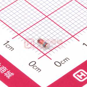

BZV55 Series Zener Voltage Range: 2.4 to 75 Volts Zener Diodes Power Dissipation: 500mW Features Silicon Planar Power Zener Diodes. For use as low voltage stabilizer or voltage reference. The Zener voltages are graded according to the international E 24 standard. Higher Zener voltages and 1% tolerance available on request. Diodes available in these tolerance series: ±2% BZV55-B, ±3% BZV55-F, ±5% BZV55-C. Mechanical Data Case: MiniMELF Glass Case (SOD-80) Weight: approx. 0.05g Cathode Band Color: Blue Maximum Ratings and Thermal Characteristics (TA=25oC unless otherwise noted) Parameter Zener current (see Table "Characteristics") Power dissipation at Tflange=50oC Power dissipation at TA=50oC Junction temperature Storage temperature range Continuous forward current Thermal resistance junction to ambient air Thermal resistance junction to lead Peak reverse power dissipation (non-repetitive) tp=100us Ptot Ptot Tj TS IF RθJA RθJL PZSM 500 400 (1) Symbol Value Unit mW mW o -65 to +175 -65 to +175 250 0.38 (1) o C C o mA C/mW C/mW W 0.30 30 (2) o Notes: 1. Mounted on ceramic substrate 10mm x 10mm x 0.6mm 2. Tj=150oC 500 Electrical Characteristics (TA=25oC unless otherwise noted) Maximum VF=0.9V at IF=10mA Temp. coefficient of z ener voltage at IZ=5mA αvz (% / oC) Type number y=B for +2% VZ y=F for +3% VZ y=C for +5% VZ BZV55 - y2V4 BZV55 - y2V7 BZV55 - y3V0 BZV55 - y3V3 BZV55 - y3V6 BZV55 - y3V9 BZV55 - y4V3 BZV55 - y4V7 BZv55 - y5V1 BZV55 - y5V6 BZV55 - y6V2 BZV55 - y6V8 BZV55 - y7V5 BZV55 - y8V2 BZV55 - y9V1 BZV55 - y10 BZV55 - y11 BZV55 - y12 BZV55 - y13 BZV55 - y15 BZV55 - y16 BZV55 - y18 BZV55 - y20 BZV55 - y22 BZV55 - y24 BZV55 - y27 BZV55 - y30 BZV55 - y33 BZV55 - y36 BZV55 - y39 BZV55 - y43 BZV55 - y47 BZV55 - y51 BZV55 - y56 BZV55 - y62 BZV55 - y68 BZV55 - y75 Dynamic resistance at IZ=5mA f=1kHz rz j (Ω) Max. 100 100 95 95 90 90 90 80 60 40 10 15 15 15 15 20 20 25 30 30 40 45 55 55 70 80 80 80 90 (3) (3) (3) (3) (3) (3) (3) (3) (3) (3) (3) (4) Reverse leakage current at Tamb=25oC at V R (Volts) 1 1 1 1 1 1 1 2 2 2 4 4 5 5 6 7 8 8 8 10 11 13 14 15 17 19 21 23 25 27 30 33 36 39 43 48 53 at IZ=1mA f=1kHz rz j (Ω) Max. 600 600 600 600 600 600 600 500 480 400 150 80 80 80 100 150 150 150 170 200 200 225 225 250 250 300 300 325 350 350 375 375 400 425 450 475 500 (4) (4) (4) (4) (4) (4) (4) (4) (4) (4) (4) (4) Min. - 0.08 - 0.08 - 0.08 - 0.08 - 0.08 - 0.07 - 0.04 - 0.03 - 0.02 - 0.01 0 + 0.01 + 0.01 + 0.01 + 0.02 + 0.03 + 0.03 + 0.03 + 0.03 + 0.03 + 0.03 + 0.03 + 0.03 + 0.03 + 0.04 + 0.04 + 0.04 + 0.04 + 0.04 + 0.04 + 0.04 + 0.04 + 0.04 (3) (3) (3) (3) (3) (3) (3) (3) Max. - 0.06 - 0.06 - 0.06 - 0.05 - 0.04 - 0.03 - 0.01 + 0.01 + 0.05 + 0.06 + 0.07 + 0.08 + 0.09 + 0.09 + 0.10 + 0.11 + 0.11 + 0.11 + 0.11 + 0.11 + 0.11 + 0.11 + 0.11 + 0.11 + 0.12 + 0.12 + 0.12 + 0.12 + 0.12 + 0.12 + 0.12 + 0.12 + 0.12 typ. +0.1 typ. +0.1 typ. +0.1 typ. +0.1 (3) (3) (3) (3) (3) (3) (3) (3) (3) (3) (3) (3) IR (uA) 50 20 10 5 5 3 3 3 2 1 3 2 1 0.7 0.5 0.2 0.1 0.1 0.1 0.05 0.05 0.05 0.05 0.05 0.05 0.05 0.05 0.05 0.05 0.05 0.05 0.05 0.05 0.05 0.05 0.05 0.05 130 150 170 180 200 215 240 255 Notes: 1. Tested with pulses tp=5 ms. 2. Valid provided that electrodes are kept at ambient temperature. 3. at IZ=2.0 mA 4. at IZ=0.5 mA y = Zener voltage tolerance designator (see next page for VZ specifications) 501 Electrical Characteristics (TA=25oC unless otherwise noted) Maximum VF=0.9V at IF=10mA Zener voltage range at IZ=5mA VZ (Volts) Min. 2.20 2.50 2.80 3.10 3.40 3.70 4.00 4.40 4.80 5.20 5.80 6.40 7.00 7.70 8.50 9.40 10.40 11.40 12.40 13.80 15.30 16.80 18.80 20.80 22.80 25.10 28.00 31.00 34.00 37.00 40.00 44.00 48.00 52.00 58.00 64.00 70.00 Max. 2.60 2.90 3.20 3.50 3.80 4.10 4.60 5.00 5.40 6.00 6.60 7.20 7.90 8.70 9.60 10.60 11.60 12.70 14.10 15.60 17.10 19.10 21.20 23.30 25.60 28.90 32.00 35.00 38.00 41.00 46.00 50.00 54.00 60.00 66.00 72.00 79.00 (3) (3) (3) (3) (3) (3) (3) (3) (3) (3) (3) (3) (1) Type number + 5% Tol. BZV55-C2V4 BZV55-C2V7 BZV55-C3V0 BZV55-C3V3 BZV55-C3V6 BZV55-C3V9 BZV55-C4V3 BZV55-C4V7 BZV55-C5V1 BZV55-C5V6 BZV55-C6V2 BZV55-C6V8 BZV55-C7V5 BZV55-C8V2 BZV55-C9V1 BZV55-C10 BZV55-C11 BZV55-C12 BZV55-C13 BZV55-C15 BZV55-C16 BZV55-C18 BZV55-C20 BZV55-C22 BZV55-C24 BZV55-C27 BZV55-C30 BZV55-C33 BZV55-C36 BZV55-C39 BZV55-C43 BZV55-C47 BZV55-C51 BZV55-C56 BZV55-C62 BZV55-C68 BZV55-C75 Notes: Type number + 3% Tol. BZV55-F2V4 BZV55-F2V7 BZV55-F3V0 BZV55-F3V3 BZV55-F3V6 BZV55-F3V9 BZV55-F4V3 BZV55-F4V7 BZV55-F5V1 BZV55-F5V6 BZV55-F6V2 BZV55-F6V8 BZV55-F7V5 BZV55-F8V2 BZV55-F9V1 BZV55-F10 BZV55-F11 BZV55-F12 BZV55-F13 BZV55-F15 BZV55-F16 BZV55-F18 BZV55-F20 BZV55-F22 BZV55-F24 BZV55-F27 BZV55-F30 BZV55-F33 BZV55-F36 BZV55-F39 BZV55-F43 BZV55-F47 BZV55-F51 BZV55-F56 BZV55-F62 BZV55-F68 BZV55-F75 Zener voltage range at IZ=5mA VZ (Volts) Min. 2.33 2.62 2.91 3.20 3.49 3.78 4.17 4.56 4.95 5.43 6.01 6.60 7.28 7.95 8.83 9.70 10.67 11.64 12.61 14.55 15.50 17.50 19.40 21.30 23.30 26.20 29.10 32.00 34.90 37.80 41.70 45.60 49.50 54.30 60.10 66.00 72.80 Max. 2.47 2.78 3.09 3.40 3.71 4.02 4.43 4.84 5.25 5.77 6.39 7.00 7.72 8.45 9.37 (1) Type number + 2% Tol. BZV55-B2V4 BZV55-B2V7 BZV55-B3V0 BZV55-B3V3 BZV55-B3V6 BZV55-B3V9 BZV55-B4V3 BZV55-B4V7 BZV55-B5V1 BZV55-B5V6 BZV55-B6V2 BZV55-B6V8 BZV55-B7V5 BZV55-B8V2 BZV55-B9V1 BZV55-B10 BZV55-B11 BZV55-B12 BZV55-B13 BZV55-B15 BZV55-B16 BZV55-B18 BZV55-B20 BZV55-B22 BZV55-B24 BZV55-B27 BZV55-B30 BZV55-B33 BZV55-B36 BZV55-B39 BZV55-B43 BZV55-B47 BZV55-B51 BZV55-B56 BZV55-B62 BZV55-B68 BZV55-B75 Zener voltage range at IZ=5mA VZ (Volts) Min. 2.35 2.65 2.94 3.23 3.53 3.82 4.21 4.61 5.00 5.49 6.08 6.66 7.35 8.04 8.92 9.80 10.80 11.80 12.70 14.70 15.70 17.60 19.60 21.60 23.50 26.50 29.40 32.30 35.30 38.20 42.10 46.10 50.00 54.90 60.80 66.60 73.50 Max. 2.45 2.75 3.06 3.37 3.67 3.98 4.39 4.79 5.20 5.71 6.32 6.94 7.65 8.36 9.28 (1) 10.30 11.33 12.36 13.39 15.45 16.50 18.50 20.60 22.70 24.70 27.80 30.90 34.00 37.10 40.20 44.30 48.40 52.50 57.70 63.90 70.00 77.20 (3) (3) (3) (3) (3) (3) (3) (3) (3) (3) (3) (3) 10.20 11.20 12.20 13.30 15.30 16.30 18.40 20.40 22.40 24.50 27.50 30.60 33.70 36.70 39.80 43.90 47.90 52.00 57.10 63.20 69.40 76.50 (3) (3) (3) (3) (3) (3) (3) (3) (3) (3) (3) (3) 1. Tested with pulses tp=5ms 2. Valid provided that electrodes are kept at ambient temperature 3. at IZ=2.0 mA 502 RATINGS AND CHARACTERISTIC CURVES (TA = 25oC unless otherwise noted) 503 RATINGS AND CHARACTERISTIC CURVES (TA = 25oC unless otherwise noted) 504 RATINGS AND CHARACTERISTIC CURVES (TA = 25oC unless otherwise noted) 505 RATINGS AND CHARACTERISTIC CURVES (TA = 25oC unless otherwise noted) 506
