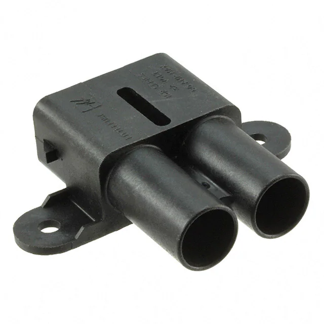

    FUSE HOLDER BLADE 80A IN LINE
01520008Z 数据手册
Fuseholders MAXI™ Fuse Splashproof Fuseholder Ideal for high amperage MAXI™ Fuse applications where a protective cover is required for harsh under-the-hood environments. Specifications Terminals: Copper Alloy/Tin Plated with integral stainless steel reinforcing spring Wire Seal: Silicon Rubber Body: Heat Stabilized Thermoplastic Cover: Transparent Thermoplastic with integral silicon seal Rated: 80A (Dependent on application - contact Littelfuse) Ambient Temp.: -10˚C to +80˚C Maxi Fuse Splashproof Holder for 20-70 Amp Part Number 1520007Z 1520004Z 1520005Z 1520006Z 868-095 913-064 913-064-001 868-096 913-068 913-068-001 913-087 913-087-001 Description Cover with Intergal seal Body with Mounting Tabs (one tab is slotted) Body with Mounting Tabs Body without Mounting Tabs Blue Wire Seal for 1.5-4mm2 (14-12AWG) Wire Single terminal 1.5-4mm2 (14-12AWG) Wire Reeled terminals 1.5-4mm2 (14-12AWG) Wire Gray Wire Seal for 4-10mm2 (10-8AWG) Wire Single terminal 4-6mm2 (10AWG) Wire Reeled terminals 4-6mm2 (10AWG) Wire Single terminal 6-10mm2 (8AWG) Wire Reeled terminals 6-10mm2 (8AWG) Wire Maxi Fuse Splashproof Holder for 80 Amp Part Number 1520007Z 1520008Z 1520009Z 868-096 913-088 913-088-001 Description Cover with Intergal seal Body with Mounting Tabs, 80 Amp Body without Mounting Tabs, 80 Amp Gray Wire Seal for 4-10mm_ (10-8AWG) Wire Single terminal 8mm_ (8AWG) Wire Reeled terminals 8mm_ (8AWG) Wire *It is recommended that cross linked polyethelene (GLX) insulated wire be used, as described in SAE J1128 (Type, FLY in DIN 76722) or equivalent. 28 Visit our web site at www.littelfuse.com
