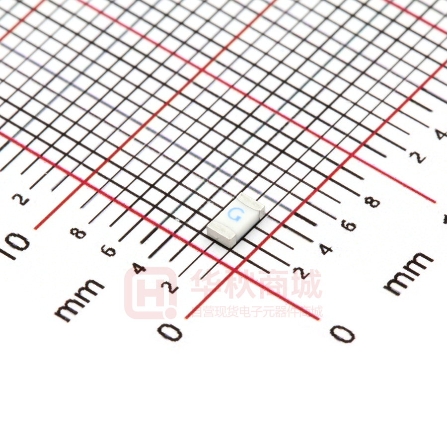

Description
The 440 Series is a 100% Lead-free, RoHS compliant and
Halogen-free fuse series designed specifically to provide
over-current protection to circuits that operate under high
working ambient temperatures up to 150ºC and high inrush
currents. The general design ensures excellent temperature
stability and performance reliability. This high I2t fuse series
is designed to have ultra high inrush current withstand
capability to avoid nuisance fuse open.
