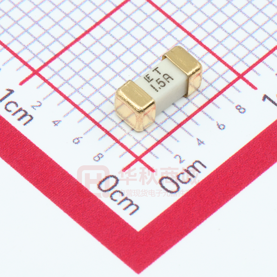

Surface Mount Fuses NANO2® > Slo-Blo® Fuse > 452/454 Series 452/454 Series Fuse RoHS PS E Description The NANO2® Slo-Blo® fuse has enhanced inrush withstand characteristics over the NANO2® Fast-Acting fuse. The unique time delay feature of this fuse design helps solve the problem of nuisance “opening” by accommodating inrush currents that normally cause a fast-acting fuse to open. Features Agency Approvals AGENCY AGENCY FILE NUMBER AMPERE RANGE E10480 0.375A - 12A 29862 0.375A - 12A NBK030205-E10480B 1A - 5A PS E Electrical Characteristics for Series % of Ampere Rating Opening Time 100% 4 hours, Minimum 200% 1 sec., Min.; 60 sec., Max. 300% 0.2 sec., Min.; 3 sec., Max 800% 0.02 sec., Min.; 0.1 sec., Max. • Small size • Wide range of current rating available (0.375A to 12A) • Wide operating temperature range • Low temperature rerating • RoHS compliant and Halogen Free Applications • Notebook PC • LCD/PDP TV • LCD monitor • LCD/PDP panel • LCD backlight inverter • Portable DVD player • Power supply • Networking • PC server • Cooling fan system • Storage system • Telecom system • Wireless basestation • White goods • Game console • Office Automation equipment • Battery charging circuit protection • Industrial equipment Electrical Specifications by Item Ampere Rating (A) Amp Code Max Voltage Rating (V) Interrupting Rating Nominal Cold Resistance (Ohms) Agency Approvals Nominal Melting I2t (A2sec) PS E 0.375 .375 125 1.2000 0.101 x x 0.500 .500 125 0.7000 0.240 x x 0.750 .750 125 0.3600 0.904 x x 001. 001. 125 0.2250 1.98 x x x 1.50 01.5 125 0.0930 3.65 x x x 2.00 002. 125 2.50 02.5 125 3.00 003. 125 0.0340 20.16 x x x 3.50 03.5 125 0.0224 26.53 x x x 50A @ 125 VAC/VDC 300A @ 32 VDC PSE: 100A @ 100 VAC 0.0625 8.20 x x x 0.0450 15.0 x x x 4.00 004. 125 0.0186 34.40 x x x 5.00 005. 125 0.0136 53.72 x x x 7.00 007. 75 0.0105 123.83 x x 8 008. 75 12 012. 75 50A @ 72 VAC 50A @ 60 VDC 100A @ 75 VDC 0.0088 137.34 x x 0.0061 260.46 x x Notes: - l2t calculated at 8ms. - Resistance is measured at 10% of rated current, 25ºC © 2018 Littelfuse, Inc. Specifications are subject tostrongly change recommended. without notice. Specifications are subject to change without notice. Application testing is Revised: 01/10/18 Surface Mount Fuses NANO2® > Slo-Blo® Fuse > 452/454 Series Temperature Re-rating Curve Average Time Current Curves 12.0A 8.00A 7.00A 5.00A 4.00A 3.50A 3.00A 2.50A 2.00A 1.50A 1.00A 750mA 500mA 375mA TIME IN SECONDS 100 10 1 Note: 1. Rerating depicted in this curve is in addition to the standard derating of 25% for continuous operation. 0.1 0.01 0.1 1 10 100 1000 CURRENT IN AMPS Soldering Parameters Pre Heat Pb – Free assembly - Temperature Min (Ts(min)) 150°C - Temperature Max (Ts(max)) 200°C - Time (Min to Max) (ts) 60 – 120 secs Average ramp up rate (Liquidus Temp (TL) to peak 5°C/second max. TS(max) to TL - Ramp-up Rate 5°C/second max. Reflow - Temperature (TL) (Liquidus) 217°C - Temperature (tL) 60 – 90 seconds 260 Time within 5°C of actual peak Temperature (tp) 20 – 40 seconds °C Ramp-down Rate 5°C/second max. Time 25°C to peak Temperature (TP) 8 minutes max. Do not exceed 260°C Wave Soldering Parameters 260°C Peak Temperature, 3 seconds max. © 2018 Littelfuse, Inc. Specifications are subject to change without notice. Revised: 01/10/18 Critical Zone TL to TP Ramp-up TL TS(max) tL Ramp-down TS(min) Preheat tS 25 Peak Temperature (TP) +0/–5 tP TP Temperature Reflow Condition time to peak temperature (t 25ºC to peak) Time Surface Mount Fuses NANO2® > Slo-Blo® Fuse > 452/454 Series Product Characteristics Body: Ceramic Terminations: Gold-plated Caps / Sn-dipped Silver Plated Caps (452 Series) Silver-plated Caps (454 Series) Materials Product Marking Brand, Ampere Rating Operating Temperature -55°C to 125°C Moisture Sensitivity Level Level 1, J-STD-020 Solderability MIL-STD-202, Method 208 Insulation Resistance (after Opening) MIL-STD-202, Method 302, Test Condition A (10,000 ohms minimum) Thermal Shock MIL-STD-202, Method 107, Test Condition B, 5 cycles, -65°C / +125°C, 15 minutes @ each extreme Mechanical Shock MIL-STD-202, Method 213, Test I: Deenergized. 100G’s pk amplitude, sawtooth wave 6ms duration, 3 cycles XYZ+xyz = 18 shocks Vibration MIL-STD-202, Method 201: 0.03” amplitude, 10-55 Hz in 1 min. 2hrs each XYZ=6hrs Moisture Resistance MIL-STD-202, Method 106, 10 cycles Salt Spray MIL-STD-202, Method 101, Test Condition B (48hrs) Resistance to Soldering Heat MIL-STD-202, Method 210, Test condition B (10 sec at 260°C) Part Numbering System Dimensions 0452 001. M R L 2.69 ± .25 (.106") 6.10 ± .20 (.240") T 1A F 2.69 ± .25 (.106") 1.45 (.057") SERIES AMP Code Refer to Amp Code column in the Electrical Specifications table. The dot is positioned at the end of the number sequence with whole ratings and within for fractional ratings. Example: 0.375 Amp product is 0452.375MRL (1 amp product shown) 6.86 (.270") QUANTITY Code M = 1000 pcs N = 5000 pcs 3.15 (.124") PACKAGING Code R = Tape and Reel L - RoHS Compliant & Halogen Free (Gold Plated Caps) SN-RoHS Compliant & Halogen Free (Sn-dipped Caps) 2.95 (.116") 1.96 (.077") Recommended pad layout Notes: 452 series may be ordered as “RoHS and HF (Gold Plated Caps)” (“L” suffix). 454 series is available only as “RoHS and HF” version and does not require “L” suffix. Please do not include “L” suffix within 454 series ordering instructions. Additional Information Packaging Packaging Option Packaging Specification Quantity Quantity & Packaging Code 12mm Tape and Reel EIA RS-481-1 (IEC 286, part 3) 5000 NR 12mm Tape and Reel EIA RS-481-1 (IEC 286, part 3) 1000 MR Datasheet 452 Series Resources 452 Series Samples 452 Series Datasheet 454 Series Resources 454 Series Samples 454 Series Disclaimer Notice - Littelfuse products are not designed for, and shall not be used for, any purpose (including, without limitation, automotive, military, aerospace, medical, life-saving, life-sustaining or nuclear facility applications, devices intended for surgical implant into the body, or any other application in which the failure or lack of desired operation of the product may result in personal injury, death, or property damage) other than those expressly set forth in applicable Littelfuse product documentation. Warranties granted by Littelfuse shall be deemed void for products used for any purpose not expressly set forth in applicable Littelfuse documentation. Littelfuse shall not be liable for any claims or damages arising out of products used in applications not expressly intended by Littelfuse as set forth in applicable Littelfuse documentation. The sale and use of Littelfuse products is subject to Littelfuse Terms and Conditions of Sale, unless otherwise agreed by Littelfuse. Information furnished is believed to be accurate and reliable. However, users should independently evaluate the suitability of and test each product selected for their own applications. Littelfuse products are not designed for, and may not be used in, all applications. Read complete Disclaimer Notice at www.littelfuse.com/disclaimer-electronics. © 2018 Littelfuse, Inc. Specifications are subject to change without notice. Revised: 01/10/18
