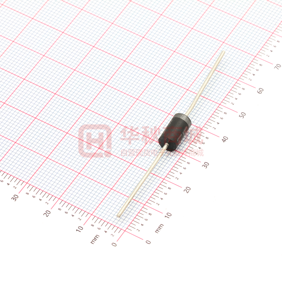

1.5KE200A
1.5KE200A
    HAMLIN
    DO201
    TVS DIODE 171VWM 274VC AXIAL
1.5KE200A 数据手册
Transient Voltage Suppression Diodes Axial Leaded – 1500W > 1.5KE series 1.5KE Series RoHS Pb e3 Description The 1.5KE Series is designed specifically to protect sensitive electronic equipment from voltage transients induced by lightning and other transient voltage events. Uni-directional Features Bi-directional Agency Approvals AGENCY AGENCY FILE NUMBER E230531 Maximum Ratings and Thermal Characteristics (TA=25OC unless otherwise noted) Parameter Symbol Value Unit PPPM 1500 W PD 6.5 W IFSM 200 A VF 3.5/5.0 V TJ , TSTG -55 to 175 °C Typical Thermal Resistance Junction to Lead RθJL 15 °C/W Typical Thermal Resistance Junction to Ambient RθJA 75 °C/W Peak Pulse Power Dissipation by 10/1000μs Test Waveform (Fig.2) (Note 1), (Note 4) Steady State Power Dissipation on Infinite Heat Sink at TL=75ºC Peak Forward Surge Current, 8.3ms Single Half Sine Wave Unidirectional Only (Note 2) Maximum Instantaneous Forward Voltage at 100A for Unidirectional Only (Note 3) Operating Junction and Storage Temperature Range Notes: 1. Non-repetitive current pulse , per Fig. 4 and derated above TJ (initial) =25OC per Fig. 3. 2. Measured on 8.3ms single half sine wave or equivalent square wave, duty cycle=4 per minute maximum. 3. VF < 3.5V for single die parts and VF< 5.0V for stacked-die parts. 4. The PPPM of stacked-die parts is 2kW and please contact littelfuse for the detail stacked-die parts. • 1500W peak pulse capability at 10/1000μs waveform, repetition rate (duty cycles):0.01% • Glass passivated chip junction in DO-201 Package • Fast response time: typically less than 1.0ps from 0 Volts to BV min • Excellent clamping capability • Typical failure mode is short from over-specified voltage or current • Whisker test is conducted based on JEDEC JESD201A per its table 4a and 4c • IEC-61000-4-2 ESD 30kV(Air), 30kV (Contact) •E  SD protection of data lines in accordance with IEC 61000-4-2 •E  FT protection of data lines in accordance with IEC 61000-4-4 • Low incremental surge resistance • Typical IR less than 1μA when VBR min>12V • High temperature to reflow soldering guaranteed: 260°C/40sec / 0.375”,(9.5mm) lead length, 5 lbs., (2.3kg) tension • VBR @ TJ= VBR@25°C x (1+αT x (TJ - 25)) (αT:Temperature Coefficient, typical value is 0.1%) • Plastic package is flammability rated V-0 per Underwriters Laboratories • Matte tin lead–free plated • Halogen free and RoHS compliant • Pb-free E3 means 2nd level interconnect is Pb-free and the terminal finish material is tin(Sn) (IPC/JEDEC J-STD609A.01) Applications TVS devices are ideal for the protection of I/O interfaces, VCC bus and other vulnerable circuits used in telecom, computer, industrial and consumer electronic applications. Additional Infomarion Functional Diagram Datasheet Bi-directional Cathode Anode Uni-directional © 2015 Littelfuse, Inc. Specifications are subject to change without notice. Revised: 11/20/15 Resources Samples Transient Voltage Suppression Diodes Axial Leaded – 1500W > 1.5KE series Electrical Characteristics (T =25°C unless otherwise noted) A Test Current IT (mA) Maximum Clamping Voltage VC @ Ipp (Volts) Maximum Peak Pulse Current Ipp (A) Maximum Reverse Leakage IR @ VR (µA) Agency Approval 7.14 7.88 8.61 9.50 10.50 11.60 12.60 13.70 15.80 16.80 18.90 21.00 23.10 25.20 28.40 31.50 34.70 37.80 41.00 45.20 49.40 53.60 58.80 65.10 71.40 78.80 86.10 95.50 105.00 116.00 126.00 137.00 158.00 168.00 179.00 189.00 210.00 231.00 263.00 315.00 336.00 368.00 420.00 462.00 504.00 535.00 556.50 567.00 577.50 10 10 10 1 1 1 1 1 1 1 1 1 1 1 1 1 1 1 1 1 1 1 1 1 1 1 1 1 1 1 1 1 1 1 1 1 1 1 1 1 1 1 1 1 1 1 1 1 1 10.5 11.3 12.1 13.4 14.5 15.6 16.7 18.2 21.2 22.5 25.2 27.7 30.6 33.2 37.5 41.4 45.7 49.9 53.9 59.3 64.8 70.1 77.0 85.0 92.0 103.0 113.0 125.0 137.0 152.0 165.0 179.0 207.0 219.0 234.0 246.0 274.0 328.0 344.0 414.0 441.0 482.0 548.0 602.0 658.0 698.0 725.0 740.0 760.0 144.8 134.5 125.6 113.4 104.8 97.4 91.0 83.5 71.7 67.6 60.3 54.9 49.7 45.8 40.5 36.7 33.3 30.5 28.2 25.6 23.5 21.7 19.7 17.9 16.5 14.8 13.5 12.2 11.1 10.0 9.2 8.5 7.3 6.9 6.5 6.2 5.5 4.6 4.4 3.7 3.5 3.2 2.8 2.5 2.3 2.1 2.1 2.0 2.0 1000 500 200 50 10 5 5 1 1 1 1 1 1 1 1 1 1 1 1 1 1 1 1 1 1 1 1 1 1 1 1 1 1 1 1 1 1 1 1 1 1 1 1 1 1 1 1 1 1 X X X X X X X X X X X X X X X X X X X X X X X X X X X X X X X X X X X X X X X X X X X X 630.00 1 828.0 1.8 1 Part Number (Uni) Part Number (Bi) Reverse Stand off Voltage VR (Volts) MIN MAX 1.5KE6.8A 1.5KE7.5A 1.5KE8.2A 1.5KE9.1A 1.5KE10A 1.5KE11A 1.5KE12A 1.5KE13A 1.5KE15A 1.5KE16A 1.5KE18A 1.5KE20A 1.5KE22A 1.5KE24A 1.5KE27A 1.5KE30A 1.5KE33A 1.5KE36A 1.5KE39A 1.5KE43A 1.5KE47A 1.5KE51A 1.5KE56A 1.5KE62A 1.5KE68A 1.5KE75A 1.5KE82A 1.5KE91A 1.5KE100A 1.5KE110A 1.5KE120A 1.5KE130A 1.5KE150A 1.5KE160A 1.5KE170A 1.5KE180A 1.5KE200A 1.5KE220A 1.5KE250A 1.5KE300A 1.5KE320A 1.5KE350A 1.5KE400A 1.5KE440A 1.5KE480A 1.5KE510A 1.5KE530A 1.5KE540A 1.5KE550A 1.5KE6.8CA 1.5KE7.5CA 1.5KE8.2CA 1.5KE9.1CA 1.5KE10CA 1.5KE11CA 1.5KE12CA 1.5KE13CA 1.5KE15CA 1.5KE16CA 1.5KE18CA 1.5KE20CA 1.5KE22CA 1.5KE24CA 1.5KE27CA 1.5KE30CA 1.5KE33CA 1.5KE36CA 1.5KE39CA 1.5KE43CA 1.5KE47CA 1.5KE51CA 1.5KE56CA 1.5KE62CA 1.5KE68CA 1.5KE75CA 1.5KE82CA 1.5KE91CA 1.5KE100CA 1.5KE110CA 1.5KE120CA 1.5KE130CA 1.5KE150CA 1.5KE160CA 1.5KE170CA 1.5KE180CA 1.5KE200CA 1.5KE220CA 1.5KE250CA 1.5KE300CA 1.5KE320CA 1.5KE350CA 1.5KE400CA 1.5KE440CA 1.5KE480CA 1.5KE510CA 1.5KE530CA 1.5KE540CA 1.5KE550CA 5.80 6.40 7.02 7.78 8.55 9.40 10.20 11.10 12.80 13.60 15.30 17.10 18.80 20.50 23.10 25.60 28.20 30.80 33.30 36.80 40.20 43.60 47.80 53.00 58.10 64.10 70.10 77.80 85.50 94.00 102.00 111.00 128.00 136.00 145.00 154.00 171.00 185.00 214.00 256.00 273.00 300.00 342.00 376.00 408.00 434.00 451.00 460.00 468.00 6.45 7.13 7.79 8.65 9.50 10.50 11.40 12.40 14.30 15.20 17.10 19.00 20.90 22.80 25.70 28.50 31.40 34.20 37.10 40.90 44.70 48.50 53.20 58.90 64.60 71.30 77.90 86.50 95.00 105.00 114.00 124.00 143.00 152.00 162.00 171.00 190.00 209.00 237.00 285.00 304.00 332.00 380.00 418.00 456.00 485.00 503.50 513.00 522.50 1.5KE600A 1.5KE600CA 512.00 570.00 Breakdown Voltage VBR (Volts) @ IT F For bidirectional type having VR of 10 volts and less, the IR limit is double. For parts without A, the VBR is ± 10% and VC is 5% higher than with A parts. © 2015 Littelfuse, Inc. Specifications are subject to change without notice. Revised: 11/20/15 Transient Voltage Suppression Diodes Axial Leaded – 1500W > 1.5KE series I-V Curve Characteristics Bi-directional Uni-directional Ipp Vc VBR VR V IR VF IT IT IR Vc VBR VR IR IT V Ipp Ipp PPPM VR VBR VC IR VF VR VBR Vc Peak Pulse Power Dissipation -- Max power dissipation Stand-off Voltage -- Maximum voltage that can be applied to the TVS without operation Breakdown Voltage -- Maximum voltage that flows though the TVS at a specified test current (IT) Clamping Voltage -- Peak voltage measured across the TVS at a specified Ippm (peak impulse current) Reverse Leakage Current -- Current measured at VR Forward Voltage Drop for Uni-directional Ratings and Characteristic Curves (T =25°C unless otherwise noted) A Figure 1 - TVS Transients Clamping Waveform Figure 2 - Peak Pulse Power Rating 100 PPPM-Peak Pulse Power (kW) Voltage Transients Voltage or Current Voltage Across TVS Current Through TVS TJ initial = Tamb 1 0.1 0.001 Time stacked-die, 2kW at 10x1000µs, 25°C 10 Single die, 1.5kW at 10x1000µs, 25°C 0.01 0.1 1 10 td-Pulse Width (ms) continues on next page. © 2015 Littelfuse, Inc. Specifications are subject to change without notice. Revised: 11/20/15 Transient Voltage Suppression Diodes Axial Leaded – 1500W > 1.5KE series Ratings and Characteristic Curves (T =25°C unless otherwise noted) (Continued) A Figure 4 - Pulse Waveform Figure 3 - Peak Pulse Power Derating Curve IPPM- Peak Pulse Current, % IRSM Peak Pulse Power (PPP) or Current (IPP) Derating in Percentage % 150 100 75 50 25 0 0 25 50 75 100 125 150 175 tr=10µsec 2 50 10/1000µsec. Waveform as defined by R.E.A td 1.0 0 2.0 3.0 4.0 Figure 6 - Typical Transient Thermal Impedance 100 Transient Thermal Impedance (°C/W) 100000 Uni-directional V=0V 10000 Bi-directional V=0V Cj(pF) ( ) t-Time (ms) Figure 5 - Typical Junction Capacitance 1000 Uni-directional V=VR 100 Bi-directional V=VR 10 1 10 100 10 1 0.1 1000 0.01 VBR - Reverse Breakdown Voltage(V) 0.1 1 10 100 1000 TP - Pulse Duration (s) Figure 7 - Maximum Non-Repetitive Peak Forward Surge Current Uni-Directional Only Figure 8 - Peak Forward Voltage Drop vs Peak Forward Current (Typical Values) 100.0 200 Single die 180 IF- Peak Forward Current(A) IFSM - Peak Forward Surge Current (A) Half Value IPPM IPPM 0 TJ - Initial Junction Temperature (ºC) 1 Peak Value IPPM 100 200 TJ=25°C Pulse Width(td) is defined as the point where the peak current decays to 50% of IPPM 160 140 120 100 80 60 40 Stacked-die 10.0 1.0 20 0 1 10 Number of Cycles at 60 Hz 100 0.1 0.0 1.0 2.0 3.0 4.0 5.0 6.0 7.0 8.0 9.0 VF-Peak Forward Voltage(V) © 2015 Littelfuse, Inc. Specifications are subject to change without notice. Revised: 11/20/15 Transient Voltage Suppression Diodes Axial Leaded – 1500W > 1.5KE series Soldering Parameters Lead–free assembly Pre Heat - Temperature Min (Ts(min)) 150°C - Temperature Max (Ts(max)) 200°C - Time (min to max) (ts) 60 – 180 secs Ramp-up TL Average ramp up rate (Liquidus Temp (TA) to peak 3°C/second max TS(max) to TA - Ramp-up Rate 3°C/second max Reflow tp TP - Temperature (TA) (Liquidus) 217°C - Time (min to max) (ts) 60 – 150 seconds Temperature (T) Reflow Condition tL Ts(max) Ramp-down Ts(min) ts Preheat 25˚C t 25˚C to Peak Time (t) Peak Temperature (TP) 260 Time within 5°C of actual peak Temperature (tp) 20 – 40 seconds Flow/Wave Soldering (Solder Dipping) Ramp-down Rate 6°C/second max Peak Temperature : 265OC Time 25°C to peak Temperature (TP) 8 minutes Max. Dipping Time : 10 seconds Do not exceed 260°C Soldering : 1 time +0/-5 Critical Zone TL to TP °C Environmental Specifications Physical Specifications Weight 0.045oz., 1.2g High Temp. Storage JESD22-A103 Case JEDEC DO-201 molded plastic body over passivated junction. HTRB JESD22-A108 Polarity Color band denotes the cathode except Bipolar. Temperature Cycling JESD22-A104 Terminal Matte Tin axial leads, solderable per JESD22-B102. H3TRB JESD22-A101 RSH JESD22-B106 Dimensions D Cathode Band (for Uni-directional products only) A C A Dimensions B DO-201 © 2015 Littelfuse, Inc. Specifications are subject to change without notice. Revised: 11/20/15 A Inches Millimeters Min Max Min Max 1.000 - 25.40 - B 0.285 0.375 7.20 9.50 C 0.038 0.042 0.96 1.07 D 0.190 0.210 4.80 5.30 Transient Voltage Suppression Diodes Axial Leaded – 1500W > 1.5KE series Part Numbering System Part Marking System OPTION CODE: BLANK Reel Tape -B Bulk Packaging Cathode Band TYPE CODE: A Uni-Directional (5% VBR Voltage Tolerance) CA Bi-Directional (5% VBR Voltage Tolerance) Littelfuse Logo (for Uni-directional products only) F 1.5KE xxx XX X YYWW Trace Code Marking 1.5KEXXX VBR VOLTAGE CODE (Refer to the Electrical Characteristics table) YY:Year Code WW: Week Code Product Type SERIES CODE Packaging Component Package Quantity Packaging Option 1.5KExxxXX DO-201 1200 Tape & Reel EIA STD RS-296 1.5KExxxXX-B DO-201 500 BULK Littelfuse Spec. Part Number Packaging Specification Tape and Reel Specification Off Center either side 2.063+0.079/-0.039 (53.0+2.0/-1.0) 0.028(0.7) 2.56 (65.0) 0.047 (1.2) 0.394+/-0.020 (10.0+/-0.5) 13.0 (330.2) 0.236 (6.0) Dimensions are in inches/mm 3.0 (76.2) 0.68 (17.27) 2.75 (69.85) Recess Depth Max. 0.75 (19.05) Direction of Feed © 2015 Littelfuse, Inc. Specifications are subject to change without notice. Revised: 11/20/15
