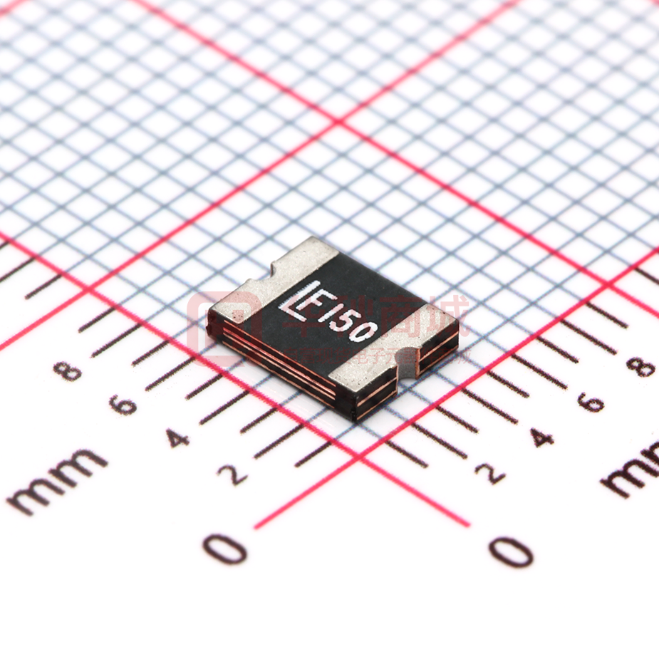

    PTC自恢复保险丝 1.5A 15V 2016
2016L150DR 数据手册
POLY-FUSE® Resettable PTCs Surface Mount > 2016L Series 2016L Series RoHS Description The 2016L Series PTC provides surface mount overcurrent protection for low voltage (≤60V) applications where resettable protection is desired. Features • High voltage • Low-profile • RoHS compliant, lead-free and halogen-free • Fast response to fault currents Agency Approvals Agency Applications • Low voltage telecom equipment protection • IEEE 1394 port protection •P  owered ethernet port protection (IEEE 802.3 af) • Automotive electronic control module protection Agency File Number E183209 R50119118 Electrical Characteristics Part Number Marking I hold (A) I trip (A) V max (Vdc) I max (A) P d typ. (W) 2016L030 LF030 0.30 0.60 60 20 2016L050 LF050 0.55 1.10 60 20 2016L075/60 LF075 0.75 1.50 60 2016L100 LF100 1.10 2.20 2016L100/33 LF100-33 1.10 2016L150 LF150 1.50 2016L150/33 LF150-33 1.50 2016L200 LF200 2016L260/24 2016L300/16 2016L500 Maximum Time To Trip Resistance Agency Approvals Current (A) Time (Sec.) R min (Ω) R 1max (Ω) 1.40 1.5 3.0 0.500 2.300 X X 1.40 2.5 5.0 0.200 1.000 X X 20 1.40 8.0 0.5 0.130 0.900 X X 15 40 1.40 8.0 0.5 0.100 0.400 X X 2.20 33 40 1.40 8.0 0.5 0.100 0.400 X X 3.00 15 40 1.40 8.0 1.0 0.070 0.180 X X 3.00 33 40 2.0 8.00 1.00 0.070 0.180 X X 2.00 4.20 6 40 1.40 8.0 3.0 0.048 0.100 X X LF260-24 2.60 5.00 24 40 1.6 8.00 5.00 0.025 0.075 X X LF300 3.00 5.00 16 40 1.6 8.00 10.00 0.015 0.048 X X LF500 5.00 10.00 6 100 2.0 25.00 2.00 0.005 0.025 X X I hold = Hold current: maximum current device will pass without tripping in 20°C still air. I trip = Trip current: minimum current at which the device will trip in 20°C still air. V max = Maximum voltage device can withstand without damage at rated current (I max) I max = Maximum fault current device can withstand without damage at rated voltage (Vmax) P d = Power dissipated from device when in the tripped state at 20°C still air. R min = Minimum resistance of device in initial (un-soldered) state. R typ = Typical resistance of device in initial (un-soldered) state. R 1max = M  aximum resistance of device at 20°C measured one hour after tripping or reflow soldering of 260°C for 20 sec. Caution: Operation beyond the specified rating may result in damage and possible arcing and flame. * Agency Approval is Pending WARNING • Users shall independently assess the suitability of these devices for each of their applications • Operation of these devices beyond the stated maximum ratings could result in damage to the devices and lead to electrical arcing and/or fire • These devices are intended to protect against the effects of temporary over-current or over-temperature conditions and are not intended to perform as protective devices where such conditions are expected to be repetitive or prolonged in duration • Exposure to silicon-based oils, solvents, electrolytes, acids, and similar materials can adversely affect the performance of these PPTC devices • These devices undergo thermal expansion under fault conditions, and thus shall be provided with adequate space and be protected against mechanical stresses • Circuits with inductance may generate a voltage (L di/dt) above the rated voltage of the PPTC device. © 2019 Littelfuse, Inc. Specifications are subject to change without notice. Revised: 05/10/19 POLY-FUSE® Resettable PTCs Surface Mount > 2016L Series Temperature Rerating Ambient Operation Temperature -40°C -20°C 0°C 20°C Part Number 40°C 50°C 60°C 70°C 85°C Hold Current (A) 2016L030 0.45 0.40 0.35 0.30 0.25 0.23 0.20 0.18 0.14 2016L050 0.93 0.95 0.65 0.55 0.42 0.38 0.33 0.30 0.23 2016L075/60 1.05 1.06 0.85 0.75 0.60 0.55 0.45 0.40 0.30 2016L100 1.66 1.47 1.29 1.10 0.91 0.83 0.73 0.64 0.50 2016L100/33 1.66 1.47 1.29 1.10 0.91 0.83 0.73 0.64 0.50 2016L150 2.26 2.00 1.76 1.50 1.24 1.13 1.00 0.87 0.68 2016L150/33 2.26 2.00 1.76 1.50 1.24 1.13 1.00 0.87 0.68 2016L200 2.80 2.50 2.19 2.00 1.84 1.74 1.50 1.34 1.14 2016L260/24 3.82 3.46 3.06 2.60 2.24 2.03 1.82 1.60 1.26 2016L300/16 4.40 3.96 3.52 3.00 2.65 2.43 2.20 1.96 1.59 2016L500 7.29 6.57 5.86 5.00 4.38 4.02 3.66 3.26 2.66 Temperature Rerating Curve Average Time Current Curves Time in Seconds 100 10 150% Percentage of Rated Current 1.50A/33 2.60A/24 3.00A/16 5.00A 0.30A 0.50A 0.75A/60 1.00A 1.00A/33 1.50A 2.00A 170% 130% 110% 90% 70% 50% 30% 10% -40 -30 -20 -10 0 1 10 20 30 40 Temperature (°C) 50 60 70 80 85 Note: Typical Temperature rerating curve, refer to table for derating data 0.1 Additional Information 0.01 0.1 1 10 Current in Amperes The average time current curves and Temperature Rerating curve performance is affected by a number or variables, and these curves provided as guidance only. Customer must verify the performance in their application. Datasheet Resources Samples © 2019 Littelfuse, Inc. Specifications are subject to change without notice. Revised: 05/10/19 POLY-FUSE® Resettable PTCs Surface Mount > 2016L Series Soldering Parameters Profile Feature Pb-Free Assembly Average Ramp-Up Rate (TS(max) to TP) 3°C/second max Time Maintained Above: Temperature Min (Ts(min)) 150°C Temperature Max (Ts(max)) 200°C Time (Min to Max) (ts) 60 – 180 secs Temperature (TL) 217°C Temperature (tL) 60 – 150 seconds Peak / Classification Temperature (TP) 260 Time within 5°C of actual peak Temperature (tp) 20 – 40 seconds +0/-5 °C Ramp-down Rate 6°C/second max Time 25°C to peak Temperature (TP) 8 minutes Max. Physical Specifications Critical Zone tL to tP Ramp-up TL TS(max) Temperature Pre Heat: tP TP tL Ramp-do Ramp-down Preheat TS(min) 25 tS time to peak temperature Time -- All temperature refer to topside of the package, measured on the package body surface -- If reflow temperature exceeds the recommended profile, devices may not meet the performance requirements -- Recommended reflow methods: IR, vapor phase oven, hot air oven, N2 environment for lead -- Recommended maximum paste thickness is 0.25mm(0.010inch) -- Devices can be cleaned usingstandard industry methods and solvents -- Devices can be reworked using the standard industry practices Environmental Specifications Terminal Material Solder-Plated Copper (Solder Material: Matte Tin(Sn)) Operating/Storage Temperature -40°C to +85°C Lead Solderability Meets EIA Specification RS186-9E, ANSI/ J-STD-002 Category 3. Maximum Device Surface Temperature in Tripped State 125°C Passive Aging +85°C, 1000 hours -/+5% typical resistance change Humidity Aging +85°C, 85%,R.H.,1000 hours -/+5% typical resistance change Thermal Shock MIL–STD–202, Method 107 +85°C/-40°C 20 times -30% typical resistance change Solvent Resistance MIL–STD–202, Method 215 No change Vibration MIL–STD–883, Method 2007, Condition A No change Moisture Sensitivity Level Level 1, J–STD–020 © 2019 Littelfuse, Inc. Specifications are subject to change without notice. Revised: 05/10/19 POLY-FUSE® Resettable PTCs Surface Mount > 2016L Series Dimensions (mm) C A Top View 100 Bottom View 100 100 -33 B 3.40 mm (.133”) Pad Layout D E 4.60 mm (.181”) 1.50 mm (.059”) A Part Number Inches Min Max MARKING CODE VARIES WITH AMPERAGE AND VOLTAGE RATING SEE ELECTRICAL CHARACTERISTICS CHART SHOWN ARE: - 1.1A/15V RATING (LEFT) - 1.1A/33V RATING (RIGHT) Side View B mm Min Max Inches Min Max C mm Min D Inches mm Min Max Min Max 2016L030 0.03 0.05 0.75 1.25 2016L050 0.05 0.08 1.20 2.00 2016L075/60 Max 4.43 2016L100 2016L100/33 0.19 2016L150 0.21 4.72 5.44 0.15 0.17 3.7 0.05 0.08 1.20 2.00 0.02 0.03 0.50 0.75 0.03 0.05 0.75 1.25 0.03 0.06 0.75 1.55 2016L150/33 4.43 0.03 0.06 0.80 1.60 2016L200 4.43 0.02 0.03 0.50 0.75 4.43 0.03 0.06 0.80 1.60 Inches E mm Inches mm Min Max Min Max Min Max Min Max 0.01 0.06 0.3 1.5 0.01 0.03 0.25 0.65 2016L260/24 2016L300/16 2016L500 Part Ordering Number System 2016 L xxx /xx D R - A SERIES -A: Automotive grade Blank: Standard version PACKAGING STYLE R: Tape & Reel QUANTITY CODE: D=1500 M=1000 P=2000 SPECIAL VOLTAGE RATING ITEM (Not applicable to all parts. Refer to Electrical Characteristics Table for additional information) I HOLD HOLD CURRENT CODE (Refer to Electrical Characteristics Table) L: LITTELFUSE SURFACE MOUNT PPTC DEVICE SIZE CODE (0.20 x 0.16 inch) Packaging Ordering Number Halogen Free I hold (A) I hold Code 2016L030 2016L030DR Yes 0.30 2016L050 2016L050MR Yes 0.55 2016L075/060 2016L075/60MR Yes 0.75 075 2016L100 2016L100PR Yes 1.10 110 2016L100/33 2016L100/33DR Yes 1.10 110 2016L150 2016L150DR Yes 1.50 150 2016L150/33 2016L150/33DR Yes 1.50 150 2016L200 2016L200PR Yes 2.00 200 2016L260/24 2016L260/24MR Yes 2.60 260 2016L300/16 2016L300/16MR Yes 3.00 2016L500 2016L500DR Yes 5.00 Part Number Voltage Option Packaging Option Quantity 030 Tape and Reel 1500 DR 050 Tape and Reel 1000 MR MR /60 /33 /33 Quantity & Packaging Codes Tape and Reel 1000 Tape and Reel 2000 PR Tape and Reel 1500 DR Tape and Reel 1500 DR DR Tape and Reel 1,500 Tape and Reel 2000 PR /24 Tape and Reel 1,000 MR 300 /16 Tape and Reel 1,000 MR 500 /6 Tape and Reel 1,500 DR © 2019 Littelfuse, Inc. Specifications are subject to change without notice. Revised: 05/10/19 POLY-FUSE® Resettable PTCs Surface Mount > 2016L Series Tape and Reel Specifications TAPE SPECIFICATIONS: EIA-481-1 (mm) 2016L100 2016L200 2016L030 2016L100/33 2016L150 2016L150/33 2016L500 2016L050 2016L075/60 2016L260/24 2016L300/16 W 12.0+/- 0.30 12.0+/- 0.30 12.0+/- 0.30 C Ø178.0+/-1.0 REEL DIMENSIONS: EIA-481-1 (mm) F 5.50+/- 0.05 5.50+/- 0.05 5.50+/- 0.05 D Ø60.2+/-0.5 E1 1.75+/- 0.10 1.75+/- 0.10 1.75+/- 0.10 H 16.0+/- 0.5 D0 1.55+/- 0.05 1.55+/- 0.05 1.55+/- 0.05 W 13.2+/- 1.5 D1 1.50 (MIN) 1.50+/-0.10 1.50+/-0.10 4.0+/- 0.10 P0 4.0+/- 0.10 4.0+/- 0.10 P1 8.0+/- 0.10 8.0+/- 0.10 8.0+/- 0.10 P2 2.0+/- 0.05 2.0+/- 0.05 2.0+/- 0.05 A0 4.40+/- 0.10 4.48+/- 0.10 4.45+/- 0.10 B0 5.50+/- 0.10 5.40+/- 0.10 5.48+/- 0.10 T 0.25+/- 0.10 0.25+/- 0.10 0.25+/- 0.10 KO 0.75+/-0.10 1.36+/- 0.10 1.86+/- 0.10 Leader Min. 390 390 390 Trailer Min. 160 160 160 Tape and Reel Diagram D0 P0 P1 E1 P2 H F W D T D1 C D1 K0 B0 W Disclaimer Notice - Information furnished is believed to be accurate and reliable. However, users should independently evaluate the suitability of and test each product selected for their own applications. Littelfuse products are not designed for, and may not be used in, all applications. Read complete Disclaimer Notice at www.littelfuse.com/disclaimer-electronics. © 2019 Littelfuse, Inc. Specifications are subject to change without notice. Revised: 05/10/19
