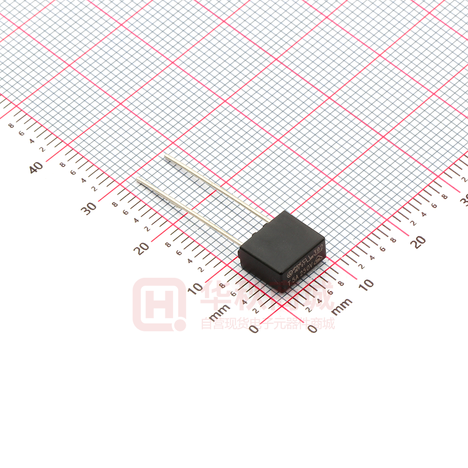

Radial Lead Fuses TE5 > Time-Lag Fuse > 392 Series 392 Series, TE5 Time-Lag Fuse RoHS Pb PS E Description TE5 Fuse, Time-Lag type, 250V rated, designed in accordance to IEC 60127-3. Features • Shock safe casing • Vibration resistant • Halogen free, Lead-free and RoHS compliant • Red Phosphorus Free • Reduced PCB space requirements • Direct solderable or plug-in versions • Internationally approved • Low internal resistance Applications Agency Approvals Agency PS E Agency File Number Ampere Range 126983 0.28A - 6.3A* 1606079 0.8A - 6.3A E67006 0.28A - 6.3A JET1896-31007-2002 1A - 5A CQC07012021162 0.8A - 6.3A SU05024 - 7013A SU05024 - 7014B SU05024 - 7015B SU05024 - 7016B SU05024 - 7017B SU05024 - 7018B 0.8A 1A - 2.5A 3.15A 4A 5A 6.3A • Industrial Controllers • Chargers • Battery Chargers • Consumer Electronics • Power supplies Additional Information Datasheet Samples Resources Electrical Characteristics for Series % of Ampere Rating 150% Opening Time 1 Hour, Min. 210% 120 s, Max. 275% 400 ms Min. ; 10 Sec. Max. 400% 150 ms Min. ; 3 Sec. Max. 1000% 20 ms Min. ; 150 ms Max. *Red Phosphorus Free from 0.28A to 5A. Electrical Characteristic Specifications by Item Agency Approvals Rated Current Amp Code Voltage Rating Breaking Capacity Nominal Cold Resistance (Ohms) Voltage Drop 1.0×IN max. (mV) Power Dissipation 1.5×IN max. (mW) Melting Integral 10×IN max. (A2s) 280 mA 0280 250V 35A@250VAC 0.3300 115 168 0.048 x 800 mA 0800 250V 0.0960 110 280 5.120 x x x x x 1.00 A 1100 250V 0.0715 115 400 8.00 x x x x x x 1.25 A 1125 250V 0.0569 100 500 11.95 x x x x x x 25A@250VAC PS E x 1.60 A 1160 250V 0.0400 95 600 18.43 x x x x x x 2.00 A 1200 250V 0.0298 90 700 29.00 x x x x x x 2.50 A 1250 250V 0.0240 85 750 47.81 x x x x x x 3.15 A 1315 250V 32A@250VAC 0.0170 80 1100 78.39 x x x x x x 4.00 A 1400 250V 40A@250VAC 0.0128 75 1200 126.40 x x x x x x 5.00 A 1500 250V 50A@250VAC 0.0101 70 1000 106.25 x x x x x x 6.30 A 1630 250V 63A@250VAC 0.0077 65 1200 160.74 x x x x x Notes: 1) 1.00 means the number one with two decimal places. 1,000 means the number one thousand. 2) Resistance is measured at 10% of rated current, 25ºC. © 2018 Littelfuse, Inc. Application testing is strongly recommended. Specifications are subject to change without notice. Revised: 12/10/18 Radial Lead Fuses TE5 > Time-Lag Fuse > 392 Series 140 100000 120 PERCENT OF RATING 0.800A 1.00A 1.25A 1.60A 2.00A 2.50A 3.15A 4.00A 5.00A 6.30A Average Time Current Curves 0.280A Temperature Re-rating Curve 100 10000 80 60 23ºC 40 1000 20 -60 -40 -20 0 20 40 60 80 100 TIME IN SECONDS 0 120 AMBIENT TEMPERATURE (°C) Note: 1. Rerating depicted in this curve is in addition to the standard derating of 25% for continuous operation. 100 10 1 0.1 0.01 0.001 0.20 1 10 100 1000 CURRENT IN AMPERES Soldering Parameters - Wave Soldering Recommended Process Parameters: 280 260 Wave Parameter 240 220 Preheat: 200 (Depends on Flux Activation Temperature) 180 160 140 120 100 80 60 40 Time (Seconds) Cooling Time Preheat Time Dwell Time © 2018 Littelfuse, Inc. Specifications are subject to change without notice. Revised: 12/10/18 240 230 220 210 200 190 180 170 160 150 140 130 120 110 90 100 80 70 60 50 40 30 20 0 10 20 0 Temperature (°C) - Measured on bottom side of board 300 Lead-Free Recommendation (Typical Industry Recommendation) Temperature Minimum: 100°C Temperature Maximum: Preheat Time: 150°C 60-180 seconds Solder Pot Temperature: 260°C Maximum Solder Dwell Time: 2-5 seconds Recommended Hand-Solder Parameters: Solder Iron Temperature: 350°C +/- 5°C Heating Time: 5 seconds max. Note: These devices are not recommended for IR or Convection Reflow process. Radial Lead Fuses TE5 > Time-Lag Fuse > 392 Series Product Characteristics Materials Base/Cap: Thermoplastic Polyamide PA 6.6, UL 94 V-0 Round Pins: Copper, Tin-plated Lead Pull Strength 10 N (IEC 60068-2-21) Solderability 260ºC, ≤ 3 sec. (Wave) 350ºC, ≤ 3 sec. (Soldering iron) Soldering Heat Resistance 260ºC, 10 sec. (IEC 60068-2-20) 350ºC, ≤ 3 sec. (Soldering iron) Operating Temperature Climatic Category Stock Condition Vibration Resistance Dimensions –40ºC to +125ºC (Consider re-rating) –40ºC to +85ºC/21 days (IEC 60068-1, -2-1, -2-2, -2-78) +10ºC to +60ºC Relative humidity ≤ 75% yearly average, without dew, maximum value for 30 days - 95% 24 cycles at 15 min. each (IEC 60068-2-6) 10 – 60Hz at 0.75mm amplitude 60 – 2000Hz at 10g acceleration Part Numbering System max. 4 8.5 0.6 5.08 1 +0.1 0.5 min L max. 8 392 xxxx 0000 Series 1.5 Amp Code Refer to Amp Code column of Electrical Characteristics Table Packaging Code 0000 Tape/Ammopack (1,400 pcs.) 0440 Short Leads - Bulk (1,400 pcs.) Holes in the printed circuit board Long Leads (L=18.8mm) Short Leads (L=4.3mm) Packaging Packaging Option Packaging Specification Quantity Quantity & Packaging Code Taping Width Tape and Ammopack Short Leads N/A N/A 1,400 1,400 0000 0440 N/A N/A Disclaimer Notice - Information furnished is believed to be accurate and reliable. However, users should independently evaluate the suitability of and test each product selected for their own applications. Littelfuse products are not designed for, and may not be used in, all applications. Read complete Disclaimer Notice at: www.littelfuse.com/disclaimer-electronics. © 2018 Littelfuse, Inc. Specifications are subject to change without notice. Revised: 12/10/18 Mouser Electronics Authorized Distributor Click to View Pricing, Inventory, Delivery & Lifecycle Information: Littelfuse: 39212500000 39211250000 39208000000 39214000440 39212000440 39211000440 39213150000 39208000440 39214000000 39212500440 39212000000 39211250440 39211000000 39211600000 39211600440 39202800000 39213150440 39215000000 39216300000 39215000440 39000320000 38706300000
