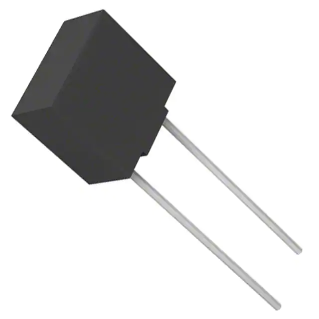

    HAMLIN
    插件,P=5.08mm
    一次性保险丝(熔断) 630mA 125V
39606300000 数据手册
Radial Lead Fuses TE5® > Time-Lag Fuse > 396 Series 396 Series, TE5® Time-Lag Fuse RoHS Pb PS E Description The 396 Series TE5® fuses are time-lag type, 125V rated, and are designed in accordance to UL 248-14. Features PS E • Internationally approved • Reduced PCB space requirements • Shock safe casing Agency File Number Ampere Range E67006 0.05A - 6.3A E67006 0.05A - 6.3A JET1896-31007-1005 1A - 5A • Low internal resistance • Vibration resistant • Direct solderable or plug-in versions Agency Approvals Agency • Halogen free, Lead-free and RoHS compliant • Available from 0.05A to 6.3A Applications • Battery chargers • Power supplies • Consumer Electronics • Industrial controllers Additional Information Electrical Characteristics % of Ampere Rating Opening Time 200% 60 Seconds, Max. Datasheet Samples Resources Electrical Characteristics Amp Code Rated Current Voltage Rating 0050 0063 0080 0100 0125 0160 0200 0250 0315 0400 0500 0630 0800 1100 1125 1160 1200 1250 1315 1400 1500 1630 50mA 63mA 80mA 100mA 125mA 160mA 200mA 250mA 315mA 400mA 500mA 630mA 800mA 1.00A 1.25A 1.60A 2.00A 2.50A 3.15A 4.00A 5.00A 6.30A 125V 125V 125V 125V 125V 125V 125V 125V 125V 125V 125V 125V 125V 125V 125V 125V 125V 125V 125V 125V 125V 125V Breaking Capacity Nominal Cold Resistance (Ohms) Voltage Drop 1.0×IN max. (mV) Power Dissipation 1.0×IN max. (mW) Melting Integral 10×IN max. (A2s) 100A@125 VAC 12.5000 8.7900 6.0090 3.8400 2.9000 1.7700 1.2000 0.7500 0.5450 0.3750 0.2470 0.1850 0.1250 0.0868 0.0666 0.0502 0.0398 0.0297 0.0216 0.0164 0.0112 0.0087 900 800 700 600 550 480 390 350 300 250 220 210 160 155 145 130 125 120 110 110 95 95 45 50 55 60 70 80 80 90 95 100 110 135 130 155 185 210 250 300 350 400 475 570 0.011 0.017 0.02 0.04 0.05 0.09 0.14 0.26 0.32 0.58 0.86 1.15 1.92 3.25 4.69 6.76 11.90 17.81 26.29 38.40 71.25 144.87 Agency Approvals PS E x x x x x x x x x x x x x x x x x x x x x x x x x x x x x x x x x x x x x x x x x x x x x x x x x x x x Notes: 1) 1.00 means the number one with two decimal places. 1,000 means the number one thousand. 2) Resistance is measured at 10% of rated current, 25ºC. © 2016 Littelfuse, Inc. Application testing is strongly recommended. Specifications are subject to change without notice. Revised: 01/06/16 Radial Lead Fuses TE5® > Time-Lag Fuse > 396 Series 140 1.00A 1.25A 1.60A 2.00A 2.50A 3.15A 4.00A 5.00A 6.30A 0.630A 0.800A 0.250A 0.315A 0.400A 0.500A Average Time Current Curves 0.050A 0.063A 0.080A 0.100A 0.125A 0.160A 0.200A Temperature Re-rating Curve 100000 PERCENT OF RATING 120 100 10000 80 60 1000 40 23°C TIME IN SECONDS 20 0 -40 -20 0 20 40 80 60 AMBIENT TEMPERATURE (°C) Note: 1. Rerating depicted in this curve is in addition to the standard derating of 25% for continuous operation. 100 10 1 0.100 0.010 0.001 0.02 0.100 1 10 100 CURRENT IN AMPERES Soldering Parameters - Wave Soldering Recommended Process Parameters: 280 260 Wave Parameter 240 220 Preheat: 200 (Depends on Flux Activation Temperature) 180 160 140 120 100 80 60 40 Lead-Free Recommendation (Typical Industry Recommendation) Temperature Minimum: 100°C Temperature Maximum: Preheat Time: 150°C 60-180 seconds Solder Pot Temperature: 260°C Maximum Solder Dwell Time: 2-5 seconds Time (Seconds) Cooling Time Preheat Time Dwell Time 240 230 220 210 200 190 180 170 160 150 140 130 120 110 90 100 80 70 60 50 40 30 20 0 10 20 0 Temperature (°C) - Measured on bottom side of board 300 Recommended Hand-Solder Parameters: Solder Iron Temperature: 350°C +/- 5°C Heating Time: 5 seconds max. Note: These devices are not recommended for IR or Convection Reflow process. © 2016 Littelfuse, Inc. Specifications are subject to change without notice. Revised: 01/06/16 Radial Lead Fuses TE5® > Time-Lag Fuse > 396 Series Product Characteristics Materials Base/Cap: Brown Thermoplastic Polyamide PA 6.6, UL 94 V-0 Round Pins: Copper, Tin-plated Lead Pull Strength 10 N (IEC 60068-2-21) Solderability 260ºC, ≤ 3s. (Wave) 350ºC, ≤ 1s. (Soldering Iron) Soldering Heat Resistance 260ºC, 10s. (IEC 60068-2-20) 350ºC, 3s. (Soldering Iron) -40ºC to +85ºC (Consider re-rating) Operating Temperature -40ºC to +85ºC/21 days (IEC 60068-1,-2-1,-2-2,-2-78) +10ºC to +60ºC RH ≤ 75% yearly average, without dew, maximum value for 30 days95% 24 cycles at 15 min. each (IEC 60068-2-6) 10 - 60Hz at 0.75mm amplitude 60 - 2000Hz at 10g acceleration Climatic Category Stock Conditions Vibration Resistance Part Numbering System Dimensions 396 xxxx 0000 max.4 Series 5,08 0,5 min Amp Code Æ 0,6 Refer to Amp Code column of Electrical Characteristics Table 1,5 Packaging Code 0000 Tape/Ammopack (1,400 pcs.) 0440 Short Leads - Bulk (1,400 pcs.) 1 +0,1 L max. 8 8,5 Holes in the printedin circuit board Holes PCB Long Leads (L=18.8mm) Short Leads (L=4.3mm) Packaging Packaging Option 396 Series Tape & Ammopack Short Leads Packaging Specification Quantity Quantity & Packaging Code Taping Width N/A N/A 1,400 1,400 0000 0440 N/A N/A © 2016 Littelfuse, Inc. Specifications are subject to change without notice. Revised: 01/06/16
