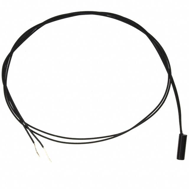

    59010 Firecracker干簧管传感器是一款超小型圆柱形干簧管传感器,尺寸为长9.0mm、直径3.0mm(0.354英寸×0.118英寸),具有常开触点。它能够在10W功率下切换高达170Vd...
59010-1-S-02-F 数据手册
Reed Sensors Firecracker > 59010 59010 Sub-Miniature Firecracker Reed Sensor + 57020 Actuator Description The 59010 Firecracker Reed Sensor is a sub-miniature cylindrical reed sensor 9.0mm L x 3.0mm Dia. (0.354” x 0.118”) with a normally open contact. It is capable of switching up to 170Vdc at 10W and has cable length and connector options. It functions best with the 57020-000 actuator. Sensors Note: The 57020 Actuator is sold separately. Features • Magnetically operated proximity sensor • Compact size requires only 3mm diameter hole Actuator • Hermetically sealed contacts • Custom cable length and connector options available Benefits Dimensions • Well suited for usage in highmoisture and contaminated environments • Non-contact solution, aesthetically more appealing than push-button or lever mechanical-type switches • Simple installation and adjustment • No standby power requirement Dimensions in mm (inch) A A B A Nom. • Ideal for battery-powered applications as the contacts do not draw power when in the nonactivated state • Reed contacts last for millions of operating cycles under microcontroller logic-level loads C B Nom. C Nom. mm(in) mm(in) mm(in) 57020 Actuator 5.10 (.201) 15.24 (.600) -- 59010 Sensor 3.00 (.118) 9.00 (.354) Cable Length ±10.00 (.393) © 2019 Littelfuse Revised: 02/08/19 Specifications are subject to change without notice. Applications • Position and Limit Sensing • Security System Switch • Level Sensing • Linear Actuators littelfuse.com Reed Sensors Firecracker > 59010 59010 Sub-Miniature Firecracker Reed Sensor + 57020 Actuator Electrical Ratings Contact Type Normally Open Switch Type 1 VA/Watt - max. 5 Vdc - max. Vac - max. Vdc - min. 175 140 200 Carry Adc - max. Aac - max Adc - max. 0.35 0.25 0.50 Contact, Initial Insulation Ω - max. Ω - min. 0.550 1012 Capacitance Contact pF - typ. 0.45 Temperature Operating °C -40 to +85 Contact Rating 1 Switching Voltage 2 4 Breakdown Switching Current 3 2 4 Resistance 5 Product Characteristics Operate Time 6 ms - max. 0.35 Release Time 6 ms - max. 0.03 11ms 1⁄2 sine G - max. 50 10-2000 Hz G - max. 10 Shock 7 Vibration 7 Notes: 1. Contact rating - Product of the switching voltage and current should never exceed the wattage rating. Contact Littelfuse for additional load/life information. 2. When switching inductive and/or capacitive loads, the effects of transient voltages and/or currents should be considered. Refer to Application Notes AN108A and AN107 for details. 3. Breakdown Voltage - per MIL-STD-202, Method 301. 4. Electrical Load Life Expectancy - Contact Littelfuse with voltage, current values along with type of load. 5. This resistance value is for 11.81mm wire length. Resistance changes when wire lengthens. 6. Operate (including bounce)/Release Time - per EIA/NARM RS-421-A, diode suppressed coil (Coil II). 7. Shock and Vibration - per EIA/NARM RS-421-A and MIL-STD-202. 8. For custom modifications to the wire length or size, or adding a special connector, please contact Littelfuse. Sensitivity Options (Using 57020 Actuator) Select Option S Switch Type 1 Normally Open T Pull-In AT Range Activate Distance - D mm (inch) Average Pull-In AT Range Activate Distance - D mm (inch) Average 6-10 6.3 (.248) 10-15 4.9 (.193) Note: 1. Pull-In AT Range: These AT values are the bare reed switch AT before modification. 2. The activation distance is average value on the final sensor assembly. Sensor Actuator D © 2019 Littelfuse Revised: 02/08/19 Specifications are subject to change without notice. littelfuse.com Reed Sensors Firecracker > 59010 59010 Sub-Miniature Firecracker Reed Sensor + 57020 Actuator Cable Length Specification Part Numbering System (Cable Type 30 AWG 7/38 PTFE 200ºC MIL-W-16878/6) Select Option Cable Length mm (inch) 02 300 (11.81) Sensor: 59010 - 1 - X - XX - X Series Termination Options Select Option Description A Tinned Leads F Untinned Leads Switch Type Sensitivity S or T Cable Length 02 Termination A or F 57020 - 000 Actuator: Series Standard Actuator 000 Note: The 57020 Actuator is sold separately. Packaging Packaging Option Bulk Packaging Specification Bulk Quantity 500 Quantity & Packaging Code N/A Taping Width N/A Disclaimer Notice - Information furnished is believed to be accurate and reliable. However, users should independently evaluate the suitability of and test each product selected for their own applications. Littelfuse products are not designed for, and may not be used in, all applications. Read complete Disclaimer Notice at www.littelfuse.com/disclaimer-electronics. © 2019 Littelfuse Revised: 02/08/19 Specifications are subject to change without notice. littelfuse.com
59010-1-S-02-F
物料型号: - 传感器型号:59010 - 执行器型号:57020
器件简介: - 59010 Firecracker Reed Sensor是一个亚微型圆柱形传感器,尺寸为9.0mm x 3.0mm,具有常开触点,可切换高达170Vdc的10W功率,并提供电缆长度和连接器选项。
引脚分配: - 文档中未明确提供引脚分配信息。
参数特性: - 工作温度范围:-40°C 至 +85°C - 操作时间:最大0.35毫秒 - 释放时间:最大0.03毫秒 - 抗冲击:50G(11ms/正弦波) - 抗振动:10g(10-2000Hz)
功能详解: - 磁控接近传感器,适用于高湿度和污染环境,无需接触,美观且易于安装和调整,无待机功耗,适用于电池供电应用。
应用信息: - 位置和限制感应 - 安全系统开关 - 液位感应 - 线性执行器
封装信息: - 电缆类型:30 AWG 7/38 PTFE,耐温200ºC,符合MIL-W-16878/6标准。
