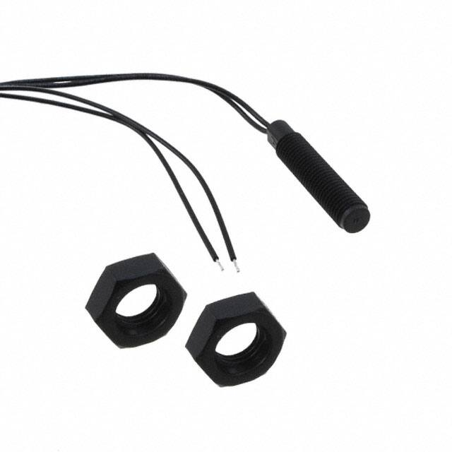

www.hamlin.com File E61760(N) 59065 & 59070 Threaded Barrel Features and Benefits Features • 2 part magnetically operated proximity sensor • Threaded barrel with retaining nuts • Available as M8 (57070/59070) or 5/16 (57065/59065) size options • Customer defined sensitivity • Choice of cable length and connector Benefits • Simple installation and adjustment using supplied retaining nuts • No standby power requirement • Operates through non-ferrous materials such as wood, plastic or aluminium • Simple installation and adjustment Applications • • • • Position and limit sensing Security system switch Linear actuators Industrial process control Actuator Sensor DIMENSIONS (in) mm SCHEMATICS Black Black Black Blue White Black Black Switch Type 1&2 3 4 CUSTOMER OPTIONS - Switching Specifications TABLE 1 Contact Type Switch Type Power Voltage Current Resistance Capacitance Temperature Time Shock Vibration Switching Breakdown Switching Carry Contact, Initial Insulation Contact Operating Storage Operate Release 11ms 1⁄2 sine 50-2000 Hz Watt - max. Vdc - max. Vdc - min. A - max. A - max. Ω - max. Ω - min. pF - typ. °C °C ms - max. ms - max. G - max. G - max. Form A Normally Open 1 10 200 250 0.5 1.2 0.2 1010 0.3 -40 to +105 -65 to +105 1.0 1.0 100 30 Normally Open High Voltage 2 10 300 450 0.5 1.5 0.2 1010 0.2 -20 to +105 -65 to +105 1.0 1.0 100 30 Change Over 3 5 175 200 0.25 1.5 0.2 109 0.3 -40 to +105 -65 to +105 3.0 3.0 50 30 Normally Closed 4 5 175 200 0.25 1.5 0.2 109 0.3 -40 to +105 -65 to +105 3.0 3.0 50 30 CUSTOMER OPTIONS - Sensitivity, Cable Length and Termination Specification TABLE 2 Sensitivity Options:Activate Distances are approximate using Hamlin 57065/57070 actuator as illustrated Switch AT before modification TABLE 3 Cable Type:24 AWG 7/32 PVC 105oC UL1430/UL1569 TABLE 4 Termination Options:SELECT OPTION DESCRIPTION (2 WIRE VERSIONS ILLUSTRATED) Standard Lengths SELECT OPTION CABLE LENGTH A or F B C D E Tinned or untinned leads Crimped terminals 6.35mm fastons AMP MTE 2.54mm pitch JST XHP 2.5mm pitch Select Option Switch Type 1 2 3 4 S Pull In AT Range Activate Distance d (in) mm (.354) 9,0 (.295) 7,5 Pull In AT Range 17-23 20-25 T Activate Distance d (in) mm (.276) 7,0 (.236) 6,0 Pull In AT Range 22-28 25-30 U Activate Distance d (in) mm (.236) 6,0 (.197) 5,0 Pull In AT Range 27-33 V Activate Distance d (in) mm (.177) 4,5 01 02 03 04 05 (in) mm (3,94) 100 (11,81) 300 (19,69) 500 (29,53) 750 (39,37) 1000 Normally Open 12-18 High Voltage Change Over 15-20 Normally Closed ORDERING INFORMATION N.B. 57065/57070 actuator sold separately 59065/59070 59036 X X XX X Series 59065/59070 Table 1 Switch Type Table 2 Sensitivity Table 3 Cable Length Termination Hamlin USA Hamlin UK Hamlin Germany Hamectrol France ISSUE No: 4 DATE: 1/5/3 Table 4 DETAILS PROVIDED ON THIS DATA SHEET ARE PROVIDED FOR INFORMATION PURPOSES ONLY AND SHOULD NOT BE RELIED UPON AS BEING ACCURATE FOR ANY PARTICULAR PURPOSE. Product performance may be affected by the application to which the product is put. Upon request, HAMLIN will assist purchasers by providing information specific to any particular application. HAMLIN disclaims any and all liability whatsoever for any purchaser’s reliance upon the information contained on this data sheet without further consultation with authorised representatives of HAMLIN. Tel: Tel: Tel: Tel: +1 920 648 3000 • Fax: +1 920 648 3001 • Email: sales.us@hamlin.com +44 (0)1379 649700 • Fax: +44 (0)1379 649702 • Email: sales.uk@hamlin.com +49 (0) 6181 953660 • Fax: +49 (0) 6181 9536666 • Email: sales.de@hamlin.com +33 (0) 1 4687 0202 • Fax: +33 (0) 1 4686 6786 • Email: sales.fr@hamlin.com 27
