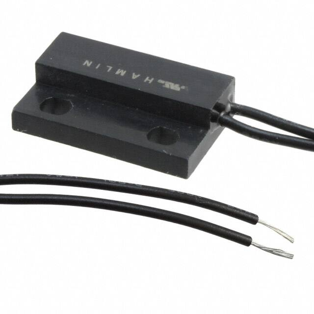

    HAMLIN
    SENSOR REED SW SPST-NO W LEADS
59140-010 数据手册
www.breedelectronics.com 59140 Mini Flange Mount Features and Benefits File E61760(N) 57140 Actuator 59140 Sensor F eatures Benefits Applications • 2 Part Magnetically Operated • No standby power Proximity Sensor • Compact size requires only 3.2cm2 board space • Case design allows screw down or adhesive mounting • 300mm (12”) Flying leads requirement • Operates through non-ferrous materials such as wood,plastic or aluminium • Hermetically sealed, magnetically operated contacts continue to operate long after optical and other technologies fail due to contamination • Simple installation and adjustment • • • • Position and limit sensing Security system switch Linear actuators Door switch DIMENSIONS Recommended Activating Positions: Sensors and Matching Actuators (Note 2) Must Actuator Sensor Must Actuate Release .175 (4,44) .800 (20,32) 57140-000 59140-010 Electrical Specifications and Operating Characteristics Contact Type 59140-030 F orm A, Form A F orm C SPST-NO SPST-NO SPDT-CO High Volta ge Standar d Standar d Contact Rating 59140-020 59140-040 Form B SPST-NC Standar d Watt - max. 10 10 5 5 Switching Vdc - max. 200 300 175 175 Breakdown Vdc - min. 250 450 200 200 A - max. 0.5 0.5 0.25 0.25 Carry A - max. 1.2 1.5 1.5 1.5 Contact,Initial Ω - max. 0.2 0.2 0.2 0.2 Insulation Ω - min. 1010 1010 109 109 Capacitance Contact p F - typ. 0.3 0.2 0.3 0.3 Temperature Operating °C -40 to + 105 -20 to + 105 -40 to + 105 -40 to + 105 Storage °C -65 to + 105 -65 to + 105 -65 to + 105 -65 to + 105 Operate ms - typ. 1.0 1.0 1.0 1.0 Release ms - typ. 1.0 1.0 1.0 1.0 Shock 11ms 1⁄2 sine G - max. 100 100 50 50 Vibration 50-2000 Hz G - max. 30 30 30 30 Voltage Current Switching Resistance Time Notes: 1.Flying Leads except as shown below are 24 AWG 7/32 PVC , 105 deg. C.,UL 1569.Leads are stripped .250 (6,35),untinned. 2.Order Actuators as a separate item. INFORMATION PROVIDED ON THIS DATA SHEET IS PROVIDED FOR 3. Underwriters Laboratories recognition. For details on electrical specifications,contact Hamlin,Inc. Breed Electronics USA Breed Electronics UK Tel: 001 920 648 3000 • Fax:001 920 648 3001 • Email: sales@hamlin.com Tel: +44 (0)1379 649700 • Fax:+44 (0)1379 649702 • Email: uksales@breedtech.com Breed Electronics German y Tel: +49 (0) 6181 953660 • Fax:+49 (0) 6181 9536666 • Email: hamlin-electronics.de@breedtech.com Breed Electronics France Tel: +33 1 46 87 02 02 • Fax:+33 1 46 86 67 86 • Email: hamectrol@hamectrol.fr PA GE 1 OF 1 ISSUE No:1 DATE:08/12/00 INFORMATION PURPOSES ONLY AND SHOULD NOT BE RELIED UPON AS BEING ACCURATE FOR ANY PARTICULAR PURPOSE. Product performance may be affected by the application to which the product is put. Upon request,HAMLIN will assist purchasers by providing information specific to any particular application.HAMLIN disclaims any and all liability whatsoever for any purchaser’s reliance upon the information contained on this data sheet without further consultation with authorised representatives of HAMLIN. SIGNED:Antony Howell
