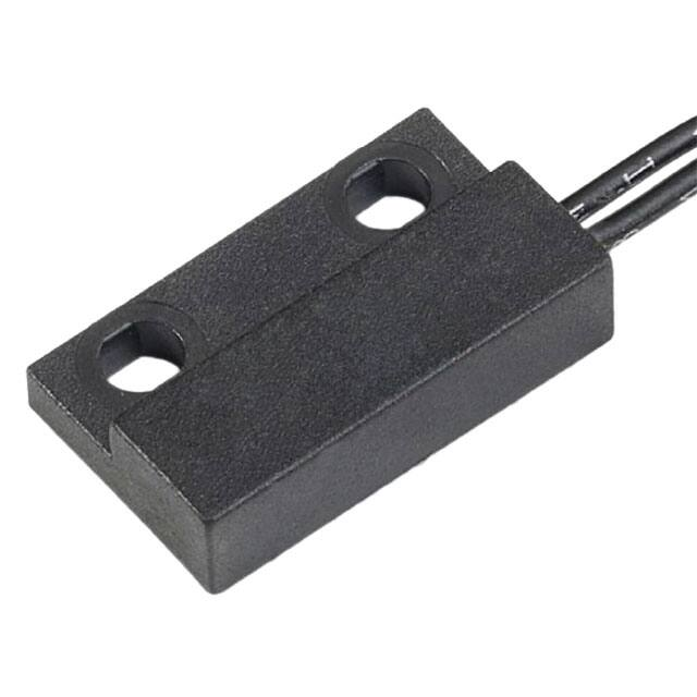

www.hamlin.com ® File E61760(N) 59140 and 59141 MINI FLANGE MOUNT SERIES Benefits Applications Features Magnetically operated position sensor No standby power requirement Position and limit sensing Matching actuator available Operates through non-ferrous Security system switch materials such as wood, plastic Compact size requires only 3.2cm² Linear actuators or aluminium board space Door switch Hermetically sealed, magnetically Screw down or adhesive mounting operated contacts continue to Customer defined sensitivity operate long after optical and other Choice of cable length and connector technologies fail due to contamination Leads can exit from LH or RH side DIMENSIONS (in) mm Actuator (.236) 6.00 (.906) 23.00 SCHEMATICS Sensor (2 wire versions) (.236) 6.00 (.906) 23.00 (Not including encapsulant) Table3 ±(.393) 10.00 (.250) 6.35 Nom. (.295) (.295) (.433) (.433) 11.00 (.551) (.551) 14.00 14.00 11.00 Switch Types 1 & 2 Black Black Switch Type 3 Black Blue White 7.50 7.50 (.118) 3.00 Slot (.126x.150) 3.20x3.81 Typ. (.551) 14.00 (.118) 3.00 Slot (.126x.150) 3.20x3.81 Typ. (.551) 14.00 Note: 59140 shown 59141 leads exit opposite side Switch Type 4 Black Black CUSTOMER OPTIONS - Switching Specifications TABLE 1 Switch Type Select Option Contact Type Contact Rating Voltage Power Switching Breakdown Current Switching Carry Resistance Contact, Initial Insulation Temperature Operating Storage Time Operate Release Capacitance Shock Vibration Contact 11ms ½ sine 50-2000 Hz. Watts - max Vdc - max. Vdc - min. A - max. A - max. Ohms - max. Ohms - min. °C °C ms - max. ms - max. pF - typ. G - max. G - max. 1 Normally Open 10 200 250 0.5 1.2 0.2 1010 -40 to +105 -65 to + 105 1.0 1.0 0.3 100 30 2 Normally Open High V. 10 300 450 0.5 1.5 0.2 1010 -20 to +105 -65 to +105 1.0 1.0 0.2 100 30 3 Change Over 5 175 200 0.25 1.5 0.2 10 9 -40 to +105 -65 to +105 3.0 3.0 0.3 50 30 4 Normally Closed 5 175 200 0.25 1.5 0.2 10 9 -40 to +105 -65 to +105 3.0 3.0 0.3 50 30 CUSTOMER OPTIONS - Sensitivity, Cable Length and Termination Specifications TABLE 2 Sensitivity d TABLE 3 Cable Length TABLE 4 Select Option Termination (2 wire versions shown) Description Diagram Activate distances (d) are approximate using Hamlin 57140-000 actuator as illustrated. Switch AT before modification Select Option (Cable 24AWG 7/32 PVC 105°C UL1430 / ULl569) Select Option Length(in)mm A C D E Tinned leads 6.35mm fastons AMP MTE 2.54mm JST XHP 2.5mm 01 02 U V (3.94) 100 (11.81) 300 (19.69) 500 (29.53) 750 (39.37) 1,000 S T Pull-In Activate Pull-In Activate Pull-In Activate Pull-In Activate AT Distance AT Distance AT Distance AT Distance Range (d) Range (d) Range (d) Range (d) (in)mm (in)mm (in)mm (in)mm 12-18 (.453) 11.5 15-20 (.413) 10.5 17-23 (.374) 9.5 (.354) 9.0 22-28 (.315) 8.0 (.295) 7.5 27-33 (.295) 7.5 03 04 05 1 2 3 4 Hamlin USA Hamlin UK Hamlin Germany Hamectrol France Switch Type F Untinned leads ORDERING INFORMATION Series 59140/59141 Switch Type Sensitivity Cable Length Termination 59140/59141 X X XX X 20-25 25-30 Table 1 (1, 2, 3 or 4) Table 2 (S, T, U or V) Table 3 (01, 02, 03, 04 or 05) Table 4 (A, C, D, E or F) Tel: +1 920 648 3000 Fax: +1 920 648 3001 Email: sales.us@hamlin.com DETAILS ON THIS DATA SHEET ARE PROVIDED FOR INFORMATION PURPOSES ONLY & SHOULD NOT BE RELIED UPON AS BEING ACCURATE FOR ANY PARTICULAR PURPOSE Tel: +44 (0) 1379 649700 Fax: +44 (0) 1379 649702 Email: sales.uk@hamlin.com Product performance may be affected by the application that the part is used for. Upon request Hamlin will assist purchasers by providing information specific to a particular application. liability whatsoever for any purchaser’s reliance upon the information Tel: +49 (0) 6181 953660 Fax: +49 (0) 6181 9536666 Email: sales.de@hamlin.com Hamlin disclaims allsheet without further consultation with Hamlin’s authorised representatives. contained in this data Tel: +33 (0) 1 4687 Fax: +33 (0) 1 4686 6798 Email: sales.fr@hamlin.com Issue:AB 05/02/09 DCR:B6092
