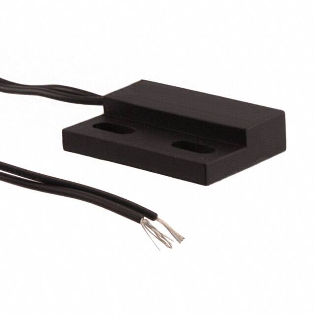

    是一种法兰安装的舌簧传感器,尺寸为 28.55mm x 19.05mm x 6.35mm (1.125" x 0.750" x 0.250"),有常开、常开高压、常闭或转换触点可供选择。其外壳设计允许...

Reed Sensors Flange Mounting Sensor > 59150 59150 Flange Mount Sensor + 57150 Actuator Description The 59150 is a flange mounting reed sensor 28.57mm x 19.05mm x 6.35mm (1.125” x 0.750” x 0.250”) with a choice of normally open, normally open high voltage, normally closed or changeover contacts. Its case design enables screw or adhesive mounting and the wires exit from top right hand side. It is also available with left hand exit - see 59145 Series. It is capable of switching up to 265Vac/300Vdc at 10VA. The 59150 functions best with the matching actuator 57150-000. Actuator Note: The 57150 Actuator is sold separately. Sensor Features • Two-part magnetically operated proximity sensor • Case design allows screw down or adhesive mounting Agency Approvals Agency • Customer defined sensitivity • Choice of cable and connector • RoHS compliant Agency File Number Benefits E61760 • Hermetically sealed, magnetically operated contacts continue to operate long after optical and other technologies fail due to contamination Note: Contact Littelfuse for specific agency approval ratings. Dimensions • No standby power requirement • Operates through non-ferrous materials such as wood, plastic or aluminium • Simple installation and adjustment Dimensions in mm (inch) Applications 28.57 (1.125) 14.28 (.562) 9.53 (.375) Actuator 19.05 (.75) 15.88 (.625) 300 (11.81) 6.35 (.250) NOM. • Position and limit sensing • Security system switch • Linear actuators • Door switch 3.43 (.135) 3.18x7.82 (.125x.308 LG.) SLOT 2 6.35 (.250) 28.57 (1.125) Sensor 15.88 (.625) 3.18x7.82 (.125x.308 LG.) SLOT 2 9.53 (.375) 14.28 (.562) 19.05 (.75) 6.35 (.250) 3.43 (.135) 6.35 (.250) Schematics Switch Type Black Black Black Blue White Black Black © 2019 Littelfuse Revised: 04/29/19 Specifications are subject to change without notice. 1 and 2 3 4 littelfuse.com Reed Sensors Flange Mounting Sensor > 59150 59150 Flange Mount Sensor + 57150 Actuator Electrical Ratings Normally Open Contact Type Switch Type Normally Open High Voltage Change Over Normally Closed 1 2 3 4 VA/Watt - max. 10 10 5 5 Vdc - max. Vac - max. Vdc - min. 200 140 250 300 265 400 175 120 200 175 120 200 Carry Adc - max. Aac - max. Adc - max. 0.5 0.35 1.2 0.4 0.30 1.4 0.25 0.18 1.5 0.25 0.18 1.5 Contact, Initial Insulation Ω - max. Ω - min. 0.2 1010 0.2 1010 0.2 109 0.2 109 Capacitance Contact pF - typ. 0.3 0.2 0.3 0.3 Temperature Operating °C -40 to +105 -20 to +105 -40 to +105 -40 to +105 Contact Rating Voltage 4 Current 4 1 Switching 2 Breakdown Switching Resistance 5 3 2 Product Characteristics Operate Time 6 ms - max. 1.0 1.0 3.0 3.0 Release Time 6 ms - max. 1.0 1.0 3.0 3.0 11ms 1⁄2 sine G - max. 100 100 50 50 50-2000 Hz G - max. 30 30 30 30 Shock 7 Vibration 7 Notes: 1. Contact rating - Product of the switching voltage and current should never exceed the wattage rating. Contact Littelfuse for additional load/life information. 2. When switching inductive and/or capacitive loads, the effects of transient voltages and/or currents should be considered. Refer to Application Notes AN108A and AN107 for details. 3. Breakdown Voltage - per MIL-STD-202, Method 301. 4. Electrical Load Life Expectancy - Contact Littelfuse with voltage, current values along with type of load. 5. This resistance value is for 11.81mm wire length. Resistance changes when wire lengthens. 6. Operate (including bounce)/Release Time - per EIA/NARM RS-421-A, diode suppressed coil (Coil II). 7. Shock and Vibration - per EIA/NARM RS-421-A and MIL-STD-202. 8. For custom modifications to the wire length or size, or adding a special connector, please contact Littelfuse. Sensitivity Options (Using 57150 Actuator) Select Option Switch Type S T U Pull-In AT Range Activate Distance - D mm (inch) Average Pull-In AT Range Activate Distance - D mm (inch) Average Pull-In AT Range Activate Distance - D mm (inch) Average V Pull-In Activate Distance - D AT mm (inch) Range Average 1 Normally Open 12-18 13.5 (.531) 17-23 11.2 (.441) 22-28 9.8 (.385) 27-33 9.0 (.357) 2 High Voltage -- -- 17-23 11.2 (.441) 22-28 9.8 (.385) 27-33 9.0 (.357) 3 Change Over 15-20 11.0 (.433) 20-25 9.2 (.362) 25-30 8.5 (.335) -- -- 4 Normally Closed 15-20 11.0 (.433) 20-25 9.2 (.362) 25-30 8.5 (.335) -- -- Note: D 1. Pull-In AT Range: These AT values are the bare reed switch AT before modification. © 2019 Littelfuse Revised: 04/29/19 Specifications are subject to change without notice. Sensor Actuator 2. The activation distance is average value on the final sensor assembly. littelfuse.com Reed Sensors Flange Mounting Sensor > 59150 59150 Flange Mount Sensor + 57150 Actuator Part Numbering System Cable Length Specification Sensor: Cable Type: 24 AWG 7/32 PVC 105°C UL1430/UL1569 Select Option Cable Length mm (inch) 02 300 (11.81) 59150 - X - X - XX - X Series Termination Specification Switch Type 1, 2, 3, or 4 Termination Options Select Option Sensitivity S, T, U, or V Description (Two-wire versions illustrated) A Tinned leads (6.4±0.76)mm F Untinned leads (6.4±0.76)mm E JST type XHP 2.5mm pitch Cable Length 02 Termination A, E, or F Actuator: 57150 - 000 Series Standard Actuator 000 Note: The 57150 Actuator is sold separately. Packaging Packaging Option Packaging Specification Bulk Bulk Quantity 500 Quantity & Packaging Code N/A Taping Width N/A Disclaimer Notice - Information furnished is believed to be accurate and reliable. However, users should independently evaluate the suitability of and test each product selected for their own applications. Littelfuse products are not designed for, and may not be used in, all applications. Read complete Disclaimer Notice at www.littelfuse.com/disclaimier-electronics. © 2019 Littelfuse Revised: 04/29/19 Specifications are subject to change without notice. littelfuse.com

物料型号:59150型法兰安装干簧管传感器和57150型执行器。
器件简介:59150型传感器是一个法兰安装的干簧管传感器,具有多种接触类型选择,包括常开、常开高压、常闭或转换接触。它采用密封设计,即使在光学和其他技术因污染而失效后,也能继续工作。
引脚分配:文档中提供了电路图和开关类型,但未明确列出具体的引脚分配
参数特性:传感器能够承受高达265Vac/300Vdc的电压,功率为10VA。它还具有多种电气额定值,包括接触类型、电压、电流、电阻、电容和操作温度范围。
功能详解:59150型传感器适用于位置和限位检测、安全系统开关、线性执行器和门开关等多种应用。
应用信息:传感器适用于多种应用场景,包括但不限于位置和限位感应、安全系统开关、线性执行器和门开关。
封装信息:传感器的尺寸为28.57mm x 19.05mm x 6.35mm,具有简单的安装和调整方式。
