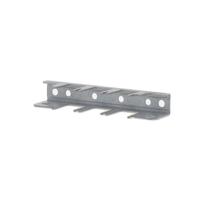

C0310 数据手册
F Series Pushbutton Switches ganging configurations Typical Applications • Audio selection • Digital equipment interface • Medical equipment interface A Pushbutton Features/Benefits Up to 10 poles per module •  •  Various contact terminals •  Various mounting & switch •  Mechanical indicator buttons •  RoHS compliant Specifications SWITCHING POWER: F module max. AC/DC: Silver: 50 VA/15W, Gold: 1 VA/300 mW. SWITCHING VOLTAGE: F module max. AC/DC: Silver: 125/30V, Gold: 50/30 V. SWITCHING CURRENT: F module max. AC/DC: Silver: 0.5A/0.5A, Gold: 0.04A/0.01A. CARRYING CURRENT: Max at ∆u = 20°C: Silver: < 2A, Gold: 105 operations “GR”: >3.5 x 104 operations. OPERATING TEMPERATURE RANGE: -40˚C to 70˚C. CONTACT RESISTANCE: Initial: Typical ≤10 mΩ, max. 20 mΩ After operating life: ≤100 mΩ INSULATION RESISTANCE: ≥109 Ω between open contacts, ≥109 Ω between chassis and contacts. MOVABLE CONTACTS: Bimetal brass, silver plated, gold plate over nickel. STATIONARY CONTACTS & TERMINALS: Brass, silver plated, gold plated. CAPACITANCE (at f = 10 kHz): ≤0.7 pF between 2 contacts. TERMINAL BOARD: Polyester UL 94V-0. TOTAL TRAVEL/LATCHING TRAVEL: 4.7mm/3.3mm (.185 inch/ .130 inch). RETURN SPRING: Music wire. All models and options are RoHS compliant and compatible. Materials HOUSING: Polycarbonate UL 94V-0 or polyester UL 94V-0. ACTUATOR: Polyester UL 94V-0. TERMINAL SEAL: RTV adhesive sealant. CHASSIS: Steel. NOTE: All models and options are RoHS compliant and compatible. LOCKOUT PIN: Steel. NOTE: Specifications and materials listed above are for switches with standard options. For information on specific and custom switches, consult Customer Service Center. BLOCKERS: Steel. Build-A-Switch To order, simply select desired option from each category and place in the appropriate box. Available options are shown and described on pages A-88 thru A-95. For additional options not shown in catalog, consult Customer Service Center. If requesting only a switch, select either a North American or European switch as noted below. Chassis and buttons are sold separately. If multiple stations are selected, we will assume all switches are the same unless noted otherwise. North American Order Code - Switch Only Designation F F Series FLT Light touch F series ZF Central mounted F series Terminal Sealing (NONE) None TB Top/bottom Contact Arrangement 2U 2PDT Mechanical Function 4U 4PDT OA Momentary 6U 6PDT EE Alternate (push-push) 8U 8PDT GR Interlock 10U 1OPDT AOR Central release OASP Momentary with lockout GRSP Interlock with lockout Terminal Style (NONE) Solder lugs & PC pins 01A Cut solder lugs 01B Cut PC pins, for other configurations, consult factory Electrical Function (NONE) BBM Break-Before-Make M MBB (special) Make-Before-Break Contact Material (NONE) Silver, AG AU Gold Dress nut* *Central mounted F series only (NONE) No dress nut B Black C Chrome Dimensions are shown: Inches (mm) Specifications and dimensions subject to change 29 may 19 A-87 www.ckswitches.com F Series Pushbutton Switches Pushbutton A European Order Code - Switch Only Designation SF F Series ZF Central mounted F series Terminal Style (NONE) Solder lugs & PC pins LB Cut solder lugs PB Cut PC pins, for other configurations, consult factory Contact Arrangement 2U 2PDT Mechanical Function 4U 4PDT OA Momentary 6U 6PDT EE Alternate (push-push) 8U 8PDT GR Interlock Contact Material (NONE) Silver, AG P Gold Electrical Function (NONE) BBM Dress nut* *Central mounted F series only (NONE) No dress nut B Black C Chrome *Minimum order quantities apply. Order Code - Buttons Solid Buttons Style F01 FMR F02 FG* F12 FSC F13 FSD F14 FU12 F15 FSB F16 FE F19 FA F21 F001 Mechanical Indicator Buttons Style F01 FA100 F02 FA101 F07 FA120 F08 FA2O1 F11 FA200* Button Color 01 Black 02 White 03 Red 04 Light gray Shell Color 01 Black Out Position Color 01 Black In Position Color 02 White 06 Yellow 07 Blue 08 Green 12 Orange *Button options for central mounting configurations, use ‘FG’ for central mount with chrome dress nut, use ‘FA200’ for central mount with black dress nut. BUTTON REMOVAL A button of a push-push switch should only be removed in the “OFF” non-latching position. Order Code - Chassis To order a switch with chassis, create the switch part number listed above and add the Chassis part number configurator information at the end of the part number. Note: We do not guarantee or recommend interlocking beyond 10 stations. C No. of Stations 01 thru 23 Comes with standard .094 (2,4mm) mounting holes Note: Single station chassis available with special mounting configurations, consult factory. *Minimum order quantities apply. Spacing between Stations 00 Single station 10 10mm 12.5 12.5mm 15 15mm 17.5 17.5mm 20 20mm Special Acknowledgements See note Dimensions are shown: Inches (mm) Specifications and dimensions subject to change 29 may 19 A-88 www.ckswitches.com F Series Pushbutton Switches SWITCHES WITH STANDARD OPTIONS A CONTACT ARRANGEMENT Pushbutton F2UEE LENGTH DIM ‘L’ 2U 0.827 (21,00) 4U 1.300 (33,00) 6U 1.770 (45,00) 8U 2.240 (57,00) 10U 2.720 (69,00) ZF2UEEBF11010108 CONTACT ARRANGEMENT LENGTH DIM ‘L’ 2U 0.827 (21,00) 4U 1.300 (33,00) 6U 1.770 (45,00) 8U 2.240 (57,00) 10U 2.720 (69,00) DESIGNATION Designation, North America F F Series FLT Light touch F series ZF Central mounted F series Designation, Europe SF F Series ZF Central mounted F series Third Angle Projection Dimensions are shown: Inches (mm) Specifications and dimensions subject to change 29 may 19 A-89 www.ckswitches.com F Series Pushbutton Switches CONTACT ARRANGEMENT Pushbutton A PC MOUNTING OPTION CODE NO. OF POLES SCHEMATIC 2U 2PDT 4U 4PDT 2X 6U 6PDT 3X 8U 8PDT 4X 10U 10PDT 5X MECHANICAL FUNCTION North America Europe OPTION CODE FUNCTION OPTION CODE OA Momentary OA Momentary EE Alternate (push-push) EE Alternate (push-push) GR Interlock GR Interlock AOR Central release OASP Momentary with lockout GRSP Interlock with lockout FUNCTION TERMINAL SEALING (NONE)  NO SEAL TB  TOP & BOTTOM F2UEE shown in example above. NOTE: Available for North America only Third Angle Projection Dimensions are shown: Inches (mm) Specifications and dimensions subject to change 29 may 19 A-90 www.ckswitches.com F Series Pushbutton Switches TERMINAL STYLE 01A  CUT SOLDER LUGS (North America) LB  CUT SOLDER LUGS (Europe) A 01B  CUT PC PINS (North America) PB  CUT PC PINS (Europe) Pushbutton (NONE)  SOLDER LUGS & PC PINS .067 (1.70) .079 (2.01) ELECTRICAL FUNCTION OPTION CODE FUNCTION (NONE) BBM Non-shorting M MBB Shorting (North America only) CONTACT MATERIAL NORTH AMERICA OPTION CODE EUROPE OPTION CODE RoHS COMPLIANT * RoHS COMPATIBLE * MATERIAL (NONE) (NONE) YES YES SILVER, AG AU P YES YES GOLD RATING 50 VA/15 W; 125/30 V; 0.5/0.5 A 1 VA/300mW; 50/30 V; 0.04 A/0.01 A * Note: See Technical Data section of this catalog for RoHS compliant and compatible definitions and specifications. DRESS NUT (NONE)  NO DRESS NUT FOR F & F/LT B  BLACK C  CHROME DESIGNATIONS PANEL CUTOUT PANEL CUTOUT NOTE: Available with ZF designation and FG button. NOTE: Available with ZF designation and FA200 buttons. Third Angle Projection Dimensions are shown: Inches (mm) Specifications and dimensions subject to change 29 may 19 A-91 www.ckswitches.com F Series Pushbutton Switches COLOR Pushbutton A SOLID BUTTON STYLE STYLE F01  FMR F02  FG F12  FSC F13  FSD F14  FU12 F15  FSB F16  FE F19  FA F21  F001 OPTION CODE COLOR 01 BLACK 02 WHITE 03 RED 04 LT. GRAY Dimensions are shown: Inches (mm) Specifications and dimensions subject to change 29 may 19 A-92 www.ckswitches.com F Series Pushbutton Switches SHELL COLOR MECHANICAL BUTTON STYLE STYLE IN POSITION COLOR A OUT POSITION COLOR Pushbutton F02  FA101 F01  FA100 F08  FA201 F07  FA120 F11  FA200 SHELL COLOR 01  BLACK OUT POSITION COLOR 01  BLACK IN POSITION COLOR OPTION CODE COLOR 02 WHITE 06 YELLOW 07 BLUE 08 GREEN 12 ORANGE Dimensions are shown: Inches (mm) Specifications and dimensions subject to change 29 may 19 A-93 www.ckswitches.com F Series Pushbutton Switches SPACING Pushbutton A CHASSIS NO. OF STATIONS NUMBER OF STATIONS C00 Thru C10    Comes with standard 0.094 (2,44mm) mounting holes NOTE: Single station chassis available with mounting configurations, consult factory. SPACING 00  SINGLE STATION 10  10mm .394 (10,0) 12.5  12.5mm .492 (12,5) No. of Stations Dim. ‘A’ Dim. ‘B’ Tolerance 2 1.182 (30,02) 1.418 (36,02) 0.005 3 1.575 (40,01) 1.811 (46,00) 0.010 4 1.969 (50,01) 2.205 (56,01) 0.010 5 2.363 (60,02) 2.599 (66,01) 0.010 6 2.757 (70,03) 2.993 (76,02) 0.015 7 3.150 (80,01) 3.386 (86,00) 0.015 8 3.544 (90,02) 3.780 (96,01) 0.015 9 3.938 (100,03) 4.174 (106,02) 0.015 10 4.331 (110,01) 4.567 (116,00) 0.015 No. of Stations Dim. ‘A’ Dim. ‘B’ Tolerance 2 1.200 (30,48) 1.436 (36,47) 0.005 3 1.692 (42,98) 1.928 (48,97) 0.010 4 2.184 (55,47) 2.420 (61,47) 0.010 5 2.676 (67,97) 2.912 (73,96) 0.010 6 3.169 (80,49) 3.405 (86,49) 0.015 7 3.661 (92,99) 3.897 (98,98) 0.015 8 4.153 (105,49) 4.389 (111,48) 0.015 9 4.645 (117,98) 4.881 (123,98) 0.015 10 5.137 (130,48) 5.373 (136,47) 0.015 Third Angle Projection Dimensions are shown: Inches (mm) Specifications and dimensions subject to change 29 may 19 A-94 www.ckswitches.com F Series Pushbutton Switches SPACING CHASSIS A NO. OF STATIONS Pushbutton SPACING 15  15mm No. of Stations Dim. ‘A’ Dim. ‘B’ Tolerance 2 1.374 (34,90) 1.615 (41,02) 0.005 3 1.969 (50,01) 2.205 (56,01) 0.010 4 2.560 (65,02) 2.796 (71,02) 0.010 5 3.150 (80,01) 3.386 (86,00) 0.010 6 3.741 (95,02) 3.977 (101,02) 0.015 7 4.332 (110,03) 4.568 (116,03) 0.015 8 4.922 (125,02) 5.158 (131,01) 0.015 9 5.513 (140,03) 5.749 (146,02) 0.015 10 6.103 (155,02) 6.339 (161,01) 0.015 No. of Stations Dim. ‘A’ Dim. ‘B’ Tolerance 2 1.477 (37,52) 1.713 (43,51) 0.005 3 2.166 (55,02) 2.402 (61,01) 0.010 4 2.855 (75,52) 3.091 (78.51) 0.010 5 3.544 (90,02) 3.780 (96,01) 0.010 6 4.233 (107,52) 4.469 (113,51) 0.015 7 4.922 (125,02) 5.158 (131,01) 0.015 8 5.611 (142,52) 5.847 (148.51) 0.015 9 6.300 (160,02) 6.536 (166,01) 0.015 10 6.989 (177,52) 7.225 (183,52) 0.015 No. of Stations Dim. ‘A’ Dim. ‘B’ Tolerance 2 1.575 (40,01) 1.811 (46,00) 0.005 3 2.363 (60,02) 2.599 (66,01) 0.010 4 3.150 (80,01) 3.386 (86,00) 0.010 5 3.938 (100,03) 4.174 (106,02) 0.010 6 4.725 (120,02) 4.961 (126,01) 0.015 7 5.512 (140,00) 5.748 (146,00) 0.015 8 6.300 (160,02) 6.536 (166,01) 0.015 9 7.087 (180,01) 7.323 (186,00) 0.015 10 7.875 (200,03) 8.111 (206,02) 0.015 .591 (15,0) 17.5  17.5mm 20  20mm Third Angle Projection Dimensions are shown: Inches (mm) Specifications and dimensions subject to change 29 may 19 A-95 www.ckswitches.com
C0310
物料型号:F系列按钮开关
器件简介: - 适用于音频选择、数字设备接口、医疗设备接口等。 - 模块化设计,每个模块最多可有10个极点。 - 提供多种接触端子和安装配置选项。 - 机械式指示按钮。 - 符合RoHS标准。
引脚分配: - 提供2U至10U不同极点的配置,例如2U为2PDT(双掷双刀),4U为4PDT等。
参数特性: - 切换功率:银触点最大AC/DC 50VA/15W,金触点1VA/300mW。 - 典型操作力:2U至10U不同尺寸的按钮有不同的操作力。 - 切换电压:银触点最大AC/DC 125/30V,金触点50/30V。 - 切换电流:银触点最大AC/DC 0.5A/0.5A,金触点0.04A/0.01A。 - 介电强度:底盘/接触点≥1500V,接触点间≥1500V。 - 工作温度范围:-40˚C至70˚C。 - 操作寿命:标准操作电压/电流下,"OA/EE"超过10^5次操作,"GR"超过3.5 x 10^4次操作。
功能详解: - 提供多种机械功能选项,如瞬时(OA)、交替(EE)、互锁(GR)等。 - 提供多种电气功能选项,如常开(BBM)。
应用信息: - 适用于需要多种配置选项和模块化设计的场合。
封装信息: - 外壳材料:聚碳酸酯或聚酯,符合UL 94V-0标准。 - 接触电阻、绝缘电阻、电容等电气特性均有详细规格。
订购信息: - 提供了详细的订购代码和选项,可以根据需求定制按钮开关。
注意事项: - 所有型号和选项均符合RoHS标准。 - 标准选项的规格和材料列出,特殊和定制开关的详细信息请咨询客户服务中心。
