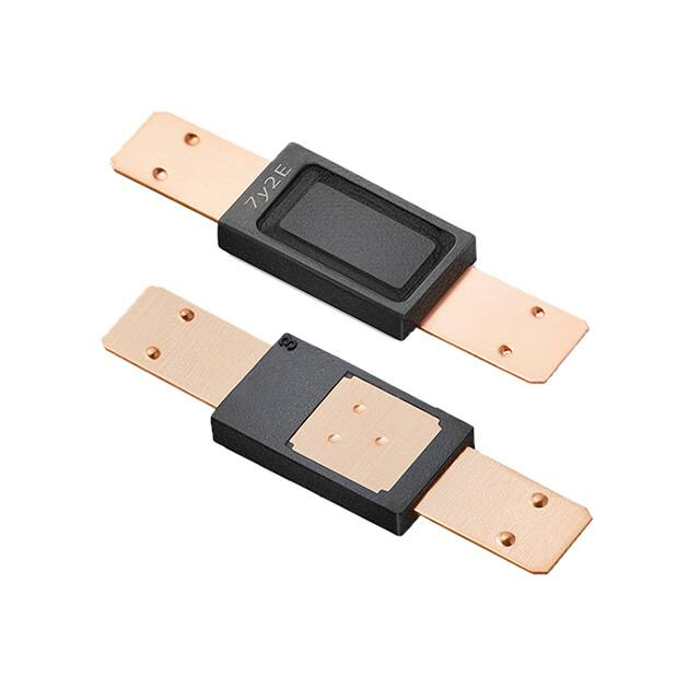

Battery Mini-Breakers Metal Hybrid PPTC > MHP Series MHP-TAC Series Breaker RoHS Description The new Metal Hybrid PPTC device, MHP-TAC, offers higher voltage rating (12VDC) and smaller size than typical MHP-TAM devices. MHP-TAC helps to meet the battery safety requirements of higher-capacity Lithium (Ion) Polymer and Prismatic batteries found in most mobile devices such as laptop PC’s, tablets, and smart phones. MHP technology connects a bimetal protector in parallel with a Polymeric Positive Temperature Coefficient (PPTC) device. The PPTC device is to act as a heater and to help keep the bimetal latched until the fault is removed. The resulting MHP-TAC helps to provide resettable overtemperature protection. Features Circuit Diagram • Miniature Thermal Cutoff (TCO) device • High voltage rating • Overtemperature and overcurrent protection for Lithium (Ion) Polymer and Prismatic cells • Multiple activation temperature ratings (72°C, 77°C, 82°C, 85°C, and 90°C) • Compact size (L: 4.75mm x W: 2.8mm x H: 0.8mm) allows for ultra thin battery pack designs Applications Battery cell protection for Lithium Polymer and Prismatic cells used in: • Notebook PCs • Ultra-books • Tablets • Smart Phone • E-cigarettes • Battery-powered portable devices Typical Electrical Ratings Specification MHP-TAC15-12-72 MHP-TAC15-12-77 MHP-TAC15-12-82 MHP-TAC15-12-85 MHP-TAC15-12-90 72°C+/-5°C 77°C+/-5°C 82°C+/-5°C 85°C+/-5°C 90°C+/-5°C ≥40°C ≥40°C ≥40°C ≥40°C ≥40°C Operation Temperature Reset Temperature Contact Rating Maximum Breaking Current Minimum Hold Voltage Maximum Leakage Current Hold Current Resistance Operating Temperature Range © 2018 Littelfuse, Inc. Specifications are subject to change without notice. Revised: 04/02/18 DC 12V/25A, 6000 Cycles DC 5V/80A, 100 Cycles 3V 150mA@25°C 15A@25°C 5 milliohms Max. -30~100°C Battery Mini-Breakers Metal Hybrid PPTC > MHP Series Specification MHP-TAC6-12-72 MHP-TAC6-12-77 MHP-TAC6-12-82 MHP-TAC6-12-85 72°C+/-5°C 77°C+/-5°C 82°C+/-5°C 85°C+/-5°C ≥40°C ≥40°C ≥40°C ≥40°C Operation Temperature Reset Temperature Contact Rating DC 12V/12A, 6000 Cycles Maximum Breaking Current DC 5V/40A, 100 Cycles Minimum Hold Voltage 2V Maximum Leakage Current 150mA@25°C Hold Current 6A@25°C Resistance 15 milliohms Max. Operating Temperature Range -30~100°C Precautions for Electrical Characteristics Precautions for Rating a. Device electrical characteristics may change depending on installation conditions. Users should independently evaluate the suitability of and test each product in their own application. b. If any terminal or lead extensions are added to the device, especially in the case of high current discharging, the device performance may be negatively impacted due to variations in welding methods or materials. Please avoid designs that might cause heat to be generated around the joints of the lead extensions or on the extended terminals. c. SMT solder reflow, wave-soldering and manual soldering irons are not permitted. a. The power supply voltage must be less than the rated voltage of the device. Operation above the voltage rating may result in device damage, smoking or flame. b. Designs must be selected in such a manner that the device hold current is higher than the normal current value in the circuit and that the device trip current is lower than the abnormal current value. Selecting device hold current and trip current values that are too low for the application may interrupt the circuit under normal usage conditions. c. This product should not be used in an application where the maximum interrupt current can be exceeded in a short circuit condition. d. The devices are intended for protection against damage caused by occasional over current or over temperature fault conditions and should not be used when repeated fault conditions or prolonged trip events are anticipated. e. The devices may not perform as specified if mechanical pressure is added while the device is in the tripped state or exposed to temperature conditions over 100°C. 1.2 1.2 B E 0.1±0.01 0.1 (.15) A 0.1 0.1±0.01 D (.15) C 1.2 1.2 2.0 Dimensions Cover Disc Notes: • Unspecified dimensions, tolerance should be +/-0.1mm • Dimensions in brackets are for reference Dimple (Optional) A Unit = mm B Base Terminal Contact C PPTC Arm Terminal D Dimple (Optional) E MIN MAX MIN MAX MIN MAX MIN MAX MIN MAX 4.65 4.85 0.75 0.85 2.7 2.9 3.1 3.3 3.1 3.3 © 2018 Littelfuse, Inc. Specifications are subject to change without notice. Revised: 04/02/18 Battery Mini-Breakers Metal Hybrid PPTC > MHP Series Current Vs. Temperature Curves Part Marking System Year Code - The last digit of the year. (2018 = 8) Week Code Day Code (Monday = 1, Tuesday = 2, etc.) Product Type (See table below) PRODUCT CODE MHP-TAC15-12-72 A MHP-TAC15-12-77 B MHP-TAC15-12-82 D MHP-TAC15-12-85 E MHP-TAC15-12-90 F MHP-TAC6-12-72 a MHP-TAC6-12-77 b MHP-TAC6-12-82 d MHP-TAC6-12-85 e Application Environment The current vs. temperature curve was derived from placing test samples in an oven at 25°C, 40°C, 60°C, 70°C, 75°C, and 80°C, increasing current flow through the sample at a rate of 0.1 A/minute and recording the current value when the sample trips. The device is intended to be used for applications which are common for general electronic devices. Usage in any of the special environments or conditions as listed below may adversely impact the device performance and therefore users should carefully consider conditions of use of the end product and the potential impact on reliability or performance when incorporating this device into any design to carefully examine the actual performance and reliability of the device. Part Ordering Number System • Environment where the devices are exposed to water, oil, chemical solutions, and/or organic solvents. MHP TAC 15 - 12 - 77 N • Installation in an area close to a heat source or adjacent to or near flammable objects such as plastic wires. TERMINAL TYPE N: Non Dimple (BLANK): With Dimple NOMINAL ACTIVATION TEMPERATURE 72, 77, 82, 85, 90 • Environment in which the device is constrained by pressure, sealing or resin coating. • Environment where water condenses on the device. • Environment with salt air or with corrosive gas such as CL2, H2S, NH3, SO2, and NOX. CONTACT VOLTAGE RATING • Environment with grit and dust and/or under direct sunlight. NOMINAL HOLD CURRENT AT ROOM TEMPERATURE • Environment outside of recommended operating temperature. PRODUCT GROUP SERIES NAME Packaging Packaging Option Quantity Quantity & Packaging Code 20,000 pcs. Minimum 1000 pcs/bag 1 bag per inner box 20 inner box in 1 outer box © 2018 Littelfuse, Inc. Specifications are subject to change without notice. Revised: 04/02/18 Battery Mini-Breakers Metal Hybrid PPTC > MHP Series Precautions for Rating a. The power supply voltage must be less than or equal to the rated voltage of the device. Operation above the voltage rating may result in device damage, smoke or flame. d. The devices are intended for protection against damage caused by occasional over current or over temperature fault conditions and should not be used when repeated fault conditions or prolonged trip events are anticipated. b. Designs must be selected in such a manner that the device hold current is higher than the normal current value in the circuit. Selecting device hold current that is too low for the application may interrupt the circuit under normal usage conditions. e. The devices may not perform as specified if mechanical pressure is added while the device is in the tripped state or exposed to temperature conditions over 100°C or in temperature conditions under -30°C. c. This product should not be used in an application where the maximum short circuit current available exceeds the rated maximum breaking current of the product. Handling Precautions a. The device is composed of plastic parts, please do not clamp or dent the housing with a tool as this might cause a resistance increase and product damage. b. When welding product terminals or mounting the breaker on battery (cell), please be careful not to apply excessive bending, twisting or force on the product and terminals. The excessive stress might cause a resistance increase or product damage. Please refer to following cautions. • Do not apply more than 10N bend force to product. (Fig. 1) • Do not apply more than 1.5cN*m twist torque to the product. (Fig. 2) • Do not apply more than 20N deflection force to product. (Fig. 3) • Do not apply more than 2N force to the terminals. (Fig. 4) • Do not apply more than 0.6cN*m twisting torque to the terminals. (Fig. 5) • Do not bend the terminals more than 45° at the end. (Fig. 6) • Should not twist terminals more than 20°C with breaker body fixed. c. Product terminals can be welded using direct welding and series welding methods. In either case, please use a suitable Jig so that the device will not be subjected to the stress conditions listed above. d. Pull strength and detach strength of the terminal welds are per user requirements. However, if the welding is controlled by resistance, the measurement should be made as close as possible to the weld point by a “4-point clip method” using milliohm meter to ensure accuracy. e. Please avoid putting the stress on the device, as listed above, when a jig, fitting or additional welding process is used. Please re-confirm the resistance value whenever a new process is added. Disclaimer Notice - Information furnished is believed to be accurate and reliable. However, users should independently evaluate the suitability of and test each product selected for their own applications. Littelfuse products are not designed for, and may not be used in, all applications. Read complete Disclaimer Notice at www.littelfuse.com/disclaimer-electronics. © 2018 Littelfuse, Inc. Specifications are subject to change without notice. Revised: 04/02/18

物料型号:MHP-TAC系列,包括MHP-TAC15-12-72、MHP-TAC15-12-77、MHP-TAC15-12-82、MHP-TAC15-12-85和MHP-TAC15-12-90等不同型号。
器件简介:MHP-TAC系列是金属混合PPTC(正温度系数聚合物)器件,提供可重置的过温保护,适用于高容量锂离子聚合物和棱柱形电池,常见于笔记本电脑、平板电脑、智能手机等移动设备。
引脚分配:文档中未明确提供引脚分配图,但提到了“Base Terminal”、“Contact PPTC Arm”和“Terminal”等部件,可能与引脚分配有关。
参数特性:包括操作温度、复位温度、接触额定值、最大断开电流、最小保持电压、最大漏电流、保持电流、电阻和工作温度范围等。
功能详解:MHP技术结合了双金属保护器和PPTC器件,PPTC器件作为加热器,帮助保持双金属锁定,直到故障移除,从而提供可重置的过温保护。
应用信息:用于锂聚合物和棱柱形电池的电池单元保护,应用于笔记本电脑、超极本、平板电脑、智能手机、电子烟等电池供电的便携设备。
封装信息:提供了详细的尺寸数据,包括最小和最大尺寸公差,以及可选的凹陷(Dimple)设计。
