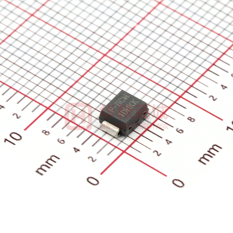

    SIDACtor®保护晶闸管 SMB VDRM=6V IT=2.2A
P0080SCMCLRP 数据手册
SIDACtor ® Protection Thyristors Broadband OptimizedTM Protection MC Series - DO-214 Pb e3 RoHS Description The MC Series DO-214 are low capacitance SIDACtor® components designed to protect broadband equipment such as VOIP, DSL modems and DSLAMs from damaging overvoltage transients. The series provides a surface mount solution that enables equipment to comply with global regulatory standards while limiting the impact to broadband signals. Features and Benefits • Low voltage overshoot • RoHS Compliant and Halogen-Free • Low on-state voltage • Pb-free E3 means 2nd level • Does not degrade surge Agency Approvals Agency interconnect is Pb-free and the terminal finish material is tin(Sn) (IPC/JEDEC J-STD609A.01) capability after multiple surge events within limit. • 40% lower capacitance Agency File Number than our Baseband Protectors, for applications that demand greater signal integrity E133083 Pinout Designation • Fails short circuit when surged in excess of ratings Applicable Global Standards NOT APPLICABLE • • • • • Schematic Symbol TIA-968-A TIA-968-B ITU K.20/21/45 Enhanced Level* ITU K.20/21/45 Basic Level GR 1089 Inter-building* • • • • • GR 1089 Intra-building IEC 61000-4-5 2nd edition YD/T 1082 YD/T 993 YD/T 950 *A-rated parts require series resistance Electrical Characteristics Part Number P0080SAMCLRP P0220SAMCLRP P0300SAMCLRP P0080SCMCLRP P0220SCMCLRP P0300SCMCLRP P0640SCMCLRP P0720SCMCLRP P0900SCMCLRP P1100SCMCLRP P1300SCMCLRP P1500SCMCLRP P1800SCMCLRP P2100SCMCLRP P2300SCMCLRP P2600SCMCLRP P3100SCMCLRP P3500SCMCLRP P4500SCMCLRP Marking P-8AM P02AM P03AM P-8CM P02CM P03CM P06CM P07CM P09CM P11CM P13CM P15CM P18CM P21CM P23CM P26CM P31CM P35CM P45CM VDRM @lDRM=5µA VS @100V/µs IH IS IT VT @IT=2.2 Amps V min V max mA min mA max A max V max pF min pF max 6 15 25 6 15 25 58 65 75 90 120 140 170 180 190 220 275 320 400 25 32 40 25 32 40 77 88 98 130 160 180 220 240 260 300 350 400 530 50 50 50 50 50 50 150 150 150 150 150 150 150 150 150 150 150 150 50 800 800 800 800 800 800 800 800 800 800 800 800 800 800 800 800 800 800 800 2.2 2.2 2.2 2.2 2.2 2.2 2.2 2.2 2.2 2.2 2.2 2.2 2.2 2.2 2.2 2.2 2.2 2.2 2.2 4 4 4 4 4 4 4 4 4 4 4 4 4 4 4 4 4 4 4 10 10 10 25 25 15 50 50 40 40 35 30 30 30 30 30 30 25 25 35 35 35 60 60 40 80 75 70 70 60 55 50 50 50 45 45 50 45 Notes: - Absolute maximum ratings measured at TA= 25ºC (unless otherwise noted). - Components are bi-directional. © 2017 Littelfuse, Inc. Specifications are subject to change without notice. Revised: 02/23/17 Capacitance @1MHz, 2V bias SIDACtor ® Protection Thyristors Broadband OptimizedTM Protection Series Surge Ratings IPP 0.2/310 1 0.5/700 2 2/10 1 2/10 2 8/20 1 1.2/50 2 10/160 1 10/160 2 10/560 1 10/560 2 5/320 1 9/720 2 10/360 1 10/360 2 10/1000 1 10/1000 2 5/310 1 10/700 2 ITSM 50/60 Hz di/dt A min A min A min A min A min A min A min A min A min A min A/µs max A 20 150 150 90 50 75 75 45 75 25 500 C 50 500 400 200 150 200 175 100 200 35 500 Notes: 1 Current waveform in µs 2 Voltage waveform in µs 3 For surge rating of P4500SCMCLRP 10/700µs min=150A 3 - Peak pulse current rating (IPP) is repetitive and guaranteed for the life of the product that remains in thermal equilibrium. - IPP ratings applicable over temperature range of -40ºC to +85ºC - The component must initially be in thermal equilibrium with -40°C < TJ < +150°C Thermal Considerations Package Symbol Parameter Value Unit TJ Operating Junction Temperature Range -40 to +150 °C TS Storage Temperature Range -65 to +150 °C R0JA Thermal Resistance: Junction to Ambient 90 °C/W DO-214AA V-I Characteristics tr x td Pulse Waveform IPP – Peak Pulse Current – %IPP +I IT IS IH IDRM -V +V VT VDRM VS tr = rise time to peak value td = decay time to half value Peak Value 100 Waveform = tr x td 50 Half Value 0 0 td tr t – Time (µs) -I Normalized DC Holding Current vs. Case Temperature 14 12 10 IH 8 6 25 °C 4 2 IH (TC = 25ºC) 2.0 Ratio of Percent of VS Change – % Normalized VS Change vs. Junction Temperature 0 -4 -6 1.8 1.6 1.4 1.0 0.8 0.6 0.4 -8 -40 -20 0 20 40 60 80 100 120 140 160 Junction Temperature (TJ) – °C 25°C 1.2 -40 -20 0 20 40 60 80 100 120 140 160 Case Temperature (TC) - ºC © 2017 Littelfuse, Inc. Specifications are subject to change without notice. Revised: 02/23/17 SIDACtor ® Protection Thyristors Broadband OptimizedTM Protection Soldering Parameters - Temperature Min (Ts(min)) Pre Heat - Temperature Max (Ts(max)) - Time (Min to Max) (ts) Pb-Free assembly (see Fig. 1) +150°C +200°C 60-180 secs. Average ramp up rate (Liquidus Temp (TL) to peak) 3°C/sec. Max. TS(max) to TL - Ramp-up Rate 3°C/sec. Max. Reflow - Temperature (TL) (Liquidus) +217°C - Temperature (tL) 60-150 secs. Peak Temp (TP) +260(+0/-5)°C Time within 5°C of actual Peak Temp (tp) 30 secs. Max. Ramp-down Rate 6°C/sec. Max. Time 25°C to Peak Temp (TP) 8 min. Max. Do not exceed +260°C Copper Alloy Terminal Finish 100% Matte-Tin Plated Body Material UL Recognized epoxy meeting flammability classification V-0 Additional Information Datasheet Resources © 2017 Littelfuse, Inc. Specifications are subject to change without notice. Revised: 02/23/17 TP tP Critical Zone TL to TP Ramp-up TL TS(max) tL Ramp-down Preheat TS(min) tS 25 time to peak temperature (t 25ºC to peak) Time Environmental Specifications Physical Specifications Lead Material Figure 1 Temperature Reflow Condition Samples High Temp Voltage Blocking 80% Rated VDRM (VAC Peak ) +125°C or +150°C, 504 or 1008 hrs. MIL-STD-750 (Method 1040) JEDEC, JESD22-A-101 Temp Cycling -65°C to +150°C, 15 min. dwell, 10 up to 100 cycles. MIL-STD-750 (Method 1051) EIA/JEDEC, JESD22-A104 Biased Temp & Humidity 52 VDC (+85°C) 85%RH, 504 up to 1008 hrs. EIA/ JEDEC, JESD22-A-101 High Temp Storage +150°C 1008 hrs. MIL-STD-750 (Method 1031) JEDEC, JESD22-A-101 Low Temp Storage -65°C, 1008 hrs. Thermal Shock 0°C to +100°C, 5 min. dwell, 10 sec. transfer, 10 cycles. MIL-STD-750 (Method 1056) JEDEC, JESD22-A-106 Autoclave (Pressure Cooker Test) +121°C, 100%RH, 2atm, 24 up to 168 hrs. EIA/ JEDEC, JESD22-A-102 Resistance to Solder Heat +260°C, 30 secs. MIL-STD-750 (Method 2031) Moisture Sensitivity Level 85%RH, +85°C, 168 hrs., 3 reflow cycles (+260°C Peak). JEDEC-J-STD-020, Level 1 SIDACtor ® Protection Thyristors Broadband OptimizedTM Protection Dimensions — DO-214AA Pad Outline Case Temperature Measurement Point B D 0.110 (2.8) C A 0.079 (2.0) H E inch (millimeter) F K Inches Dimensions 0.079 (2.0) Millimeters Min Max Min Max A 0.130 0.156 3.30 3.95 B 0.201 0.220 5.10 5.60 C 0.077 0.087 1.95 2.20 D 0.159 0.181 4.05 4.60 E 0.030 0.063 0.75 1.60 F 0.075 0.096 1.90 2.45 G 0.002 0.008 0.05 0.20 H 0.077 0.104 1.95 2.65 K 0.006 0.016 0.15 0.41 G Part Numbering Part Marking P xxx 0 S C MC L RP REEL PACK TYPE P = SIDACtor Pxxxx xxxxx RoHS COMPLIANT MEDIAN VOLTAGE MC Series CONSTRUCTION VARIABLE Part Marking Code (Refer to Electrical Characteristics Table) Date Code IPP RATING PACKAGE TYPE Packing Options Package Type S Description Quantity Added Suffix Industry Standard DO-214AA Tape & Reel Pack 2500 N/A EIA-481-D Tape and Reel Specification — DO-214AA 0.157 (4.0) 0.472 (12.0) 0.36 (9.2) 0.315 (8.0) 0.059 DIA (1.5) 12.99 (330.0) 0.512 (13.0) Arbor Hole Dia. 0.49 (12.4) Cover tape Dimensions are in inches (and millimeters). Direction of Feed Disclaimer Notice - Information furnished is believed to be accurate and reliable. However, users should independently evaluate the suitability of and test each product selected for their own applications. Littelfuse products are not designed for, and may not be used in, all applications. Read complete Disclaimer Notice at www.littelfuse.com/disclaimer-electronics. © 2017 Littelfuse, Inc. Specifications are subject to change without notice. Revised: 02/23/17
