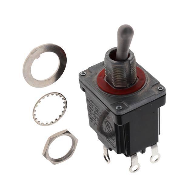

    钮子开关 双刀单掷 1万次 面板安装 15A 28V -40℃~+85℃
PT202SZQ 数据手册
PT Series Sealed Power Toggle Switch NEW Features/Benefits Typical Applications • IP66/IP68 versatile rating to withstand harsh • Off-road, Construction/Agricultural vehicles outdoor environments, intense, wet weather, • Material handling equipment wind blown rain, dirt • Articulating, scissor, and bucket lift controls • UL 61058-1 certified has global acceptance • Outdoor industrial equipment with no additional testing needed • Lift gate controls • Integrated panel seal for extra protection • Superior oil and fuel resistance • High strength, heat resistant housing designed for demanding applications subjected to vibration and harsh conditions Specifications UL ELECTRICAL RATINGS: MAINTAINED FUNCTIONS: MOMENTARY FUNCTIONS: ELECTRICAL LIFE: DC ELECTRICAL RATINGS: ALL FUNCTIONS: MAINTAINED FUNCTIONS: MOMENTARY FUNCTIONS: DIELECTRIC STRENGTH: INSULATION RESISTANCE: CONTACT RESISTANCE: OPERATING AND STORAGE TEMPERATURE: IP RATINGS: UL 61058-1 15A GP, 277VAC 50/60Hz T85 15(4)A, 277VAC 50/60Hz T85 1/2 hp, 125VAC 50/60Hz T85 1 hp, 250VAC 50/60Hz T85 10A GP, 277VAC 50/60Hz T85 10(4)A, 277VAC 50/60Hz T85 1/4hp, 125VAC 50/60Hz T85 1/2 hp, 250VAC 50/60Hz T85 10,000 cycles Resistive Loads Up to 25A, 24VDC 0.75A, 125VDC 0.5A, 250VDC 15A, 28VDC 10A, 28VDC 2500V min. initial (terminal to toggle) 1000 MΩ min. initial 50 mΩ max. initial(terminal to toggle) Materials CASE: Thermoset ACTUATOR: Stainless Steel PIVOT PIN: Stainless Steel BUSHING: Zinc Die Cast SEAL: Silicone MOVEABLE CONTACT(S): Copper alloy, silver plated BUTTON: Silver Cadmium TERMINALS: Brass for Quick connect, silver plated brass for solder and screw terminals HARDWARE: Hex nut & locking ring: brass, nickel plated Screws: brass Lock washer: brass, nickel plated PACKAGING: Trays -40°C to +85°C IP66/IP68 Versatile Build-A-Switch To order, simply select desired option from each category and place in the appropriate box. Available options are shown and described on pages F-53 thru F-56. For additional options not shown in catalog, consult Customer Service Center. P T 22 Mar 22 Actuator S Standard F Terminals S Screw terminal Q Quick connect .250” Z Solder terminal Contact Material Q Silver F–55 Toggle Switch Function * PT101 SP On-None-On PT102 SP On-None-Off PT103 SP On-Off-On PT105 SP Mom-Off-Mom PT107 SP On-Off-Mom PT108 SP On-None-Mom PT201 DP On-None-On PT202 DP On-None-Off PT203 DP On-Off-On PT205 DP Mom-Off-Mom PT207 DP On-Off-Mom PT208 DP On-None-Mom S Dimensions are shown: mm Specifications and dimensions subject to change www.ckswitches.com PT Series Sealed Power Toggle Switch SP NEW SWITCH FUNCTION POS.1 POS.2 POS.3 CONNECTED TERMINALS POS.1 POS.2 POS.3 NO. MODEL NO. POLES 30 SCHEMATIC P-2 P-1 P-3 SP PT101 PT102* PT103 PT105 PT107 PT108 ON ON ON MOM ON ON NONE NONE OFF OFF OFF NONE ON OFF ON MOM MOM MOM 2-3 2-3 N/A N/A 2-1 OPEN 2-3 OPEN 2-1 2-3 N/A 2-1 SPDT 2 (COMMON) 3 1 * PT102 OMIT TERMINAL 1 24.3 10 FLATS 21.3 15 KEYWAY THIS SIDE 29.4 32.3 DP 35.3 Toggle F Dimensions are shown: mm Specifications and dimensions subject to change 22 Mar 22 F–56 www.ckswitches.com PT Series Sealed Power Toggle Switch NEW ACTUATOR S  STANDARD TERMINALS S  SCREW TERMINAL Q  QUICK CONNECT F Toggle Dimensions are shown: Inches (mm) Specifications and dimensions subject to change 22 Mar 22 F–57 www.ckswitches.com PT Series Sealed Power Toggle Switches Z NEW SOLDER TERMINAL SP MOUNTING HARDWARE PART NO. 700302202 NIICKEL PLATED PART NO. 707100201 NIICKEL PLATED PART NO. 707200201 NIICKEL PLATED WITH KEYWAY Note: Standard hardware shipped with each switch is 1 pc each Toggle F Dimensions are shown: Inches (mm) Specifications and dimensions subject to change 22 Mar 22 F–58 www.ckswitches.com
