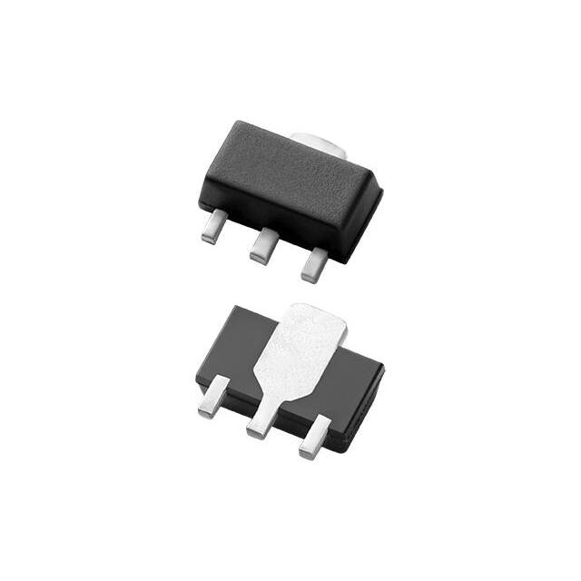

    1.5安培灵敏型可控硅整流器
S602BS2RP 数据手册
Thyristors Datasheet Sx02xSx EV Series EV Series 1.5 Amp Sensitive SCRs RoHS Description This new 1.5A sensitive gate SCR component series offers high static dv/dt and low turn-off time (tq) All SCR junctions are glasspassivated to ensure long term reliability and parametric stability. Features ■ Surge capability > 15Amps ■ Sensitive gate for direct microprocessor interface ■ Blocking voltage (VDRM/ VRRM) capability — up to 600V ■ Thru hole and surface mount packages ■ High dv/dt noise immunity ■ RoHS compliant and HalogenFree ■ Improved turn-off time (tq) < 35 μsec. Additional Information Applications The Sx02xSx EV series is specifically designed for solenoid drive often seen in GFCI and similar safety cut-off devices. Resources Accessories Samples Main Features Symbol Schematic Symbol Value Unit A IT(RMS) 1.5 VDRM / VRRM 400 or 600 V IGT 200 µA A G K Absolute Maximum Ratings Symbol IT(RMS) IT(AV) Parameter RMS on-state current (full sine wave) TO-92 TC = 65°C SOT-89 TC = 80°C SOT-223 TC = 95°C TO-92 TC = 65°C Average on-state current SOT-89 TC = 80°C TC = 95°C ITSM Non repetitive surge peak on-state current (Single cycle, TJ initial = 25°C) I2t I2t Value for fusing SOT-223 TO-92 SOT-89 SOT-223 tp = 10 ms di/dt Critical rate of rise of on-state current IG = 10mA IGM Peak gate current tp = 8.3 ms TO-92 SOT-89 SOT-223 tp = 10 μs PG(AV) Average gate power dissipation Value Unit 1.5 A 0.95 A F = 50 Hz 12.5 F = 60 Hz 15.0 F = 50 Hz 0.78 F = 60 Hz 0.93 TJ = 125°C 50 A A2s A/μs TJ = 125°C 1.0 A TJ = 125°C 0.1 W Tstg Storage junction temperature range -40 to 150 °C TJ Operating junction temperature range -40 to 125 °C 1 © 2021 Littelfuse, Inc. Specifications are subject to change without notice. Revised: GD. 03/19/21 Thyristors Datasheet Sx02xSx EV Series EV Series 1.5 Amp Sensitive SCRs Electrical Characteristics (TJ = 25°C, unless otherwise specified) Symbol Description Test Conditions Sx02xS Sx02xS1 Sx02xS2 Min Max Min Max Min Units Max IGT DC Gate Trigger Current VD = 12V; RL = 60 Ω 15 200 15 100 15 50 VGT DC Gate Trigger Voltage VD = 12V; RL = 60 Ω — 0.8 — 0.8 — 0.8 V VGRM Peak Reverse Gate Voltage IRG = 10μA 5 — 5 — 5 — V IH Holding Current RGK = 1 kΩ — 5 — 3 — 3 mA (dv/ dt)s "Critical Rate-of-Rise of Off-State Voltage" "TJ = 125°C VD = VDRM / VRRM Exponential Waveform RGK = 1 kΩ" 25 — 25 — 25 — V/μs tq Turn-Off Time — 35 — 35 — 35 μs tgt Turn-On Time — 3 — 3 — 3 µs VGD Gate Non-Trigger Voltage 0.2 — 0.2 — 0.2 — V "TJ = 125°C @ 600 V RGK = 1 kΩ" "IG = 10mA PW = 15μsec IT = 3.0A (pk)" "VD=VDRM, TJ=125°C, RL=3.3KΩ" μA x0 = voltage/10 Static Characteristics (TJ = 25°C, unless otherwise specified) Value Symbol Description Test Conditions VTM Peak On-State Voltage ITM = 3.0A (pk) Off-State Current, Peak Repetitive TJ = 25°C @ VD= VDRM RGK = 1 kΩ TJ = 125°C @ VD= VDRM RGK = 1 kΩ IDRM Unit Min Max — 1.70 V — 5 μA — 500 μA Thermal Resistances Symbol Parameter RƟ(J-C) Junction to case (AC) RƟ(J-A) 1 Junction to ambient Value IT = 1.5A (RMS)1 IT = 1.5A (RMS)1 TO-92 50 SOT-89 35 SOT-223 25 TO-92 160 SOT-89 90 SOT-223 60 Unit °C/W °C/W 60Hz AC resistive load condition, 100% conduction. 2 © 2021 Littelfuse, Inc. Specifications are subject to change without notice. Revised: GD. 03/19/21 Thyristors Datasheet Sx02xSx EV Series EV Series 1.5 Amp Sensitive SCRs Figure 1: Normalized DC Gate Trigger Current vs. Junction Temperature Figure 2: Normalized DC Holding Current vs. Junction Temperature Normalized Gate Trigger Current IGT @ TJ / IGT@ 25ºC 2.5 2.0 Normalized Holding Current (IGT @ TJ / IGT@ 25ºC) 2.0 1.5 1.0 0.5 0.0 1.5 1.0 0.5 0.0 -40 -25 -10 +5 +20 +35 +50 +65 +80 +95 +110 -40 +125 -25 -10 Instantaneous On-state Current (IT) – Amps Normalized Gate Trigger Current VGT @ VGT @ 25ºC 1.0 0.5 +5 +20 +35 +50 +65 +80 +95 +110 +125 6 4 2 1.0 1.2 1.4 1.6 1.8 2.0 2.2 Figure 6: Maximum Allowable Case Temperature vs. On-State Current Max Allowable Case Temperature, TC (Celsius) Average Power Dissipation, PD (Watts) +110 Instantaneous On-state Voltage (VT) – Volts CURRENT WAVEFORM: Sinusoidal LOAD: Resistive or Inductive CONDUCTION ANGLE: 180o 1.0 0.5 0.0 RMS On-state Current [IT(RMS)] (Amps) +95 8 0.8 1.5 1.0 +80 0 +125 Figure 5: Power Dissipation (Typical) vs. RMS On-State Current 0.5 +65 10 Junction Temperature (TJ)°C 0.0 +50 Voltage (Typical) 1.5 -10 +35 Figure 4: On-State Current vs. On-State Figure 3: Normalized DC Gate Trigger Voltage vs. Junction Temperature -25 +20 Junction Temperature (TJ)°C Junction Temperature (TJ)°C -40 +5 130 120 SOT-223 110 100 TO-92 90 80 SOT-89 CURRENT WAVEFORM: Sinusoidal LOAD: Resistive or Inductive CONDUCTION ANGLE: 180o CASE TEMPERATURE: Measured as shown on dimensional drawings 70 60 50 0.0 1.5 0.5 1.0 1.5 RMS On-state Current [IT (RMS)] (Amps) 3 © 2021 Littelfuse, Inc. Specifications are subject to change without notice. Revised: GD. 03/19/21 Thyristors Datasheet Sx02xSx EV Series EV Series 1.5 Amp Sensitive SCRs Figure 7: Typical DC Gate Trigger Current with RGK vs. Junction Temperature for Sx02xS Figure 7: Typical DC Gate Trigger Current with RGK vs. 100 Junction Temperature for Sx02xS RGK=10Ω RGK=100Ω 10 1 RGK=10Ω RGK=100Ω RGK=470Ω RGK=470Ω RGK=1KΩ 1 0.1 RGK=1KΩ No RGK 0.1 0.01 0.001 100 Holding Holding Current Current IH (mA) IH (mA) TriggerTrigger Current Current IGT (mA) IGT (mA) 100 10 0.01 0.001 Figure 8: Typical DC Holding Current with RGK vs. Junction Temperature for Sx02xS Figure 8: Typical DC Holding Current with RGK vs. 100 Junction Temperature for Sx02xS No RGK -15 10 35 60 85 110 -40 Junction Temperature (TJ ) -- (°C) -15 10 35 60 85 110 RGK R=100Ω =10Ω GK 10 10 RGK=100Ω RGK=470Ω 1 RGK=470Ω RGK=1KΩ 1 RGK RGKNo =1KΩ 0.1 -40 RGK=10Ω 135 0.1 135 No RGK -40 -15 110 135 -40 Junction Temperature (TJ ) -- (°C) -15 10 35 60 85 110 135 Junction Temperature (TJ ) -- (°C) RGK=220Ω =220Ω RRGK GK=470Ω 100 RRGKGK=470Ω =1KΩ 100 RGK=1KΩ 10 10 Turn off Turn time offTq time (µs)Tq (µs) Static Static dv/dt dv/dt (V/μs)(V/μs) RGK=10Ω 1000 85 85 28 32 RGK=1KΩ 24 28 RGK=1KΩ 20 24 25 45 105 125 25 Junction Temperature (TJ ) -- (°C) 45 65 85 105 125 RGK=470Ω RGK=470Ω RGK=100Ω 16 20 12 16 RGK=100Ω RGK=10Ω 8 12 RGK=10Ω 4 8 0 4 65 60 Figure 10: Typical turn off time with RGK vs. Junction Temperature for Sx02xS Figure 10: Typical turn off time with RGK vs. Junction 32 Temperature for Sx02xS RGK=10Ω 1000 35 Junction Temperature (TJ ) -- (°C) Figure 9: Typical Static dv/dt with RGK vs. Junction Temperature for Sx02xS Figure 9: Typical Static dv/dt with RGK vs. Junction 10000 Temperature for Sx02xS 10000 10 0 -40 -15 -40 -15 10 35 60 85 110 135 Junction Temperature (TJ ) -- (°C) 10 35 60 85 110 135 Junction Temperature (TJ ) -- (°C) Junction Temperature (TJ ) -- (°C) Figure 11: Surge Peak On-State Current vs. Number of Cycles Supply Frequency: 60Hz Sinusoidal Load: Resistive RMS On-State Current [IT(RMS)]: Max Rated Value at Specific Case Temperature Peak Surge (Non-repetitive) On-State Current (ITSM) – Amps. 20 15 12 10 9 8 7 6 Notes: 1. Gate control may be lost during and immediately following surge current interval. 2. Overload may not be repeated until junction temperature has returned to steady-state rated value. 5 1.5 4 AC om 3 pon ent s 2 1 1 2 3 4 5 6 7 8 9 10 20 30 40 60 80 100 200 300 400 600 1000 Surge Current Duration – Full Cycle 4 © 2021 Littelfuse, Inc. Specifications are subject to change without notice. Revised: GD. 03/19/21 Thyristors Datasheet Sx02xSx EV Series EV Series 1.5 Amp Sensitive SCRs Soldering Parameters Pb – Free assembly Pre Heat - Temperature Min (Ts(min)) 150°C - Temperature Max (Ts(max)) 200°C - Time (min to max) (ts) 60 – 180 secs Average ramp up rate (Liquidus Temp) (TL) to peak 5°C/second max TS(max) to TL - Ramp-up Rate Reflow 5°C/second max - Temperature (TL) (Liquidus) 217°C - Time (min to max) (ts) 60 – 150 seconds Peak Temperature (TP) 260+0/-5 °C Time within 5°C of actual peak Temperature (tp) 20 – 40 seconds Ramp-down Rate 5°C/second max Time 25°C to peak Temperature (TP) 8 minutes Max. Do not exceed 280°C Body Material Lead Material Ramp-up TL tL TS(max) Preheat TS(min) 25 Physical Specifications Terminal Finish tP TP Temperature Reflow Condition Ramp-do Ramp-down tS time to peak temperature Time Environmental Specifications 100% Matte Tin-plated. UL Recognized compound meeting flammability rating V-0 Copper Alloy Test AC Blocking Temperature Cycling Temperature/ Humidity Design Considerations Careful selection of the correct component for the application’s operating parameters and environment will go a long way toward extending the operating life of the Thyristor. Good design practice should limit the maximum continuous current through the main terminals to 75% of the component rating. Other ways to ensure long life for a power discrete semiconductor are proper heat sinking and selection of voltage ratings for worst case conditions. Overheating, overvoltage (including dv/dt), and surge currents are the main killers of semiconductors. Correct mounting, soldering, and forming of the leads also help protect against component damage. 5 Specifications and Conditions MIL-STD-750, M-1040, Cond A Applied Peak AC voltage @ 125°C for 1008 hours MIL-STD-750, M-1051, 100 cycles; -40°C to +150°C; 15-min dwell-time EIA / JEDEC, JESD22-A101 1008 hours; 160V - DC: 85°C; 85% rel humidity Resistance to Solder Heat MIL-STD-750 Method 2031 Solderability ANSI/J-STD-002, category 3, Test A Lead Bend MIL-STD-750, M-2036 Cond E © 2021 Littelfuse, Inc. Specifications are subject to change without notice. Revised: GD. 03/19/21 Thyristors Datasheet Sx02xSx EV Series EV Series 1.5 Amp Sensitive SCRs Dimensions — TO-92 (E Package) A Inches Dimensions TC Measuring Point Max Min Max 0.175 0.205 4.450 5.200 B 0.170 0.210 4.320 5.330 C 0.500 — 12.700 — D 0.135 — 3.430 — E 0.125 0.165 3.180 4.190 A B Seating Plane C Gate Anode G H Cathode Millimeters Min F 0.080 0.105 2.040 2.660 G 0.016 0.021 0.407 0.533 H 0.045 0.055 1.150 1.390 I 0.095 0.105 2.420 2.660 J 0.015 0.020 0.380 Anode 0.500 I D E F J F Anode Gate Cathode Dimensions – SOT-223 Anode Anode Anode Gate Cathode Anode Gate Cathode Anode Gate Cathode Dimensions Anode Pad Layout for SOT-223 3.3 (0.130”) 1.5 (0.059”) 1.2 (0.047”) 2.3 (0.091”) 6.4 (0.252”) (3x) 1.5 (0.059”) 4.6 (0.181”) Inches Millimeters Min Typ Max Min Typ Max A 0.248 0.256 0.264 6.30 6.50 6.70 B 0.130 0.138 0.146 3.30 3.50 3.70 C — — 0.071 — — 1.80 D 0.001 — 0.004 0.02 — 0.10 E 0.114 0.118 0.124 2.90 3.00 3.15 F 0.024 0.027 0.034 0.60 0.70 0.85 G — 0.090 — — 2.30 — H — 0.181 — — 4.60 — I 0.264 0.276 0.287 6.70 7.00 7.30 J 0.009 0.010 0.014 0.24 0.26 0.35 K 10° MAX Dimensions in Millimeters (Inches) Recommended Soldering Footprint for SOT223 6 © 2021 Littelfuse, Inc. Specifications are subject to change without notice. Revised: GD. 03/19/21 A Tc Measuring Point ThyristorsJ Datasheet Sx02xSx EV Series A EV Series 1.5 Amp Sensitive SCRs Tc Measuring Point BAnode J Anode D E B D Gate Dimensions – SOT-89 A Anode Anode Tc Measuring Point Anode J D C Cathode H G Anode D C E E F Gate B B Cathode G Tc Measuring Point E J A F H F Gate Cathode G Anode Gate F c Cathode G C Anode Dimension H Pad Layout for SOT-89 C H (2.21) .087 (1.12) .044 c c (1.19) .047 g (3.91) .154 g f (0.91) .036 (1.63) .064 a d Inches Min Typ Max Min g Typ Max A 0.173 — 0.181 4.40 — 4.60 B 0.090 — 0.102 2.29 — 2.60 C 0.055 — 0.063 1.40 —f 1.60 D 0.155 — 0.167 3.94 — 4.25 E 0.035 — 0.047 0.89 — 1.20 F 0.056 — 0.062 — 1.57 — d0.121 1.42 a 2.92 — 3.07 — 0.017 0.35 — 0.44 g f f c e G 0.115 H 0.014 I e 0.014 — 0.019 0.36 — 0.48 J 0.064 — 0.072 1.62 — 1.83 e Dimensions ina Millimeters (Inches) (1.63) .064 Millimeters d b b d b Product Selector e Part Numbr Voltage b Gate Sensitivity Package X 200 µA SOT-89 X 200 µA TO-92 X X 200 µA SOT-223 X X 100 µA SOT-89 Sx02ES1 X X 100 µA TO-92 Sx02TS1 X X 100 µA SOT-223 Sx02BS2 — X 50 μA SOT-89 Packing Mode Base Quantity 400V 600V Sx02BS X Sx02ES X Sx02TS Sx02BS1 Note: x = voltage/100 Packing Options Part Number Marking Weight Sx02ESy Sx02ESy 0.217 g Bulk 2500 Sx02ESyAP Sx02ESy 0.217 g Ammo Pack 2000 Sx02ESyRP Sx02ESy 0.217 g Tape & Reel 2000 Sx02TSyRP Sx02TSy 0.120 g Tape & Reel 1000 Sx02BSyRP x02y 0.053 g Tape & Reel 1000 Sx02BSyRP1 x02y 0.053 g Tape & Reel 1000 7 © 2021 Littelfuse, Inc. Specifications are subject to change without notice. Revised: GD. 03/19/21 a Thyristors Datasheet Sx02xSx EV Series EV Series 1.5 Amp Sensitive SCRs TO-92 (3-lead) Reel Pack (RP) Radial Leaded Specifications Meets all EIA-468-C Standards 0.236 (6.0) 1.6 (41.0) 0.708 (18.0) 0.02 (0.5 ) 0.098 (2.5) MAX 1.2 6 (32.0) 0.354 (9.0) 0. 5 (12.7) Cathode 0.2 (5.08) 0.1 (2.54) Anode Gate 0.157 DI A (4.0) 14.17(360.0) Flat up 1.9 7 (50.0) Dimensions are in inches (and millimeters). Direction of Feed SOT-89 Reel Pack (RP) Specifications 8 mm 4 mm Ø1.5 mm 2 mm ANODE 1.75 mm 12 mm 5.5 mm GATE ANODE CATHODE 180 mm 13 mm Abor Hole Diameter 13.4 mm DIRECTION OF FEED 8 © 2021 Littelfuse, Inc. Specifications are subject to change without notice. Revised: GD. 03/19/21 Thyristors Datasheet Sx02xSx EV Series EV Series 1.5 Amp Sensitive SCRs SOT-89 Reel Pack (RP1) Specifications Ф 1.5mm 4mm 2mm 8mm Cathode Anode 1.75mm 5.5mm 12mm Gate Anode 180 mm 13 mm Abor Hole Diameter 13.4 mm Direction of Feed TO-92 (3-lead) Ammo Pack (AP) Radial Leaded Specifications Meets all EIA-468-C Standards 0.236 (6.0 ) 0.02 (0.5 ) 0.098 (2.5) MAX 1.27 (32.2) 1.62 (41.2) 0.708 (18.0) 0.35 4 (9.0 ) Anode 0.1 (2.54) 0. 5 (12.7) 0.2 (5.08) 0.157 (4.0 ) DI A Cathode Gate Flat down n of Feed Direc tio 25 Devices per fold 1.85 (47.0) 12. 2 (310.0 ) 1.85 (47.0) Dimensions are in inches (and millimeters). 13. 3 (338.0) 9 © 2021 Littelfuse, Inc. Specifications are subject to change without notice. Revised: GD. 03/19/21 Thyristors Datasheet Sx02xSx EV Series EV Series 1.5 Amp Sensitive SCRs SOT-223 Reel Pack (RP) Specifications 8 mm 4 mm 1.5 mm 2 mm A 1.75 mm 12 mm 5.5 mm K A Gate 180 mm 13 mm Abor Hole Diameter 13.4 mm Part Numbering System Part Marking System S x 02 x xx xx SCR Series Packing Type Blank: Bulk RP: Reel Pack (TO-92) : Embossed Carrier Pack (SOT-223) AP: Ammo Pack (TO-92) Voltage 4: 400V 6: 600V Current 02: 1.5A SOT89 Sensitivity S: 200µA Sensitive SCR S1: 100µA Sensitive SCR S2: 50µA Sensitive SCR SOT223 Line1 = Littelfuse Part Number Line2 = continuation…Littelfuse Part Number Y = Last Digit of Calendar Year M = Letter Month Code (A-L for Jan-Dec) L = Location Code DD = Calendar Date Package Type E: TO-92 T: SOT-223 B: SOT-89 TO-92 Disclaimer Notice - Information furnished is believed to be accurate and reliable. However, users should independently evaluate the suitability of and test each product selected for their own applications. Littelfuse products are not designed for, and may not be used in, all applications. Read complete Disclaimer Notice at www.littelfuse.com/disclaimer-electronics. 10 © 2021 Littelfuse, Inc. Specifications are subject to change without notice. Revised: GD. 03/19/21
