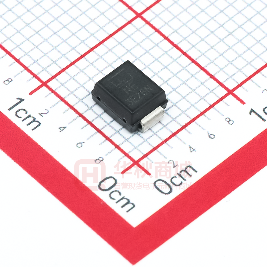

    ESD抑制器/TVS二极管 单向 54V 6.9A 600W SMB(DO-214AA)
SMBJ54A 数据手册
TVS Diodes Surface Mount – 600W > SMBJ series SMBJ Series RoHS Pb e3 Description The SMBJ series is designed specifically to protect sensitive electronic equipment from voltage transients induced by lightning and other transient voltage events. Uni-directional Features Bi-directional Agency Approvals Agency Agency File Number E230531 Maximum Ratings and Thermal Characteristics (TA=25OC unless otherwise noted) Parameter Peak Pulse Power Dissipation(Fig.2) by 10/1000us Test Waveform(Fig.4) (Note 1),(Note 2)-Single Die Parts Peak Pulse Power Dissipation(Fig.2) by 10/1000us Test Waveform(Fig.4) (Note 1), (Note 2)-Stacked Die Parts (Note 5) Power Dissipation on Infinite Heat Sink at TL=50OC Peak Forward Surge Current, 8.3ms Single Half Sine Wave (Note 3) Maximum Instantaneous Forward Voltage at 50A for Unidirectional Only (Note 4) Operating Temperature Range Symbol Value Unit PPPM 600 W PPPM 800 W PD 5.0 W IFSM 100 A VF 3.5/5.0 V °C TJ -65 to 150 Storage Temperature Range TSTG -65 to 175 °C Typical Thermal Resistance Junction to Lead RƟJL 20 °C/W Typical Thermal Resistance Junction to Ambient RƟJA 100 °C/W Notes: 1. Non-repetitive current pulse , per Fig. 4 and derated above TJ (initial) =25OC per Fig. 3. 2. Mounted on copper pad area of 0.2x0.2” (5.0 x 5.0mm) to each terminal. 3. Measured on 8.3ms single half sine wave or equivalent square wave for unidirectional device only, duty cycle=4 per minute maximum. 4. VF < 3.5V for single die parts and VF< 5.0V for stacked-die parts. 5. For stacked die component details, please refer to part numbers labeled by * in Electrical Characteristics. Functional Diagram • Excellent clamping capability • Low incremental surge resistance • Typical IR less than 1μA when VBR min>12V • For surface mounted applications to optimize board space • Low profile package • Typical failure mode is short from over-specified voltage or current • Whisker test is conducted based on JEDEC JESD201A per its table 4a and 4c • IEC-61000-4-2 ESD 30kV(Air), 30kV (Contact) • ESD protection of data lines in accordance with IEC 61000-4-2 • EFT protection of data lines in accordance with IEC 61000-4-4 • Built-in strain relief • Fast response time: typically less than 1.0ps from 0V to VBR min • 600W peak pulse power capability at 10/1000μs waveform, repetition rate (duty cycles):0.01% • High temperature to reflow soldering guaranteed: 260°C/30sec • VBR @ TJ= VBR@25°C x (1+αT x (TJ - 25)) (αT:Temperature Coefficient, typical value is 0.1%) • UL Recognized compound meeting flammability classification V-0 • Meet MSL level1, per J-STD-020, LF maximun peak of 260°C • Matte tin lead–free plated • Halogen free and RoHS compliant • Pb-free E3 means 2nd level interconnect is Pbfree and the terminal finish material is tin(Sn) (IPC/ JEDEC J-STD-609A.01) • UL Recognized to ANSI/ UL 497B: Protectors for Data Communications and Fire-Alarm Circuits. Applications TVS components are ideal for the protection of I/O Interfaces, VCC bus and other vulnerable circuits used in Telecom, Computer, Industrial and Consumer electronic applications. Bi-directional Cathode Anode Uni-directional © 2020 Littelfuse, Inc. Specifications are subject to change without notice. Revised: 06/03/20 TVS Diodes Surface Mount – 600W > SMBJ series Electrical Characteristics (T =25°C unless otherwise noted) A Part Number (Uni) Part Number (Bi) SMBJ5.0A SMBJ6.0A SMBJ6.5A SMBJ7.0A SMBJ7.5A SMBJ8.0A SMBJ8.5A SMBJ9.0A SMBJ10A SMBJ11A SMBJ12A SMBJ13A SMBJ14A SMBJ15A SMBJ16A SMBJ17A SMBJ18A SMBJ20A SMBJ22A SMBJ24A SMBJ26A SMBJ28A SMBJ30A SMBJ33A SMBJ36A SMBJ40A SMBJ43A SMBJ45A SMBJ48A SMBJ51A SMBJ54A SMBJ58A SMBJ60A SMBJ64A SMBJ70A SMBJ75A SMBJ78A SMBJ85A SMBJ90A SMBJ100A SMBJ110A SMBJ120A SMBJ130A SMBJ150A SMBJ160A SMBJ170A SMBJ180A SMBJ188A SMBJ200A SMBJ220A SMBJ250A SMBJ300A* SMBJ350A* SMBJ400A* SMBJ440A* SMBJ5.0CA SMBJ6.0CA SMBJ6.5CA SMBJ7.0CA SMBJ7.5CA SMBJ8.0CA SMBJ8.5CA SMBJ9.0CA SMBJ10CA SMBJ11CA SMBJ12CA SMBJ13CA SMBJ14CA SMBJ15CA SMBJ16CA SMBJ17CA SMBJ18CA SMBJ20CA SMBJ22CA SMBJ24CA SMBJ26CA SMBJ28CA SMBJ30CA SMBJ33CA SMBJ36CA SMBJ40CA SMBJ43CA SMBJ45CA SMBJ48CA SMBJ51CA SMBJ54CA SMBJ58CA SMBJ60CA SMBJ64CA SMBJ70CA SMBJ75CA SMBJ78CA SMBJ85CA SMBJ90CA SMBJ100CA SMBJ110CA SMBJ120CA SMBJ130CA SMBJ150CA SMBJ160CA SMBJ170CA SMBJ180CA SMBJ188CA SMBJ200CA SMBJ220CA SMBJ250CA SMBJ300CA* SMBJ350CA* SMBJ400CA* SMBJ440CA* Marking UNI BI KE KG KK KM KP KR KT KV KX KZ LE LG LK LM LP LR LT LV LX LZ ME MG MK MM MP MR MT MV MX MZ NE NG NK NM NP NR NT NV NX NZ PE PG PK PM PP PR PT PB PV PX PZ QE QG QK QM AE AG AK AM AP AR AT AV AX AZ BE BG BK BM BP BR BT BV BX BZ CE CG CK CM CP CR CT CV CX CZ DE DG DK DM DP DR DT DV DX DZ EE EG EK EM EP ER ET EB EV EX EZ FE FG FK FM Reverse Stand off Voltage VR (Volts) 5.0 6.0 6.5 7.0 7.5 8.0 8.5 9.0 10.0 11.0 12.0 13.0 14.0 15.0 16.0 17.0 18.0 20.0 22.0 24.0 26.0 28.0 30.0 33.0 36.0 40.0 43.0 45.0 48.0 51.0 54.0 58.0 60.0 64.0 70.0 75.0 78.0 85.0 90.0 100.0 110.0 120.0 130.0 150.0 160.0 170.0 180.0 188.0 200.0 220.0 250.0 300.0 350.0 400.0 440.0 Breakdown Voltage VBR (Volts) @ IT Test Current IT MIN MAX (mA) 6.40 6.67 7.22 7.78 8.33 8.89 9.44 10.00 11.10 12.20 13.30 14.40 15.60 16.70 17.80 18.90 20.00 22.20 24.40 26.70 28.90 31.10 33.30 36.70 40.00 44.40 47.80 50.00 53.30 56.70 60.00 64.40 66.70 71.10 77.80 83.30 86.70 94.40 100.00 111.00 122.00 133.00 144.00 167.00 178.00 189.00 201.00 209.00 224.00 246.00 279.00 335.00 391.00 447.00 492.00 7.00 7.37 7.98 8.60 9.21 9.83 10.40 11.10 12.30 13.50 14.70 15.90 17.20 18.50 19.70 20.90 22.10 24.50 26.90 29.50 31.90 34.40 36.80 40.60 44.20 49.10 52.80 55.30 58.90 62.70 66.30 71.20 73.70 78.60 86.00 92.10 95.80 104.00 111.00 123.00 135.00 147.00 159.00 185.00 197.00 209.00 222.00 231.00 247.00 272.00 309.00 371.00 432.00 494.00 543.00 10 10 10 10 1 1 1 1 1 1 1 1 1 1 1 1 1 1 1 1 1 1 1 1 1 1 1 1 1 1 1 1 1 1 1 1 1 1 1 1 1 1 1 1 1 1 1 1 1 1 1 1 1 1 1 Maximum Maximum Maximum Clamping Reverse Peak Voltage VC Leakage IR Pulse Current @ Ipp @ VR Ipp (A) (V) (µA) 9.2 10.3 11.2 12.0 12.9 13.6 14.4 15.4 17.0 18.2 19.9 21.5 23.2 24.4 26.0 27.6 29.2 32.4 35.5 38.9 42.1 45.4 48.4 53.3 58.1 64.5 69.4 72.7 77.4 82.4 87.1 93.6 96.8 103.0 113.0 121.0 126.0 137.0 146.0 162.0 177.0 193.0 209.0 243.0 259.0 275.0 292.0 304.0 324.0 356.0 405.0 486.0 567.0 648.0 713.0 65.3 58.3 53.6 50.0 46.6 44.2 41.7 39.0 35.3 33.0 30.2 28.0 25.9 24.6 23.1 21.8 20.6 18.6 16.9 15.5 14.3 13.3 12.4 11.3 10.4 9.3 8.7 8.3 7.8 7.3 6.9 6.5 6.2 5.9 5.3 5.0 4.8 4.4 4.1 3.7 3.4 3.1 2.9 2.5 2.3 2.2 2.1 2.0 1.9 1.7 1.5 1.7 1.5 1.3 1.1 800 800 500 200 100 50 20 10 5 1 1 1 1 1 1 1 1 1 1 1 1 1 1 1 1 1 1 1 1 1 1 1 1 1 1 1 1 1 1 1 1 1 1 1 1 1 1 1 1 1 1 1 1 1 1 Agency Maximum Temperature Approval coefficient of VBR (%/C) 0.041 0.046 0.052 0.058 0.061 0.064 0.066 0.069 0.071 0.074 0.075 0.076 0.080 0.083 0.084 0.085 0.088 0.091 0.092 0.092 0.093 0.094 0.096 0.097 0.098 0.099 0.100 0.101 0.101 0.101 0.102 0.103 0.103 0.104 0.105 0.106 0.106 0.106 0.107 0.107 0.107 0.108 0.108 0.108 0.108 0.108 0.108 0.110 0.110 0.110 0.110 0.112 0.112 0.112 0.112 X X X X X X X X X X X X X X X X X X X X X X X X X X X X X X X X X X X X X X X X X X X X X X X X X X X X X X X Notes: For bidirectional type having VR of 10 volts and less, the IR limit is double. For stack-die parts, use * to label the part number. © 2020 Littelfuse, Inc. Specifications are subject to change without notice. Revised: 06/03/20 TVS Diodes Surface Mount – 600W > SMBJ series I-V Curve Characteristics Bi-directional Uni-directional Ipp Vc VBR VR V IR VF IT IT IR Vc VBR VR IR IT Ipp Ipp PPPM VR VBR VC IR VF V VR VBR Vc Peak Pulse Power Dissipation -- Max power dissipation Stand-off Voltage -- Maximum voltage that can be applied to the TVS without operation Breakdown Voltage -- Maximum voltage that flows though the TVS at a specified test current (IT) Clamping Voltage -- Peak voltage measured across the TVS at a specified Ippm (peak impulse current) Reverse Leakage Current -- Current measured at VR Forward Voltage Drop for Uni-directional Ratings and Characteristic Curves (T =25°C unless otherwise noted) A Figure 1 - TVS Transients Clamping Waveform Figure 2 - Peak Pulse Power Rating Voltage Transients PPPM-Peak Pulse Power (kW) 100 Voltage or Current Voltage Across TVS Current Through TVS Time TJ initial = Tamb stacked-die, 800W at 10/1000µs, 25°C 10 1 0.1 0.001 Single die,600W at 10/1000µs, 25°C 0.01 0.1 1 10 td-Pulse Width (ms) © 2020 Littelfuse, Inc. Specifications are subject to change without notice. Revised: 06/03/20 TVS Diodes Surface Mount – 600W > SMBJ series Ratings and Characteristic Curves (T =25°C unless otherwise noted) (Continued) A Figure 3 - Peak Pulse Power Derating Curve Figure 4 - Pulse Waveform 150 IPPM- Peak Pulse Current, % IRSM Peak Pulse Power (PPP) or Current (IPP) Derating in Percentage % 100 80 60 40 20 0 0 25 50 75 100 125 150 TJ - Initial Junction Temperature (ºC) Half Value IPPM IPPM ( ) 2 50 0 10/1000µsec. Waveform as defined by R.E.A td 1.0 0 2.0 3.0 4.0 t-Time (ms) Figure 6 - Typical Transient Thermal Impedance 1000 10000.00 Transient Thermal Impedance (°C/W) Uni-direconal V=0V Bi-direconal V=0V 1000.00 Cj(pf) TJ=25°C Pulse Width(td) is defined as the point where the peak current decays to 50% of IPPM Peak Value IPPM 100 175 Figure 5 - Typical Junction Capacitance 100.00 Uni-direconal Bi-direconal V=VR 10.00 1.00 1.00 10.00 100.00 VBR—Reverse Breakdown Voltage(V) 100 10 1 0.1 0.001 1000.00 0.01 0.1 1 10 100 1000 TP - Pulse Duration (s) Figure 7 - Maximum Non-Repetitive Peak Forward Surge Current Uni-Directional Only Figure 8 - Peak Forward Voltage Drop vs Peak Forward Current (Typical Values) 100.0 120 Single die 100 IF - Peak Forward Current(A) IFSM - Peak Forward Surge Current (A) tr=10µsec 80 60 40 Stacked-die 10.0 1.0 20 0 1 10 Number of Cycles at 60 Hz 100 0.1 0.0 1.0 2.0 3.0 4.0 5.0 6.0 7.0 8.0 9.0 VF - Peak Forward Voltage(V) © 2020 Littelfuse, Inc. Specifications are subject to change without notice. Revised: 06/03/20 TVS Diodes Surface Mount – 600W > SMBJ series Soldering Parameters Lead–free assembly Pre Heat - Temperature Min (Ts(min)) 150°C - Temperature Max (Ts(max)) 200°C - Time (min to max) (ts) 60 – 120 secs Average ramp up rate (Liquidus Temp (TL) to peak 3°C/second max TS(max) to TL - Ramp-up Rate 3°C/second max Reflow 217°C - Temperature (TL) (Liquidus) 60 – 150 seconds - Time (min to max) (tL) Peak Temperature (TP) 260+0/-5 °C Time within 5°C of actual peak Temperature (tp) 30 seconds max Ramp-down Rate 6°C/second max Time 25°C to peak Temperature (TP) 8 minutes Max. Do not exceed 260°C tp TP Ramp-up TL Temperature (T) Reflow Condition tL Ts(max) Ramp-down Ts(min) ts Preheat 25˚C t 25˚C to Peak Time (t) Environmental Specifications Physical Specifications High Temp. Storage JESD22-A103 HTRB JESD22-A108 Polarity 0.003 ounce, 0.093 grams JEDEC DO214AA. Molded plastic body over glass passivated junction Color band denotes cathode except Bidirectional Temperature Cycling JESD22-A104 Terminal Matte Tin-plated leads, Solderable per JESD22-B102 MSL JEDEC-J-STD-020, Level 1 H3TRB JESD22-A101 RSH JESD22-A111 Weight Case Critical Zone TL to TP Dimensions DO-214AA (SMB J-Bend) Cathode Band (for Uni-directional products only) C A B H D F E Dimensions Inches Millimeters Min Max Min Max A 0.076 0.086 1.930 2.200 B 0.160 0.187 4.060 4.750 C 0.130 0.155 3.300 3.940 D 0.078 0.103 1.990 2.610 E 0.030 0.060 0.760 1.520 F - 0.008 - 0.203 G 0.205 0.220 5.210 5.590 H 0.006 0.012 0.152 0.305 I 0.089 - 2.260 - J 0.085 - 2.160 - K - 0.107 - 2.740 L 0.085 - 2.160 - G J K L I Solder Pads (all dimensions in mm) © 2020 Littelfuse, Inc. Specifications are subject to change without notice. Revised: 06/03/20 TVS Diodes Surface Mount – 600W > SMBJ series Part Numbering System SMBJ Part Marking System XXX C A Cathode Band F (for uni-directional products only) 5% VBR Voltage Tolerance XX Bi-Directional YMXXX VR Voltage Littelfuse Logo Marking Code Trace Code Marking Y:Year Code M: Month Code XXX: Lot Code Series Packaging Part number Component Package Quantity Packaging Option Packaging Specification SMBJxxxXX DO-214AA 3000 Tape & Reel - 12mm tape/13” reel EIA STD RS-481 Tape and Reel Specification 0.157 (4.0) 0.47 (12.0) Cathode 0.315 (8.0) 0.059 DIA (1.5) Cover tape 13.0 (330) 0.80 (20.2) Arbor Hole Dia. 0.49 (12.5) Dimensions are in inches (and millimeters). Direction of Feed Disclaimer Notice - Information furnished is believed to be accurate and reliable. However, users should independently evaluate the suitability of and test each product selected for their own applications. Littelfuse products are not designed for, and may not be used in, all applications. Read complete Disclaimer Notice at: www.littelfuse.com/disclaimer-electronics. © 2020 Littelfuse, Inc. Specifications are subject to change without notice. Revised: 06/03/20
SMBJ54A
物料型号:文档列出了多种型号的单向(Uni-directional)和双向(Bi-directional)瞬态电压抑制二极管。
器件简介:SMBJ系列瞬态电压抑制二极管设计用于保护电子设备免受由雷击和其他瞬态电压事件引起的电压瞬变影响。
引脚分配:文档中没有明确提供引脚分配图,但提到了器件为表面贴装应用设计,以优化板空间。
参数特性:包括600W的峰值脉冲功率能力、高温回流焊接保证(260°C/30秒)、低轮廓封装、快速响应时间(从0V到VBR最小值通常小于1.0ps)等。
功能详解:TVS组件适用于电信、计算机、工业和消费电子应用中的I/O接口、VCC总线和其他易受攻击电路的保护。
应用信息:适用于多种电子应用,以保护敏感电子设备免受电压瞬变的影响。
封装信息:提供了详细的物理规格、环境规格、尺寸和包装选项,包括JEDEC DO214AA塑封体、重量、极性、端子等信息。
