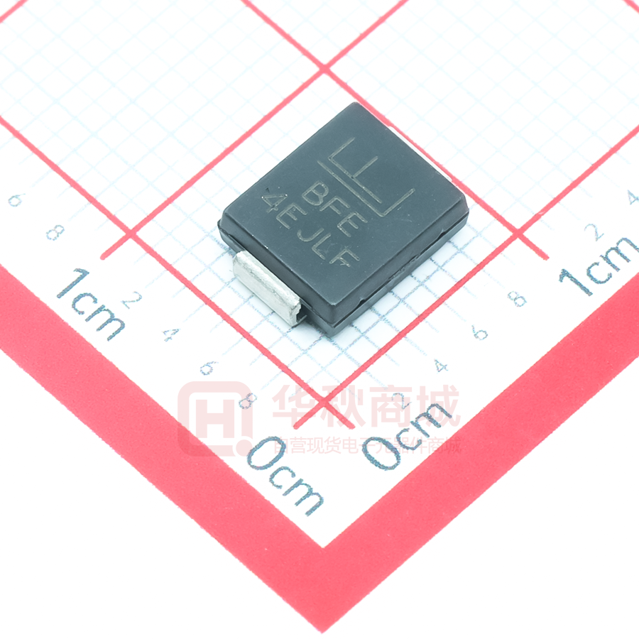

SMCJ26CA
SMCJ26CA
    HAMLIN
    SMC(DO-214AB)
    VR=26V,Vc=42.1V,Ipp=35.7A 双向
SMCJ26CA 数据手册
