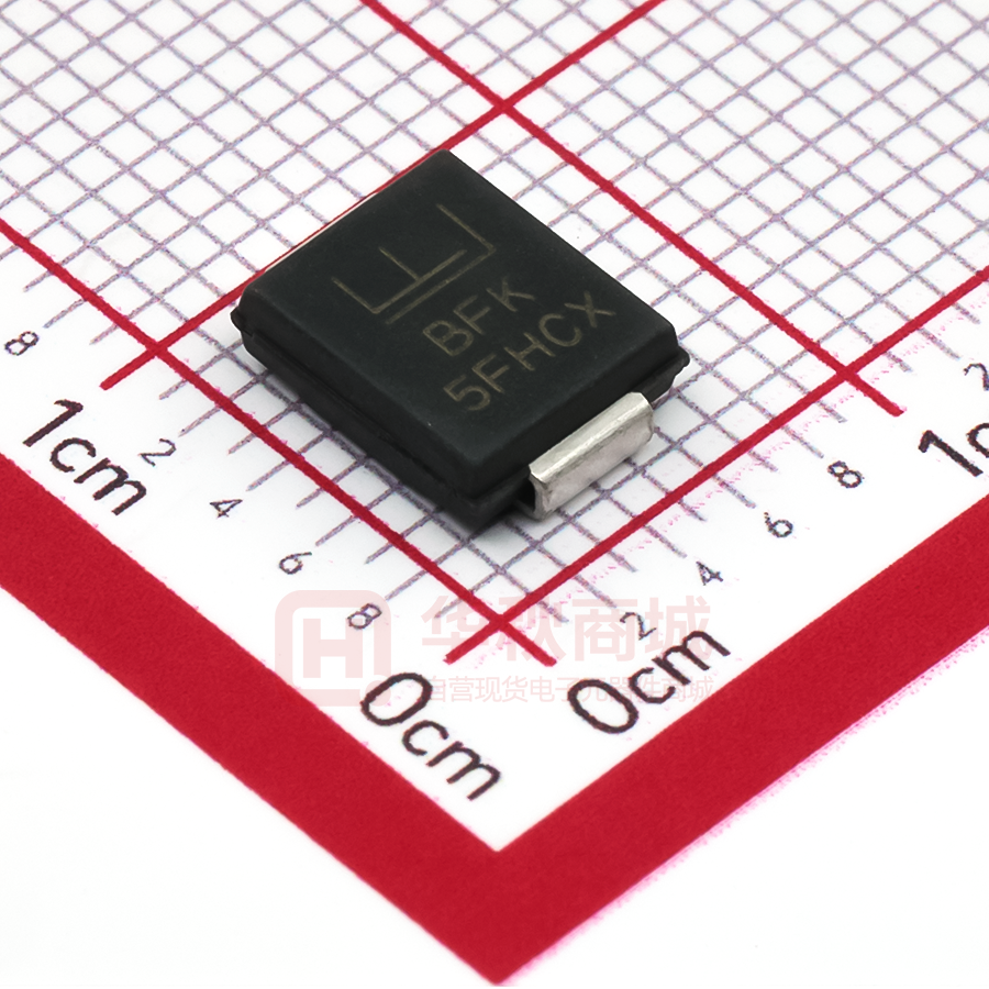

    ESD抑制器/TVS二极管 VRWM=30V VBR(min)=33.3V VC=48.4V@IPP=31A SMC
SMCJ30CA 数据手册
TVS Diodes Surface Mount – 1500W > SMCJ series SMCJ Series RoHS Pb e3 Description The SMCJ series is designed specifically to protect sensitive electronic equipment from voltage transients induced by lightning and other transient voltage events. Uni-directional Bi-directional Agency Approvals Agency Agency File Number E230531 Maximum Ratings and Thermal Characteristics (TA=25OC unless otherwise noted) Parameter Peak Pulse Power Dissipation(Fig.2) by 10/1000us Test Waveform(Fig.4) (Note 1),(Note 2)-Single Die Parts Peak Pulse Power Dissipation(Fig.2) by 10/1000us Test Waveform(Fig.4) (Note 1), (Note 2)-Stacked Die Parts (Note 5) Symbol Value Unit PPPM 1500 W PPPM 2000 W Power Dissipation on Infinite Heat Sink at TL=50OC PD 6.5 W Peak Forward Surge Current, 8.3ms Single Half Sine Wave (Note 3) IFSM 200 A Maximum Instantaneous Forward Voltage at 100A for Unidirectional Only (Note 4) VF 3.5/5.0 V TJ -65 to 150 °C TSTG -65 to 175 °C Operating Temperature Range Storage Temperature Range Typical Thermal Resistance Junction to Lead RθJL 15 °C/W Typical Thermal Resistance Junction to Ambient RθJA 75 °C/W Notes: 1. Non-repetitive current pulse , per Fig. 4 and derated above TJ (initial) =25OC per Fig. 3. 2. Mounted on copper pad area of 0.31x0.31” (8.0 x 8.0mm) to each terminal. 3. Measured on 8.3ms single half sine wave or equivalent square wave for unidirectional device only, duty cycle=4 per minute maximum. 4. VF < 3.5V for single die parts and VF< 5.0V for stacked-die parts. 5. For stacked die component details, please refer to part numbers labeled by * in Electrical Characteristics. Functional Diagram Features • 1500W peak pulse power capability at 10/1000μs waveform, repetition rate (duty cycles):0.01% • Excellent clamping capability • Low incremental surge resistance • Typical IR less than 1μA when VBR min>12V • For surface mounted applications to optimize board space • Low profile package • Built-in strain relief • Typical failure mode is short from over-specified voltage or current • Whisker test is conducted based on JEDEC JESD201A per its table 4a and 4c • IEC 61000-4-2 ESD 30kV(Air), 30kV (Contact) • ESD protection of data lines in accordance with IEC 61000-4-2 • EFT protection of data lines in accordance with IEC 61000-4-4 • Fast response time: typically less than 1.0ps from 0V to BV min • Glass passivated chip junction • High temperature to reflow soldering guaranteed: 260°C/30sec • VBR @ TJ= VBR@25°C x (1+αT x (TJ - 25)) (αT:Temperature Coefficient, typical value is 0.1%) • Plastic package is flammability rated V-0 per Underwriters Laboratories • Meet MSL level1, per J-STD-020, LF maximun peak of 260°C • Matte tin lead–free plated • Halogen free and RoHS compliant • Pb-free E3 means 2nd level interconnect is Pbfree and the terminal finish material is tin(Sn) (IPC/ JEDEC J-STD-609A.01) Applications TVS devices are ideal for the protection of I/O Interfaces, VCC bus and other vulnerable circuits used in Telecom, Computer, Industrial and Consumer electronic applications. Additional Infomarion Bi-directional Datasheet Cathode Resources Samples Anode Uni-directional © 2020 Littelfuse, Inc. Specifications are subject to change without notice. Revised: JC.10/29/20 TVS Diodes Surface Mount – 1500W > SMCJ series Electrical Characteristics (T =25°C unless otherwise noted) A Part Number (Uni) SMCJ5.0A SMCJ6.0A SMCJ6.5A SMCJ7.0A SMCJ7.5A SMCJ8.0A SMCJ8.5A SMCJ9.0A SMCJ10A SMCJ11A SMCJ12A SMCJ13A SMCJ14A SMCJ15A SMCJ16A SMCJ17A SMCJ18A SMCJ20A SMCJ22A SMCJ24A SMCJ26A SMCJ28A SMCJ30A SMCJ33A SMCJ36A SMCJ40A SMCJ43A SMCJ45A SMCJ48A SMCJ51A SMCJ54A SMCJ58A SMCJ60A SMCJ64A SMCJ70A SMCJ75A SMCJ78A SMCJ85A SMCJ90A SMCJ100A SMCJ110A SMCJ120A SMCJ130A SMCJ150A SMCJ160A SMCJ170A SMCJ180A SMCJ200A SMCJ220A SMCJ250A SMCJ300A* SMCJ350A* SMCJ400A* SMCJ440A* Part Number (Bi) SMCJ5.0CA SMCJ6.0CA SMCJ6.5CA SMCJ7.0CA SMCJ7.5CA SMCJ8.0CA SMCJ8.5CA SMCJ9.0CA SMCJ10CA SMCJ11CA SMCJ12CA SMCJ13CA SMCJ14CA SMCJ15CA SMCJ16CA SMCJ17CA SMCJ18CA SMCJ20CA SMCJ22CA SMCJ24CA SMCJ26CA SMCJ28CA SMCJ30CA SMCJ33CA SMCJ36CA SMCJ40CA SMCJ43CA SMCJ45CA SMCJ48CA SMCJ51CA SMCJ54CA SMCJ58CA SMCJ60CA SMCJ64CA SMCJ70CA SMCJ75CA SMCJ78CA SMCJ85CA SMCJ90CA SMCJ100CA SMCJ110CA SMCJ120CA SMCJ130CA SMCJ150CA SMCJ160CA SMCJ170CA SMCJ180CA SMCJ200CA SMCJ220CA SMCJ250CA SMCJ300CA* SMCJ350CA* SMCJ400CA* SMCJ440CA* Marking UNI BI GDE GDG GDK GDM GDP GDR GDT GDV GDX GDZ GEE GEG GEK GEM GEP GER GET GEV GEX GEZ GFE GFG GFK GFM GFP GFR GFT GFV GFX GFZ GGE GGG GGK GGM GGP GGR GGT GGV GGX GGZ GHE GHG GHK GHM GHP GHR GHT GHV GHX GHZ GJE GJG GJK GJM BDE BDG BDK BDM BDP BDR BDT BDV BDX BDZ BEE BEG BEK BEM BEP BER BET BEV BEX BEZ BFE BFG BFK BFM BFP BFR BFT BFV BFX BFZ BGE BGG BGK BGM BGP BGR BGT BGV BGX BGZ BHE BHG BHK BHM BHP BHR BHT BHV BHX BHZ BJE BJG BJK BJM Reverse Stand off Voltage VR (Volts) 5.0 6.0 6.5 7.0 7.5 8.0 8.5 9.0 10.0 11.0 12.0 13.0 14.0 15.0 16.0 17.0 18.0 20.0 22.0 24.0 26.0 28.0 30.0 33.0 36.0 40.0 43.0 45.0 48.0 51.0 54.0 58.0 60.0 64.0 70.0 75.0 78.0 85.0 90.0 100.0 110.0 120.0 130.0 150.0 160.0 170.0 180.0 200.0 220.0 250.0 300.0 350.0 400.0 440.0 Breakdown Voltage VBR (Volts) @ IT MIN MAX (mA) Maximum Clamping Voltage VC @ Ipp (V) 6.40 6.67 7.22 7.78 8.33 8.89 9.44 10.00 11.10 12.20 13.30 14.40 15.60 16.70 17.80 18.90 20.00 22.20 24.40 26.70 28.90 31.10 33.30 36.70 40.00 44.40 47.80 50.00 53.30 56.70 60.00 64.40 66.70 71.10 77.80 83.30 86.70 94.40 100.00 111.00 122.00 133.00 144.00 167.00 178.00 189.00 201.00 224.00 246.00 279.00 335.00 391.00 447.00 492.00 7.00 7.37 7.98 8.60 9.21 9.83 10.40 11.10 12.30 13.50 14.70 15.90 17.20 18.50 19.70 20.90 22.10 24.50 26.90 29.50 31.90 34.40 36.80 40.60 44.20 49.10 52.80 55.30 58.90 62.70 66.30 71.20 73.70 78.60 86.00 92.10 95.80 104.00 111.00 123.00 135.00 147.00 159.00 185.00 197.00 209.00 222.00 247.00 272.00 309.00 371.00 432.00 494.00 543.00 10 10 10 10 1 1 1 1 1 1 1 1 1 1 1 1 1 1 1 1 1 1 1 1 1 1 1 1 1 1 1 1 1 1 1 1 1 1 1 1 1 1 1 1 1 1 1 1 1 1 1 1 1 1 9.2 10.3 11.2 12.0 12.9 13.6 14.4 15.4 17.0 18.2 19.9 21.5 23.2 24.4 26.0 27.6 29.2 32.4 35.5 38.9 42.1 45.4 48.4 53.3 58.1 64.5 69.4 72.7 77.4 82.4 87.1 93.6 96.8 103.0 113.0 121.0 126.0 137.0 146.0 162.0 177.0 193.0 209.0 243.0 259.0 275.0 292.0 324.0 356.0 405.0 486.0 567.0 648.0 713.0 Test Current IT Maximum Peak Pulse Current Ipp (A) Maximum Reverse Leakage IR @ VR (µA) Agency Approval 163.0 145.7 134.0 125.0 116.3 110.3 104.2 97.4 88.3 82.5 75.4 69.8 64.7 61.5 57.7 54.4 51.4 46.3 42.3 38.6 35.7 33.1 31.0 28.2 25.9 23.3 21.7 20.6 19.4 18.2 17.3 16.1 15.5 14.6 13.3 12.4 11.9 11.0 10.3 9.3 8.5 7.8 7.2 6.2 5.8 5.5 5.1 4.6 4.2 3.7 4.1 3.5 3.0 2.8 800 800 500 200 100 50 20 10 5 1 1 1 1 1 1 1 1 1 1 1 1 1 1 1 1 1 1 1 1 1 1 1 1 1 1 1 1 1 1 1 1 1 1 1 1 1 1 1 1 1 1 1 1 1 X X X X X X X X X X X X X X X X X X X X X X X X X X X X X X X X X X X X X X X X X X X X X X X X X X X X X X For bidirectional type having VR of 10 volts and less, the IR limit is double. For parts without A , the VBR is ± 10% and VC is 5% higher than with A parts, the parts without A are currently available, but not recommended for new designs. The parts with A are preferred. For stack-die parts, use * to label the part number. © 2020 Littelfuse, Inc. Specifications are subject to change without notice. Revised: JC.10/29/20 TVS Diodes Surface Mount – 1500W > SMCJ series I-V Curve Characteristics Uni-directional Bi-directional Ipp Vc VBR VR V IR VF IT IT IR Vc VBR VR IR IT Ipp PPPM VR VBR VC IR VF VR VBR Vc V Ipp Peak Pulse Power Dissipation -- Max power dissipation Stand-off Voltage -- Maximum voltage that can be applied to the TVS without operation Breakdown Voltage -- Maximum voltage that flows though the TVS at a specified test current (IT) Clamping Voltage -- Peak voltage measured across the TVS at a specified Ippm (peak impulse current) Reverse Leakage Current -- Current measured at VR Forward Voltage Drop for Uni-directional Ratings and Characteristic Curves (T =25°C unless otherwise noted) A Figure 1 - TVS Transients Clamping Waveform Figure 2 - Peak Pulse Power Rating 100 PPPM-Peak Pulse Power (kW) Voltage Transients Voltage or Current Voltage Across TVS Current Through TVS TJ initial = Tamb 1 0.1 0.001 Time stacked-die, 2kW at 10x1000µs, 25°C 10 Single die, 1.5kW at 10x1000µs, 25°C 0.01 0.1 1 10 td-Pulse Width (ms) © 2020 Littelfuse, Inc. Specifications are subject to change without notice. Revised: JC.10/29/20 TVS Diodes Surface Mount – 1500W > SMCJ series Ratings and Characteristic Curves (T =25°C unless otherwise noted) (Continued) A Figure 4 - Pulse Waveform Figure 3 - Peak Pulse Power Derating Curve 150 IPPM- Peak Pulse Current, % IRSM Peak Pulse Power (PPP) or Current (IPP) Derating in Percentage % 100 80 60 40 20 0 0 25 50 75 100 125 150 TJ - Initial Junction Temperature (ºC) Uni-directional V=VR 100 Bi-directional V=VR 1 10 100 2 50 0 10/1000µsec. Waveform as defined by R.E.A td 1.0 0 3.0 4.0 1000 10 1 0.1 0.01 0.001 0.01 0.1 VBR - Reverse Breakdown Voltage(V) 1 10 100 1000 TP - Pulse Duration (s) Figure 7 - Maximum Non-Repetitive Peak Forward Surge Current Uni-Directional Only Figure 8 - Peak Forward Voltage Drop vs Peak Forward Current (Typical Values) 100.0 200 Single die 180 IF- Peak Forward Current(A) IFSM - Peak Forward Surge Current (A) 2.0 100 Transient Thermal Impedance (°C/W) Cj(pF) Bi-directional V=0V 1 ( ) Figure 6 - Typical Transient Thermal Impedance Uni-directional V=0V 10 Half Value IPPM IPPM t-Time (ms) 100000 1000 TJ=25°C Pulse Width(td) is defined as the point where the peak current decays to 50% of IPPM Peak Value IPPM 100 175 Figure 5 - Typical Junction Capacitance 10000 tr=10µsec 160 140 120 100 80 60 40 Stacked-die 10.0 1.0 20 0 1 10 Number of Cycles at 60 Hz 100 0.1 0.0 1.0 2.0 3.0 4.0 5.0 6.0 7.0 8.0 9.0 VF-Peak Forward Voltage(V) © 2020 Littelfuse, Inc. Specifications are subject to change without notice. Revised: JC.10/29/20 TVS Diodes Surface Mount – 1500W > SMCJ series Soldering Parameters Lead–free assembly Pre Heat - Temperature Min (Ts(min)) 150°C - Temperature Max (Ts(max)) 200°C - Time (min to max) (ts) 60 – 120 secs Ramp-up TL Average ramp up rate (Liquidus Temp (TL) to peak 3°C/second max TS(max) to TL - Ramp-up Rate 3°C/second max Reflow - Temperature (TL) (Liquidus) 217°C - Time (min to max) (tL) 60 – 150 seconds Peak Temperature (TP) 260 Time within 5°C of actual peak Temperature (tp) 30 seconds max Ramp-down Rate 6°C/second max Time 25°C to peak Temperature (TP) 8 minutes Max. Do not exceed 260°C +0/-5 Case Polarity Terminal tL Critical Zone TL to TP Ts(max) Ramp-down Ts(min) ts Preheat °C Physical Specifications Weight tp TP Temperature (T) Reflow Condition 25˚C t 25˚C to Peak Time (t) Environmental Specifications 0.007 ounce, 0.21 grams JEDEC DO214AB. Molded plastic body over glass passivated junction Color band denotes positive end (cathode) except Bidirectional. Matte Tin-plated leads, Solderable per JESD22-B102 High Temp. Storage JESD22-A103 HTRB JESD22-A108 Temperature Cycling JESD22-A104 MSL JEDEC-J-STD-020, Level 1 H3TRB JESD22-A101 RSH JESD22-A111 Dimensions DO-214AB (SMC J-Bend) Dimensions Cathode Band (for uni-directional products only) A C A B H D J F E G Dimensions in inches and (millimeters) K L Inches Millimeters Min Max Min Max 0.114 0.126 2.900 3.200 B 0.260 0.280 6.600 7.110 C 0.220 0.245 5.590 6.220 2.620 D 0.079 0.103 2.060 E 0.030 0.060 0.760 1.520 F - 0.008 - 0.203 G 0.305 0.320 7.750 8.130 H 0.006 0.012 0.152 0.305 - I 0.129 - 3.300 J 0.094 - 2.400 - K - 0.165 - 4.200 L 0.094 - 2.400 - I Solder Pads (all dimensions in mm) © 2020 Littelfuse, Inc. Specifications are subject to change without notice. Revised: JC.10/29/20 TVS Diodes Surface Mount – 1500W > SMCJ series Part Numbering System SMCJ Part Marking System XXX C A Cathode Band F (for uni-directional products only) 5% VBR Voltage Tolerance Littelfuse Logo XXX Bi-Directional YMXXX VR Voltage Marking Code Trace Code Marking Y:Year Code M: Month Code XXX: Lot Code Series Packaging Part number Component Package Quantity Packaging Option Packaging Specification SMCJxxxXX DO-214AB 3000 Tape & Reel - 16mm tape/13” reel EIA STD RS-481 Tape and Reel Specification 0.157 (4.0) 0.63 (16.0) 0.315 (8.0) 0.059 DIA (1.5) Cover tape 13.0 (330) 0.80 (20.2) Arbor Hole Dia. 0.65 (16.4) Dimensions are in inches (and millimeters). Cathode Direction of Feed Disclaimer Notice - Information furnished is believed to be accurate and reliable. However, users should independently evaluate the suitability of and test each product selected for their own applications. Littelfuse products are not designed for, and may not be used in, all applications. Read complete Disclaimer Notice at www.littelfuse.com/disclaimer-electronics. © 2020 Littelfuse, Inc. Specifications are subject to change without notice. Revised: JC.10/29/20
SMCJ30CA
物料型号:Littelfuse的TVS二极管,SMCJ系列。
器件简介:SMCJ系列是专为保护敏感电子设备免受雷电和其他瞬态电压事件引起的电压瞬态而设计的。
引脚分配:文档中没有明确提到引脚分配,但提到了器件为表面贴装应用设计,以优化板空间。
参数特性: - 1500W的峰值脉冲功率能力,在10/1000μs波形下,重复率(占空比)为0.01%。 - 出色的钳位能力。 - 快速响应时间:从0V到BV最小值典型小于1.0ps。 - 玻璃钝化芯片结。 - 高温度至260°C/30秒的回流焊接保证。
功能详解: - 低增量浪涌阻抗。 - 典型IR小于1μA,当VBR最小值大于12V时。 - 典型故障模式是因电压或电流过规格而短路。 - 须毛测试基于JEDEC JESD201A进行。 - 符合IEC 61000-4-2标准的ESD 30kV(空气),30kV(接触)。 - 符合IEC 61000-4-2标准的数据线ESD保护。 - 符合IEC 61000-4-4标准的数据线EFT保护。
应用信息:TVS器件非常适合用于电信、计算机、工业和消费电子应用中的I/O接口、VCC总线和其他易损电路的保护。
封装信息: - 低轮廓封装。 - 内置的应变缓解。 - 塑料封装的阻燃等级为V-0,根据Underwriters Laboratories标准。 - 符合J-STD-020标准的MSL等级1,LF最大峰值为260°C。 - 无铅镀锡。 - 无卤素,符合RoHS标准。
电气特性表提供了不同型号的TVS二极管的详细电气参数,包括反向立电压、击穿电压、测试电流、最大钳位电压、最大峰值脉冲电流和最大反向漏电流等。
