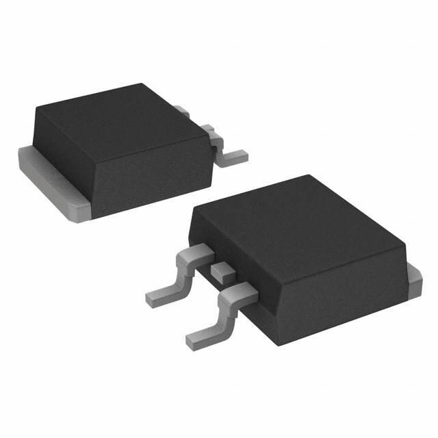

Thyristors Datasheet SVxx20xx Series 20 Amp High Junction Temperature SCRs RoHS Description The SVxx20xx high temperature SCR series is ideal for unidirectional switch applications such as phase control in heating, motor speed controls, converters/rectifiers and inrush current controllers. These SCRs have a low gate current, (IGT) trigger level of 6mA and 10mA maximum at approximately 1.5V for SVxx20x1 and SVxx20x2, respectively. Features & Benefits ■ Halogen free and RoHS compliant ■ 150 °C maximum junction temperature Applications Agency File Number Typical applications include AC Generator (ACG) rectifiers, battery voltage regulators, generic converters and inrush current controller in various AC to DC applications. Additional applications include controls for power tools, home/brown good and white goods appliances. Internally constructed isolated packages offered for ease of heat sinking with high isolation voltage. L Packages: E71639 Main Features Symbol ■ UL Recognized to UL 1557 as an Electrically Isolated Semiconductor Device ■ Surge capability up to 300A at 60Hz half cycle Agency Approval Agency ■ High dv/dt performance Value Unit A IT(RMS) 20 VDRM /VRRM 600 V IGT 6 to 10 mA Schematic Symbol A K G 1 © 2021 Littelfuse, Inc. Specifications are subject to change without notice. Revised: GD.06/16/21 Thyristors Datasheet SVxx20xx Series 20 Amp High Junction Temperature SCRs Absolute Maximum Ratings — 20A SCR Symbol Parameter VDSM/VRSM Peak non-repetitive blocking voltage Test Conditions Value Unit PW=100 μs 800 V 20 A 12.8 A IT(RMS) RMS on-state current IT(AV) Average on-state current ITSM Peak non-repetitive surge current I2 t I2t Value for fusing SVxx20Lx TC = 105 °C SVxx20Rx TC = 130 °C SVxx20Nx SVxx20Lx TC = 105 °C SVxx20Rx TC = 130 °C SVxx20Nx single half cycle; f = 50Hz; TJ (initial) = 25 °C single half cycle; f = 60Hz; TJ (initial) = 25 °C tp = 8.3 ms di/dt Critical rate of rise of on-state current IGM Peak gate current PG(AV) Average gate power dissipation TJ = 150 °C 0.8 W Tstg Storage temperature range -40 to 150 °C TJ Operating junction temperature range -40 to 150 °C 225 A 300 374 A2s f = 60Hz ; TJ = 150 °C 125 A/μs TJ = 150 °C 4 A Note: xx=voltage/10, x=sensitivity Electrical Characteristics (TJ = 25°C, unless otherwise specified) Symbol IGT Test Conditions SVxx20x1 VD = 12V; RL = 60 Ω dv/dt MIN. 2 5 MAX. 6 10 MAX. VGT SVxx20x2 VD = 67%VDRM; gate open; TJ = 125°C MIN. VD = 67% VDRM; gate open; TJ = 150°C 1.5 1.5 400 800 200 400 Unit mA V V/μs VGD VD = VDRM RL = 3.3 kΩ TJ = 110°C MIN. 0.2 0.2 V IH IT = 200mA (initial) MAX. 22 35 mA tq IT=2A; tp=50µs; dv/dt=5V/µs; di/dt=-30A/µs MAX. 25 25 μs tgt IG = 2 x IGT PW = 15µs IT = 40A TYP. 2.6 2.6 μs Note: xx=voltage/10, x=package Static Characteristics Symbol VTM Test Conditions IT = 40A; tp = 380μs Value Unit MAX. 1.6 V MAX. 1000 TJ = 25°C IDRM / IRRM VDRM / VRRM 10 TJ = 125°C TJ = 150°C μA 4000 Thermal Resistances Symbol RØ(JC) Parameter Value SVxx20Rx SVxx20Nx SVxx20Lx Junction to case (AC) 1.0 2.4 Unit °C/W Note: xx=voltage/10, x=sensitivity 2 © 2021 Littelfuse, Inc. Specifications are subject to change without notice. Revised: GD.06/16/21 Thyristors Datasheet SVxx20xx Series 20 Amp High Junction Temperature SCRs Figure 1: Normalized DC Gate Trigger Current vs. Junction Temperature Figure 2: Normalized DC Gate Trigger Voltage vs. Junction Temperature 2.0 1.4 1.8 1.2 Ratio of VGT/VGT(TJ=25˚C) Ratio of IGT/IGT(TJ=25˚C) 1.6 1.4 1.2 1.0 0.8 0.6 0.4 0.6 0.4 0.0 -40 -15 10 35 60 85 110 Junction Temperature (TJ)- ºC 135 150 Figure 3: Normalized DC Holding Current vs. Junction Temperature -40 50 1.8 45 Instantaneous On-State Current(IT) -Amps 2.0 1.4 1.2 1.0 0.8 0.6 0.4 0.2 0.0 -40 -15 10 35 60 85 110 Junction Temperature (TJ)- ºC 135 -15 10 35 60 85 110 Junction Temperature (TJ)- ºC 150 135 Figure 4: On-State Current vs. On-State Voltage (Typical) 1.6 Ratio of IH/IH(TJ=25˚C) 0.8 0.2 0.2 0.0 1.0 40 35 30 25 20 15 10 5 0 150 TJ=25º 0.6 0.7 0.8 0.9 1 1.1 1.2 1.3 1.4 Instantaneous On-State Voltage(VT) -Volts 1.5 1.6 Figure 6: Maximum Allowable Case Temperature vs. RMS On-State Current Figure 5: Power Dissipation (Typical) vs. RMS On-State Current (TC) - ºC) 40 Maximum Allowable case Temperature Average On-State Power Dissipation (PD(AV))-Watts 35 30 25 20 15 10 5 0 0 5 10 15 20 RMS On-State Current (IT(RMS)) 25 30 - Amps 35 150 140 SJxx20Rx SVxx20Rx SJxx20Nx SVxx20Nx 130 SJxx20Lx SVxx20Lx 120 110 100 90 80 70 0 5 10 15 20 RMS On - State Current[I T(RMS) ]Amps 3 © 2021 Littelfuse, Inc. Specifications are subject to change without notice. Revised: GD.06/16/21 Thyristors Datasheet SVxx20xx Series 20 Amp High Junction Temperature SCRs Figure 7: Maximum Allowable Case Temperature vs. Average On-State Current Figure 8: Peak Capacitor Discharge Current 1000 SJxx20Rx SVxx20Rx SJxx20Nx SVxx20Nx Maximum Allowable case Temperature 140 Peak Discharge Current (ITM) - Amps (TC) - ºC) 150 130 SJxx20Lx 120 SVxx20Lx 110 100 90 80 100 ITRM tW 70 0 2 4 6 8 10 12 10 14 0.5 10.0 1.0 50.0 Pulse Current Duration (tW) - ms Average On - State Current[I T(AVE)]Amps Figure 9: Peak Capacitor Discharge Current Derating 1.2 Normalized Peak Current 1.0 0.8 0.6 0.4 0.2 0.0 0 25 50 75 100 125 150 Case Temperature (TC) - ºC Figure 10: Surge Peak On-State Current vs. Number of Cycles Peak Surge (Non-repetitive)On-state Current (ITSM) – Amps 1000 SUPPLY FREQUENCY: 60 Hz Sinusoidal LOAD: Resistive RMS On-State Current: [IT(RMS)]: Maximum Rated Value at Specified Case Temperature Notes: 1. G  ate control may be lost during and immediately following surge current interval. 2. O  verload may not be repeated until junction temperature has returned to steady-state rated value. 100 10 1 10 100 1000 Surge Current Duration -- Full Cycles 4 © 2021 Littelfuse, Inc. Specifications are subject to change without notice. Revised: GD.06/16/21 Thyristors Datasheet SVxx20xx Series 20 Amp High Junction Temperature SCRs Soldering Parameters Pre Heat - Temperature Max (Ts(max)) 200°C - Time (min to max) (ts) 60 – 180 secs Average ramp up rate (Liquidus Temp) (TL) to peak 5°C/second max TS(max) to TL - Ramp-up Rate 5°C/second max Reflow - Temperature (TL) (Liquidus) 217°C - Time (tL) 60 – 150 seconds Peak Temperature (TP) 260+0/-5 °C Time within 5°C of actual peak Temperature (tp) 20 – 40 seconds Ramp-down Rate 5°C/second max Time 25°C to peak Temperature (TP) 8 minutes Max. Do not exceed 280°C tP TP Ramp-up Temperature - Temperature Min (Ts(min)) Pb – Free assembly 150°C Reflow Condition TL tL T S(max) Preheat T S(min) tS 25 time to peak temperature Physical Specifications Terminal Finish Body Material Lead Material Ramp-dow Ramp-down Time Environmental Specifications 100% Matte Tin-plated UL Recognized compound meeting flammability rating V-0 Copper Alloy Test AC Blocking Temperature Cycling Design Considerations Temperature/Humidity Careful selection of the correct component for the application’s operating parameters and environment will go a long way toward extending the operating life of the Thyristor. Good design practice should limit the maximum continuous current through the main terminals to 75% of the component rating. Other ways to ensure long life for a power discrete semiconductor are proper heat sinking and selection of voltage ratings for worst case conditions. Overheating, overvoltage (including dv/dt), and surge currents are the main killers of semiconductors. Correct mounting, soldering, and forming of the leads also help protect against component damage. Resistance to Solder Heat Solderability Lead Bend Moisture Sensitivity Level 5 Specifications and Conditions MIL-STD-750, M-1040, Cond A Applied Peak AC voltage @ 150°C for 1008 hours MIL-STD-750, M-1051, 1000 cycles; -55°C to +150°C; 15-min dwell-time EIA / JEDEC, JESD22-A101 1008 hours; 160V - DC: 85°C; 85% rel humidity MIL-STD-750 Method 2031 ANSI/J-STD-002, category 3, Test A MIL-STD-750, M-2036 Cond E Level 1, JEDEC-J-STD-020D © 2021 Littelfuse, Inc. Specifications are subject to change without notice. Revised: GD.06/16/21 Thyristors Datasheet SVxx20xx Series 20 Amp High Junction Temperature SCRs Dimensions — TO-220AB (L-Package) — Isolated Mounting Tab TC MEASURING POINT O A E P AREA (REF.) 0.17 IN2 Dimension 8.13 .320 A B C D E F G H J K L M N O P R B C 13.36 .526 D 7.01 .276 F R G L H CATHODE ANODE GATE N K M J Inches Millimeters Min Max Min Max 0.380 0.105 0.230 0.590 0.142 0.110 0.540 0.025 0.195 0.095 0.060 0.085 0.018 0.178 0.045 0.038 0.420 0.115 0.250 0.620 0.147 0.130 0.575 0.035 0.205 0.105 0.075 0.095 0.024 0.188 0.060 0.048 9.65 2.67 5.84 14.99 3.61 2.79 13.72 0.64 4.95 2.41 1.52 2.16 0.46 4.52 1.14 0.97 10.67 2.92 6.35 15.75 3.73 3.30 14.61 0.89 5.21 2.67 1.91 2.41 0.61 4.78 1.52 1.22 Dimensions — TO-220AB (R-Package) — Non-Isolated Mounting Tab Common with Center Lead TC MEASURING POINT O A E P AREA (REF.) 0.17 IN2 Dimension 8.13 .320 A B C D E F G H J K L M N O P R ANODE B C 13.36 .526 D 7.01 .276 NOTCH IN GATE LEAD TO ID. NON-ISOLATED TAB F R G L H CATHODE ANODE K J GATE N M Note: Maximum torque to be applied to mounting tab is 8 in-lbs. (0.904 Nm). 6 Inches Millimeters Min Max Min Max 0.380 0.105 0.230 0.590 0.142 0.110 0.540 0.025 0.195 0.095 0.060 0.085 0.018 0.178 0.045 0.038 0.420 0.115 0.250 0.620 0.147 0.130 0.575 0.035 0.205 0.105 0.075 0.095 0.024 0.188 0.060 0.048 9.65 2.67 5.84 14.99 3.61 2.79 13.72 0.64 4.95 2.41 1.52 2.16 0.46 4.52 1.14 0.97 10.67 2.92 6.35 15.75 3.73 3.30 14.61 0.89 5.21 2.67 1.91 2.41 0.61 4.78 1.52 1.22 © 2021 Littelfuse, Inc. Specifications are subject to change without notice. Revised: GD.06/16/21 Thyristors Datasheet SVxx20xx Series 20 Amp High Junction Temperature SCRs Dimensions — TO- 263AB (N-package) — D2-Pak Surface Mount TC MEASURING POINT B AREA: 0.11 in C V 2 Dimension E ANODE A B C D E F G H J K S V U W 8.41 .331 7.01 .276 A S W U K GATE CATHODE G J 8.13 .320 H D F 11.68 .460 2.16 .085 7.01 .276 7.01 .276 Inches Millimeters Min Max Min Max 0.360 0.380 0.178 0.025 0.045 0.060 0.095 0.092 0.018 0.090 0.590 0.035 0.002 0.040 0.370 0.420 0.188 0.035 0.060 0.075 0.105 0.102 0.024 0.110 0.625 0.045 0.010 0.070 9.14 9.65 4.52 0.64 1.14 1.52 2.41 2.34 0.46 2.29 14.99 0.89 0.05 1.02 9.40 10.67 4.78 0.89 1.52 1.91 2.67 2.59 0.61 2.79 15.88 1.14 0.25 1.78 16.89 .665 8.89 .350 1.40 .055 3.81 .150 2.03 .080 6.60 .260 Product Selector Part Number SVxx20L1 SVxx20R1 SVxx20N1 SVxx20L2 SVxx20R2 SVxx20N2 Voltage 600V X X X X X X Gate Sensitivity Type Package 6mA 6mA 6mA 10mA 10mA 10mA Standard SCR Standard SCR Standard SCR Standard SCR Standard SCR Standard SCR TO-220L TO-220R TO-263 TO-220L TO-220R TO-263 Note: xx = Voltage/10 Packing Options Part Number Marking Weight Packing Mode Base Quantity SVxx20LxTP SVxx20RxTP SVxx20NxTP SVxx20NxRP SVxx20Lx SVxx20Rx SVxx20Nx SVxx20Nx 2.2g 2.2g 1.6g 1.6g Tube Tube Tube Embossed Carrier 1000 (50 per tube) 1000 (50 per tube) 1000 (50 per tube) 500 Note: xx=voltage/10, x=sensitivity 7 © 2021 Littelfuse, Inc. Specifications are subject to change without notice. Revised: GD.06/16/21 Thyristors Datasheet SVxx20xx Series 20 Amp High Junction Temperature SCRs Part Numbering System Part Marking System TO-220 AB - (L and R Package) TO-263 AB - (N Package) SV 60 20 L 1 TP Packing Type TP: Tube Pack RP: Reel Pack Component Type SV: High Temperature High dv/dt SCR SV6020L1 YMXXX Sensitivity & Type 1: 6mA 2: 10mA Votage Rating 60: 600V Current Rating 20: 20A ® Date Code Marking Package Type L: TO-220 Isolated R: TO-220 Non-Isolated N: TO-263 (D2-Pak) Y:Year Code M: Month Code XXX: Lot Trace Code TO-263 Embossed Carrier Reel Pack (RP) Specifications Meets all EIA-481-2 Standards 0.63 (16.0) 0.157 (4.0) Gate 0.059 DI A (1.5) 0.945 (24.0) 0.827 (21.0) Cathode * * Co ver tape Anode 0.512 (13.0) Arbor Hole Dia. 12.99 (330.0) Dimensions are in inches (and millimeters). 1.01 (25.7) Direction of F eed Disclaimer Notice - Information furnished is believed to be accurate and reliable. However, users should independently evaluate the suitability of and test each product selected for their own applications. Littelfuse products are not designed for, and may not be used in, all applications. Read complete Disclaimer Notice at http://www.littelfuse.com/disclaimer-electronics. 8 © 2021 Littelfuse, Inc. Specifications are subject to change without notice. Revised: GD.06/16/21
