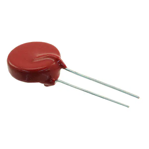

Metal-Oxide Varistors (MOVs) Radial Lead Varistors > TMOV® and iTMOV® Varistor Series TMOV and iTMOV Varistor Series ® ® RoHS Description The Littelfuse TMOV® and iTMOV® thermally protected varistors represent a new development in integrated circuit protection. Both versions are comprised of radial leaded Metal Oxide Varistors (MOVs) with an integrated thermally activated element designed to open in the event of overheating due to the abnormal overvoltage, limited current, conditions outlined in UL1449. The TMOV® and iTMOV® varistor’s integrated thermal element, in conjunction with appropriate enclosure design, helps facilitate SPD module compliance to UL1449 for both cord connected and permanently connected applications. Agency Approvals Agency Agency Approval Agency File Number UL1449 E320116 QC 42201-C001, QC 42201-A001, IEC 60950-1 (Annex Q) IECQ-C BSI 15.0009 IEC 61051-1, IEC 61051-2, IEC 60950-1 (Annex Q) 40021525 Additional Information The TMOV® and iTMOV® varistors offer quick thermal response due to the close proximity of the integrated thermal element to the MOV body. The integrated configuration also offers lower inductance than most discrete solutions resulting in improved clamping performance to fast overvoltage transients. The iTMOV® varistor differs from the TMOV® varistor by the inclusion of a third lead for the purpose of indicating that the MOV has been disconnected from the circuit. This lead facilitates connection to monitoring circuitry. Additionally TMOV® and iTMOV® varistors are wave solderable, thus simplifying end product assembly by reducing the the expense and rework associated with hand soldering operations. Features • RoHS compliant Halogen-Free and Lead–free available Datasheet iTMOV Resources iTMOV Samples iTMOV • Designed to facilitate compliance to UL1449 for SPD products • -55°C to +85°C operating temp range • Three-lead version available for indication purposes • High peak surge current rating up to 10kA Datasheet TMOV Resources TMOV Samples TMOV • Wave solderable • Standard lead form and spacing option Applications • SPD Products • GFCI (Ground Fault • AC Panel Protection Modules • UPS (Uninterruptable • AC Line Power Supplies Current Interupter) Power Supply) • Surge Protected Strip Connectors • White Goods • AC Power Meters • Inverters • • AC/DC Power Supplies Relocatable AC Power Taps • Plug-in SPD © 2019 Littelfuse, Inc. Specifications are subject to change without notice. Revised: 10/01/19 Metal-Oxide Varistors (MOVs) Radial Lead Varistors > TMOV® and iTMOV® Varistor Series Absolute Maximum Ratings • For ratings of individual members of a series, see Device Ratings and Specifications chart Continuous TMOV® and iTMOV® Varistor Series Units 115 to 750 V 6,000 to 10,000 A Steady State Applied Voltage AC Voltage Range (VM(AC)RMS) Transient Peak Pulse Current (ITM) - For 8x20µs Current Wave, single pulse Single-Pulse Energy Capability - For 2ms Current Wave 35 to 480 J Operating Ambient Temperature Range (TA) -55 to +85 °C Storage Temperature Range (TSTG) -55 to +125 °C Temperature Coefficient (αV) of Clamping Voltage (VC) at Specified Test Current TMOV® and iTMOV® Varistor Series Ratings & Specifications Maximum Rating (85°C) TMOV® Varistor Lead–free And RoHS Compliant Models Continuous iTMOV® Varistor Lead–free and RoHS Compliant Models Part Number Branding Disc Diameter Part Number Branding Specifications (25°C) Transient AC Volts DC Volts Energy 2ms VM(AC)RMS VM(DC) WTM (mm) (V) (V) (J) Peak Surge Current 8/20µs Maximum Varistor Voltage at Clamping Voltage 1mA Test Current 8/20µs ITM 1 × Pulse (A) ITM 2 × Pulse (A) VN(DC) Min Typical Capacitance f = 1MHz VN(DC) Max VC IPK C (V) (V) (A) (pF) TMOV14RP575E P4T575E TMOV14RP575M P4T575M 14 575 730 195 6000 4500 857 1047 1568 50 170 TMOV20RP575E P2T575E TMOV20RP575M P2T575M 20 575 730 375 10000 6500 857 1047 1568 100 275 TMOV14RP625E P4T625E TMOV14RP625M P4T625M 14 625 825 200 6000 4500 900 1100 1650 50 160 TMOV20RP625E P2T625E TMOV20RP625M P2T625M 20 625 825 400 10000 6500 900 1100 1650 100 250 TMOV14RP750E P4T750E TMOV14RP750M P4T750M 14 750 970 210 6000 4500 1080 1320 1980 50 140 TMOV20RP750E P2T750E TMOV20RP750M P2T750M 20 750 970 480 10000 6500 1080 1320 1980 100 175 Figure 1. Thermal Characteristics Figure 2. Current, Energy, Power Derating Curve 10 100 PERCENT OF RATED VALUE Typical 5A 2.5A 0.5A 0.125A 1 0.1 10 100 1000 80 60 40 20 0 -55 10000 Time(s) 50 60 70 80 90 100 110 120 130 AMBIENT TEMPERATURE ( oC) * Figure 4: Typical time to open circuit under UL1449 Overvoltage Limited Current Test in conjunction Note : TheAbnormal TMOV® and iTMOV® varistors are intended, with appropriate enclosure design, to help facilitate SPD module compliance to UL 1449, 3rd Edition Section 39.4 (abnormal overvoltage limited current requirements). Under these extreme abnormal overvoltage conditions, some units will exhibit substantial heating, arcing and venting prior to opening. Modules should be designed to contain this possibility. Application testing is strongly recommended. For applications exceeding 85°C ambient temperature, the peak surge current and energy ratings must be reduced as shown above. Figure 3. Maximum Clamping Voltage for 14mm Parts Figure 4. Maximum Clamping Voltage for 20mm Parts 10000 Maximum Clamping Voltage 750V 625V 575V 550V 510V 460V 420V 385V 320V 300V 275V Maximum Leakage Current Clamping Voltage (V) Clamping Voltage (V) 10000 Maximum Clamping Voltage Maximum Leakage Current 1000 100 0.000001 0.00001 0.0001 0.001 0.01 250V 230V 200V 175V 150V 140V 130V 115V 0.1 1 10 100 1000 10000 Peak Current (A) 625V 750V 575V 550V 510V 460V 420V 385V 320V 300V 275V 1000 100 0.000001 0.00001 0.0001 0.001 0.01 250V 230V 200V 175V 150V 140V 130V 115V 0.1 1 10 100 1000 10000 Peak Current (A) Figure 7: V-I Characteristic Curves for 20mm Types Figure 6: V-I Characteristic Curves for 14mm Types © 2019 Littelfuse, Inc. Specifications are subject to change without notice. Revised: 10/01/19 Metal-Oxide Varistors (MOVs) Radial Lead Varistors > TMOV® and iTMOV® Varistor Series Figure 5. Repetitive Surge Capability for 14mm Parts 10000 1 2 Figure 6. Repetitive Surge Capability for 20mm Parts 10000 15 1 102 10 15 10 10 1000 2 10 4 3 10 1000 5 10 4 10 6 10 Peak Current (A) Peak Current (A) 2 3 100 5 106 100 10 10 1 1 10 100 1000 10 10000 100 Impulse Duration (µs) 1000 10000 Impulse Duration (μs) Note: Average power dissipation of transients should not exceed 0.6W Note: Average power dissipation of transients should not exceed 1.0W Figure 8: Pulse Rating Curves 14mm types(not combination waveform) and UL1449 40.7.3 (Edition 4) test condition Note: Repetitive surge capability is qualified and tested based onfor 8/20us current waveform Figure 9: Pulse Rating Curves for 20mm types Wave Solder Profile Because the TMOV® and iTMOV® varistors contain a thermal protection device, care must be taken when soldering the devices into place. Two soldering methods are possible. Firstly, hand soldering: It is recommended to heat-sink the leads of the device. Secondly, wave soldering: It is critically important that all preheat stage and the solder bath temperatures are rigidly controlled. Figure 8. Lead–free Profile Figure 7. Non Lead–free Profile 300 300 250 TEMPERATURE (ºC) TEMPERATURE (ºC) Maximum Wave 260C Maximum Wave 240C 250 200 150 100 200 150 100 50 50 0 0 0 0.5 1 1.5 2 2.5 3 3.5 4 0 0.5 1 1.5 Physical Specifications Lead Material Copper clad steel wire Soldering Characteristics Insulating Material Solderability per MIL–STD–202, Method 208 Cured, flame retardant epoxy polymer meets UL94 V–0 requirements Device Labeling Marked with LF, voltage, UL/CSA logos, and date code 2 2.5 3 3.5 4 TIME(MINUTES) TIME(MINUTES) Environmental Specifications Operating/Storage Temperature Humidity Aging Thermal Shock -55°C to +85°C +85°C, 85% RH , 1000 hours +/-10% typical voltage change +85°C to -55°C 5 times +/-10% typical voltage change Solvent Resistance MIL–STD–202, Method 215 Moisture Sensitivity Level 1, J-STD-020 © 2019 Littelfuse, Inc. Specifications are subject to change without notice. Revised: 10/01/19 Metal-Oxide Varistors (MOVs) Radial Lead Varistors > TMOV® and iTMOV® Varistor Series Lead Configurations TMOV® Varistor iTMOV® Varistor 2 Thermal Fuse Element Thermal Fuse Element 3 Monitor Lead Line 3 Line Fuse 1 MOV 2 iTMOV Varistor 1 Monitor Lead Note: MOVs are non-polarized passive elements To Protected Circuit MOV LED R iTMOV® Varistor Application Examples Neutral ® The application examples below show how the indicator lead on the iTMOV can1be used to indicate that the Figure 1.varistor Application example thermal element has been opened. This signifies that the circuit is no longer protected from transients by the MOV. Line Application Example 1 Line iTMOV Varistor Line To Protected Circuit Line Fuse LED R Line Fuse Neutral Application Example 2 Line Load Switch Relay (loss of protection) Line Fuse To Protected Circuit Figure 1. Application example 1 iTMOV Varistor This circuit illustrates the use of the monitoring lead of to ensure that equipment is only the iTMOV® varistor iTMOV Varistor R operated when overvoltage protection present. AC OPTOCOUPLER In normal operation the load switch relay solenoid is powered TO STATUS via the ANNUNCIATOR LIGHT/ALARM indicator lead of the iTMOV® varistor. In the event of the Neutral thermal element being activated, the relay will de-activate, cutting power to the protected circuit and the fault LED will Figure 2. Application example 2 illuminate. LED Line "Load Powered" neon lamp iTMOV Varistor Fault LED (Normallyoff) R Line Fuse AC OPTOCOUPLER Line R AC OPTOCOUPLER Line Neutral Figure 3. Application example 3 Please note: Indicator circuits are provided as a guideline only. Verification of actual indicator circuitry is the responsibility of the end user. Component values selected must be appropriate for the specific AC line voltage service and application. iTMOV Varistor Fault LED (Normallyoff) Line Load Switch Relay R (loss of protection) Line Fuse Neutral "Load Powered" neon lamp Figure 3. Application example 3 iTMOV Varistor Fault LED (Normallyoff) R To Protected Circuit "Load Powered" neon lamp Figure 2. Application example 2 To Protected Circuit TO STATUS ANNUNCIATOR LIGHT/ALARM Load Switch Relay (loss of protection) Line Fuse Neutral Neutral To Protected Circuit TO STATUS ANNUNCIATOR LIGHT/ALARM Line Fuse Neutral Figure 2. Application example 2 iTMOV Varistor R To Protected Circuit This circuit Neutralutilizes an optocoupler to provide galvanic isolations between the iTMOV® varistor Figure 1. Application example 1 and the indicating or alarm circuitry. iTMOV Varistor R To Protected Circuit In this case, the LED is normally on, and is off when the thermal element opens. To Protected Circuit Application Example 3 Line Fuse © 2019 Littelfuse, Inc. Specifications are subject to change without notice. Revised: 10/01/19 Metal-Oxide Varistors (MOVs) Radial Lead Varistors > TMOV® and iTMOV® Varistor Series Device Dimensions Straight Lead Forms TMOV Varistor Curved Lead Forms TMOV® Varistor iTMOV® Varistor iTMOV Varistor ® ® Dia D (outer crimp) (inner crimp) Dia D Dia D Dia D A A Monitor Lead L3 Seating Plane L L Dia c Dia b Dia b E E e Dimension Dia c e3 Dia b VRMS Voltage Model e1 e2 E e1 e1 e e TMOV® Varistor 14mm Size e3 Dia b E e Monitor Lead L3 e1 e2 iTMOV® Varistor 20mm Size 14mm Size 20mm Size Min. mm (in) Max. mm (in) Min. mm (in) Max. mm (in) Min. mm (in) Max. mm (in) Min. mm (in) Max. mm (in) ALL 17.0 (0.669) 22.0 (0.866) 23.0 (0.906) 28.0 (1.10) 17.0 (0.669) 22.0 (0.866) 23.0 (0.906) 28.0 (1.10) ALL -- 22.5 (0.886) -- 31.0 (1.221) -- 22.5 (0.886) -- 31.0 (1.221) Dia D ALL 13.5 (0.531) 17.0 (0.669) 19.0 (0.748) 23.0 (0.906) 13.5 (0.531) 17.0 (0.669) 19.0 (0.748) 23.0 (0.906) e ALL 6.5 (0.256) 8.5 (0.335) 6.5 (0.256) 8.5 (0.335) 6.5 (0.256) 8.5 (0.335) 6.5 (0.256) 8.5 (0.335) 115-175 1.5 (0.059) 4.0 (0.157) 1.5 (0.059) 4.0 (0.157) 1.5 (0.059) 4.0 (0.157) 1.5 (0.059) 4.0 (0.157) e1 Bulk Pack 200-275 2.0 (0.079) 4.5 (0.177) 2.0 (0.079) 4.5 (0.177) 2.0 (0.079) 4.5 (0.177) 2.0 (0.079) 4.5 (0.177) 300-420 3.0 (0.118) 5.5 (0.217) 3.0 (0.118) 5.5 (0.217) 3.0 (0.118) 5.5 (0.217) 3.0 (0.118) 5.5 (0.217) 460-750 0 2.0 (0.079) 0 2.0 (0.079) 0 2.0 (0.079) 0 2.0 (0.079) 115-420 0 2.0 (0.079) 0 2.0 (0.079) 0 2.0 (0.079) 0 2.0 (0.079) A Straight Lead A Crimped Lead e1 Tape & Reel and In-Line Lead 460-550* 0 2.0 (0.079) 0 2.0 (0.079) 0 2.0 (0.079) 0 2.0 (0.079) e2 ALL n/a n/a n/a n/a 4.0 (0.157) 6.0 (0.236) 4.0 (0.157) 6.0 (0.236) e3 ALL n/a n/a n/a n/a 0 2.0 (0.079) 0 2.0 (0.079) 115-175 -- 9.0 (0.354) -- 9.0 (0.354) -- 9.0 (0.354) -- 9.0 (0.354) 200-275 -- 9.5 (0.374) -- 9.5 (0.374) -- 9.5 (0.374) -- 9.5 (0.374) 300-460 -- 11.0 (0.433) -- 11.0 (0.433) -- 11.0 (0.433) -- 11.0 (0.433) E 510-575 -- 12.0 (0.472) -- 12.0 (0.472) -- 12.0 (0.472) -- 12.0 (0.472) 625-750 -- 13.0 (0.512) -- 13.0 (0.512) -- 13.0 (0.512) -- 13.0 (0.512) L ALL 25.4 (1.00) -- 25.4 (1.00) -- 25.4 (1.00) -- 25.4 (1.00) -- L3 ALL n/a n/a n/a n/a 6.0 (0.236) -- 6.0 (0.236) -- 115-420 0.76 (0.030) 0.86 (0.034) 0.76 (0.030) 0.86 (0.034) 0.76 (0.030) 0.86 (0.034) 0.76 (0.030) 0.86 (0.034) 460-750 0.76 (0.030) 0.86 (0.034) 0.95 (0.037) 1.05 (0.041) 0.76 (0.030) 0.86 (0.034) 0.95 (0.037) 1.05 (0.041) ALL n/a n/a n/a n/a 0.76 (0.030) 0.86 (0.034) 0.76 (0.030) 0.86 (0.034) Dia b Dia c Outside Lead Only NOTES: * Tape and Reel packaging option is available only for devices up to 420Vrms. © 2019 Littelfuse, Inc. Specifications are subject to change without notice. Revised: 10/01/19 Metal-Oxide Varistors (MOVs) Radial Lead Varistors > TMOV® and iTMOV® Varistor Series Tape and Reel Specification TMOV® VARISTOR WITH OUTER CRIMP iTMOV® VARISTOR WITH INNER CRIMP P P2 P E ∆P ∆P P2 E ∆P ∆P ∆H ∆H ∆H ∆H B1 B1 C SEATING PLANE H1 W0 H0 W2 W1 C SEATING PLANE H1 W0 H0 Øb W2 W1 Øb W W ØD0 ØD0 P1 P1 t F P0 TMOV® VARISTOR WITH STRAIGHT LEADS iTMOV® VARISTOR WITH STRAIGHT LEADS P P2 t F P0 P E ∆P ∆P P2 E ∆P ∆P ∆H ∆H ∆H ∆H H1 H1 W0 H W2 Øb L W0 H W1 W2 W1 Øb L W W ØD0 ØD0 P1 P0 F P1 t Crimped Leads Description t F P0 Straight Leads Model Size Model Size 14mm 20mm 14mm 20mm 22.5 Max 31 Max 22.0 Max 28.0 Max 25.4 +/- 1.0 25.4 +/- 1.0 25.4 ±1.0 25.4 ±1.0 B1 Component Top to Seating Plane P Pitch of Component P0 Feed Hole Pitch 12.7 +/- 0.2 12.7 +/- 0.2 12.7 ±0.2 12.7 ±0.2 P1 Feed Hole Center to Pitch 8.95 +/- 0.7 8.95 +/- 0.7 8.95 ±0.7 8.95 ±0.7 P2 Hole Center to Component Center 12.7 +/- 0.7 12.7 +/- 0.7 12.7 ±0.7 12.7 ±0.7 F Lead to Lead Distance 7.5 +/- 0.8 7.5 +/- 0.8 7.5 ±0.8 7.5 ±0.8 Δh Component Alignment W Tape Width W0 Hold Down Tape Width W1 Hole Position W2 Hold Down Tape Position H Height from Tape Centre to Component Base (non-crimped parts) H0 Seating Plane Height (crimped parts only) H1 Component Height 2.0 Max 2.0 Max 2.0 Max 2.0 Max 18.0 +1.0/-0.5 18.0 +1.0/-0.5 18.0 +1.0/-0.5 18.0 +1.0/-0.5 12.0 +/- 0.3 12.0 +/- 0.3 12.0 ±0.3 12.0 ±0.3 9.0 +0.75/-0.50 9.0 +0.75/-0.50 9.0 +0.75/-0.5 9.0 +0.75/-0.5 0.5 Max 0.5 Max 0.5 Max 0.5 Max -- -- 18.0 +2.0/-0 18.0 +2.0/-0 16.0 +/- 0.5 16.0 +/- 0.5 -- -- 40.0 Max 46.5 Max 40.0 Max 46.5 Max NOTES: • Dimensions in mm • Reel capacity varies with voltage. C Crimp Length (crimped parts only) 2.6 typ 2.6 typ -- -- D0 Feed Hole Diameter 4.0 +/- 0.2 4.0 +/- 0.2 4.0 ±0.2 4.0 ±0.2 t Total Tape Thickness 0.7 +/- 0.2 0.7 +/- 0.2 0.7 ±0.2 0.7 ±0.2 L Length of Clipped Lead 11.0 Max 11.0 Max 11.0 Max 11.0 Max Δp Component Alignment 3 Max. 1.00mm 3 Max 3 deg Max, 1.0mm Max 3 deg Max, 1.0mm Max • Leads are crimped and in-line. This excludes the monitor lead on iTMOV® varistor which are not crimped and not in-line. • To order tape and reel option please add suffix 'L2T7' to end of standard part number. • Tape and reel option is available for rated voltages up to 420V.  Contact factory regarding availability of higher voltages. • Contact Littelfuse for additional details. © 2019 Littelfuse, Inc. Specifications are subject to change without notice. Revised: 10/01/19 Metal-Oxide Varistors (MOVs) Radial Lead Varistors > TMOV® and iTMOV® Varistor Series Part Numbering System Base Part Codes (See ratings & specifications tables and notes below) TMOV 20 R P 150 E Option Codes1 (See below) XXXXX DEVICE FAMILY Littelfuse Thermally Protected MOV NON-STANDARD LEAD FORM, PACKAGING and LEAD SPACING OPTIONS1: DISC DIAMETER (mm) 14 or 20mm L2B7: Lead Form: Crimped and In-Line2 Leads Packaging: Bulk Pack Lead Spacing3: 7.5mm L2T7: Lead Form: Crimped and In-Line2 Leads Packaging: Tape and Reel4 Lead Spacing3: 7.5mm L3T7: Lead Form: Straight Leads and In-Line2 Leads Packing: Tape and Reel Lead Spacing: 7.5mm CERAMIC SHAPE R: Round LEAD-FREE/RoHS COMPLIANT INDICATOR V M(AC)RMS 115V to 750V SERIES DESIGNATOR E: TMOV (2-Leaded, without indicator lead) M: iTMOV (3-Leaded, with indicator lead option) Option Codes: X2855: Nickel Barrier coated wire option -All standard parts use tinned copper clad steel wire. Nickel Barrier coated wire is available as an option, consisting of Copper wire with a flashing of Nickel followed by a top coating of Tin. To order append standard model BASE PART number with "X2855." Example: Standard Model Order As TMOV20RP115E TMOV20RP115EX2855 NOTES: 1 Use Base Part Code only to receive standard product: Lead Form: Straight Leads. Devices greater than 420Vrms are provided In-Line2. Packaging: Bulk Pack Lead Spacing: 7.5mm +/-1.0mm Other non-standard options may be available - please contact Littelfuse. 2 “In-Line” refers to straight row of leads at the tip where product is to contact the circuit board. Refer to “e1” in Device Dimensions section. 3 Lead Spacing refers to span between leads as “e” dimension in Device Dimensions section. 4 Due to device bulk, tape and reel packaging option is available only for devices up to 420Vrms. Pack Quantities Pack Quantities Rated Voltage 115-250 Bulk Pack Tape and Reel Model Size Model Size 14mm 20mm 14mm 20mm 600 400 500 400 275-550 500 300 400 300 575-750 400 200 n/a n/a NOTE: Tape and Reel available up to 420V only - please contact factory regarding availability of higher voltage parts. Disclaimer Notice - Information furnished is believed to be accurate and reliable. However, users should independently evaluate the suitability of and test each product selected for their own applications. Littelfuse products are not designed for, and may not be used in, all applications. Read complete Disclaimer Notice at www.littelfuse.com/disclaimer-electronics. © 2019 Littelfuse, Inc. Specifications are subject to change without notice. Revised: 10/01/19
TMOV20RP510E
物料型号:Littelfuse TMOV®和iTMOV®压敏电阻,具有不同的额定电压和尺寸,例如TMOV14RP115E、TMOV20RP115E等。
器件简介:这些压敏电阻是集成电路保护的新发展,包含径向引线金属氧化物压敏电阻(MOV)和集成的热激活元件,用于在异常过电压导致的过热情况下断开。
引脚分配:TMOV®压敏电阻为2引脚配置,而iTMOV®压敏电阻为3引脚配置,多出的第三引脚用于指示MOV是否已从电路中断开。
参数特性:包括工作温度范围-55°C至+85°C,无卤素和无铅版本可用,高冲击峰值电流额定值高达10kA,符合UL1449标准。
功能详解:TMOV®和iTMOV®压敏电阻提供快速的热响应,集成配置还提供了比大多数分立解决方案更低的电感,从而改善了对快速过电压瞬变的钳位性能。
应用信息:适用于SPD产品、GFCI、AC面板保护模块、UPS、AC线电源、浪涌保护插座连接器、白色家电插件SPD、AC功率表、可移动AC电源插座、AC/DC电源等。
封装信息:提供标准引脚形式和间距选项,波峰焊接兼容,简化最终产品组装,减少手工焊接操作的费用和返工。
