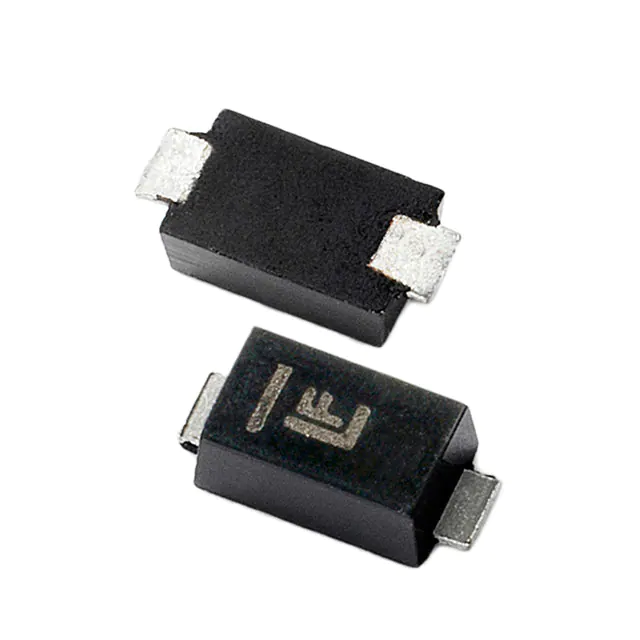

TVS Diode Datasheet TPSMF4L Series Surface Mount – 400W RoHS Pb e3 Description Uni-directional The TPSMF4L series of SOD-123FL small and flat lead low-profile plastic package is designed specifically to protect sensitive electronic equipment from voltage transients induced by lightning and other transient voltage events, and it’s especially suitable for high reliability and automotive application. Features Additional Information ■ High reliability application and automotive grade AEC-Q101 qualified ■ High temperature soldering: 260°C/30 seconds at terminals ■ 400W peak pulsepower capability at 10/1000µs waveform, repetition rate (duty cycle): 0.01% ■ VBR @ TJ= VBR@25°C x (1+αT x (TJ - 25)) (αT:Temperature Coefficient, typical value is 0.1%) ■ Compatible with industrial standard package SOD-123FL ■ Glass passivated junction ■ Low inductance, excellent clamping capability ■ Plastic package is flammability rated V-0 per Underwriters Laboratories ■ For surface mounted applications to optimize board space Resources Accessories ■ Typical failure mode is short from over-specified voltage or current Samples ■ Whisker test is conducted based on JEDEC JESD201A per its table 4a and 4c Agency Approvals Agency ■ IEC 61000-4-2 ESD 30kV(Air), 30kV (Contact) Agency File Number E230531 ■ ESD protection of data lines in accordance with IEC 61000-4-2 Maximum Ratings and Thermal Characteristics (TA=25 OC unless otherwise noted) Parameter Peak Pulse Power Dissipation at TA=25ºC (Note 1) Symbol 8/20 Value Unit 2000 W 400 W PD 1 W RƟJA RƟJL 220 100 -55 150 °C/W °C/W (Note 2) 10/1000µs(Note 3) Power Dissipation On Infinite Heat Sink at TL=50ºC Thermal Resistance Junction to Ambient Thermal Resistance Junction to Lead PPPM Operating and Storage Temperature Range TJ,TSTG ■ EFT protection of data lines in accordance with IEC 610004-4 ■ Built-in strain relief ■ Meet MSL level1, per J-STD-020, LF maximun peak of 260°C ■ Matte tin lead–free plated ■ Halogen-free and RoHS compliant ■ Pb-free E3 means 2nd level interconnect is Pb-free and the terminal finish material is tin(Sn) (IPC/JEDEC J-STD609A.01) ■ UL Recognized as an Isolated Loop Circuit Protector per UL 497B ■ Fast response time: typically less than 1.0ns from 0 Volts to VBR min Applications TPSMF4L devices are ideal for the protection of portable devices/ hard drives, notebooks, VCC busses, POS terminal, SSDs, power supplies, monitors, and vulnerable circuit used in other consumer applications. °C Notes: 1. Non-repetitive current pulse, per Fig. 4 and derated above TJ (initial) =25ºC per Fig. 3. 2. TPSMF4L5.0A~TPSMF4L8.5A Peak Pulse Power Dissipation is 1850W min, 2000W typical @8/20us 3. TPSMF4L5.0A~TPSMF4L8.5A Peak Pulse Power Dissipation is 370W min, 400W typical @10/1000μs Bi-directional Functional Diagram Cathode Anode Uni-directional 1 © 2021 Littelfuse, Inc. Specifications are subject to change without notice. Revised: JC.05/26/21 TVS Diode Datasheet TPSMF4L Series Surface Mount – 400W Electrical Characteristics (TA=25 °C unless otherwise noted) Part Number TPSMF4L5.0A TPSMF4L6.0A TPSMF4L6.5A TPSMF4L7.0A TPSMF4L7.5A TPSMF4L8.0A TPSMF4L8.5A TPSMF4L9.0A TPSMF4L10A TPSMF4L11A TPSMF4L12A TPSMF4L13A TPSMF4L14A TPSMF4L15A TPSMF4L16A TPSMF4L17A TPSMF4L18A TPSMF4L20A TPSMF4L22A TPSMF4L24A TPSMF4L26A TPSMF4L28A TPSMF4L30A TPSMF4L33A TPSMF4L36A TPSMF4L40A TPSMF4L43A TPSMF4L45A TPSMF4L48A TPSMF4L51A TPSMF4L54A TPSMF4L58A TPSMF4L60A TPSMF4L64A TPSMF4L70A TPSMF4L75A TPSMF4L78A TPSMF4L85A Marking Code KEA KGA KKA KMA KPA KRA KTA KVA KXA KZA LEA LGA LKA LMA LPA LRA LTA LVA LXA LZA MEA MGA MKA MMA MPA MRA MTA MVA MXA MZA NEA NGA NKA NMA NPA NRA NTA NVA Breakdown Voltage VBR (Volts) @ IT Min Max 6.40 6.67 7.22 7.78 8.33 8.89 9.44 10.00 11.10 12.20 13.30 14.40 15.60 16.70 17.80 18.90 20.00 22.20 24.40 26.70 28.90 31.10 33.30 36.70 40.00 44.40 47.80 50.00 53.30 56.70 60.00 64.40 66.70 71.10 77.80 83.30 86.70 94.40 7.00 7.37 7.98 8.60 9.21 9.83 10.40 11.10 12.30 13.50 14.70 15.90 17.20 18.50 19.70 20.90 22.10 24.50 26.90 29.50 31.90 34.40 36.80 40.60 44.20 49.10 52.80 55.30 58.90 62.70 66.30 71.20 73.70 78.60 86.00 92.10 95.80 104.00 Test Current IT (mA) 10 10 10 10 1 1 1 1 1 1 1 1 1 1 1 1 1 1 1 1 1 1 1 1 1 1 1 1 1 1 1 1 1 1 1 1 1 1 Maximum Maximum Peak Reverse Stand off Reverse Leakage Pulse Current Voltage VR (V) @ VR IR (µA) Ipp (A) 5.0 6.0 6.5 7.0 7.5 8.0 8.5 9.0 10 11 12 13 14 15 16 17 18 20 22 24 26 28 30 33 36 40 43 45 48 51 54 58 60 64 70 75 78 85 800 800 500 200 100 50 20 5 5 1 1 1 1 1 1 1 1 1 1 1 1 1 1 1 1 1 1 1 1 1 1 1 1 1 1 1 1 1 40.1 35.9 33.1 30.9 28.7 27.2 25.7 26.4 23.5 22.0 20.1 18.6 17.2 16.4 15.4 14.5 13.7 12.3 11.3 10.3 9.5 8.8 8.3 7.5 6.9 6.2 5.8 5.5 5.2 4.9 4.6 4.3 4.1 3.9 3.5 3.3 3.2 2.9 Maximum Clamping Voltage @Ipp VC (V) 9.2 10.3 11.2 12.0 12.9 13.6 14.4 15.4 17.0 18.2 19.9 21.5 23.2 24.4 26.0 27.6 29.2 32.4 35.5 38.9 42.1 45.4 48.4 53.3 58.1 64.5 69.4 72.7 77.4 82.4 87.1 93.6 96.8 103.0 113.0 121.0 126.0 137.0 Agency Approval X X X X X X X X X X X X X X X X X X X X X X X X X X X X X X X X X X X X X X Notes: 1. VBR measured after IT applied for 300µs, IT = square wave pulse or equivalent. 2. Surge current waveform per 10/1000µs exponential wave and derated per Fig.3. 3. All terms and symbols are consistent with ANSI/IEEE C62.35. 2 © 2021 Littelfuse, Inc. Specifications are subject to change without notice. Revised: JC.05/26/21 TVS Diode Datasheet TPSMF4L Series Surface Mount – 400W I-V Curve Characteristics Uni-directional Vc VBR VR V IR V F IT Ipp PPPM VR VBR VC IR VF Peak Pulse Power Dissipation -- Max power dissipation Stand-off Voltage -- Maximum voltage that can be applied to the TVS without operation Breakdown Voltage -- Maximum voltage that flows though the TVS at a specified test current (IT) Clamping Voltage -- Peak voltage measured across the TVS at a specified Ippm (peak impulse current) Reverse Leakage Current -- Current measured at VR Forward Voltage Drop for Uni-directional Ratings and Characteristic Curves (TA=25 °C unless otherwise noted) Figure 1 TVS Transients Clamping Waveform Figure 2 Peak Pulse Power Rating Curve Voltage Transients PPPM-Peak Pulse Power (kW) 10 Voltage or Current Voltage Across TVS Current Through TVS 1 0.2x0.2" (5.0x5.0mm) Copper Pad Area 0.1 0.000001 0.00001 0.0001 0.001 td-Pulse Width (sec.) Time 3 © 2021 Littelfuse, Inc. Specifications are subject to change without notice. Revised: JC.05/26/21 TVS Diode Datasheet TPSMF4L Series Surface Mount – 400W Ratings and Characteristic Curves (TA=25°C unless otherwise noted) (Continued) Figure 3 Peak Pulse Power Derating Curve Figure 4 Pulse Waveform - 10/1000µS 150 IPPM- Peak Pulse Current, % IRSM Peak Pulse Power (PPP) or Current (IPP) Derating in Percentage % 100 80 60 40 20 0 25 50 75 100 125 150 TJ - Initial Junction Temperature (ºC) 0 tr=10µsec Peak Value IPPM 100 Half Value IPPM IPPM ( ) 2 50 10/1000µsec. Waveform as defined by R.E.A td 0 175 0 1.0 2.0 3.0 4.0 t-Time (ms) Figure 5 Forward Voltage Figure 6 Typical Junction Capacitance 10000 0.9 0.8 Uni-directional V=0v 1000 0.7 Cj (pF) Vf - Typical forward dropped voltage@10mA TJ=25°C Pulse Width(td) is defined as the point where the peak current decays to 50% of IPPM 0.6 0.5 100 Uni-directional V=VR 10 0.4 1 0 -55 10 75 1 140 Temperature (ºC) 10 VBR - Reverse Breakdown Voltage (V) 100 Figure 8 Maximum Non-Repetitive Forward Surge Current Uni-Directional Only Figure 7 Peak Forward Voltage Drop vs. Peak Forward Current IFSM - Peak Forward Surve Current(A) I F - Peak Forward Current(A) 35 10 1 0.1 0.01 0 0.5 1 1.5 2 2.5 3 3.5 30 25 20 15 10 5 0 4 1 V F - Peak Forward Voltage(V) 10 100 Number of Cycles at 60 Hz 4 © 2021 Littelfuse, Inc. Specifications are subject to change without notice. Revised: JC.05/26/21 TVS Diode Datasheet TPSMF4L Series Surface Mount – 400W Soldering Parameters Lead–free assembly 150°C 200°C 60 – 120 secs 3°C/second Max 3°C/second Max 217°C 60 – 150 seconds 260+0/-5 °C 30 seconds Max 6°C/second Max 8 minutes Max. 260°C - Temperature Min (Ts(min)) Pre Heat - Temperature Max (Ts(max)) - Time (min to max) (ts) Average ramp up rate (Liquidus Temp (TL) to peak TS(max) to TL - Ramp-up Rate Reflow - Temperature (TL) (Liquidus) - Time (min to max) (tL) Peak Temperature (TP) Time within 5°C of actual peak Temperature (tp) Ramp-down Rate Time 25°C to peak Temperature (TP) Do not exceed Ramp-up TL Polarity Terminal Critical Zone TL to TP tL Ts(max) Ramp-down Ts(min) ts Preheat 25˚C t 25˚C to Peak Time (t) Physical Specifications Case tp TP Temperature (T) Reflow Condition Environmental Specifications SOD-123FL plastic over glass passivated junction Color band denotes cathode except bipolar Matte tin-plated leads, solderable per JESD22-B102 JESD22-A103 JESD22-A108 JESD22-A104 JEDEC-J-STD-020, Level 1 JESD22-A101 JESD22-A111 High Temp. Storage HTRB Temperature Cycling MSL H3TRB RSH Dimensions - SOD-123FL Package Dimensions E B A E A B C D E F G H Millimeters Min Max 2.90 3.50 0.85 1.70 0.43 0.10 0.00 0.90 3.10 3.90 1.05 2.00 0.83 0.25 0.10 1.08 Inches Min Max 0.114 0.138 0.033 0.067 0.017 0.004 0.000 0.035 0.122 0.154 0.041 0.079 0.033 0.010 0.004 0.043 F C G H D Mounting Pad Layout 2.24(0.088) 1.25 (0.049) 0.98 (0.039) 5 © 2021 Littelfuse, Inc. Specifications are subject to change without notice. Revised: JC.05/26/21 TVS Diode Datasheet TPSMF4L Series Surface Mount – 400W Part Numbering System TPSMF4L Part Marking System xx A LF 5% VBR Voltage Tolerance XXX YM VR Voltage Cathode Brand Marking Code Trace Code Marking Y:Year Code M: Month Code Series Packaging Options Part number Component Package Quantity Packaging Option Packaging Specification TPSMF4LXXX SOD-123FL 3000 Tape & Reel – 8mm tape/7” reel EIA RS-481 Tape and Reel Specification 0.157 (4.0) Cathode 0.31 (8.0) 0.157 (4.0) 0.059 DIA (1.5) Cover tape 7” 7.0 (178) 0.80 (20.2) Arbor Hole Dia. 0.33 (8.5) Dimensions are in inches (and millimeters). Direction of Feed Disclaimer Notice - Information furnished is believed to be accurate and reliable. However, users should independently evaluate the suitability of and test each product selected for their own applications. Littelfuse products are not designed for, and may not be used in, all applications. Read complete Disclaimer Notice at http://www.littelfuse.com/disclaimer-electronics. 6 © 2021 Littelfuse, Inc. Specifications are subject to change without notice. Revised: JC.05/26/21
