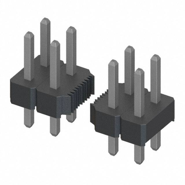

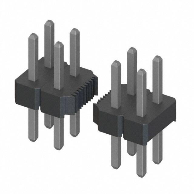

    CONN HEADER VERT 100POS 2MM
M22-2025046 数据手册
M22 Connectors Specification Board-to-Board and Cable-to-Board application options. Materials Mechanical Mouldings: Standard or High Temperature Plastic, UL94V-0 Contacts Female: Jumper socket: Male: Phosphor Bronze Beryllium Copper Copper Alloy Finish: See individual pages Electrical Current: Up to 2A per contact (see individual drawings)  Voltage proof: 500V AC for 1 minute Contact resistance: 30mΩ max Insulation resistance: 500MΩ min Durability M22-30X: Others: 25 operations 300 operations Insertion force (max) Jumper sockets: M22-30X: Others: 10N total 2.9N per contact 2.0N per contact Withdrawal force (min) Jumper sockets: M22-30X: Others: 1N total 1.0N per contact 0.2N per contact Vibration sensitivity M22-654, 655: 50 – 2,000Hz, 3.13G, 45 minutes duration Others: 10 – 55Hz, 1.5mm, 6 hours duration Shock severity: 294m/s2 (30G) for 11ms Environmental All dimensions in mm. www.harwin.com 222 Operating temperature M22-30X: Others: -25°C to +85°C -40°C to +105°C Solderability M22-636, 713, 714: Others: 250°C for 3 seconds 245°C for 5 seconds Soldering heat resistance: 260°C for 10 seconds 2mm (.079") PITCH 2mm pitch, with 0.5mm square male pin connection system. M22 Connectors Mating Profiles FEMALE 2mm (.079") PITCH VERTICAL PC TAIL VERTICAL PC TAIL DIL DIL 5.80 5.80 3.60 9.55 9.55 7.35 6.80 6.80 4.60 6.55 6.55 4.35 12.52 12.52 10.32 9.20 All dimensions in mm. www.harwin.com HORIZONTAL SMT SIL VERTICAL SMT 7.65 VERTICAL SMT Low Profile VERTICAL SMT With Pegs HORIZONTAL PC TAIL DIL 5.90 HORIZONTAL SMT MALE SIL VERTICAL SMT 223 CRIMP DIL 10.65 12.40 13.69 SIL DIL 13.95 9.10 max 9.10 max 17.70 11.00 max 13.10 max 14.95 10.40 max 14.70 10.00 max 20.41 12.60 max 16.02 max M22 Connectors 2mm (.079") PITCH Female Vertical PC Tail Twin beam phosphor bronze contacts. Suitable for use with mating M22 male pin headers, with 0.5mm square pins. For polarising key use order code M22-0340000. SINGLE ROW A B 2.40 B 2.00 4.40 0.50 2.00 Ø0.80 Recommended PC Board Pattern 2.40 0.20 CALCULATION DOUBLE ROW A B A B + 2.5 B 2 x (No. of contacts per row - 1) 2.00 4.00 B 4.30 2.00 2.00 Ø0.80 Recommended PC Board Pattern 0.50 2.00 0.20 2.00 2.40 HOW TO ORDER M22  -  71  X  XX  XX FINISH SERIES CODE 42 NO. OF ROWS Gold + Tin 3 Single Row NO. OF CONTACTS PER ROW 4 Double Row 03 to 20, 25 Single Row 03 to 25 Double Row All dimensions in mm. www.harwin.com 224 M22 Connectors Female Vertical Surface Mount, Dual Entry 2mm (.079") PITCH Dual entry sockets - can be used as either a top entry or bottom entry configuration. The low profile socket has locating pegs, to assist with correct positioning and minimised movement during soldering. Twin beam contact for cost-effective reliability. Contact technical@harwin.com for Tape and Reel options. CALCULATION 4.30mm HIGH B 2.00 A B + 2.5 B 2 x (No. of contacts per row - 1) B 4.50 0.89 2.00 2.10 2.00 0.50 2.00 7.40 A 4.30 Ø1.00 Recommended PC Board Pattern 6.20 CALCULATION 2.10mm HIGH B 2.00 A 2 x No. of contacts per row B 2 x (No. of contacts per row - 1) C B–2 B C 4.00 0.50 A C 2.00 2.00 2.10 6.00 1.65 2.00 6.80 0.90 0.89 Ø1.00 Ø0.85 Recommended PC Board Pattern HOW TO ORDER M22  -  63  X  XX  XX SERIES CODE TYPE FINISH 42 Gold + Tin 46 Tin (2.10mm high only) 4 4.30mm high NO. OF CONTACTS PER ROW 6 2.10mm high 03 to 20 4.30mm high 02 to 20 2.10mm high All dimensions in mm. www.harwin.com 225 M22 Connectors 2mm (.079") PITCH Female Horizontal Surface Mount Rear tail configuration, to allow mounting right up to the edge of the PCB. Supplied in Tape and Reel packaging as standard for use in automated assembly systems. CALCULATION SINGLE ROW CALCULATION DOUBLE ROW A B + 2.3 B 2 x (No. of contacts per row - 1) 2.00 B + 2.3 B 2 x (No. of contacts per row - 1) 0.50 square 2.00 B A 0.50 square 6.35 6.35 6.10 2.00 4.00 2.80 A 2.80 2.00 1.00 A 2 x 1.00 B 2.00 B 2.00 2.00 5.30 1.00 1.00 Recommended PC Board Pattern 2.00 Recommended PC Board Pattern HOW TO ORDER M22  -  65  X  XX  XX  R PACKAGING R SERIES CODE Tape & Reeled FINISH TYPE 4 Single Row 5 Double Row 42 NO. OF CONTACTS PER ROW 02 to 06, 08, 10 All dimensions in mm. www.harwin.com Gold + Tin 226 M22 Connectors Female Crimp Housings 2mm (.079") PITCH Female crimp housing - contacts are ordered separately (shown on following page). For polarising key use order code M22-0340000. CALCULATION SINGLE ROW CALCULATION DOUBLE ROW A B + 2.3 B 2 x (No. of contacts per row - 1) A B + 2.2 B 2 x (No. of contacts per row - 1) B B 2.00 2.00 2.00 2.00 7.20 7.20 A A 4.00 HOW TO ORDER M22  -  30  X  XX  00 SERIES CODE NO. OF CONTACTS PER ROW TYPE 1 Single Row 2 Double Row 02 to 20 All dimensions in mm. www.harwin.com 227 M22 Connectors 2mm (.079") PITCH Female Crimp Contacts Loose or reeled contacts. Open crimp design, ideal for automation. Use with female crimp housings shown on previous page. Suitable for connection with male pin headers with a mating length of 4.00mm or longer. CONTACTS HAND CRIMP TOOL Reeled (continuous strip) Order code is for one reel of 10,000 contacts. Instruction sheet is available at www.harwin.com/instructions. For use with loose contacts. 5.50 9.64 ORDER CODE Z22-020 Loose (cropped) Order code is for one pack of 100 contacts. WIRE STRIPPING DETAILS 6.00 Ø1.40 max 24 to 30 AWG 1.00 to 1.50 HOW TO ORDER M22  -  30  X  00  XX SERIES CODE FINISH TYPE 4 Reeled Contacts 5 Loose Contacts All dimensions in mm. www.harwin.com 228 42 Gold 46 Tin M22 Connectors Jumper Sockets, Polarising Key 2mm (.079") PITCH Can be fitted and removed by hand. Used with male pin headers, Jumper Sockets give an alternative on-board programming method to DIP switches. Jumper Sockets have an open top for use with test probes. JUMPER SOCKET POLARISING KEY For use with Female Vertical PC Tail connectors, M22-713 and M22-714 series. For use with Female Cable Housings, M22-301 and M22-302 series. 3.85 Exposed contact for probing 1.93 1.30 2.60 3.45 1.68 3.35 Ø0.55 max 2.00 HOW TO ORDER M22 - 19  X  00  XX SERIES CODE FINISH COLOUR 0 Black 1 Blue 2 Red 3 Grey ORDER CODE 05 Gold 46 Tin M22-0340000 All dimensions in mm. www.harwin.com 229 M22 Connectors 2mm (.079") PITCH Male Vertical PC Tail Suitable for use with female PCB connectors and jumper sockets. 4.2mm mating pin length recommended for use with female cable connections. Pin headers can be cut into smaller sizes. Also available with variable dimensions. SINGLE ROW A B 2.00 B Mating Length 2.00 Ø0.80 Recommended PC Board Pattern 1.50 Tail 2.00 0.50 square CALCULATION DOUBLE ROW A A 2 x No. of contacts per row B 2 x (No. of contacts per row - 1) B 2.00 B Mating Length 2.00 1.50 Tail 2.00 Ø0.80 Recommended PC Board Pattern 4.00 2.00 0.50 square HOW TO ORDER M22  -  2XX  XX  XX FINISH SERIES CODE 05 Gold 46 Tin NO. OF CONTACTS PER ROW TYPE SINGLE ROW DOUBLE ROW MATING LENGTH TAIL 02 to 25, 50 M22-201, M22-202 201 202 3.50mm 3.40mm 02 to 20, 25, 40, 50 M22-251 251 252 3.50mm 2.30mm 02 to 20, 25, 40 M22-252 271 272 4.20mm 2.30mm 02 to 20 M22-271, M22-272 All dimensions in mm. www.harwin.com 230 M22 Connectors Male Horizontal PC Tail 2mm (.079") PITCH Suitable for use with female PCB connectors and jumper sockets. 4.2mm mating pin length recommended for use with female cable connectors. Pin headers can be cut into smaller sizes. Also available with variable dimensions. SINGLE ROW A B Mating Length B 1.50 2.00 Ø0.80 Recommended PC Board Pattern Tail 1.50 2.00 0.50 square CALCULATION DOUBLE ROW 4.00 A 2.00 B A 2 x No. of contacts per row B 2 x (No. of contacts per row - 1) B Mating Length 1.50 2.00 1.50 2.00 Ø0.80 Recommended PC Board Pattern 2.00 Tail 0.50 square 2.00 HOW TO ORDER M22  -  2XX  XX  XX SERIES CODE FINISH TYPE SINGLE ROW DOUBLE ROW MATING LENGTH 05 Gold 46 Tin TAIL 203 204 3.50mm 3.00mm NO. OF CONTACTS PER ROW 253 254 3.50mm 2.40mm 02 to 25, 50 M22-203, M22-204 273 274 4.20mm 2.40mm 02 to 20 Others All dimensions in mm. www.harwin.com 231 M22 Connectors 2mm (.079") PITCH Male Vertical Surface Mount Suitable for use with female PCB connectors and jumper sockets. 4.2mm mating pin length recommended for use with female cable connectors. Pin headers can be cut into smaller sizes. Also available with variable dimensions. Tape and Reel option supplied fitted with Pick and Place cap, contact technical@harwin.com for availability. CALCULATION DOUBLE ROW A 2 x No. of contacts per row B 2 x (No. of contacts per row - 1) B 2.00 4.00 2.00 0.50 square B Mating Length 1.50 6.40 1.65 1.00 A 5.75 2.00 2.50 Recommended PC Board Pattern HOW TO ORDER M22  -  5  X  2  XX  XX  X SERIES CODE PACKAGING TYPE Blank Loose 3 3.50mm Mating Length P Pick and Place cap, tube 5 4.20mm Mating Length R Tape & Reeled FINISH NO. OF CONTACTS PER ROW 02 to 25 3.50mm Mating Length 05 Gold 02 to 20 4.20mm Mating Length 46 Tin All dimensions in mm. www.harwin.com 232 M22 Connectors Male Vertical Surface Mount 2mm (.079") PITCH Suitable for use with female PCB connectors and jumper sockets. Supplied with location pegs for additional placement accuracy. Tape and Reel option supplied fitted with Pick and Place cap. CALCULATION DOUBLE ROW A 2 x No. of contacts per row B 2 x (No. of contacts per row - 1) C B–2 B 2.00 B 2.00 0.50 square C 4.00 Ø1.20 1.50 2.25 C A 2.40 3.50 2.00 1.00 5.75 6.75 1.02 2.00 Recommended PC Board Pattern HOW TO ORDER M22  -  530  XX  05  X PACKAGING SERIES CODE Blank R NO. OF CONTACTS PER ROW 02 to 06, 10 Loose 02, 03, 05 Tape & Reeled Tape & Reeled FINISH 05 All dimensions in mm. www.harwin.com Loose 233 Gold M22 Connectors 2mm (.079") PITCH Male Horizontal Surface Mount Suitable for use with female PCB connectors and jumper sockets. 4.2mm mating pin length recommended for use with female cable connectors. Single row pin headers can be cut into smaller sizes. Locating pegs on double row, to assist with correct positioning and minimised movement during soldering. Contact technical@harwin.com for Tape and Reel options. CALCULATION SINGLE ROW A 4.20 B 2.00 2.80 A 2 x No. of contacts per row B 2 x (No. of contacts per row - 1) 1.27 B 2.03 2.00 0.89 2.00 Recommended PC Board Pattern 0.50 square 2.00 CALCULATION DOUBLE ROW A 2.00 4.00 C B A 2 x No. of contacts per row B 2 x (No. of contacts per row - 1) C B–2 2.00 1.00 B Ø1.00 1.27 0.89 1.27 2.00 2.03 5.45 Mating Length Ø1.20 2.80 0.50 square 6.22 C 1.93 Recommended PC Board Pattern 2.00 HOW TO ORDER M22  -  5  X  3  XX  05 FINISH SERIES CODE 05 Gold NO. OF CONTACTS PER ROW TYPE 3 Single Row 02 to 15 M22-533 4 Double Row, 3.2mm Mating Length 03 to 15, 20 M22-543 6 Double Row, 4.2mm Mating Length 03 to 20 M22-563 All dimensions in mm. www.harwin.com 234 M22 Connectors Pin Header Variants 2mm (.079") PITCH If you are unable to specify the connector you require from our standard range of M22 connectors, use the order code below to create an application-specific connector. Contact technical@harwin.com for further information, or search online for M22-XXX. Suitable for use with female connectors shown on previous pages. TERMINATION STYLES Vertical PC Tail Pin section is 0.50mm square. V Series 2.00 A Horizontal PC Tail W Series 2.00 A Pin section is 0.50mm square. PCB mounting hole is Ø0.80mm. 1.50 B B Pin section is 0.50mm square. E Series (3mm Tail) K Series (2.4mm Tail) 2.00 A 4.00 B 1.50 B For PCB pad layout see standard Male SMT pin header. B dimension is 000 on S series. B Tail 2.00 1.50 1.50 2.00 S Series T Series 4.00 2.00 Pin section is 0.50mm square. PCB mounting hole is Ø0.80mm. B 1.50 1.50 Vertical SMT Extended SMT 4.00 1.50 2.00 4.00 F Series (3mm Tail) L Series (2.4mm Tail) A Maximum B dimension is 6.00mm. J Series A 2.00 A PCB mounting hole is Ø0.80mm. 1.50 Extended PC Tail H Series 4.00 2.00 A 1.50 1.50 A 5.75 1.25 Tail B 5.75 0.70 HOW TO ORDER M22  -  XXX  XXX  X  XX  XX FINISH SERIES CODE Gold 46 Tin NO. OF CONTACTS PER ROW 02 to 50 DIMENSION A Example: 7.8mm = 078 DIMENSION B Example: 5.0mm = 050 All dimensions in mm. www.harwin.com 05 235 SINGLE ROW DOUBLE ROW V W Vertical H J Horizontal E F Extended K L Extended (2.4mm Tail) – S Surface Mount – T Extended Surface Mount
