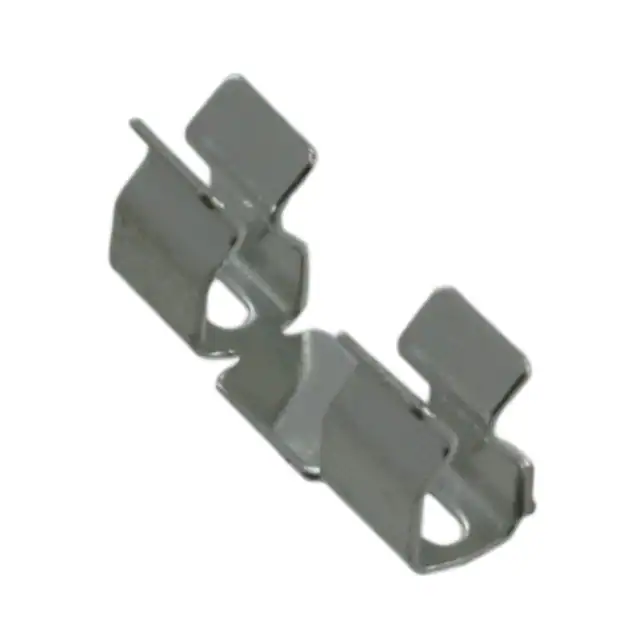

    RFI SHIELD CLIP MAXI TIN SMD
S1411-46R 数据手册
RFI Shield Clips Shield Clips for EMI/RFI Shields EMC SHIELDING SMT devices offering a fast solution for assembling RFI shields to PCBs. Eliminates the need for through holes and post reflow operations. Saves PCB real estate. Facilitates easy removal of the can for maintenance and repair. Substantial improvement in time and simplicity of assembly tuning and re-work. MAXI MIDI Shield Thickness 0.70-1.00mm 3.00 Shield Thickness 0.17-0.30mm 3.00 ORDER CODE S1411-46R 8.79 2.28 ORDER CODE MATERIAL S1711-46R Beryllium Copper S2711-46R Cupro-Nickel 8.79 2.28 max 3.65 2.60 3.55 max 2.55 2.28 2.28 9.40 9.40 2.28 Recommended PC Board Pattern 2.28 Recommended PC Board Pattern MINI MINI Shield Thickness 0.20-0.30mm Shield Thickness 0.13-0.23mm ORDER CODE 1.70 ORDER CODE 1.20 S0971-46R 1.60 S1721-46R 1.80 0.70 0.90 5.08 1.60 1.55 2.00 5.80 0.90 2.23 1.00 1.07 5.25 max 6.00 1.40 Recommended PC Board Pattern 2.00 1.20 1.05 5.59 Recommended PC Board Pattern 2.00 All dimensions in mm. www.harwin.com 294 1.02
