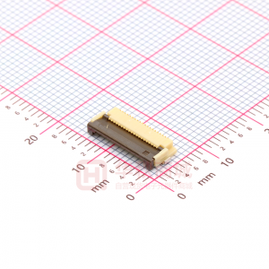

2.54mm Pitch Miniature Connector for Flexible Board FH1 Series sFeatures 1. 2.54mm FPC and FFC Connector The contact pitch is 2.54mm. 2. Contact Reliability This connector assures high contact reliability for high voltage contact. 3. Eighteen Types of Contact Numbers This connector consists of 18 kinds of 8, 9, 10, 11, 12, 13, 14, 15, 15, 17, 18, 19, 20, 21, 22, 27, and 29 contacts. sApplications HDD, facsimiles, printers, VTR, etc. sProduct Specifications Rating Rated Current: 1A Rated Voltage: 200V AC Operating Temperature Range:_40~+85ç (Note 1) Storage Temperature Range:_10~+60ç (Note 2) Operating Humidity Range:Relative humidity, 90% max. Storage Humidity Range: Relative humidity, 90% max. (Not dewed) Applicable FPC Item 1. Insulation Resistance 2. Withstand voltage 3. Contact Resistance 4. Mechanical operation 5. Vibration 6. Shock 7. Moisture Resistance in Steady State 8. Temperature Cycle 5000Mø min. Neither short or breakdown should occur. 20mømax. π FPC conductor resistance included Contact resistance : 40mø max. No part should be broken, cracked or loosened No part should be broken, cracked or loosened No part should be broken, cracked or loosened Insulation resistance: 500Mø min. No part should be broken, cracked or loosened Frequency: 10~55Hz and full amplitude 1.50mm in 3 directions for 2 hours, respectively Acceleration: 490m/S2, duration: 11ms, sine half-wave: in 3 directions for 3 times, respectively Exposed to temperature 40ç and humidity 90~95% for 96 hours 5 cycles under conditions as follows; Temperature: _55ç¡+5~+35¡85¡+5~+35ç Time: 30¡10~15¡ 30~10~15 minutes 9.Resistance to Soldering heat Neither appearance should be deformed nor contact remarkably loosened. Automatic soldering: 260çœ for 10 seconds Note 1. Temperature rise included when energized Note 2. This storage indicates a long-term storage state for the unused product before board mounted. The operating temperature and humidity ranges are applied to the non-energized state after the connector has been installed in the board. Note 3. The above standards represent this series. The individual formal agreement should be based on the "Specification". 30 cycles t=0.13~0.3 Tin plating Specification Measured at 500V DC 500V AC for 1 minute Measured at DC 1A Condition (Not dewed) D2 sMaterial Part Insulator Contact Material PBT Phosphor bronze Finish Black Tin plating Remarks UL94V-0 ––––––– sOrdering Information Please determine the specific product. If needed, please select and order the product from the product No. as listed on catalog page D4 and D5. FH 1 - 17 S -2.54 DS q q Series Name w Series No. : FH :1 16, 17, 18, 19, 20, 21, 22, 27, 29 w e r t y r Contact alignment : Single t Contacts Pitch y Contact Type : 2.54mm : DS : Right angle type DSA : Straight type e Number of Contacts : 6, 8, 9, 10, 11, 12, 13, 14, 15, sFPC · FFC Dimensions Unit: mm Number of Contacts 5 Size 8 9 10 11 12 13 14 15 16 17 18 19 20 21 22 27 29 A B 10.16 17.78 20.32 22.86 25.40 27.94 30.48 33.02 35.56 38.10 40.64 43.18 45.72 48.26 50.80 53.34 66.04 71.12 15.29 22.91 25.45 27.99 30.53 33.07 35.61 38.15 40.69 43.23 45.77 48.31 50.85 53.39 55.93 58.47 69.90 76.25 D3 sRight Angle Type Unit:mm Product No. FH1-08S-2.54DS FH1-09S-2.54DS FH1-10S-2.54DS FH1-11S-2.54DS FH1-12S-2.54DS FH1-13S-2.54DS FH1-14S-2.54DS FH1-15S-2.54DS FH1-16S-2.54DS FH1-17S-2.54DS FH1-18S-2.54DS FH1-19S-2.54DS FH1-20S-2.54DS FH1-21S-2.54DS FH1-22S-2.54DS FH1-27S-2.54DS HRS No. CL586-0015-5 CL586-0016-8 CL586-0017-0 CL586-0018-3 CL586-0019-6 CL586-0020-5 CL586-0027-4 CL586-0028-7 CL586-0029-0 CL586-0001-0 CL586-0002-3 CL586-0003-6 CL586-0004-9 CL586-0005-1 CL586-0006-4 CL586-0007-7 Number of Contacts 8 9 10 11 12 13 14 15 16 17 18 19 20 21 22 27 A 26.0 28.5 31.0 33.6 36.1 38.7 41.3 43.8 46.3 48.8 51.4 53.9 56.4 59.0 61.5 73.0 B 23.01 25.55 28.09 30.63 33.17 35.71 38.25 40.79 43.33 45.87 48.41 50.95 53.49 56.03 58.57 70.00 C 17.78 20.32 22.86 25.40 27.94 30.48 33.02 35.56 38.10 40.64 43.18 45.72 48.26 50.80 53.34 66.04 D4 sStraight Type Unit: mm Product No. FH1-05S-2.54DSA FH1-08S-2.54DSA FH1-10S-2.54DSA FH1-11S-2.54DSA FH1-12S-2.54DSA FH1-13S-2.54DSA FH1-14S-2.54DSA FH1-15S-2.54DSA FH1-16S-2.54DSA FH1-17S-2.54DSA FH1-18S-2.54DSA FH1-19S-2.54DSA FH1-20S-2.54DSA FH1-21S-2.54DSA FH1-22S-2.54DSA FH1-27S-2.54DSA FH1-29S-2.54DSA HRS No. CL586-0036-5 CL586-0021-8 CL586-0023-3 CL586-0024-6 CL586-0025-9 CL586-0026-1 CL586-0030-9 CL586-0031-1 CL586-0032-4 CL586-0008-0 CL586-0009-2 CL586-0010-1 CL586-0011-4 CL586-0012-7 CL586-0013-0 CL586-0014-2 CL586-0037-8 Number of Contacts 5 8 10 11 12 13 14 15 16 17 18 19 20 21 22 27 29 A 18.3 26.0 31.0 33.6 36.1 38.7 41.3 43.8 46.3 48.8 51.4 53.9 56.4 59.0 61.5 73.0 79.3 B 15.39 23.01 28.09 30.63 33.17 35.71 38.25 40.79 43.33 45.87 48.41 50.95 53.49 56.03 58.57 70.00 76.35 C 10.16 17.78 22.86 25.40 27.94 30.48 33.02 35.56 38.10 40.64 43.18 45.72 48.26 50.80 53.34 66.04 71.12 D 5.5 5.5 5.5 5.5 5.5 5.5 5.5 5.5 5.5 5.5 5.5 5.5 5.5 5.5 5.5 5.5 6.0 E 4 4 4 4 4 4 4 4 4 4 4 4 4 4 4 4 4.5 F 4.5 4.5 4.5 4.5 4.5 4.5 4.5 4.5 4.5 4.5 4.5 4.5 4.5 4.5 4.5 4.5 5.0 D5
