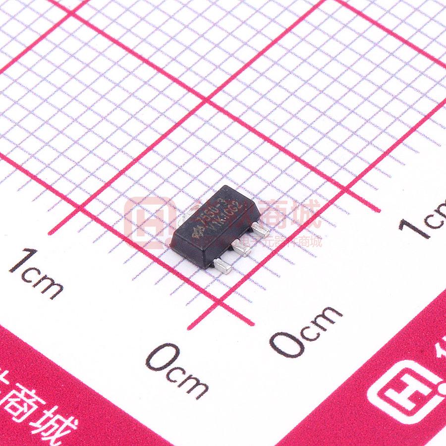

    低功耗 LDO 150mA 55mV@(1mA) Fixed 5V~5V Positive 1 30V SOT-89-3
HT7550-3 数据手册
HT75xx-3 100mA TinyPowerTM LDO Features General Description • Low power consumption The HT75xx-3 series is a set of three-terminal low power high voltage implemented in CMOS technology. They can deliver 100mA output current and allow an input voltage as high as 30V. They are available with several fixed output voltages ranging from 2.1V to 12.0V. CMOS technology ensures low voltage drop and low quiescent current. • Low voltage drop • Low temperature coefficient • High input voltage (up to 30V) • Quiescent current 1μA • High output current : 100mA Although designed primarily as fixed voltage regulators, these devices can be used with external components to obtain variable voltages and currents. • Output voltage accuracy: tolerance ±2% • 3-pin TO92, 3-pin SOT89 and 5-pin SOT23 packages Applications • Battery-powered equipment • Communication equipment • Audio/Video equipment Selection Table Part No. Output Voltage HT7521-3 2.1V HT7523-3 2.3V HT7525-3 2.5V HT7527-3 2.7V HT7530-3 3.0V HT7533-3 3.3V HT7536-3 3.6V HT7540-3 4.0V HT7544-3 4.4V HT7550-3 5.0V HT7560-3 6.0V HT7570-3 7.0V HT7580-3 8.0V HT7590-3 9.0V HT75A0-3 10.0V HT75C0-3 12.0V Package Marking TO92 SOT89 SOT23-5 75xx-3 (for TO92) 75xx-3 (for SOT89) 5xx3 (for SOT23-5) Note: ″xx″ stands for output voltages. Rev. 1.20 1 August 07, 2018 HT75xx-3 Block Diagram             Pin Assignment                                                                                      AbsolutemAximum Ratings     Operating Temperature ................................... −40°C to 85°C Supply Voltage .................................................. −0.3V to 33V Storage Temperature ..................................... −50°C to 125°C Note: These are stress ratings only. Stresses exceeding the range specified under ″AbsolutemAximum Ratings″ may cause substantial damage to the device. Functional operation of this device at other conditions beyond those listed in the specification is not implied and prolonged exposure to extreme conditionsmAy affect device reliability. Thermal Information Symbol θJA PD Parameter Thermal Resistance (Junction to Ambient) (Assume no ambient airflow, no heat sink) Power Dissipation Package Max. Unit SOT23-5 500 °C/W SOT89 200 °C/W TO92 200 °C/W SOT23-5 0.20 W SOT89 0.50 W TO92 0.50 W Note: PD is measured at Ta=25°C Rev. 1.20 2 August 07, 2018 HT75xx-3 Pin Descriptions Pin No. Pin Name Pin Description 1 GND Ground pin 2 VIN Input pin 3 VOUT Output pin Electrical Characteristics HT7521-3, +2.1V Output Type Ta=25°C Symbol Test Conditions Parameter Conditions Typ. Max. Unit — — 30 V 2.058 2.100 2.142 V VIN Input Voltage VOUT Output Voltage VIN=4.1V, IOUT=10mA IOUT Output Current VIN=4.1V 70 100 — mA ∆VOUT Load Regulation VIN=4.1V, 1mA≤IOUT≤50mA — 25 60 mV VDIF Dropout Voltage (Note) IOUT=1mA, ∆VOUT=2% — 30 100 mV Quiescent Current No load — 1.0 1.5 μA Line Regulation 3.1V≤VIN≤30V, IOUT=1mA — — 0.2 %/V Temperature Coefficient IOUT=10mA, -40°C
