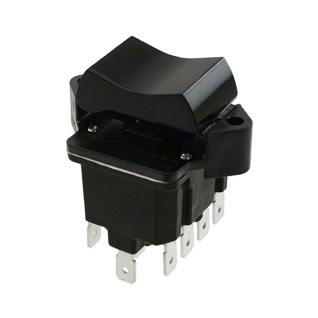

    船型开关 4PDT 10A 125VDC
4NR91-70-BK 数据手册
Manual Switches Sealed Rocker Switches NR Series GENERAL INFORMATION MICRO SWITCH NR Series Rocker Switches meet severe environment application needs for a rugged, cost-effective manual switch. They combine the advantages of toggle switch circuit versatility with pushbutton control. Quality construction features include a premolded elastomer seal between the actuator and bushing and an elastomer cover/case gasket seal. Also, the terminal inserts are molded into the high impact strength thermoplastic case. Complete sealing of the switching chamber enables compliance with UL 508, paragraph 13.3 hosedown test. These switches can be used where panels are subjected to periodic splash and washdowns, such as are common to food and beverage equipment. They will also withstand exposure to heavy accumulations of eary morning dew that may condense on the control panel in cabs of vehicles left outdoors overnight. FEATURES 1 Completely sealed switching chamber 1 Colored removable rockers 1 Choice of flush-panel or above-panel mounting 1 Step-design case provides added space between terminals to help prevent shorting 1 1, 2 or 4-pole circuitry 1 2 or 3 positions, maintained and momentary action 1 Spring-loaded actuating mechanism provides excellent tactile feedback 1 High impact strength, non-tracking case enhances electrical stability 1 Temperature range: −40 to 71°C (−40 to 160°F) 1 UL recognized, File E12252, Vol. 1, Section 44 1 CSA certified, File LR4442 1 CE approved HOW TO ORDER 1. To order flush panel mount switches without rockers, specify the listings in the NR order guides. 2. To specify above-panel mount switches, change the 1 (after ‘‘NR’’) in 1NR1, 11NR1, 2NR1, 12NR1, 4NR1, and 14NR1 listings in the NR order guides to 4. Example: 1NR1-2W converts to 1NR4-2, 11NR1-2 to 11NR4-2. For 1NR91, 2NR91, and 14NR91 listings add 4 (after the ‘‘NR’’) to specify the above panel mount version. Example: 1NR91-2 becomes 1NR491-2. 3. To order rockers, specify listings in the 12PA rocker order guide. ELECTRICAL RATINGS L191: 15 amps, 125, 250, 277 VAC; 1⁄2 Hp, 125 VAC; 1 Hp, 250, 277 VAC; 5 amps, 125 VAC ‘‘L’’ L192: 10 amps, 125, 250, 277 VAC; 1⁄4 Hp, 125 VAC; 1⁄2 Hp, 250, 277 VAC; 3 amps, 125 VAC ‘‘L’’ 12PA ROCKER ORDER GUIDE Note: These listings are used to specify rockers only. Rocker Color Catalog Listing White Red Yellow Black Green Blue 12PA12-W 12PA12-R 12PA12-Y 12PA12-BK 12PA12-G 12PA12-BL Flush Panel Mount ELECTRICAL RATINGS In Amperes (See Application Note on next page) Elect. Rating Code Ind. Res. 1 2 3 4 5 6 12 10 15 10 12 10 20 15 20 18 20 18 28 Volts DC 115 Volts AC 60 & 400 Hz 115 VDC 250 VDC Lamp Res. Res. Ind. Res. Lamp Res. 5 4 7 5 5 4 0.75 0.75 0.75 0.75 0.75 0.75 0.5 0.5 0.5 0.5 0.5 0.5 10 7 15 8 15 8 15 15 15 11 15 11 3 2 4 2 4 2 6 6 6 6 6 6 Honeywell 1 Sensing and Control 1 1-800-537-6945 USA 1 F1-815-235-6847 International 1 1-800-737-3360 Canada 230 VAC 123 Toggle/Rockers Above Panel Mount Manual Switches Sealed Rocker Switches NOTE: Catalog listings in the order guides below do not include rocker operators. See ‘‘How to Order.’’ NR Series Application Note: Honeywell MICRO SWITCH does not recommend the use of silver cadmium oxide switch contacts in non-arcing loads. Non-arcing loads are generally loads less than 12 volts and/or 0.5 amp. NR switches use silver cadmium oxide contacts. For other options, contact the MICRO SWITCH Application Center at 1-800-537-6945. NR 2-POSITION FLUSH-PANEL MOUNT ROCKERS ORDER GUIDE Circuits Made With Rocker At: No. of Poles 1 2 4 Ident. Lug Position Opposite Lug Position UL Rating Code Elect. Rating Code Termination Style Screw Solder Q-C OFF 1-2 OFF* 1-2* 1-2* 2-3 2-3 2-3 OFF 2-3 L191 L191 L192 L192 L192 1 1 2 2 2 1NR1-2 1NR1-3 1NR1-4 1NR1-6 1NR1-8 11NR1-2 11NR1-3 11NR1-4 11NR1-6 11NR1-8 1NR91-2 1NR91-3 1NR91-4 1NR91-6 1NR91-8 OFF 1-2, 4-5 OFF* 1-2, 4-5 * 1-2, 4-5 * 2-3, 5-6 2-3, 5-6 2-3, 4-6 OFF 2-3, 4-6 L191 L191 L192 L192 L192 3 3 4 4 4 2NR1-2 2NR1-3 2NR1-4 2NR1-6 2NR1-8 12NR1-2 12NR1-3 12NR1-4 12NR1-6 12NR1-8 2NR91-2 2NR91-3 2NR91-4 2NR91-6 2NR91-8 OFF 1-2, 4-5, 7-8, 10-11 OFF* 1-2, 4-5, 7-8, 10-11 * 1-2, 4-5, 7-8, 10-11 * 2-3, 5-6, 8-9, 11-12 2-3, 5-6, 8-9, 11-12 2-3, 5-6, 8-9, 11-12 OFF 2-3, 5-6, 8-9, 11-12 L191 L191 L192 L192 L192 5 5 6 6 6 4NR1-2 4NR1-3 4NR1-4 4NR1-6 4NR1-8 14NR1-2 14NR1-3 14NR1-4 14NR1-6 14NR1-8 4NR91-2 4NR91-3 4NR91-4 4NR91-6 4NR91-8 Termination Style NR 3-POSITION FLUSH-PANEL MOUNT ROCKERS ORDER GUIDE Circuits Made With Toggle At: No. of Poles 1 2 4 Ident. Lug Position Center Positon Opposite Lug Position UL Rating Code Elect. Rating Code Screw Solder Q-C 1-2 1-2* 1-2* NONE ** NONE ** NONE ** 1-2* OFF OFF OFF OFF 1-2 1-2 OFF 2-3 2-3 2-3* 2-3 2-3 2-3* NONE** L191 L192 L192 L191 L191 L192 L192 1 2 2 1 1 2 2 1NR1-1 1NR1-5 1NR1-7 1NR1-21 1NR1-31 1NR1-51 1NR1-61 11NR1-1 11NR1-5 11NR1-7 11NR1-21 11NR1-31 11NR1-51 11NR1-61 1NR91-1 1NR91-5 1NR91-7 1NR91-21 1NR91-31 1NR91-51 1NR91-61 1-2, 4-5 1-2, 4-5 * 1-2, 4-5 * NONE * NONE ** NONE ** 1-2, 4-5 * 1-2, 4-5 1-2, 4-5 * 1-2, 4-5 * OFF OFF OFF OFF 1-2, 4-5 1-2, 4-5 OFF 2-3, 4-5 1-2, 5-6 1-2, 5-6 2-3, 5-6 2-3, 5-6 2-3, 5-6* 2-3, 5-6 2-3, 5-6 2-3, 5-6* NONE** 2-3, 5-6 2-3, 5-6 2-3, 5-6* L191 L192 L192 L191 L191 L192 L192 L191 L192 L192 3 4 4 3 3 4 4 3 4 4 2NR1-1 2NR1-5 2NR1-7 2NR1-21 2NR1-31 2NR1-51 2NR1-61 2NR1-12 2NR1-50 2NR1-70 12NR1-1 12NR1-5 12NR1-7 12NR1-21 12NR1-31 12NR1-51 12NR1-61 12NR1-12 12NR1-50 12NR1-70 2NR91-1 2NR91-5 2NR91-7 2NR91-21 2NR91-31 2NR91-51 2NR91-61 2NR91-12 2NR91-50 2NR91-70 1-2, 4-5, 7-8, 10-11 1-2, 4-5, 7-8, 10-11 * 1-2, 4-5, 7-8, 10-11 * NONE * NONE ** NONE ** 1-2, 4-5, 7-8, 10-11 * 1-2, 4-5, 7-8, 10-11 1-2, 4-5, 7-8, 10-11 * 1-2, 4-5, 7-8, 10-11 * OFF OFF OFF OFF 1-2, 4-5, 7-8, 10-11 1-2, 4-5, 7-8, 10-11 OFF 2-3, 4-5, 7-8, 11-12 2-3, 4-5, 7-8, 11-12 2-3, 4-5 2-3, 5-6, 8-9, 11-12 2-3, 5-6, 8-9, 11-12 2-3, 5-6, 8-9, 11-12 * 2-3, 5-6, 8-9, 11-12 2-3, 5-6, 8-9, 11-12 2-3, 5-6, 8-9, 11-12 * NONE** 2-3, 5-6, 8-9, 11-12 2-3, 5-6, 8-9, 11-12 2-3, 5-6, 8-9, 11-12 * L191 L192 L192 L191 L191 L192 L192 L191 L192 L192 5 6 6 5 5 6 6 5 6 6 4NR1-1 4NR1-5 4NR1-7 4NR1-21 4NR1-31 4NR1-51 4NR1-61 4NR1-12 4NR1-50 4NR1-70 14NR1-1 14NR1-5 14NR1-7 14NR1-21 14NR1-31 14NR1-51 14NR1-61 14NR1-12 14NR1-50 14NR1-70 4NR91-1 4NR91-5 4NR91-7 4NR91-21 4NR91-31 4NR91-51 4NR91-61 4NR91-12 4NR91-50 4NR91-70 * These positions are momentary. All others are maintained. ** Toggle lever is blocked from these products. Toggle becomes 2-position, with center being one extreme position. TERMINAL CIRCUIT IDENTIFICATION Terminal identification numbers referenced in the order guides are molded into the switch base. These numbers indicate which circuits are made in each rocker position (e.g. ‘‘1-2’’ refers to circuit closure through terminals 1 and 2). 124 Honeywell 1 Sensing and Control 1 1-800-537-6945 USA 1 F1-815-235-6847 International 1 1-800-737-3360 Canada Manual Switches Seated Rocker Switches NR Series MOUNTING DIMENSIONS (For reference only) Flush Panel Quick Connect Terminals Above Panel Terminal Circuit Identification Solder Terminals Panel Cutout Honeywell 1 Sensing and Control 1 1-800-537-6945 USA 1 F1-815-235-6847 International 1 1-800-737-3360 Canada Toggle/Rockers Flange mounting torque is 10–12 in./lbs. Terminal screw mounting torque is 5 in./lbs. max. 125 Manual Switches Flat Base Sealed Toggles and Rockers NT/NR Series FEATURES 1 Sealed switching chamber 1 1 or 2-pole circuitry 1 2 or 3 position maintained and momentary action 1 Flat base with quick-connect terminals – mating connectors are available 1 Brightly colored removable rockers 1 Spring-loaded actuating mechanism provides tactile feedback 1 High impact strength, non-tracking case enhances electrical stability 1 Temperature range: –40 to 71°C (–40 to 160°F) 1 UL Recognized, File E12252, vol. 1, section 44 1 CSA Certified, File LR4442 1 CE approved UL AND CSA ELECTRICAL RATINGS Rating Code* Electrical Rating L192 10 amps, 125, 250, 277 VAC; 1⁄4 Hp, 125 VAC; 1⁄2 Hp, 250, 277 VAC; 3 amps, 125 VAC ‘‘L’’ L191 15 amps, 125, 250, 277 VAC; 1⁄2 Hp, 125 VAC; 1 Hp, 250, 277 VAC; 5 amps, 125 VAC ‘‘L’’ ELECTRICAL RATINGS In Amperes 28 Volts DC Rating Code Ind. Res. 1 2 3 4 12 10 15 10 20 15 20 18 115 Volts AC 60 & 400 Hz 115 VDC 250 VDC Lamp Res. Res. Ind. Res. Lamp 230 VAC Res. 5 4 7 5 0.75 0.75 0.75 0.75 0.5 0.5 0.5 0.5 10 7 15 8 15 15 15 11 3 2 4 2 6 6 6 6 Application Note: Honeywell MICRO SWITCH does not recommend the use of silver cadmium oxide switch contacts in non-arcing loads. Non-arcing loads are generally loads less than 12 volts and/or 0.5 amp. NT/NR switches use silver cadmium oxide contacts. For other options, contact the MICRO SWITCH Application Center at 1-800-537-6945. 126 GENERAL INFORMATION MICRO SWITCH NT Series toggle switches and NR Series rocker switches are designed to meet severe environment application needs for rugged, cost-effective manual switches. These flat base style products are identical to the stepped base style in construction and features. The flat base allows for PC board or connector use for easy wiring/connection. The flat base NT toggle switches and NR rocker switches are provided with quickconnect (spade) termination. Mating connectors are available. TERMINAL CIRCUIT IDENTIFICATION Terminal identifications are referenced in the order guides to indicate which circuits are made in each toggle position (e.g. ‘‘1-2’’ refers to circuit closure through terminals 1 and 2). Honeywell 1 Sensing and Control 1 1-800-537-6945 USA 1 F1-815-235-6847 International 1 1-800-737-3360 Canada Manual Switches Flat Base Sealed Toggles NT Series NT 2-POSITION ORDER GUIDE Circuits Made At: No. of Poles 1 2 Keyway Position Opposite Keyway UL Rating Code Electrical Rating Code Catalog Listing Toggle Q-C OFF 1-2 OFF** 1-2** 1-2** 2-3 2-3 2-3 OFF 2-3 L191 L191 L192 L192 L192 1 1 2 2 2 31NT91-2 31NT91-3 31NT91-4 31NT91-6 31NT91-8 OFF 1-2, 4-5 OFF** 1-2, 4-5** 1-2, 4-5** 2-3, 5-6 2-3, 5-6 2-3, 4-6 OFF 2-3, 4-6 L191 L191 L192 L192 L192 3 3 4 4 4 32NT91-2 32NT91-3 32NT91-4 32NT91-6 32NT91-8 NT 3-POSITION ORDER GUIDE Circuits Made At: No. of Poles 1 2 Keyway Position Center Position Opposite Keyway UL Rating Code Electrical Rating Code Catalog Listing Toggle Q-C 1-2 1-2** 1-2** NONE*** NONE*** NONE*** 1-2** OFF OFF OFF OFF 1-2 1-2 OFF 2-3 2-3 2-3** 2-3 2-3 2-3** NONE*** L191 L192 L192 L191 L191 L192 L192 1 2 2 1 1 2 2 31NT91-1 31NT91-5 31NT91-7 31NT91-21 31NT91-31 31NT91-51 31NT91-61 1-2, 4-5 1-2, 4-5** 1-2, 4-5** NONE*** NONE*** NONE*** 1-2, 4-5** 1-2, 4-5 1-2, 4-5 1-2, 4-5** 1-2, 4-5** OFF OFF OFF OFF 1-2, 4-5 1-2, 4-5 OFF 2-3, 4-5 1-2, 5-6 1-2, 5-6 1-2, 5-6 2-3, 5-6 2-3, 5-6 2-3, 5-6** 2-3, 5-6 2-3, 5-6 2-3, 5-6** NONE*** 2-3, 5-6 2-3, 5-6 2-3, 5-6 2-3, 5-6** L191 L192 L192 L191 L191 L192 L192 L191 L191 L192 L192 3 4 4 3 3 4 4 3 3 4 4 32NT91-1 32NT91-5 32NT91-7 32NT91-21 32NT91-31 32NT91-51 32NT91-61 32NT91-12 32NT91-10 32NT91-50 32NT91-70 ** These positions are momentary. All others are maintained. *** Toggle lever is blocked from these positions. Toggle becomes 2-position, with center being one extreme position. MATING CONNECTORS ORDER GUIDE Description Catalog Listing 2-pole connector 19PA168-NT 1-pole connector, same package size as 2-pole connector 19PA169-NT LOCKING CONFIGURATIONS B D Locked In Three Positions Locked In Center and Extreme Position (Keyway Side) Locked Out Of Center Position E F G H Locked In Center Position Locked In Extreme Position (Opposite Keyway) Locked In Extreme Position (Keyway Side) Locked Out Of Center And Extreme Position (Keyway Side) J K L M N P Locked Out Of Center And Extreme Position (Opposite Keyway) Locked In Center And Extreme Position (Opposite Keyway) Locked Out Of Extreme Position (Keyway Side) Locked Out Of And Into Extreme Position (Opposite Keyway) Locked Out Of Extreme Position (Opposite Keyway) Locked Out Of And Into Extreme Position (Keyway Side) Honeywell 1 Sensing and Control 1 1-800-537-6945 USA 1 F1-815-235-6847 International 1 1-800-737-3360 Canada 127 Toggle/Rockers A Manual Switches Flat Base Sealed Rockers NR Series NR 2-POSITION ORDER GUIDE Circuits Made At: No. of Poles 1 2 Keyway Position Opposite Keyway UL Rating Code Electrical Rating Code Catalog Listing Rocker* Q-C OFF 1-2 OFF** 1-2** 1-2** 2-3 2-3 2-3 OFF 2-3 L191 L191 L192 L192 L192 1 1 2 2 2 31NT91-2 31NR91-3 31NR91-4 31NR91-6 31NR91-8 OFF 1-2, 4-5 OFF** 1-2, 4-5** 1-2, 4-5** 2-3, 5-6 2-3, 5-6 2-3, 4-6 OFF 2-3, 4-6 L191 L191 L192 L192 L192 3 3 4 4 4 32NR91-2 32NR91-3 32NR91-4 32NR91-6 32NR91-8 NT 3-POSITION ORDER GUIDE Circuits Made At: No. of Poles 1 2 Keyway Position Center Position Opposite Keyway UL Rating Code Electrical Rating Code Catalog Listing Rocker* Q-C 1-2 1-2** 1-2** NONE*** NONE*** NONE*** 1-2** OFF OFF OFF OFF 1-2 1-2 OFF 2-3 2-3 2-3** 2-3 2-3 2-3** NONE*** L191 L192 L192 L191 L191 L192 L192 1 2 2 1 1 2 2 31NR91-1 31NR91-5 31NR91-7 31NR91-21 31NR91-31 31NR91-51 31NR91-61 1-2, 4-5 1-2, 4-5** 1-2, 4-5** NONE*** NONE*** NONE*** 1-2, 4-5** 1-2, 4-5 1-2, 4-5 1-2, 4-5** 1-2, 4-5** OFF OFF OFF OFF 1-2, 4-5 1-2, 4-5 OFF 2-3, 4-5 1-2, 5-6 1-2, 5-6 1-2, 5-6 2-3, 5-6 2-3, 5-6 2-3, 5-6** 2-3, 5-6 2-3, 5-6 2-3, 5-6** NONE*** 2-3, 5-6 2-3, 5-6 2-3, 5-6 2-3, 5-6** L191 L192 L192 L191 L191 L192 L192 L191 L191 L192 L192 3 4 4 3 3 4 4 3 3 4 4 32NR91-1 32NR91-5 32NR91-7 32NR91-21 32NR91-31 32NR91-51 32NR91-61 32NR91-12 32NR91-10 32NR91-50 32NR91-70 ELECTRICAL RATING L191: 15 amps, 125, 250, 277 VAC; 1⁄2 Hp, 125 VAC; 1 Hp, 250, 277 VAC; 5 amps, 125 VAC ‘‘L’’ L192: 10 amps, 125, 250, 277 VAC; 1⁄4 Hp, 125 VAC; 1⁄2 Hp, 250, 277 VAC; 3 amps, 125 VAC ‘‘L’’ TERMINAL CIRCUIT IDENTIFICATION Terminal identifications are referenced in the order guides to indicate which circuits are made in each toggle position (e.g., ‘‘1-2’’ refers to circuit closure through terminals 1 and 2). Top specify above-panel mount rockers: add 4 (after the ‘‘NR’’) to specify the above panel version. Example: 31NR91-5 becomes 31NR491-5. ROCKER BUTTONS ORDER GUIDE Rocker Color Catalog Listing White Red Yellow Black Green Blue 12PA12-W 12PA12-R 12PA12-Y 12PA12-BK 12PA12-G 12PA12-BL * Does not include rocker button. Order separately from chart. ** These positions are momentary. All others are maintained. *** Toggle lever is blocked from these positions. Toggle becomes 2-position, with center being one extreme position. MATING CONNECTORS ORDER GUIDE Description Catalog Listing 2-pole connector 19PA168-NT 1-pole connector, same package size as 2-pole connector 19PA169-NT 128 Honeywell 1 Sensing and Control 1 1-800-537-6945 USA 1 F1-815-235-6847 International 1 1-800-737-3360 Canada Manual Switches Flat Base Sealed Toggles and Rockers NT/NR Series MOUNTING DIMENSIONS (For reference only) Toggle Switches Rocker Switches, Above Panel Rocker Switches, Flush Panel Flange mounting torque is 10–12 in./lbs. Honeywell 1 Sensing and Control 1 1-800-537-6945 USA 1 F1-815-235-6847 International 1 1-800-737-3360 Canada Toggle/Rockers Bushing mounting torque is 10–15 in./lbs. 129
