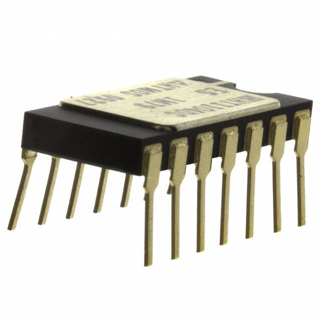

High Temperature Quad Operational Amplifier HT1104 The High Temperature Quad Operational Amplifier, HT1104, is a versatile performer over an extremely wide temperature range. It is fabricated with Honeywell’s dielectrically isolated high-temperature linear (HTMOS™) process, and is designed specifically for use in systems operating in severe high temperature environments. These amplifiers perform over the full -55°C to 225°C temperature range. All parts are burned in at 250°C. The HT1104 will operate with both single and split supplies. High temperature circuit applications such as transducer interfacing, amplification, active filtering, and signal buffering are all possible with the HT1104. APPLICATIONS:  Down-Hole Oil Well  Turbine Engine Control  Avionics  Industrial Process Control  Electric Power Conversion  Heavy Duty Internal Combustion Engine PINOUT DIAGRAM Top View OUT1 IN1M IN1P VP IN2P IN2M OUT2 1 2 3 + + 6 OUT4 13 IN4M 12 Top View 4 5 14 11 + - 7 + - 10 9 8 IN4P VN IN3P IN3M OUT3 FEATURES  Specified Over -55°C to +225°C  ESD Protection Circuitry  Single or Split Supply Operation  Latch-up Free Design with Dielectric Isolation  Low Input Bias and Offset Parameters  Hermetic 14-Lead Ceramic DIP package, or die HT1104 ABSOLUTE MAXIMUM RATINGS (1) Rating Symbol VN to VP VPIN IOUT IOS VHBM ΘJC TSTORE TSOLDER TJ Parameter Min Total Supply Voltage Voltage on Any Pin (excluding power pins) DC or Average Output Current (each output) Output Short Circuit Current (1 second) ESD Input Protection Voltage (Human Body Model) Thermal Resistance (Jct-to-Case) Storage Temperature Lead Temperature (soldering, 10 seconds) Junction Temperature Max 13 VP + 0.5 +50 110 2000 10 300 355 315 VN - 0.5 -50 -65 Units V V mA mA V °C/W °C °C °C (1) Stresses in excess of those listed above may result in permanent damage. These are stress ratings only, and operation at these levels is not implied. Frequent or extended exposure to absolute maximum conditions may affect device reliability. RECOMMENDED OPERATING CONDITIONS Symbol VP Parameter Positive Supply Voltage (Single supply) Min 5 Max 10 Units V VN Negative Supply Voltage (Single supply) 0 VP Positive Supply Voltage (Split supply) VN Negative Supply Voltage (Split supply) -5 IOUT Continuous Output Current -10 +10 mA VPIN Voltage on Any Pin (excluding power pins) VN - 0.3 VP + 0.3 V TC Case Temperature -55 225 °C V +5 V V ELECTRICAL SPECIFICATIONS Unless otherwise specified, specifications apply over the Recommended Operating Conditions. VP = +5V, VN=-5V. Limits Symbol Supply Current VO Output Voltage Swing ISOH ISOL 2 Parameter IP Output Short Circuit Current High Output Short Circuit Current Low Conditions R =10kΩ, C =20pF Open Loop, VP>VN, Vo = 0V, Absolute value Open Loop, VN>VP, Vo = 0V, Absolute value Open Loop, VP>VN, Vo = 0V, absolute value Open Loop, VN>VP, Vo = 0V, absolute value Min -4.8 Max Unit 12.5 mA +4.6 V 110 mA 110 mA ISOURCE Output Drive Current - source 10 mA ISINK Output Drive Current - sink 10 mA IIO Input Offset Current -55°C to 25°C +225°C -10 -50 10 50 nA nA IIB Input Bias Current -55°C to 25°C +225°C -10 -50 10 50 nA nA VIO Input Offset Voltage -7 7 mV www.hightempsolutions.com HT1104 Limits Symbol VCM Parameter Input Common Mode Voltage Range Conditions 25°C to +225°C, -55°C Min VN+0.2 VN+0.2 Max VP-2.2 VP-2.4 Unit V V AVOL DC Open Loop Gain 100 dB CMRR Common Mode Rejection Ratio 80 dB PSRR Power Supply Rejection Ratio 66 dB TYPICAL ELECTRICAL SPECIFICATIONS The following specifications are not tested on each device and are for reference only. Symbol VIO Parameter Input Offset Voltage Conditions Drift with Temperature Typical 10 Units µV/°C fo = 10 Hz fo = 1 kHz f = 0.1 to 10 Hz 200 30 8 nv/√Hz nv/√Hz µV, p-p N Noise SR Slew Rate R = 10kΩ, C = 20pF, 25°C 1.4 V/µsec UGB Unity Gain Bandwidth R = 10kΩ, C = 20pF, 25°C 1.4 MHz ØM Phase Margin C = 20pF 60 degrees AM Gain Margin C = 20pF 8 dB SIMPLIFIED SCHEMATIC (each amplifier) www.hightempsolutions.com 3 HT1104 PACKAGE DETAIL B1 All dimensions in inches Leads are NiFE (Alloy 42) A B C D E E1 B1 e L Q 0.150 (max) 0.018 ± 0.002 0.010 ± 0.002 0.700 ± 0.010 0.295 REF 0.300 ± 0.010 0.047 ± 0.002 0.100 ± 0.005 0.125 ± 0.180 0.035 ± 0.010 DIE DETAIL Die Dimension (millimeters) A D E D1 E1 Min. 0.655 --------- Nom. 0.675 2.455 2.575 0.100 0.100 Max. 0.695 --------- Terminal Connections for Die Die Pad Number 1 2 3 4 5 6 7 8 9 10 11 12 13 14 15 16 17 1. Die backside is isolated from topside. Die backside shall be externally connected to VN potential. 2. Top-side bond-pad surface metalization is aluminum. 3. Die back-side surface is gold. 4 Terminal Connection IN2M OUT2 OUT3 IN3M IN3P VN* IN4P Do not connect IN4M OUT4 VN* OUT1 IN1M Do not connect IN1P VP IN2P *Die pads 6 and 11, VN, are electrically common, by on-chip interconnect. www.hightempsolutions.com HT1104 TYPICAL PERFORMANCE PLOTS Supply Current (mA) SUPPLY CURRENT vs. TEMPERATURE 12 11 10 9 8 7 6 5 4 3 2 VSUP=±5.0V All Inputs at GND -100 -50 0 50 100 150 200 250 300 Ambient Temperature (°C) www.hightempsolutions.com 5 HT1104 6 www.hightempsolutions.com HT1104 www.hightempsolutions.com 7 HT1104 8 www.hightempsolutions.com HT1104 www.hightempsolutions.com 9 HT1104 DIE LEVEL SCREENING The HT1104 die are specified to operate over the entire temperature range. To meet this objective, three levels of screening are in place. 1. Wafer Level – 100% of die are electrically tested at room temperature. 2. Sample Package Test – A sample of die from each wafer are assembled into packages and screened over the temperature range of -55C to +225C to verify performance. 3. The sample packaged parts also receive 44 hours of burn-in at 250C. DIE LEVEL ASSEMBLY RECOMMENDATIONS Die Bonding Honeywell recommends using a Eutectic Gold/Silicon preform or high temperature conductive adhesive for die bonding to a ceramic package. Wire Bonding 1. Aluminum bond wires must be used to achieve high temperature reliability. 2. Wire bond power (die pad 16) and ground (die pads 6 and 11) pads before the other signal pads. 10 www.hightempsolutions.com HT1104 ORDERING INFORMATION H T 1104 x SOURCE H = Honeywell PROCESS T=Hi Temp SOI PART NUMBER 1104 = Quad Op Amp PACKAGE DESIGNATION D = 14 Pin DIP Z = Die Find out more For more information on Honeywell’s High Temperature Electronics visit us online at www.hightempsolutions.com, or contact us at 1-800-323-8295. Customer Service Email: ps.customer.support@honeywell.com. Honeywell reserves the right to make changes of any sort without notice to any and all products, technology and testing identified herein. You are advised to consult Honeywell or an authorized sales representative to verify that the information in this data sheet is current before ordering this product. Absent express contract terms to the contrary, Honeywell does not assume any liability of any sort arising out of the application or use of any product or circuit described herein; nor does it convey any license or other intellectual property rights of Honeywell or of third parties. Honeywell 12001 Highway 55 Plymouth, MN 55441 Tel: 800-323-8295 www.hightempsolutions.com ADS-14254 Rev B November 2015 ©2015 Honeywell International Inc.
