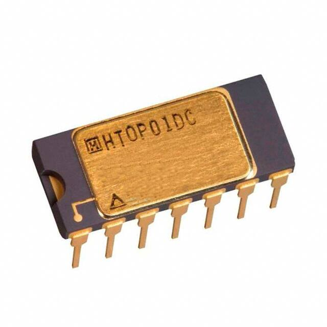

High Temperature Dual Precision Operational Amplifier HTOP01 DESCRIPTION The HTOP01 is a precision low power op amp, offering very low input offset voltage and drift over an operating temperature range of -55 C to 225 C. Using autozeroing techniques input offset voltage is continuously sampled and compensated, providing near perfect offset voltage compensation over temperature and time. An internal oscillator and logic provides all necessary auto-zero clock signals, and no external capacitors are needed. The internal auto-zero clock generator produces a pseudo-random clock frequency operating between 2kHz – 4kHz that effectively “spreads out” the clock noise frequency spectrum over a 2kHz span. This greatly reduces detectable clock noise in the amplifier’s output spectrum. The external clock option allows timing flexibility for synchronously sampled systems, where no clock energy can be tolerated in the sampled amplifier output. Additionally, an external clock input pin (XCLK) is provided along with a select input pin (SEL) to choose between the internal clock and an optional external clock. To save power, a power shutdown pin (SHDN) depowers all analog circuitry when asserted (active high). The current with SHDN asserted is
