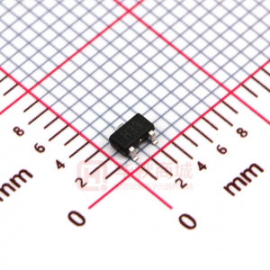

300mA CMOS L.D.O. Regulator FEATURES ● Extremely Low Supply Current(50µA,Typ.) ● Very Low Dropout Voltage ● 300mA Output Current ● Compatible with MLCC ● High Output Voltage Accuracy +/- 1.4 % ● Standardor Custom Output Voltages ● Over Currentand Over Temperature Protection ● Small input/output differential : 0.3V for full load ● Moisture Sensitivity Level 3 LM1108 SOT-23 ( 2.92*1.60*1.10 ) 2 1 3 1. GND 2. Vin 3. Vout [A type] 1. Vin 2. Vout 3. GND [B type] SOT-23-5L (SOT-25) 5 4 1 2 3 1. GND 2. Vin 3. Vout 4. NC 5. NC APPLICATIONS ● Battery Operated Systems ● Portable Computers ● Portable Cameras and Video Recorders ● Medical Instruments ● Instrumentation ● Cellular/GSM/PHS Phones ● Linear Post-Regulators for SMPS ● Pagers 1 SOT-89 2 3 1. GND 2. Vin 3. Vout ORDERING INFORMATION Device LM1108SF-X.X (A type) LM1108BSF-X.X (B type) LM1108GSF-X.X (H/F) LM1108SF5-X.X LM1108F-X.X Marking HXX BXX HGXX HXX 1108 X.X Package SOT-23 3L SOT-23 5L SOT-89 ( "X.X" = Output Voltage = 1.5, 1.8, 2.5, 3.0, 3.3, 3.6, 5.0 ) DESCRIPTION The LM1108 is a fixed output,high accuracy(typically ±0.5%) CMOS low drop-out regulator. Total supply current is typically 50µA at full load (20 to 60 times lower than in bipolar regulators). LM1108 key features include ultra low noise operation, very low dropout voltage (typically 240mV at full load), and fast response to step changes in load. The LM1108 in corporates both over temperature and over current protection. The LM1108 is stable with an output capacitor of only1µF and has a maximum out put current of 300mA. It is available in a SOT-23 & SOT-89 package TYPICAL APPLICATION CIRCUIT Nov. 2010 - Rev. 1.3.1 HTC -1 - 300mA CMOS L.D.O. Regulator ABSOLUTE MAXIMUM RATING Characteristic Supply Voltage Output Current Output Voltage Total Power Dissipation SOT23 PKG SOT89 PKG LM1108 Symbol Vin Iout Vout Pd Topr Tstg Value +6.5 300 Vss-0.3 to Vin+0.3 230 500 -40 ~ +85 260 -40 ~ +125 Unit V mA V mW °C °C °C Operating Ambient Temperature Lead Temperature (soldering, 5 sec) Storage Temperature ELECTRICAL CHARACTERISTICS % Note.1 : Load Regulation is measured using pulse techniques with duty cycle
