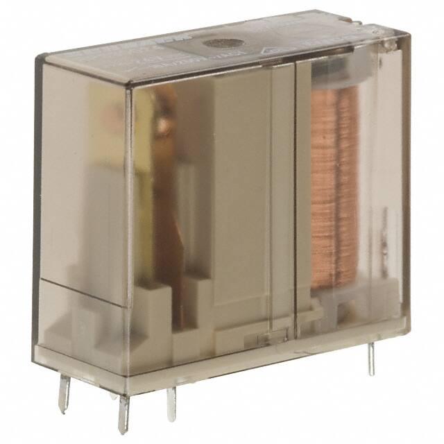

General Purpose Relays PCB Relays SCHRACK Power PCB Relay RPII/1 n 1 pole 8/12/16A, 1 form C (CO) or 1 form A (NO) contact coil-contact n Pinning 3.5 or 5mm (8/12A) and 5mm (16A) n RoHS compliant (Directive 2002/95/EC) n 4kV/8mm Typical applications Power supplies, domestic appliances, heating control, installation Z Approvals Coil Data VDE REG.-Nr. C894, UL E214025 Coil voltage range Operative range, IEC 61810 Technical data of approved types on request Contact Data 8A 12A 16A Contact arrangement 1 form C (CO) or 1 form A (NO) Rated voltage 250VAC Max. switching voltage 400VAC Rated current 8A 12A 16A Limiting making current 16A 20A 25A Breaking capacity max. 2000VA 3000VA 4000VA Contact material AgNi0.15 AgCdO AgCdO Frequency of operation, with/without load 600/72000h-1 Operate/release time typ. 8/2ms Bounce time typ., form A/form B 2/4ms Contact ratings Type Contact IEC61810 RP310 A (NO) RP410/418 A (NO) RP410/418 C (CO) RP411/418 A (NO) Load Cycles 16A, 250VAC resistive, 35°C 12A, 250VAC resistive, 35°C 10A, 250VAC resistive, 70°C 8A, 250VAC resistive, 35°C Mechanical endurance F0146-B 5 to 110VDC 2 Coil versions, DC coil Coil Rated Operate Release Coil Rated coil code voltage voltage voltage resistance power VDC VDC VDC Ω±10%1) mW 005 5 3.5 0.5 54 500 006 6 4.2 0.6 68 500 012 12 8.4 1.2 270 500 024 24 16.8 2.4 11001) 500 048 48 33.6 4.8 44001) 500 060 60 42.0 6.0 65401) 500 110 110 77.0 11.0 231001) 500 1) Coil resistance ±15%. All figures are given for coil without pre-energization, at ambient temperature +20°C. Other coil voltages on request. 100x103 100x103 100x103 100x103 >30x106 operations Insulation Data Initial dielectric strength between open contacts between contact and coil Clearance/creepage between contact and coil Material group of insulation parts 07-2012, Rev. 0712 www.te.com © 2011 Tyco Electronics Corporation, a TE Connectivity Ltd. company Datasheets and product specification according to IEC 61810-1 and to be used only together with the ‘Definitions’ section. Datasheets and product data is subject to the terms of the disclaimer and all chapters of the ‘Definitions’ section, available at http://relays.te.com/definitions 1000Vrms 4000Vrms ≥8/8mm IIIa Datasheets, product data, ‘Definitions’ section, application notes and all specifications are subject to change. 1 General Purpose Relays PCB Relays SCHRACK Power PCB Relay RPII/1 (Continued) Other Data Material compliance: EU RoHS/ELV, China RoHS, REACH, Halogen content refer to the Product Compliance Support Center at www.te.com/customersupport/rohssupportcenter Ambient temperature -40 to +70°C Category of environmental protection IEC 61810 RTII - flux proof, RTIII - wash tight Vibration resistance (functional), form A/form B, 30 to 300Hz 10/2g Shock resistance (destructive) 100g Terminal type PCB-THT Weight 18g Resistance to soldering heat THT, IEC 60068-2-20 flux proof version 270°C/10s wash tight version 260°C/5s Packaging/unit tube/20 pcs., box/500 pcs. Dimensions Dimensions in mm S0273-AA Bottom view on solder pins Dimensions in mm PCB layout / terminal assignment 8​/​12​A, pinning 5 ​mm 8​/​12​A, pinning 3.5 ​mm S0163-CQ 1 form C (1 CO) 16​A, pinning 5 ​mm S0163-CP 1 form C (1 CO) S0163-BG 1 form A (1 NO) 1 form C (1 CO) S0163-BC 1 form A (1 NO) S0163-BH S0163-BD S0163-BF Typical product code Type RP Power PCB Relay RPII/1 Version 3 16A, flux proof 4 8/12A, flux proof Contact arrangement 1 1 form C contact (1 CO) Contact material and pinning 1 AgNi0.15, 8A, pinning 5mm 2 AgNi0.15, 8A, pinning 3.5mm Coil Coil code: please refer to coil versions table 07-2012, Rev. 0712 www.te.com © 2011 Tyco Electronics Corporation, a TE Connectivity Ltd. company S0163-BE 1 form A (1 NO) Product code structure 2 S0163-CO 7 8 16A, wash tight 8/12A, wash tight 3 1 form A contact (1 NO) 0 8 AgCdO, 12/16A, pinning 5mm AgCdO, 12A, pinning 3.5mm Datasheets and product specification according to IEC 61810-1 and to be used only together with the ‘Definitions’ section. RP 3 1 0 024 Datasheets and product data is subject to the terms of the disclaimer and all chapters of the ‘Definitions’ section, available at http://relays.te.com/definitions Datasheets, product data, ‘Definitions’ section, application notes and all specifications are subject to change. General Purpose Relays PCB Relays SCHRACK Power PCB Relay RPII/1 (Continued) Product code Version Contact arrangement Contact material Pinning Coil Part number RP310012 16A, flux proof 1 form C (CO) contact AgCdO 5mm 16A 12VDC 2-1393230-9 RP310024 24VDC 3-1393230-2 RP310048 48VDC 3-1393230-3 RP330012 1 form A (NO) contact 12VDC 4-1393230-7 RP330024 24VDC 4-1393230-9 RP330048 48VDC 5-1393230-1 RP410024 12A, flux proof 1 form C (CO) contact 5mm 8/12A 24VDC 8-1393230-2 RP411024 8A, flux proof AgNi0.15 9-1393230-5 RP412024 3.5mm 1-1393231-2 RP418012 12A, flux proof AgCdO 12VDC 2-1393231-5 RP418024 24VDC 2-1393231-8 RP438012 1 form A (NO) contact 12VDC 5-1393231-0 RP710012 16A, wash tight 1 form C (CO) contact 5mm 16A 7-1393231-2 RP710024 24VDC 7-1393231-5 RP730012 1 form A (NO) contact 12VDC 8-1393231-2 RP818012 12A, wash tight 3.5mm 1-1393232-7 This list represents the most common types and does not show all variants covered by this datasheet. Other types on request 07-2012, Rev. 0712 www.te.com © 2011 Tyco Electronics Corporation, a TE Connectivity Ltd. company Datasheets and product specification according to IEC 61810-1 and to be used only together with the ‘Definitions’ section. Datasheets and product data is subject to the terms of the disclaimer and all chapters of the ‘Definitions’ section, available at http://relays.te.com/definitions Datasheets, product data, ‘Definitions’ section, application notes and all specifications are subject to change. 3
