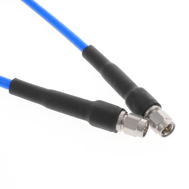

    同轴电缆组件 SMA 至 SMA 4.90mm OD 外径同轴缆线 39.4"(1.0m)3.3'
1-2016655-0 数据手册
4 C 2 3 1 REVISIONS 2019 TE Connectivity. All Rights Reserved. P DESCRIPTION LTR 1 DATE INITIAL CREATED DWN APVD CL 23SEP2019 RS D D LENGTH 100REF 1/4-36UNS-2B 1 (2X) 50REF(2X) 4.90 BLUE 4 2 3 (2X) C C THIS PRINT IS B PRELIMINARY UNQUALIFIED PRODUCT CONTACT PRODUCT ENGINEERING BEFORE USING THIS PRINT NOTES: 1. MATERIAL AND PROCESSING MUST MEET REQUIREMENTS OF TEC-138-702 2. CONNECTOR SMA INTERFACE FOLLOW IEC60169-15 3. PRODUCT RATING: TEMPERATURE: -40 °C TO +85 °C CHARACTERISTIC IMPEDANCE: 50 OHMS Normal FREQUENCY RANGE: DC TO 18GHz DURABILITY: NO LESS THAN 500TIMES BEND RADIUS: 54MM MIN (STATIC) 108MM MIN(REPEATED) 4. CABLE ASSEMBLY TO BE 100% SI TESTED VSWR: 1.3:1 MAX @ DC~18GHz INSERT LOSS: REFER TO TABLE MECHANICAL PHASE STABILITY: < ±5° MECHANICAL AMPLITUDE STABILITY:< ±0.1dB 5. CONNECTOR NEED COVER WITH CAP,PACKAGE FOLLOW TEC-107-115 1500 ±15 2016655-6 600±10 1000 ±15 1-2016655-0 PART NUMBER PC mm A MATERIAL 0 1 2 3 4 PLC PLC PLC PLC PLC ANGLES TBD - FINISH 0.1 0.01 0.001 0.0001 - finish_spec_2 1.94dB@18GHz 2.94dB@18GHz INSERTION LOSS(MAX) AR COAX CABLE,SOLID SPCCS 0.94MM,PTFE TAPE INSULATION, SPC TAPE OUTER CONDUCTOR 3.15MM,FEP JACKET,50OHM,BLUE 2 2 TOLERANCES UNLESS OTHERWISE SPECIFIED: DIMENSIONS: 0.97dB@6GHz 1.42dB@6GHz 4 PC UNIT 3.96dB@18GHz LABEL AR MR LENGTH 1.98dB@6GHz 1 MR Q'TY THIS DRAWING IS A CONTROLLED DOCUMENT. 1470-19 (3/13) 1-2016655-5 HEAT SHRINK TUBE PC SMA,MALE,STRAIGHT 20AUG2019 Cedar Liu CHK 28AUG2019 Roger Song APVD Roger Song DESCRIPTION B 3 1 ITEM DWN PRODUCT SPEC - APPLICATION SPEC - WEIGHT TE Connectivity NAME RF CA,SMA M TO SMA M,WITHOUT ARMOR 18GHz - SIZE - CUSTOMER DRAWING CAGE CODE A3 00779 DRAWING NO A RESTRICTED TO 2016655 SCALE 1:3 SHEET 1 OF 1 REV 1
