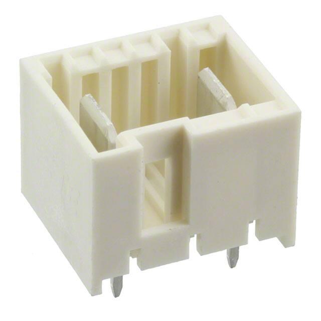

STANDARD POWER TIMER HOUSINGS WITH TPA AND MATING HEADERS Inline Connectors Meet RAST 5 Standard Compression Crimp Connection Technology TE Connectivity (TE) introduces new housings with integral terminal position assurance (TPA) devices for crimp type, standard power timer contacts, along with mating headers meeting the RAST 5 standard. Both housings and headers meet the Glow Wire test (750°C, no flame) as well as UL 94 V-0 flammability requirements. The new connectors are offered in 3, 5 and 7 position models with vacant spaces between positions to provide 2, 3 or 4 contacts for power connections. The housings' integral covers incorporate TPA devices to help ensure contacts are fully seated, and the housings also have external locking latches to help prevent unintended disconnection. The housings utilize 16A rated crimp, standard power timer contacts that accommodate 1.0 - 2.5mm2 wire with insulation from 2.0 - 3.3mm diameter. The DIN style, vertical headers have 6.3 x 0.8mm tabs. key features ELECTRICAL • Multiple position power connector can save per line connection time when compared to discrete terminal connections. • Voltage rating: 250 VAC • Current rating: 16 A, max. Integrated housing covers incorporate TPA devices to help assure contacts are fully seated and provide an extra measure of security against contact backout MECHANIcAL • Positions: 3, 5, 7 for 2, 3, 4 contacts • Natural color nylon material meets Glow Wire test (750°C, no flame) and UL 94 V-0 • Pitch: 5 mm per RAST 5 • Temperature range: -40°C to +110°C • Housings use an existing, robust, crimp-type, standard power timer contact rated 16A • Wire size: 1.0 - 2.5mm2 • Vacant spaces between contacts provide greater isolation • Insulation range: 2.0 - 3.5mm diameter • Multiple keying options are available MATERIAL • External locking latches help prevent unintentional disconnection • Housing & header body: Natural color nylon meeting GWT (750°C, no flame) and UL 94 V-0 • Choice of locking latch geometries – standard or alternate type with wider areas on which to press • Contacts: Tin plated copper alloy • Mating DIN style, vertical headers Specifications & standards • UL recognized and VDE approved • Header product specification: 108-106080 • Contact product specification: 108-18025 • Contact application specification: 114-18037 • UL recognized, file E28476 • VDE approved (contact), certificate 40042369 • applications • Room air conditioners • Power supply connections in home appliances and other commercial and industrial applications APPLIANCES /// STANDARD POWER TIMER CONNECTOR WITH TPA STANDARD POWER TIMER CONNECTOR WITH TPA Meeting RAST 5 Standard AVAILABLE HOUSINGS WITH TPA AND MATING HEADERS Positions (Contacts) Housing Part Number Housing Latch Type Header Part Number RAST 5 Keying 3 (2) 2295787-3 Standard 1-2232511-3 03-G 1-2232511-5 05-B 1-2232511-7 07-C 2-2232511-7 – 5 (2) 2295787-5 Standard 5-2295787-5 Alternate (Extended Width) 2295787-7 Standard 7 (4) 7 (4) 1-2295787-7 Standard 5-2295787-7 Alternate (Extended width) Housings listed above use crimp-type standard power timer contact part number 964203-1. The contacts are provided in strip form and may be applied with TE OCEAN applicator X-2151059-X. INTEGRAL TPA DEVICES CHOICE OF LOCKING LATCH LEVER TYPE Terminal position assurance (TPA) devices are molded into the housing's integral cover to help assure contacts are fully inserted. Standard Alternate (Extended Width) After the Standard Power Timer Terminals are inserted and lock in place, an operator can close the cover and the edge of the ribs comes in contact with the terminal box to lock it in place. DESIGN-IN QUESTIONS 1. Do you need to make a power connection (up to 16A) to a PC board? 2. Are you interested in a multi-position connector to save valuable assembly time instead of using individual terminals? 3. Would you like to use a connector system meeting the RAST 5 standard? 4. Does the connector need to comply with the Glow Wire test and/or UL 94 V-0 flammability standards? 5. Are you interested in an integrated TPA device that helps to ensure that the contacts are fully seated in the housing? If the answers are “yes,” these RAST 5 standard power timer connectors with TPA may represent a great solution for the application. TE TECHNICAL SUPPORT CENTER USA: +1 (800) 522-6752 Canada: +1 (905) 475-6222 Mexico: +52 (0) 55-1106-0800 Latin/S. America +54 (0) 11-4733-2200 Germany: +49 (0) 6251-133-1999 UK: +44 (0) 800-267666 France: +33 (0) 1-3420-8686 Netherlands: +31 (0) 73-6246-999 China: +86 (0) 400-820-6015 te.com te.com TE Connectivity, TE Connectivity (logo) and Every Connection Counts are trademarks. All other logos, products and/or company names referred to herein might be trademarks of their respective owners. The information given herein, including drawings, illustrations and schematics which are intended for illustration purposes only, is believed to be reliable. However, TE Connectivity makes no warranties as to its accuracy or completeness and disclaims any liability in connection with its use. TE Connectivity‘s obligations shall only be as set forth in TE Connectivity‘s Standard Terms and Conditions of Sale for this product and in no case will TE Connectivity be liable for any incidental, indirect or consequential damages arising out of the sale, resale, use or misuse of the product. Users of TE Connectivity products should make their own evaluation to determine the suitability of each such product for the specific application. 1-1773938-3 APPLIANCES /// STANDARD POWER TIMER CONNECTOR WITH TPA
