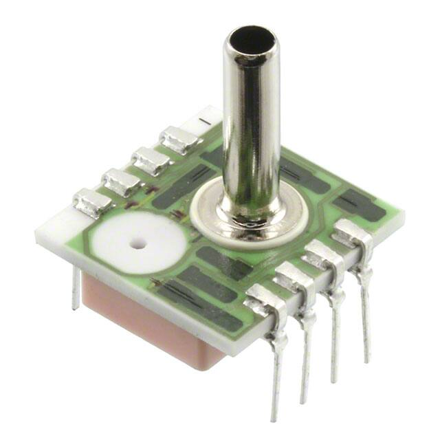

1210 Standard SPECIFICATIONS      FEATURES      Dual-in-Line Package 0ºC to 50ºC Compensated Temperature Range ±0.1% Non-Linearity 1.0% Interchangeable Span (provided by gain set resistor) Solid State Reliability APPLICATIONS       Medical Instruments Airspeed and Altitude Measurements Process Control Factory Automation Vacuum Measurement Handheld Calibrators SENSOR SOLUTIONS /// 1210 PC Board Mountable Pressure Sensor 0-100 mV Output Current Excitation Gage, Absolute, and Differential Temperature Compensated The 1210 is a temperature compensated, piezoresistive silicon pressure sensor packaged in a dual-in-line configuration. It is intended for cost sensitive applications where excellent performance and long-term stability are required. Integral temperature compensation is provided over a range of 0-50°C using laser-trimmed resistors. An additional laser-trimmed resistor is included to normalize pressure sensitivity variations by programming the gain of an external differential amplifier. This provides sensitivity interchangeability of ±1%. Gage, absolute, and differential pressure ranges from 02 psi to 0-100 psi are available. Multiple lead and tube configurations are available for specific applications. Please refer to the 1210 1 psi datasheet for low pressure applications. For voltage excitation, please refer to the Model 1220. 03/2018 Page 1 1210 Standard STANDARD RANGES Range 0 to 2 0 to 5 0 to 15 0 to 30 0 to 50 0 to 100 psia      psid       psig       Port Styles S, L, N, B* S, L, N, B* S, L, N S, L, N, S, L, N S, L, N *Barb port styles are only available in lead configuration type 3. See Ordering Information. PERFORMANCE SPECIFICATIONS Supply Current: 1.5mA Ambient Temperature: 25°C (unless otherwise specified) PARAMETERS MIN TYP MAX UNITS NOTES Span 75 100 150 mV 1 Span (2 psi version) 30 60 mV 1 Zero Pressure Output -2 2 mV Pressure Non Linearity -0.1 ±0.05 0.1 %Span Pressure Hysteresis -0.05 ±0.01 0.05 %Span Input & Output Resistance 2500 4400 6000 Ω Temperature Error – Span -0.5 ±0.3 0.5 %Span 3 Temperature Error – Zero -0.5 ±0.1 0.5 %Span 3 %Span 3 Thermal Hysteresis – Zero ±0.1 Supply Current 1.5 Response Time (10% to 90%) 1.0 ms Output Noise (10Hz to 1kHz) 1.0 µV p-p Long Term Stability (Offset & Span) ±0.1 Pressure Overload Compensated Temperature 2.0 mA 4 %Span 5 3X Rated 6 0 50 °C Operating Temperature -40 +125 °C Storage Temperature -50 +150 °C 3 grams Weight 2 Solder Temperature 250ºC Max 5 Sec. Media Non-Corrosive Dry Gases Compatible with Silicon, Pyrex, RTV, Gold, Ceramic, Nickel, and Aluminum Notes 1. Ratiometric to supply current. 2. Best fit straight line. 3. Maximum temperature error between 0°C and 50°C with respect to 25°C. For 2psi devices, Temperature Error -- Zero is ±1%. 4. For a zero-to-full scale pressure step change. Long term stability over a one year period with constant current and temperature. 5. 6. 2X maximum for 100psi device. 20psi maximum for 2 and 5psi devices. Application Schema SENSOR SOLUTIONS /// 1210 03/2018 Page 2 1210 Standard DIMENSIONS SENSOR SOLUTIONS /// 1210 03/2018 Page 3 1210 Standard BARB DIMENSIONS SENSOR SOLUTIONS /// 1210 03/2018 Page 4 1210 Standard CONNECTIONS APPLICATION SCHEMATIC SENSOR SOLUTIONS /// 1210 03/2018 Page 5 1210 Standard ORDERING INFORMATION 1210A – 030 A – 3 B Vent Pressure Range [psi] 002(1) 005(1) 015 030 050 L Long Tube S Short Tube N No Tube B Barb Fitting Type 100 3 1 Pressure Type G Gage A Absolute D Differential Opposite Side as Vent Tube Same Side as Vent Tube Barb port styles are only available in lead configuration type 3. (1) : Not available in Absolute Pressure Type NORTH AMERICA EUROPE ASIA Measurement Specialties, Inc., a TE Connectivity company Tel: +1 800-522-6752 customercare.frmt@te.com MEAS Switzerland Sarl, a TE Connectivity company Tel: +31 73 624 6999 customercare.bevx@te.com Measurement Specialties (China) Ltd., a TE Connectivity company Tel: +86 0400-820-6015 mailto:customercare.shzn@te.com TE.com/sensorsolutions Measurement Specialties, Inc., a TE Connectivity company. Measurement Specialties, TE Connectivity, TE Connectivity (logo) and EVERY CONNECTION COUNTS are trademarks. All other logos, products and/or company names referred to herein might be trademarks of their respective owners. The information given herein, including drawings, illustrations and schematics which are intended for illustration purposes only, is believed to be reliabl e. However, TE Connectivity makes no warranties as to its accuracy or completeness and disclaims any liability in connection with its use. TE Connectivity‘s obligations shall only be as set forth in TE Connectivity‘s Standard Terms and Conditions of Sale for this product and in no case will TE Connectivity be liable for any incidental, indirect or consequential damages arising out of the sale, resale, use or misuse of the product. Users of TE Connectivity products should make their own evaluation to determine the suitability of each such product for the specific application. © 2015 TE Connectivity Ltd. family of companies SENSOR SOLUTIONS /// 1210 All Rights Reserved. 03/2018 Page 6
