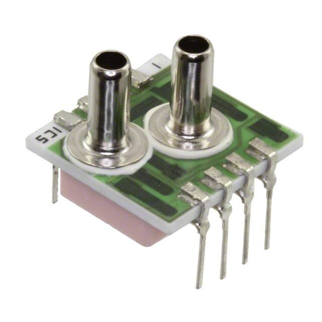

1220 Standard SPECIFICATIONS      FEATURES      Dual-in-Line Package 0ºC to 50ºC Compensated Temperature Range ±0.1% Non-Linearity 1.0% Interchangeable Span (provided by current set resistor) Solid State Reliability APPLICATIONS       Medical Instruments Airspeed and Altitude Measurements Process Control Factory Automation Vacuum Measurement Handheld Calibrators SENSOR SOLUTIONS /// 1220 PC Board Mountable Pressure Sensor 0-50 mV Output Voltage Excitation Gage, Absolute, and Differential Temperature Compensated The 1220 is a temperature compensated, piezoresistive silicon pressure sensor packaged in a dual-in-line configuration and intended for cost sensitive applications where excellent performance and long-term stability are required. When using the 1220 with a fixed voltage reference and current set resistor as shown in the application schematic, a span of 50mV and 1% interchangeability can be achieved. Integral temperature compensation is provided over a range of 0-50°C using laser-trimmed resistors. Gage, absolute, and differential pressure ranges from 0-2 psi to 0-100 psi are available. Multiple lead and tube configurations are available for specific applications. Please refer to the 1220 1psi datasheet for low pressure applications. For current excitation, please refer to the Model 1210. 08/2017 Page 1 1220 Standard STANDARD RANGES Range 0 to 2 0 to 5 0 to 15 0 to 30 0 to 50 0 to 100 psia psid           psig       PERFORMANCE SPECIFICATIONS Supply Voltage: See application schematic Ambient Temperature: 25°C (unless otherwise specified) PARAMETERS Span MIN TYP MAX UNITS NOTES 49.5 50 50.5 mV 1 Zero Pressure Output -2 2 mV Pressure Non Linearity -0.1 ±0.05 0.1 %Span Pressure Hysteresis -0.1 ±0.01 0.1 %Span Input Resistance 2500 4400 6000 Ω Output Resistance 2 Ω 4200 Temperature Error – Span -0.5 ±0.3 0.5 %Span 3 Temperature Error – Zero -0.5 ±0.1 0.5 %Span 3,8 .15 %/oC 3 Thermal Hysteresis – Zero ±0.05 %Span 3 Short Term Stability (Offset & Span) ±0.05 % Span 4 Long Term Stability (Offset & Span) ±0.10 % Span 5 Supply Voltage Reference 1.235 V Temperature Coefficient-Resistance Response Time (10% to 90%) Output Noise (10Hz to 1kHz) 1.0 ms 1.0 µV p-p Pressure Overload Compensated Temperature 3X Rated 0 50 °C Operating Temperature -40 +125 °C Storage Temperature -50 +150 °C Weight 3 Solder Temperature Weight 6 7 grams 250ºC Max 5 Sec. Non-Corrosive Dry Gases Compatible with Silicon, Pyrex, RTV, Ceramic, Nickel, Gold, and Aluminum Notes 1. Refer to application schematic. 2. Best fit straight line. Maximum temperature error between 0°C and 50°C with respect to 25°C. For 2psi devices, Temperature Error -- Zero is ±1.25%. 3. 4. Short term stability over 7 days with constant current and temperature. 5. Long term stability over a one year period with constant voltage and temperature. 6. For a zero-to-full scale pressure step change. 7. 2X maximum for 100 psi device. SENSOR SOLUTIONS /// 1220 08/2017 Page 2 1220 Standard DIMENSIONS CONNECTIONS SENSOR SOLUTIONS /// 1220 08/2017 Page 3 1220 Standard APPLICATION SCHEMATIC SENSOR SOLUTIONS /// 1220 08/2017 Page 4 1220 Standard ORDERING INFORMATION 1220A – 030 A – 3 B Pressure Range [psi] 002+ 005+ 015 030 050 100 Electrical Long Tube L S Short Tube N No Tube B Barb Tube + Gage and Differential Only Lead Configuration 1 Same Side as Vent Tube 3 Opposite Side as Vent Tube Pressure Type G Gage A Absolute D Differential NORTH AMERICA EUROPE ASIA Measurement Specialties, Inc., a TE Connectivity Company Tel: 800-522-6752 customercare.frmt@te.com Measurement Specialties (Europe), Ltd., a TE Connectivity Company Tel: 800-440-5100 customercare.bevx@te.com Measurement Specialties (China), Ltd., a TE Connectivity Company Tel: 0400-820-6015 mailto:customercare.shzn@te.com TE.com/sensorsolutions Measurement Specialties, Inc., a TE Connectivity company. Measurement Specialties, TE Connectivity, TE Connectivity (logo) and EVERY CONNECTION COUNTS are trademarks. All other logos, products and/or company names referred to herein might be trademarks of their respective owners. The information given herein, including drawings, illustrations and schematics which are intended for illustration purposes only, is believed to be reliable. However, TE Connectivity makes no warranties as to its accuracy or completeness and disclaims any liability in connection with its use. TE Connectivity‘s obligations shall only be as set forth in TE Connectivity‘s Standard Terms and Conditions of Sale for this product and in no case will TE Connectivity be liable for any incidental, indirect or consequential damages arising out of the sale, resale, use or misuse of the product. Users of TE Connectivity products should make their own evaluation to determine the suitability of each such product for the specific application. © 2015 TE Connectivity Ltd. family of companies SENSOR SOLUTIONS /// 1220 All Rights Reserved. 08/2017 Page 5
