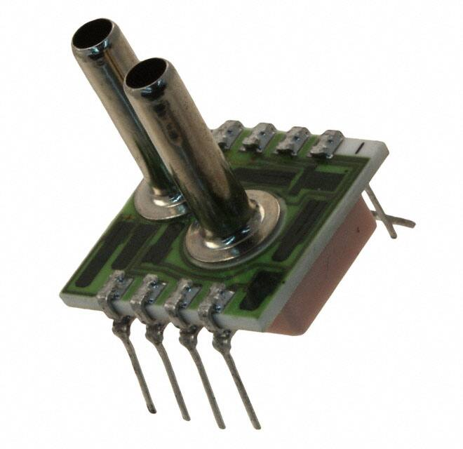

    SENSOR PRES 30PSID 0-100MV 8-DIP
1230-030D-3L 数据手册
1230 UltraStable™ SPECIFICATIONS     FEATURES       Dual-in-Line Package -20ºC to +85ºC Compensated Temperature Range ±0.1% Non Linearity 1.0% Interchangeable Span (provided by gain set resistor) Solid State Reliability APPLICATIONS       Medical Instruments Altitude Measurement Process Control Factory Automation Handheld Calibrators Environmental Control SENSOR SOLUTIONS ///1230  PC Board Mountable Pressure Sensor 0-100 mV Output Current Excitation Gage, Differential, and Absolute Temperature Compensated The 1230 is a high-performance temperature compensated, piezoresistive silicon pressure sensor packaged in a dual-in-line configuration. It uses Measurement Specialties’ proprietary UltraStable™ die to provide excellent performance and long-term stability over wide temperatures. Integral temperature compensation is provided over a range of -20°C to +85°C using laser-trimmed resistors. An additional laser-trimmed resistor is included to normalize pressure sensitivity variations by programming the gain of an external differential amplifier. This provides sensitivity interchangeability of ±1%. Absolute, differential and gage pressure ranges from 0-15 to 0-100 psi are available. Multiple lead and tube configurations are available for different applications. Please refer to the 1210 and 1220 for information on products with operating pressures less than 0-15 psi. For voltage excitation, please refer to the Model 1240. 05/2018 Page 1 1230 UltraStable™ STANDARD RANGES Range 0 to 2 0 to 5 0 to 15 0 to 30 0 to 50 0 to 100 psia psid           psig       PERFORMANCE SPECIFICATIONS Unless otherwise specified: Supply Current: 1.5 mA, Ambient Temperature: 25°C PARAMETERS MIN TYP MAX UNITS NOTES Span 75 150 mV 1 Zero Pressure Output -2 2 mV Pressure Non Linearity -0.1 ±0.05 0.1 %Span Pressure Hysteresis -0.1 ±0.01 0.1 %Span Input Resistance 2200 4000 5800 Ω 100 Output Resistance Temperature Error – Span Temperature Error – Zero 2 Ω 4200 -0.5 ±0.3 0.5 %Span 3 -0.5 ±0.1 0.5 %Span 3 Temperature Coefficient – Resistance 0.15 %/ºC 3 Thermal Hysteresis – Zero ±0.05 %Span 3 Short Term Stability (Offset & Span) ±0.05 %Span 4 Long Term Stability (Offset & Span) ±0.1 %Span 5 Supply Current 0.5 1.5 2.0 mA Response Time (10% to 90%) 1.0 ms Output Noise (10Hz to 1kHz) 1.0 µV p-p Pressure Overload 6 3X Rated 7 Compensated Temperature -20 +85 °C 8 Operating Temperature -40 +125 °C Storage Temperature -50 +150 °C 3 grams Weight Solder Temperature 250ºC Max 5 Sec. Media Non-Corrosive Dry Gases Compatible with Silicon, Pyrex, RTV, Gold, Ceramic, Nickel, and Aluminum Notes 1. Ratiometric to supply current. Span for 2PSI is 30 to 60mV. 2. Best fit straight line. Non Linearity for 2 PSI is ±0.2% and 5 PSI is ± 0.5%. Maximum temperature error between -20°C and +85°C with respect to 25°C. 3. 4. Short term stability over 7 days with constant current and temperature. 5. Long term stability over a one year period with constant current and temperature. 6. For a zero-to-full scale pressure step change. 2X maximum for 100 psi device. 7. 8. For pressures ranges below 15 psi, compensated temperature range is 0oC to 50oC and thermal error of offset is ±1%. SENSOR SOLUTIONS ///1230 05/2018 Page 2 1230 UltraStable™ DIMENSIONS SENSOR SOLUTIONS ///1230 05/2018 Page 3 1230 UltraStable™ Sensor Pinout Pin No. Function 1 -OUT 2 -EX 3 +OUT 4 +EX 5,6 GAIN 7,8 TEST Vent Tube Dimensions Model ‘A’ Dim ‘B’ Dim 1N / 3N N/A N/A 1L / 3L .490±.005 [12.45±0.13] Ø.127±.005 [⌀3.23±.13] 1S / 3S .325±.005 [8.26±0.13] Ø.125±.005 [⌀.3.18±0.13] SENSOR SOLUTIONS ///1230 05/2018 Page 4 1230 UltraStable™ CONNECTIONS APPLICATION SCHEMATIC SENSOR SOLUTIONS ///1230 05/2018 Page 5 1230 UltraStable™ ORDERING INFORMATION 1230 – 030 A – 3 N Pressure Range [psi] 002 005 015 030 050 100 G A D Vent Type Long Tube Short Tube No Tube Barb L S N B 1 3 Pressure Type Gage Absolute Differential Lead Configuration Same Side as Vent Tube Opposite Side as Vent Tube NORTH AMERICA EUROPE ASIA Measurement Specialties, Inc., a TE Connectivity Company Tel: +1 800-522-6752 customercare.frmt@te.com Measurement Specialties (Europe), Ltd., a TE Connectivity Company Tel: +31 73 624 6999 customercare.bevx@te.com Measurement Specialties (China), Ltd., a TE Connectivity Company Tel: +86 0400-820-6015 mailto:customercare.shzn@te.com TE.com/sensorsolutions Measurement Specialties, Inc., a TE Connectivity company. Measurement Specialties, TE Connectivity, TE Connectivity (logo) and EVERY CONNECTION COUNTS are trademarks. All other logos, products and/or company names referred to herein might be trademarks of their respective owners. The information given herein, including drawings, illustrations and schematics which are intended for illustration purposes only, is believed to be reliable. However, TE Connectivity makes no warranties as to its accuracy or completeness and disclaims any liability in connection with its use. TE Connectivity‘s obligations shall only be as set forth in TE Connectivity‘s Standard Terms and Conditions of Sale for this product and in no case will TE Connectivity be liable for any incidental, indirect or consequential damages arising out of the sale, resale, use or misuse of the product. Users of TE Connectivity products should make their own evaluation to determine the suitability of each such product for the specific application. © 2015 TE Connectivity Ltd. family of companies SENSOR SOLUTIONS ///1230 All Rights Reserved. 05/2018 Page 6
