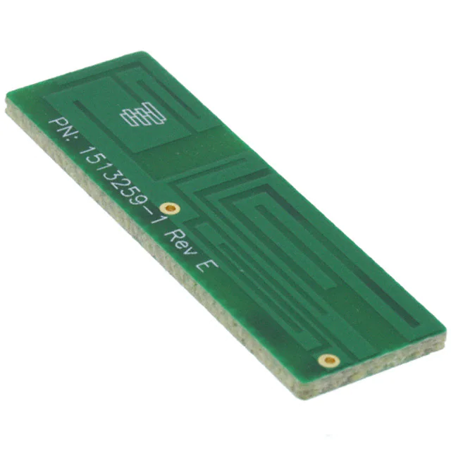

    ANTENNA PCB QUAD BAND
1513259-1 数据手册
Antenna Solutions 824 – 960 & 1710 – 1990 MHz Quad Band Antenna (US Dual and EU Dual Band) Part Number: 1513259-1 Product Facts  This small embedded antenna provides the most reliable easy-to-use, and adjustment-free antenna technology for handling during assembly and implementation by developers.  Also available in tape & reel (P/N 1513259-9) for automatic mounting.  RoHS compliant Recommendations  Minimum or no matching circuits required.  Bandwidth and performance is dependent on ground plane size. Suggested minimum ground plane length from the antenna feed is 100 mm.  PCB ground is to be on top layer. Specifications Frequency Range (MHz) Peak Gain VSWR Polarization Azimuth Beamwidth Power Handling Feed Point Impedance Size Weight Mounting Keep Out Area Test Orientation in Free Space 824 – 960; 1710 – 1990 +1 dBi < 3.0:1 Linear Omni-directional 10 Watt cw 50 Ohms unbalanced 37.59 mm x 11.94 mm x 1.57 mm < 1.6 g. Surface-mount technology. See page 2 See diagram on page 2 VSWR VSWR 5 1 824 1710 Azimuth Legend: 894 MHz 1880 MHz Elevation 892 1850 960 1990 Frequency (MHz) Efficiency Legend: 894 MHz 1880 HMz 1 Catalog 2-1773459-9 Revised 03-11 www.te.com www.antenna.te.com Dimensions are in inches and millimeters unless otherwise sspecified. Values in brackets are metric equivalents. Dimensions are shown for reference purposes only. Specifications subject to change. USA: 1-800-522-6752 UK: +44 (0) 800-267666 Canada: 1-905-475-6222 Netherlands: +31 (0) 73-6246-999 Germany: +49 (0) 6251-133-1999 China: +86 (0) 400-820-6015 For other country number go to te.com/supportcenter Antenna Solutions 824 – 960 & 1710 – 1990 MHz Quad Band Antenna (US Dual and EU Dual Band) PageHead_12_HelvCdBd (Continued) Part Number: 1513259-1 Mounting Guide NOTES: 1. Suggested matching component pads. 2. Antenna must be mounted on the edge of PCB. 3. NC = No connection (mechanical mounting pads). 4. No copper allowed in designated area on all PCB layers – 5. For more information please call TE. Keep Out Area Dimensions: mm Diagram is not to scale Approx. Dimensions Keep Out Area Dimensions: mm Diagram is not to scale Dimensions: mm Diagram is not to scale © 2011 Tyco Electronics Corporation. All Rights Reserved. 2-1773459-9–CIS–PDF–03-11 TE (logo) and TE Connectivity are trademarks of the TE Connectivity group of companies and its licensors. Other logos, product and Company names mentioned herein may be trademarks of their respective owners. While TE has made every reasonable effort to ensure the accuracy of the information in this catalog, TE does not guarantee that it is error-free, nor does TE make any other representation, warranty or guarantee that the information is accurate, correct, reliable or current. TE reserves the right to make any adjustments to the information contained herein at any time without notice. TE expressly disclaims all implied warranties regarding the information contained herein, including, but not limited to, any implied warranties of merchantability or fitness for a particular purpose. The dimensions in this catalog are for reference purposes only and are subject to change without notice. Specifications are subject to change without notice. Consult TE for the latest dimensions and design specifications. 9565 Soquel Drive Aptos, CA 95003 (+ 831) 662-1174 http://www.antenna.te.com 2 Catalog 2-1773459-9 Revised 03-11 www.te.com www.antenna.te.com Dimensions are in inches and millimeters unless otherwise sspecified. Values in brackets are metric equivalents. Dimensions are shown for reference purposes only. Specifications subject to change. USA: 1-800-522-6752 UK: +44 (0) 800-267666 Canada: 1-905-475-6222 Netherlands: +31 (0) 73-6246-999 Germany: +49 (0) 6251-133-1999 China: +86 (0) 400-820-6015 For other country number go to te.com/supportcenter
