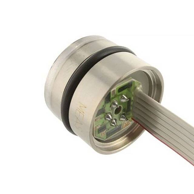

154BC SPECIFICATIONS       FEATURES       O-Ring Mount -20ºC to +85ºC Compensated Temperature 1.0% Interchangeable Span (provided by gain set resistor) Solid State Reliability ±0.3% Pressure Non Linearity Titanium Option APPLICATIONS       Medical Instruments (Dialysis Machines) Process Control Fresh, Waste, Salt and Brackish Water Measurements Refrigeration/Compressors Pressure Transmitters Hydraulic Controls Low Cost 316L Stainless Steel or Titanium 19mm Diameter Package 0 - 100mV Output Gage and Absolute Wide Compensated Temperature Range The 154BC is a 19mm small profile, media compatible, piezoresistive silicon pressure sensor packaged in a 316L stainless steel or ASTM Grade 2 CP titanium housing. The 154BC is a low-cost unit designed without a header for O-ring mounting and OEM applications where compatibility with corrosive media is required. The titanium option offers greater resistance to corrosive materials and harsh cleaning chemicals, opening the range of its application use to things such as dialysis machines and salt/brackish water measurements. The sensing package utilizes silicone oil to transfer pressure from either a 316L stainless steel or titanium diaphragm to the sensing element. A ceramic substrate is attached to the package that contains laser-trimmed resistors for temperature compensation and offset correction. An additional laser-trimmed resistor is included which can be used to adjust an external differential amplifier and provide span interchangeability to within ±1%. Please refer to the 154N uncompensated and constant voltage datasheets for more information on different features of the 154. STANDARD RANGES SENSOR SOLUTIONS ///154BC 04/2018 Page 1 154BC Range (psi) 0 to 015 0 to 030 0 to 050 0 to 100 Gage     0 to 300  Range (Bar) Absolute 0 to 007 0 to 012 0 to 018    0 to 028  PERFORMANCE SPECIFICATIONS Unless otherwise specified: Supply Current: 1.5 mA, Ambient Temperature: 25°C PARAMETERS MIN TYP MAX UNITS NOTES Span 75 100 150 mV 1 Zero Pressure Output -1.0 0 1.0 mV 2 Pressure Non Linearity -0.30 0.30 %Span 3 Pressure Hysteresis -0.20 0.20 %Span Repeatability ±0.02 Input Resistance 2.0 Output Resistance Temperature Error – Span Temperature Error – Offset Thermal Hysteresis – Span -0.25 Thermal Hysteresis – Offset -0.25 kΩ 3.0 6.0 kΩ -1.0 1.0 %Span 4 -1.0 1.0 %Span 4 ±0.05 0.25 %Span 4 ±0.05 0.25 %Span 4 ±0.10 Long Term Stability – Offset Supply Current %Span 5.8 Long Term Stability – Span 3.5 %Span/Year ±0.25 0.5 1.5 3 %Span/Year mA 5 Output Load Resistance 5 MΩ 6 Insulation Resistance (50VDC) 50 MΩ 7 Output Noise (10Hz to 1kHz) 1.0 Response Time (10% to 90%) 0.1 2.0 µV p-p ms Overload Pressure 2X Rated 8 Burst Pressure 3X Rated 9 Compensated Temperature -20 +85 °C Operating Temperature -40 +125 ºC 10 Storage Temperature -50 +125 ºC 10 Media – Pressure Port Liquids and Gases compatible with 316L Stainless Steel or ASTM Grade 2 CP Titanium Notes 1. For amplified output circuits, 3.012V ±1% interchangeability with gain set resistor. See application schematic. 2. Measured at vacuum for absolute (A), ambient for gage (G). 3. Best fit straight line. 4. Over the compensated temperature range with respect to 25°C. 5. Guarantees output/input ratiometricity. 6. Load resistance to reduce measurement errors due to output loading. 7. Between case and sensing element. 8. 2X or 500psi, whichever is less. The maximum pressure that can be applied without changing the transducer’s performance or accuracy. 9. 3X or 600psi, whichever is less. The maximum pressure that can be applied to a transducer without rupture of either the sensing element or transducer. 10. Maximum temperature range for product with standard cable and connector is -20°C to +105°C. 11. Marking: Part marked with Model Number, Pressure Range, Type, Lot Number, Serial Number and Date Code 12. Shipping: The stainless steel diaphragm is protected by a plastic cap. Each unit will be packaged individually in a plastic vial with antistatic foam. DIMENSIONS SENSOR SOLUTIONS ///154BC 04/2018 Page 2 154BC SENSOR SOLUTIONS ///154BC 04/2018 Page 3 154BC APPLICATION SCHEMATIC SENSOR SOLUTIONS ///154BC 04/2018 Page 4 154BC ORDERING INFORMATION 154BC – S – 300PG R Electrical P R C Material S T 316L Stainless Steel ASTM Grade 2 CP Ti Solder Pads Ribbon cable Cable w/ Connector Pressure Range [psi] 015PG 030PG 050PG 100PG 300PG 007BA 012BA 018BA 028BA NORTH AMERICA EUROPE ASIA Measurement Specialties, Inc., a TE Connectivity Company Tel: +1 800-522-6752 Email: customercare.frmt@te.com Measurement Specialties (Europe), Ltd., a TE Connectivity Company Tel: +31 73 624 6999 Email: customercare.lcsb@te.com Measurement Specialties (China), Ltd., a TE Connectivity Company Tel: +86 0400-820-6015 Email: customercare.shzn@te.com TE.com/sensorsolutions Measurement Specialties, Inc., a TE Connectivity company. Measurement Specialties, TE Connectivity, TE Connectivity (logo) and EVERY CONNECTION COUNTS are trademarks. All other logos, products and/or company names referred to herein might be trademarks of their respective owners. The information given herein, including drawings, illustrations and schematics which are intended for illustration purposes only, is believed to be reliable. However, TE Connectivity makes no warranties as to its accuracy or completeness and disclaims any liability in connection with its use. TE Connectivity‘s obligations shall only be as set forth in TE Connectivity‘s Standard Terms and Conditions of Sale for this product and in no case will TE Connectivity be liable for any incidental, indirect or consequential damages arising out of the sale, resale, use or misuse of the product. Users of TE Connectivity products should make their own evaluation to determine the suitability of each such product for the specific application. © 2015 TE Connectivity Ltd. family of companies SENSOR SOLUTIONS ///154BC All Rights Reserved. 04/2018 Page 5
