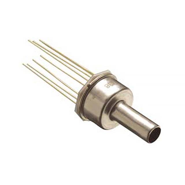

17 47 17 AND 47 UltraStable™ SPECIFICATIONS      PC Board Mountable Pressure Sensor 0-100 mV Output Current Excitation Gage and Absolute Temperature Compensated FEATURES        TO-8 Package -20ºC to +85ºC Compensated Temperature Range ±0.1% Non-Linearity 1.0% Interchangeable Span (provided by gain set resistor) Solid State Reliability APPLICATIONS       Medical Instruments Process Control Factory Automation Altitude Measurement Vacuum Measurement Handheld Calibrators SENSOR SOLUTIONS ///17 and 47 The 17 and 47 UltraStable™ are high performance, temperature compensated, piezoresistive silicon pressure sensors packaged in a TO-8 configuration. It uses Measurement Specialties’ proprietary UltraStable™ die to provide excellent performance and long-term stability over wide temperatures. Gage and absolute pressure ranges from 0-15 to 0-250 psi are available. Integral temperature compensation is provided over a range of -20ºC to +85ºC using laser-trimmed resistors. An additional laser-trimmed resistor is included to normalize pressure sensitivity variations by programming the gain of an external differential amplifier. This provides sensitivity interchangeability of ±1%. Please refer to 13 and 43 for information on products with operating pressures less than 0-15 psi. 09/2017 Page 1 17 AND 47 UltraStable™ STANDARD RANGES Range 0 to 15 0 to 30 0 to 50 0 to 100 0 to 250 psig      psia      PERFORMANCE SPECIFICATIONS Supply Current: 1.5 mA Ambient Temperature: 25°C (unless otherwise specified) PARAMETERS MIN TYP MAX UNITS NOTES Span 75 100 150 mV 1 Zero Pressure Output -2 2 mV Pressure Non Linearity -0.1 ±0.05 0.1 %Span Pressure Hysteresis -0.1 ±0.01 0.1 %Span Input Resistance 2200 4000 5800 Ω Output Resistance Temperature Error – Span Temperature Error – Zero 2 Ω 4200 -0.5 ±0.3 0.5 %Span 3 -0.5 ±0.1 0.5 %Span 3 Temperature Coefficient – Resistance 0.15 %/ºC 3 Thermal Hysteresis – Zero ±0.05 %Span 3 Short Term Stability (Offset & Span) ±0.05 %Span 4 Long Term Stability (Offset & Span) ±0.1 %Span 5 Supply Current 0.5 1.5 2.0 mA Response Time (10% to 90%) 1.0 ms Output Noise (10Hz to 1kHz) 1.0 µV p-p Pressure Overload 3X Rated Compensated Temperature -20 +85 °C Operating Temperature -40 +125 °C Storage Temperature -50 +150 °C 3 grams Weight Solder Temperature 250ºC Max 5 Sec. Media Non-Corrosive Dry Gases Compatible with Silicon, Pyrex, RTV, Gold, Nickel, and Aluminum 6 7 Notes 1. Ratiometric to supply current. For 250 psi devices, the minimum span value is 62 mV. 2. Best fit straight line. 3. Maximum temperature error between -20°C and +85°C with respect to 25°C. 4. Short term stability over 7 days with constant current and temperature. 5. Long term stability over a one year period with constant current and temperature. 6. For a zero-to-full scale pressure step change. 7. 2X maximum for 250 psi device. SENSOR SOLUTIONS ///17 and 47 09/2017 Page 2 17 AND 47 UltraStable™ DIMENSIONS CONNECTIONS SENSOR SOLUTIONS ///17 and 47 09/2017 Page 3 17 AND 47 UltraStable™ APPLICATION SCHEMATIC SENSOR SOLUTIONS ///17 and 47 09/2017 Page 4 17 AND 47 UltraStable™ ORDERING INFORMATION 17 – 030 A Pressure Range [psi] Pressure Type G Gage A Absolute 015 030 050 100 250 47 – 015 G Pressure Range [psi] Pressure Type G Gage A Absolute 015 030 050 100 250 NORTH AMERICA EUROPE ASIA Measurement Specialties, Inc., a TE Connectivity Company Tel: 800-522-6752 customercare.frmt@te.com Measurement Specialties (Europe), Ltd., a TE Connectivity Company Tel: 800-440-5100 customercare.bevx@te.com Measurement Specialties (China), Ltd., a TE Connectivity Company Tel: 0400-820-6015 mailto:customercare.shzn@te.com TE.com/sensorsolutions Measurement Specialties, Inc., a TE Connectivity company. Measurement Specialties, TE Connectivity, TE Connectivity (logo) and EVERY CONNECTION COUNTS are trademarks. All other logos, products and/or company names referred to herein might be trademarks of their respective owners. The information given herein, including drawings, illustrations and schematics which are intended for illustration purposes only, is believed to be reliable. However, TE Connectivity makes no warranties as to its accuracy or completeness and disclaims any liability in connection with its use. TE Connectivity‘s obligations shall only be as set forth in TE Connectivity‘s Standard Terms and Conditions of Sale for this product and in no case will TE Connectivity be liable for any incidental, indirect or consequential damages arising out of the sale, resale, use or misuse of the product. Users of TE Connectivity products should make their own evaluation to determine the suitability of each such product for the specific application. © 2015 TE Connectivity Ltd. family of companies SENSOR SOLUTIONS ///17 and 47 All Rights Reserved. 09/2017 Page 5
