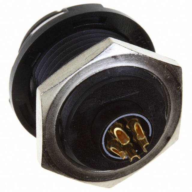

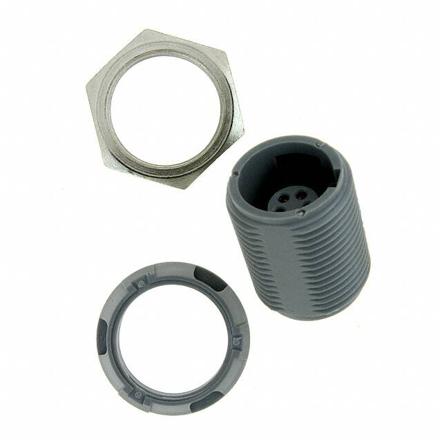

Cl i c kt hea c t i vel i nks wi t hi nt hi sdoc ume ntt o vi e w3DPDFmode l s ! CPC - Medical Connector KEY FEATURES • Connectors are user friendly, sterilizable, robust and provide secure self-latching • Self-latching mechanism is secure under axial and torsional loads • Can be overmolded with silicone or PVC flex reliefs for cable strain and flex protection • Overmolded flex-reliefs can be customized per customer requirements • Available with an integral cable collet or an overmolded flex relief ELECTRICAL • Operating Voltage - 300 VAC • Dielectric Withstanding Voltage - 1200 VAC • Current rating - 5 position - 7A 6 position - 6A 7 position - 5A 10 position - 3A • Insulation Resistance - 1000 megohms • Contact Resistance - 20 milliohms max MECHANICAL • Durability: 2500 cycles • Mating Force: 2.5 lbs max • Temperature Rating: -50° to 170° C • Unmating Force: 1.0 lb min MATERIALS • Housing, Insert, Collet & Nut - Polyphenylsulfone • Contacts - Copper Alloy, Gold Finish • Hex Nut - Copper Alloy, Nickel Finish STANDARDS & SPECS • EIA-364: Electrical Connector/Socket Test procedure Including Environmental Classifications PRODUCT OFFERING Keying (plug front view): Color Coded Receptacles and Plugs 80° 0° 20.4 REF 35.2 REF Ø 13.7 REF Ø 18.5 REF Contact Configuration: RED YELLOW 5 pin 6 pin 7 pin 10 pin GREEN Cable flex/strain reliefs: Cable collet BLUE Standard overmold WHITE MEDLOC II overmaold ©2007 by Tyco Electronics Corporation. All Rights Reserved. STERRAD, CIDEX+ are trademarks of Johnson & Johnson Corporation. Dimensions are shown for reference purposes only. Specifications subject to change. Tyco Electronics Corporation Harrisburg, PA 17001 800-522-6752 medicalsales@tycoelectronics.com tycoelectronics.com/medical 6-1773445-3-GIC-03-28-2007 Contact your local Tyco Electronics sales engineer for availability of additional configurations or complete cable assemblies. GRAY BLACK Circular Plastic Connector Medical PART NUMBERS Cable Plugs - Cable Collet - No Flex Relief 5 pin 0° Alignment Key Housing Color BLACK GRAY Collet Color BLACK RED WHITE YELLOW GREEN BLUE GRAY RED WHITE YELLOW GREEN BLUE Ø2.7 - 3.9 1877845-3 1-1877845-5 2-1877845-7 3-1877845-9 5-1877845-1 6-1877845-3 1877845-9 2-1877845-1 3-1877845-3 4-1877845-5 5-1877845-7 6-1877845-9 Cable Diameter Ø4.0 - 5.2 Ø5.3 - 6.5 1877845-2 1-1877845-4 2-1877845-6 3-1877845-8 5-1877845-0 6-1877845-2 1877845-8 2-1877845-0 3-1877845-2 4-1877845-4 5-1877845-6 6-1877845-8 1877845-1 1-1877845-3 2-1877845-5 3-1877845-7 4-1877845-9 6-1877845-1 1877845-7 1-1877845-9 3-1877845-1 4-1877845-3 5-1877845-5 6-1877845-7 Cable Diameter Ø4.0 - 5.2 Ø5.3 - 6.5 1877845-5 1-1877845-7 2-1877845-9 4-1877845-1 5-1877845-3 6-1877845-5 1-1877845-1 2-1877845-3 3-1877845-5 4-1877845-7 5-1877845-9 7-1877845-1 1877845-4 1-1877845-6 2-1877845-8 4-1877845-0 5-1877845-2 6-1877845-4 1-1877845-0 2-1877845-2 3-1877845-4 4-1877845-6 5-1877845-8 7-1877845-0 5 pin 80° Alignment Key Housing Color BLACK GRAY Collet Color BLACK RED WHITE YELLOW GREEN BLUE GRAY RED WHITE YELLOW GREEN BLUE Ø2.7 - 3.9 1877845-6 1-1877845-8 3-1877845-0 4-1877845-2 5-1877845-4 6-1877845-6 1-1877845-2 2-1877845-4 3-1877845-6 4-1877845-8 6-1877845-0 7-1877845-2 6 pin 0 ° Alignment Key Housing Color BLACK GRAY Collet Color BLACK RED WHITE YELLOW GREEN BLUE GRAY RED WHITE YELLOW GREEN BLUE Ø2.7 - 3.9 1877846-3 1-1877846-5 2-1877846-7 3-1877846-9 5-1877846-1 6-1877846-3 1877846-9 2-1877846-1 3-1877846-3 4-1877846-5 5-1877846-7 6-1877846-9 Cable Diameter Ø4.0 - 5.2 Ø5.3 - 6.5 1877846-2 1-1877846-4 2-1877846-6 3-1877846-8 5-1877846-0 6-1877846-2 1877846-8 2-1877845-0 3-1877846-2 4-1877846-4 5-1877846-6 6-1877846-8 1877846-1 1-1877846-3 2-1877846-5 3-1877846-7 4-1877846-9 6-1877846-1 1877846-7 1-1877846-9 3-1877846-1 4-1877846-3 5-1877846-5 6-1877846-7 Cable Diameter Ø4.0 - 5.2 Ø5.3 - 6.5 1877846-5 1-1877846-7 2-1877846-9 4-1877846-1 5-1877846-3 6-1877846-5 1-1877846-1 2-1877846-3 3-1877846-5 4-1877846-7 5-1877846-9 7-1877846-1 1877846-4 1-1877846-6 2-1877846-8 4-1877846-0 5-1877846-2 6-1877846-4 1-1877846-0 2-1877846-2 3-1877846-4 4-1877846-6 5-1877846-8 7-1877846-0 6 pin 80° Alignment Key Housing Color BLACK GRAY 3 Collet Color BLACK RED WHITE YELLOW GREEN BLUE GRAY RED WHITE YELLOW GREEN BLUE Ø2.7 - 3.9 1877846-6 1-1877846-8 3-1877846-0 4-1877846-2 5-1877846-4 6-1877846-6 1-1877846-2 2-1877846-4 3-1877846-6 4-1877846-8 6-1877846-0 7-1877846-2 Circular Plastic Connector Medical Cable Plugs - Cable Collet - No Flex Relief 7 pin 0° Alignment Key Housing Color BLACK GRAY Collet Color BLACK RED WHITE YELLOW GREEN BLUE GRAY RED WHITE YELLOW GREEN BLUE Ø2.7 - 3.9 1877847-3 1-1877847-5 2-1877847-7 3-1877847-9 5-1877847-1 6-1877847-3 1877847-9 2-1877847-1 3-1877847-3 4-1877847-5 5-1877847-7 6-1877847-9 Cable Diameter Ø4.0 - 5.2 Ø5.3 - 6.5 1877847-2 1-1877847-4 2-1877847-6 3-1877847-8 5-1877847-0 6-1877847-2 1877847-8 2-1877847-0 3-1877847-2 4-1877847-4 5-1877847-6 6-1877847-8 1877847-1 1-1877847-3 2-1877847-5 3-1877847-7 4-1877847-9 6-1877847-1 1877847-7 1-1877847-9 3-1877847-1 4-1877847-3 5-1877847-5 6-1877847-7 Cable Diameter Ø4.0 - 5.2 Ø5.3 - 6.5 1877847-5 1-1877847-7 2-1877847-9 4-1877847-1 5-1877847-3 6-1877847-5 1-1877847-1 2-1877847-3 3-1877847-5 4-1877847-7 5-1877847-9 7-1877847-1 1877847-4 1-1877847-6 2-1877847-8 4-1877847-0 5-1877847-2 6-1877847-4 1-1877847-0 2-1877847-2 3-1877847-4 4-1877847-6 5-1877847-8 7-1877847-0 Cable Diameter Ø4.0 - 5.2 Ø5.3 - 6.5 1877848-2 1-1877848-4 2-1877848-6 3-1877848-8 5-1877848-0 6-1877848-2 1877848-8 2-1877848-0 3-1877848-2 4-1877848-4 5-1877848-6 6-1877848-8 1877848-1 1-1877848-3 2-1877848-5 3-1877848-7 4-1877848-9 6-1877848-1 1877848-7 1-1877848-9 3-1877848-1 4-1877848-3 5-1877848-5 6-1877848-7 Cable Diameter Ø4.0 - 5.2 Ø5.3 - 6.5 1877848-5 1-1877848-7 2-1877848-9 4-1877848-1 5-1877848-3 6-1877848-5 1-1877848-1 2-1877848-3 3-1877848-5 4-1877848-7 5-1877848-9 7-1877848-1 1877848-4 1-1877848-6 2-1877848-8 4-1877848-0 5-1877848-2 6-1877848-4 1-1877848-0 2-1877848-2 3-1877848-4 4-1877848-6 5-1877848-8 7-1877848-0 7 pin 8 0° Alignment Key Housing Color BLACK GRAY Collet Color BLACK RED WHITE YELLOW GREEN BLUE GRAY RED WHITE YELLOW GREEN BLUE Ø2.7 - 3.9 1877847-6 1-1877847-8 3-1877847-0 4-1877847-2 5-1877847-4 6-1877847-6 1-1877847-2 2-1877847-4 3-1877847-6 4-1877847-8 6-1877847-0 7-1877847-2 10 pin 0° Alignment Key Housing Color BLACK GRAY Collet Color BLACK RED WHITE YELLOW GREEN BLUE GRAY RED WHITE YELLOW GREEN BLUE Ø2.7 - 3.9 1877848-3 1-1877848-5 2-1877848-7 3-1877848-9 5-1877848-1 6-1877848-3 1877848-9 2-1877848-1 3-1877848-3 4-1877848-5 5-1877848-7 6-1877848-9 10 pin 80° Alignment Key Housing Color BLACK GRAY Collet Color BLACK RED WHITE YELLOW GREEN BLUE GRAY RED WHITE YELLOW GREEN BLUE Ø2.7 - 3.9 1877848-6 1-1877848-8 3-1877848-0 4-1877848-2 5-1877848-4 6-1877848-6 1-1877848-2 2-1877848-4 3-1877848-6 4-1877848-8 6-1877848-0 7-1877848-2 4 Circular Plastic Connector Medical Cable Plugs - Overmold Flex Relief - Cable OD Ø6.4 mm Max Color Standard MEDLOC II Contacts Keying 5P 5P 5P 5P 0° 80° 0° 80° Black.............. 1877849-1............. 1811797-1 Black.............. 1877849-2............ 1811797-2 Gray............... 1877849-3............ 1811797-3 Gray............... 1877849-4............ 1811797-4 6P 6P 6P 6P 0° 80° 0° 80° Black.............. 1877850-1............. 1811897-1 Black.............. 1877850-2............ 1811897-2 Gray............... 1877850-3............ 1811897-3 Gray............... 1877850-4............ 1811897-4 7P 7P 7P 7P 0° 80° 0° 80° Black.............. 1877851-1............... 1811798-1 Black.............. 1877851-2.............. 1811798-2 Gray............... 1877851-3.............. 1811798-3 Gray............... 1877851-4............. 1811798-4 10P 10P 10P 10P 0° 80° 0° 80° Black.............. 1877852-1.............. 1811799-1 Black.............. 1877852-2............. 1811799-2 Gray............... 1877852-3............. 1811799-3 Gray............... 1877852-4............ 1811799-4 Panel Mount - Receptacles Contacts Keying 5P 5P 5P 5P 6P 6P 6P 6P 7P 7P 7P 7P 10P 10P 10P 10P 0° 0° 80° 80° 0° 0° 80° 80° 0° 0° 80° 80° 0° 0° 80° 80° 5 Color Part number Gray................ 1877066-1 Black............... 1877066-2 Gray................ 1877066-3 Black............... 1877066-4 Gray................ 1877067-1 Black............... 1877067-2 Gray................ 1877067-3 Black............... 1877067-4 Gray................ 1877068-1 Black............... 1877068-2 Gray................ 1877068-3 Black............... 1877068-4 Gray................ 1877069-1 Black............... 1877069-2 Gray................ 1877069-3 Black............... 1877069-4 Front Nut Back Nut Wrench RED........................ 1811448-1 WHITE.................. 1811448-2 YELLOW.............. 1811448-3 GREEN.................. 1811448-4 BLUE..................... 1811448-5 RED........................ 1877841-1 WHITE................... 1877841-2 YELLOW............... 1877841-3 GREEN.................. 1877841-4 BLUE...................... 1877841-5 GRAY...................... 195457-1 Circular Plastic Connector Medical NOTES: 6
