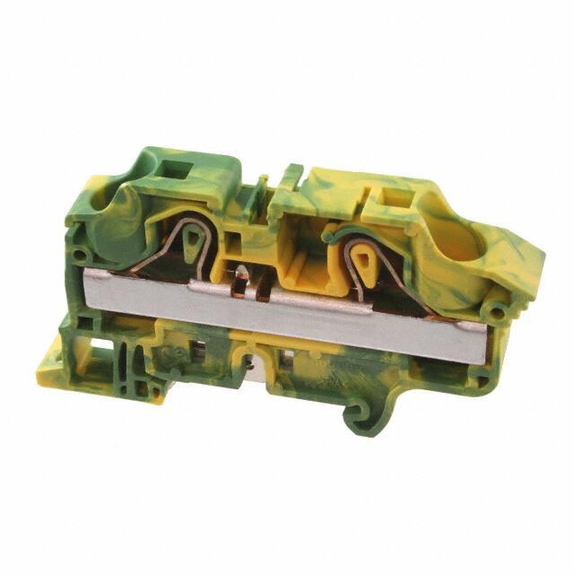

ZK16-PE TE Connectivity has acquired the DIN Rail Terminal Block product range from ABB Products Low Voltage Products and Systems Connection Devices Terminal Blocks SNK Series General Information Extended Product Type: ZK16-PE Product ID: 1SNK712150R0000 EAN: 3472597121500 Catalog Description: ZK16-PE PI-Spring clamp Terminal Block - Ground - Green Yellow Long Description: Improve the safety of your installation in the event of a short-circuit thanks to our screwless rail contact: - Rail contact non operator dependent, - Perf ormances above the requirements of the IEC 60947-7-2 terminal block sta ndard, - Secured snap on or off the rail, - Profile aligned with ZK16. Ordering Color: Green-Yellow Minimum Order Quantity: 20 piece Customs Tariff Number: 85369010 Popular Downloads Data Sheet, Technical Information: 1SNK162036D0201 Instructions and Manuals: 1SNK160027C0201 Dimensions Product Net Width: 12 mm Product Net Height: 89 mm Product Net Length: 47.6 mm Product Net Depth / Length: 47.6 mm Product Net Weight: 47 g Technical Rated Cross-Section: 16 mm² Spacing: 12 mm Connection Type: PI Spring Function: Ground Number of Levels: 1 Connecting Capacity Main Circuit: Spring Spring Spring Spring Gauge Type: A7 & 6.3 mm Dia. Clamp Clamp Clamp Clamp / / / / Flexible 1x 0.5 ... 16 mm² Rigid 1x 0.5 ... 25 mm² With Insulated Ferrrule 1x 0.5 ... 16 mm² Without Insulated Ferrule 1x 0.5 ... 16 mm² Rated Short-time Withstand for 1 s 1920 A Current (Icw): Rated Impulse Withstand Voltage 8000 V (Uimp): Dielectric Test Voltage: 2200 V Pollution Degree: 3 Degree of Protection: acc. to IEC 60529, IEC 60947-1, EN 60529 Main Terminals IP20 Insulation Material: Polyamide Mounting on DIN Rail: TH35-7.5 (35 x 7.5 mm Mounting Rail) acc. to IEC 60715 TH35-15 (35 x 15 mm Mounting Rail) acc. to IEC 60715 Wire Stripping Length: 15.0 mm Recommended Screw Driver: 4 mm Technical UL/CSA UL/CSA: Spring Clamp / Rigid 1x 20 ... 4 AWG Spring Clamp / With Insulated Ferrrule 1x 20 ... 6 AWG Spring Clamp / Without Insulated Ferrule 1x 20 ... 6 AWG Connecting Capacity UL/CSA: Stranded 4 AWG Flammability According to UL94: V0 Connecting Capacity Main Circuit Environmental Ambient Air Temperature: Operation -55 ... +110 °C Storage -55 ... +110 °C Resistance to Vibrations acc. to Compliant IEC 60068-2-6: RoHS Status: Following EU Directive 2011/65/EU Certificates and Declarations (Document Number) ATEX Certificate: 1SND162009A1702 BV Certificate: 1SND162013A0203 CB Certificate: 1SND162018A0201 CSA Certificate: 1SND162014A0206 cUL Certificate: 1SND162012A0204 Declaration of Conformity - CE: 1SND225112U1004 DNV Certificate: 1SND162023A0200 EAC Certificate: 1SND161010A1100 Environmental Information: 1SND220072E1002 Instructions and Manuals: 1SNK160027C0201 RoHS Information: 1SND230535F0201 Classifications Object Classification Code: X ETIM 4: EC000901 - Ground terminal block ETIM 5: EC000901 - Ground terminal block ETIM 6: EC000901 - Ground terminal block Container Information Package Level 1 Units: 20 piece Package Level 1 Width: 86 mm Package Level 1 Depth / Length: 250 mm Package Level 1 Height: 51 mm Package Level 1 Gross Weight: 0.96 kg Package Level 1 EAN: 3472597121500 Package Level 2 Units: 240 piece Package Level 2 Width: 300 mm Package Level 2 Depth / Length: 400 mm Package Level 2 Height: 200 mm Package Level 2 Gross Weight: 11.52 kg Package Level 3 Units: 11520 piece Product Packing Type: Box
