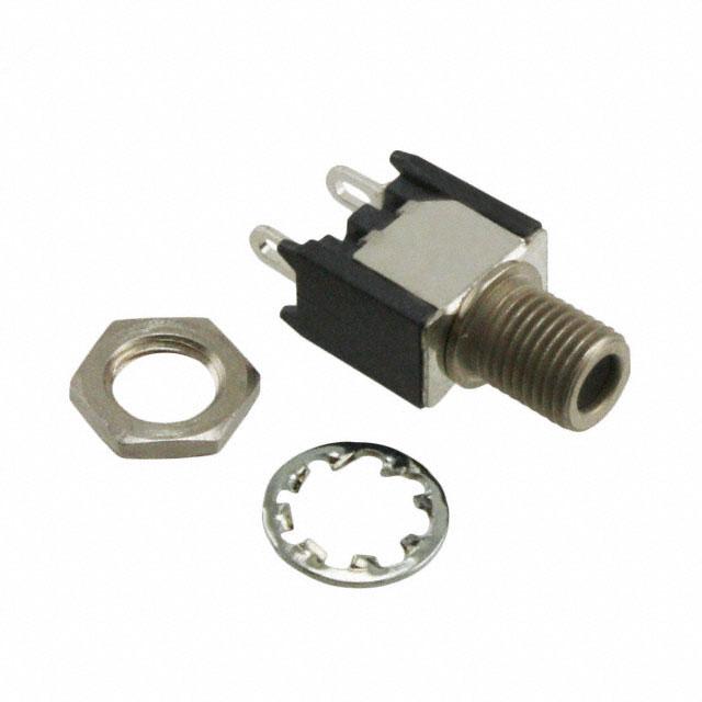

    按动开关 6万次 单刀单掷-常开 1A 20V -30℃~+65℃
2-1825098-0 数据手册
TP Series Pushbutton Switches, Tiny, Part Number Matrix Material Specifications: Typical Performance Characteristics: Contacts: Gold – gold plate, silver- silver plate Case Material: High temperature polyester Actuator Material: Polyamide Terminals/Fixed Contacts: Tin lead plate Terminal Seal: SP epoxy, DP epoxy optional Contacts Rating: Gold 0.4 VA Max. @ 20 VDC or peak AC Silver: 1A @ 125 VAC or 28 VDC resistive Initial Contact Resistance: 20 Milliohms max. Contact Timing: Break-before-make Insulation Resistance: 1,000 Megohms @ 500 VDC min. Dielectric Strength: 1,000 Volts @ sea level Actuation Force: 500 to 400 Grams Plunger/Actuator Travel: 030” (.762) Life Expectancy: See Below Note: Hardware included with switches Environmental Specifications: Operating Temperature: -22°F to + 149°F (-30°C to + 65°C) Storage Temperature: -22°F to + 149°F (-30°C to + 65°C) Solder Heat Resistance: See page M3-4 Part Numbering Matrix: Model TP Bushing Actuator F Poles 1= Single 2= Double Blank: Sp. No Bushing A=Rnd. No Bushing B=Rnd., 188” Bushing Dia. Unthreaded C=Rnd., 10/48 Bushing Dia. D=Rnd., .250” Bushing dia. Unthreaded F=Rnd., ¼-40 Bushing Dia. Rating Function Terminations Process Seal Button Colors Plating G= Gold None= Silver** 1= Gold 0.4 VA 3= Silver** 1 Amp ES= Process Sealed*** Process seal: disposable boot, epoxied double case 0= Black Blank= Wire Lug 2= Red PC= Printed Circuit RA= Right Angle *** VRA= Vertical Right Angle SP DP C M S.T. Momentary F R D.T. Momentary F=Flush Actuator* ES switches provided with disposable boot used only during cleaning operation * Available with “B” and “C” bushing only ** Silver - available only in wire lug and PC termination *** Right angle, ES available with “B” and “C” bushing only **** Available only in single pole TP Series Life Expectancy Chart Application Note: For 3 pole and 4 pole, refer to pages D22 and D24… “ MP Series” For surface mount termination, refer to pages D3-D5… “TSP Series” Process Seal Version NOT TP Pushbuttons 0.4 (gold Plate) 1A (Silver Plate) 1 Pole 2Pole 100,000 80,000 60,000 50,000 Process Seal Version Available TPA TPB TPC TPD TPF Page 1 Document 1-1437571-0 Rev A Date: 30-Aug-2018 Dimensions in millimetres unless otherwise specified Dimensions Shown for reference purposes only. Specifications subject to change For Email, phone or live chat, go to: www.te.com/help TP Series Pushbutton Switches, Tiny, Straight or Right Angle, Single or Dual Actuators See Page 1 for Product Specifications Page 2 Document 1-1437571-0 Rev A Date: 30-Aug-2018 Dimensions in millimetres unless otherwise specified Dimensions Shown for reference purposes only. Specifications subject to change For Email, phone or live chat, go to: www.te.com/help TP Series Pushbutton Switches, Tiny, Straight or Right Angle, Single or Dual Actuators See Page 1 for Product Specifications Pushbuttons, Tiny, Straight or Right Angle, Unthreaded or 10-48 Bushings Page 3 Document 1-1437571-0 Rev A Date: 30-Aug-2018 Dimensions in millimetres unless otherwise specified Dimensions Shown for reference purposes only. Specifications subject to change For Email, phone or live chat, go to: www.te.com/help TP Series See Page 1 for Product Specifications Document 1-1437571-0 Rev A Date: 30-Aug-2018 Dimensions in millimetres unless otherwise specified Dimensions Shown for reference purposes only. Specifications subject to change Page 4 For Email, phone or live chat, go to: www.te.com/help TP Series Pushbutton Switches, Tiny, Straight or Right Angle Flush Actuator See Page 1 for Product Specifications Document 1-1437571-0 Rev A Date: 30-Aug-2018 Dimensions in millimetres unless otherwise specified Dimensions Shown for reference purposes only. Specifications subject to change Page 5 For Email, phone or live chat, go to: www.te.com/help TP Series Pushbuttons, Tiny, Vertical Right Angle, Unthreaded or 10-48 Bushings See Page 1 for Product Specifications Pushbuttons, Tiny, Vertical, Unthreaded, or ¼ - 40 Bushings Page 6 Document 1-1437571-0 Rev A Date: 30-Aug-2018 Dimensions in millimetres unless otherwise specified Dimensions Shown for reference purposes only. Specifications subject to change For Email, phone or live chat, go to: www.te.com/help TP Series Pushbutton Switches, Tiny, Vertical or Right Angle, Unthreaded ¼ to 40 Bushing Page 7 Document 1-1437571-0 Rev A Date: 30-Aug-2018 Dimensions in millimetres unless otherwise specified Dimensions Shown for reference purposes only. Specifications subject to change For Email, phone or live chat, go to: www.te.com/help
