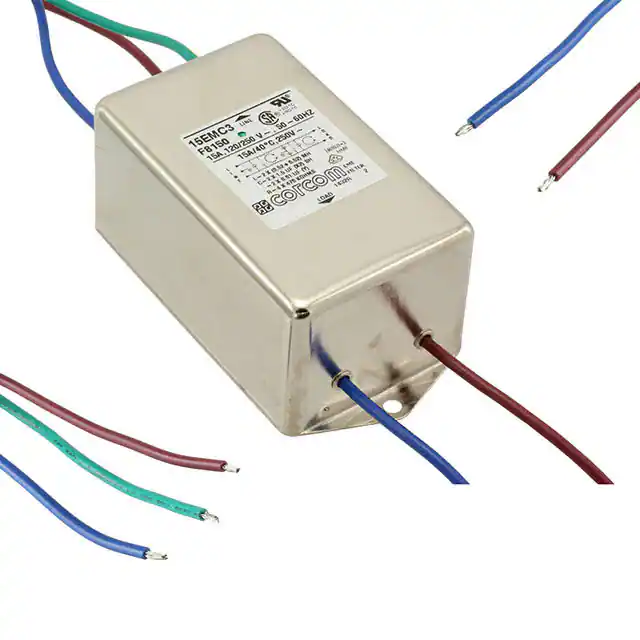

Catalog: 1654001 Issue Date: 06.2011 Corcom Product Guide Compact and Cost-effective Dual Stage RFI Power Line Filters EMC Series UL Recognized CSA Certified VDE Approved EMC6 EMC1 EMC Series Specifications • Compact dual stage filter series Maximum leakage current each Line to Ground: • Cost-effective design • Current rating up to 30A @ 120 VAC 60 Hz: @250 VAC 50 Hz: 3, 6, 10A 15, 20, 30A .21 mA .43 mA .73 mA 1.52 mA • High differential mode attenuation in the lower frequency range Hipot rating (one minute): Line to Ground: Line to Line: • High common mode performance Rated Voltage (max): 250 VAC Operating Frequency: 50/60 Hz • Suitable for switching mode power supplies Rated Current: 2250 VDC 1450 VDC 3 to 30A Operating Ambient Temperature Range (at rated current Ir): -10°C to +40°C In an ambient temperature (Ta) higher than +40°C the maximum operating current (Io) is calculated as follows: Io = Ir (85-Ta)/45 Ordering Information Electrical Schematic 10 EMC 1 LINE LOAD Case Styles 1 – .250 [6.3] spade terminals 3 – Wire leads 6 – Threaded bolt EMC Series Current Rating 3, 6, 10, 15, 20 or 30A Available Part Numbers 3EMC1 6EMC1 10EMC1 15EMC1 20EMC1 3EMC3 6EMC3 10EMC3 15EMC3 10EMC6 15EMC6 20EMC6 30EMC6 24 Dimensions are in inches and millimeters unless otherwise specified. Values in italics are metric equivalents. Dimensions are shown for reference purposes only. Specifications subject to change. For email, phone or live chat, please go to te.com/help corcom.com Catalog: 1654001 Issue Date: 06.2011 Corcom Product Guide Compact and Cost-effective Dual Stage RFI Power Line Filters (continued) EMC Series Case Styles EMC1 30EMC6 1 B D RFI Power Line Filters E B C D E A A           C    Case Dimensions EMC3 Part No. Green/ Yellow Brown 3EMC1 Brown B 6EMC1 Blue Blue 10EMC1 A D E    C 15EMC1 20EMC1   3EMC3 6EMC3 EMC6 10EMC3 15EMC3 B 10EMC6 15EMC6 20EMC6 D E A    C 30EMC6 A B C D E                                                                                                                       25 Dimensions are in inches and millimeters unless otherwise specified. Values in italics are metric equivalents. Dimensions are shown for reference purposes only. Specifications subject to change. For email, phone or live chat, please go to te.com/help corcom.com Catalog: 1654001 Issue Date: 06.2011 Corcom Product Guide Compact and Cost-effective Dual Stage RFI Power Line Filters (continued) EMC Series Performance Data Typical Insertion Loss Measured in closed 50 Ohm system 3EMC 6EMC 10EMC 15EMC db 100 db 100 db 100 db 100 90 90 90 90 80 80 80 80 70 70 70 70 60 60 60 60 50 50 50 50 40 40 40 40 30 30 30 30 20 20 20 20 10 10 10 0 0.1 1 10 30 Frequency in MHz 0 0.1 1 20EMC 30EMC db 100 db 100 90 90 80 80 70 70 60 60 50 50 40 40 30 30 20 20 0 10 0.1 1 10 30 Frequency in MHz 0 0.1 1 10 30 Frequency in MHz Common Mode / Asymmetrical (L-G) Differential Mode / Symmetrical (L-L) 10 10 0 10 30 Frequency in MHz 0.1 1 10 30 Frequency in MHz 0 0.1 1 10 30 Frequency in MHz Minimum Insertion Loss Common Mode / Asymmetrical (Line to Ground)           Differential Mode / Symmetrical (Line to Line)                                                                                                                                       26 Dimensions are in inches and millimeters unless otherwise specified. Values in italics are metric equivalents. Dimensions are shown for reference purposes only. Specifications subject to change. For email, phone or live chat, please go to te.com/help corcom.com
