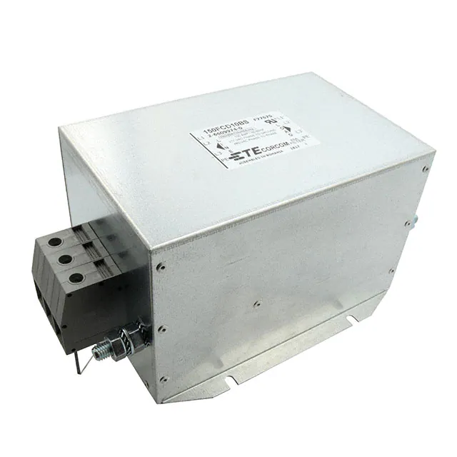

Catalog: 1654001 Issue Date: 06.2011 Corcom Product Guide 3-phase Delta External Power Line Filter for Frequency Converters FCD Series UL Recognized 6FCD10 FCD Series Specifications • Suitable to meet the latest EMC standards • Insulated safety terminals • Suitable for EMC troubleshooting in the field • Very high attenuation • High insertion loss • BS models optimized for very high insertion loss • BS models suitable for infeed/regenerative (ER) applications • Touch safe terminals provide easy connections and prevent inadvertent contact for safety in the most demanding applications Ordering Information 150 FCD 10 BS -95 Terminal Block Option -95 – 95mm terminal block available on 150A only omit for standard terminals Filter Type B – Single stage BS – High performance Single stage. Omit for dual stage Input / Output Style 10 – Terminal Block Maximum leakage current voltage drop to virtual N to PE/V: 6FCD10: 12 & 16FCD10: 25, 36 & 50FCD10: 12 & 16FCD10B: 25& 36FCD10B: 50FCD10B: 80 & 110FCD10B: 150FCD10B: 180 & 230FCD10B: FCD10BS: .26 mA/V .45 mA/V .52 mA/V .46 mA/V .52 mA/V .57 mA/V .62 mA/V .63 mA/V .92 mA/V 3.25 mA/V Hipot rating (one minute): Line to Ground: Line to Line: 2250 VDC 1450 VDC Rated Voltage (max): Phase to Phase: Phase to Neutral / Ground: 480 VAC 277 VAC Operating Frequency: 50/60 Hz Rated Current: 6 to 230A Operating Ambient Temperature Range (at rated current Ir): -10°C to +40°C In an ambient temperature (Ta) higher than +40°C the maximum operating current (Io) is calculated as follows: Io = Ir (85-Ta)/45 Electrical Schematics 6FCD10 Power line Device FCD Series Current Rating 6, 12, 16, 25, 36, 50, 80, 110, 150, 180 or 230A PE PE 118 Dimensions are in inches and millimeters unless otherwise specified. Values in italics are metric equivalents. Dimensions are shown for reference purposes only. Specifications subject to change. For email, phone or live chat, please go to te.com/help corcom.com Corcom Product Guide Catalog: 1654001 Issue Date: 06.2011 3-phase Delta External Filter for Frequency Converters (continued) FCD Series Electrical Schematics (continued) Available Part Numbers 12 to 50A FCD10 Power line Device L1 L1 L2 L2 L3 L3 PE PE Device L1 L1 L2 L2 L3 L3 Slots: .260 6.61 D PE 80 to 230A FCD10B Power line 2 Case Styles 6 to 50A FCD10 & FCD10B B PE 12FCD10B 50FCD10BS 16FCD10B 80FCD10BS 25FCD10B 110FCD10BS 36FCD10B 150FCD10BS 50FCD10B 150FCD10BS-95 80FCD10B 180FCD10BS 110FCD10B 230FCD10BS 150FCD10B 150FCD10B-95 180FCD10B 230FCD10B Three Phase Filters 12 to 50A FCD10B Power line 6FCD10 12FCD10 16FCD10 25FCD10 36FCD10 50FCD10 F E Device L1 L1 L2 L2 L3 L3 C A 80 to 150A FCD10B 50 to 150A FCD10BS PE Slots: .260 6.61 PE FCD10BS Power line B Device L1 L1 L2 L2 L3 L3 D F E 150FCD10B-95 Terminal Block C PE PE A A (150FCD10B-95) 119 Dimensions are in inches and millimeters unless otherwise specified. Values in italics are metric equivalents. Dimensions are shown for reference purposes only. Specifications subject to change. For email, phone or live chat, please go to te.com/help corcom.com Corcom Product Guide Catalog: 1654001 Issue Date: 06.2011 3-phase Delta External Filter for Frequency Converters (continued) FCD Series Case Styles (continued) 180 to 230FCD10B\BS Slots: .260 6.61 Case Dimensions Part No. Center slot on 180 & 230A only D E F                        25FCD10/10B 36FCD10/10B 50FCD10/10B F             E C Terminals Terminal Size Torque max. lbf-in [N-m] Ground 8-32 20.7 [2.34] 4mm² 7.08 [0.8] 6FCD10 Line/Load terminal block Ground M5 26.58 [3.0] Line/Load 4mm² 7.08 [0.8] terminal block M5 26.58 [3.0] Line/Load 6mm² 15.93 [1.8] Ground Line/Load Ground 50FCD10BS Line/Load Ground 80 to 150FCD10B 80 to 150FCD10BS Line/Load 150FCD10B/BS-95 Ground 180FCD10B/BS Line/Load 230FCD10B/BS       80FCD10B/BS 110FCD10B/BS 150FCD10B/BS       terminal block M5 10mm² terminal block M10 16mm² terminal block M10 180FCD10B/BS 230FCD10B/BS                               Performance Data Typical Insertion Loss Ground 50FCD10/10B 50FCD10BS 150FCD10B-95 150FCD10BS-95 A 25FCD10/10B 36FCD10/10B C        12FCD10/10B 16FCD10/10B B D 12FCD10/10B 16FCD10/10B B        6FCD10 Part No. A  26.58 [3.0] 15.93 [1.8] 88.5 [10.0] 20.36 [2.3] 88.5 [10.0] Measured in closed 50 Ohm system 6FCD10 12FCD10 db 100 db 100 90 90 80 80 70 70 60 60 50 50 40 40 30 30 20 20 10 50mm² terminal block 70.80 [8.0] M10 88.5 [10.0] 95mm² 177.0 [20.0] terminal block 0 10 0.01 0.1 1 10 30 Frequency in MHz 0 0.01 0.1 1 10 30 Frequency in MHz Common Mode / Asymmetrical (L-G) Differential Mode / Symmetrical (L-L) 120 Dimensions are in inches and millimeters unless otherwise specified. Values in italics are metric equivalents. Dimensions are shown for reference purposes only. Specifications subject to change. For email, phone or live chat, please go to te.com/help corcom.com Corcom Product Guide Catalog: 1654001 Issue Date: 06.2011 3-phase Delta External Filter for Frequency Converters (continued) FCD Series Performance Data (continued) Typical Insertion Loss (continued) Measured in closed 50 Ohm system 16FCD10 25FCD10 36FCD10 50FCD10 db 100 db 100 db 100 db 100 90 90 90 90 80 80 80 80 70 70 70 70 60 60 60 60 50 50 50 50 40 40 40 40 30 30 30 30 20 20 20 20 10 10 10 0 0.01 0.1 1 10 30 Frequency in MHz 0 0.01 0.1 1 10 30 Frequency in MHz 0 2 10 0.01 0.1 1 10 30 Frequency in MHz 0 0.01 0.1 16FCD10B 25FCD10B 36FCD10B db 100 db 100 db 100 db 100 90 90 90 90 80 80 80 80 70 70 70 70 60 60 60 60 50 50 50 50 40 40 40 40 30 30 30 30 20 20 20 20 10 10 10 0 0 0 0.01 0.1 1 10 30 Frequency in MHz 0.01 0.1 1 10 30 Frequency in MHz 0.1 1 10 30 Frequency in MHz 0 0.01 0.1 80FCD10B 110FCD10B 150FCD10B db 100 db 100 db 100 db 100 90 90 90 90 80 80 80 80 70 70 70 70 60 60 60 60 50 50 50 50 40 40 40 40 30 30 30 30 20 20 20 20 10 10 10 0.01 0.1 1 10 30 Frequency in MHz 0 0.01 0.1 1 10 30 Frequency in MHz 0 0.1 1 10 30 Frequency in MHz 0 0.01 0.1 230FCD10B 50/80/110FCD10BS 150FCD10BS db 100 db 100 db 100 db 100 90 90 90 90 80 80 80 80 70 70 70 70 60 60 60 60 50 50 50 50 40 40 40 40 30 30 30 30 20 20 20 20 10 10 10 0.01 0.1 1 10 30 Frequency in MHz 0 0.01 0.1 180FCD10BS 230FCD10BS db 100 db 100 90 90 80 10 30 Frequency in MHz 0 1 10 30 Frequency in MHz 1 10 30 Frequency in MHz 10 0.01 0.1 1 10 30 Frequency in MHz 0 0.01 0.1 80 70 70 60 60 50 50 40 40 30 30 20 20 10 0 1 10 30 Frequency in MHz 10 0.01 180FCD10B 0 1 10 0.01 50FCD10B 0 10 30 Frequency in MHz Three Phase Filters 12FCD10B 1 Common Mode / Asymmetrical (L-G) Differential Mode / Symmetrical (L-L) 10 0.01 0.1 1 10 30 Frequency in MHz 0 0.01 0.1 1 10 30 Frequency in MHz 121 Dimensions are in inches and millimeters unless otherwise specified. Values in italics are metric equivalents. Dimensions are shown for reference purposes only. Specifications subject to change. For email, phone or live chat, please go to te.com/help corcom.com Corcom Product Guide Catalog: 1654001 Issue Date: 06.2011 3-phase Delta External Filter for Frequency Converters (continued) FCD Series Performance Data (continued) Minimum Insertion Loss Measured in closed 50 Ohm system Common Mode / Asymmetrical (Line to Ground)          Differential Mode / Symmetrical (Line to Line)                                                                                                                                                                                                                                                                                                                                                                                                                                                  122 Dimensions are in inches and millimeters unless otherwise specified. Values in italics are metric equivalents. Dimensions are shown for reference purposes only. Specifications subject to change. For email, phone or live chat, please go to te.com/help corcom.com
