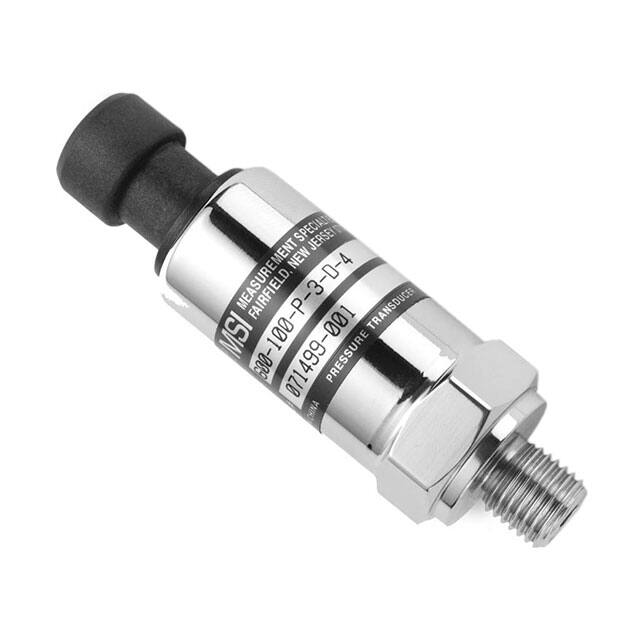

Microfused Technology S P E C I A L T I E S MSP-600 New High Accuracy, Digitally Compensated EMI/RFI Protected Stainless Steel Isolated Pressure Transducer ■ ■ ■ 1% Total Error Band ■ No Leaks ■ No Welds ■ No “O” Rings ■ No Silicone Oil ■ 1 High Accuracy Low Cost OEM 100% Leak Proof Features High Accuracy Digitally Compensated One-piece Stainless Steel Construction Ranges up to 10,000 PSI or 700 BAR Amplified Outputs Wide Operating Temperature Range Low Pressure Configuration Applications Pumps and Compressors Hydraulic/Pneumatic Systems Off Road/Mobile Equipment Energy and Water Management Pressure Instrumentation Refrigeration Equipment Agriculture Equipment Train Braking Systems UL LISTED Description The MSP series pressure transducers set a new price-performance standard for low cost, high volume, commercial and industrial applications. This series is suitable for measurement of liquid or gas pressure, even for difficult media such as contaminated water, steam, and mildly corrosive fluids or gases. NEW LY TAL ED I G I D AT S N E P COM ESIGN D The transducer pressure cavity is machined from a solid piece of 17-4 PH stainless steel. The standard version includes a 1/4" NPT pipe thread allowing a leak-proof, all metal sealed system. There are no “o”-rings, welds or organics exposed to the pressure media. The durability is excellent. Measurement Specialties proprietary Microfused technology, derived from demanding aerospace applications, employs micromachined silicon piezoresistive strain gages, fused with high temperature glass to a stainless steel diaphragm. This approach achieves media compatibility simply and elegantly providing an exceptionally stable sensor without the p-n junctions of conventional micromachined sensors. This product is geared to the OEM customer using medium to high volumes. The standard version is suitable for many applications, but the dedicated design team at our Transducer Engineering Center stands ready to provide a semi-custom design where the volume and application warrants. SPECIFICATIONS Performance at 25˚C (77˚F): Pressure range 0-25, 50, 75, 100, 250, 500, 1000, 2500, 5000, 7500, 10000 PSI (0-3, 6, 7, 17, 35, 70, 175, 350, 525, 700 BAR) Accuracy, % of FS Span (combined linearity, hysterisis and repeatability) ± 0.25% BSL, max (per ISA S37.2) Media compatibility Pressure cycles Pressure overload Burst pressure Long term stability (1 year) 17-4 PH stainless steel (optional 316L stainless) 10 million, minimum 2 times rated pressure 4 times full scale or 20,000 PSI, whichever is less ± 0.25% FS Span (Typical) Electrical: Ratiometric Non-Ratiometric Supply voltage Supply current Output 4.75 to 5.25VDC
2000973
物料型号:MSP-600
器件简介:MSP-600是一款高精度、数字补偿的EMI/RFI保护不锈钢隔离压力变送器,适用于OEM低成本解决方案,100%无泄漏。
引脚分配:文档中未明确列出引脚分配,但提供了电气连接图,显示了电源、地、输出和压力端口。
参数特性: - 总误差带:1%(包括线性度、回滞和重复性) - 压力范围:0-25,50,75,100, 250, 500, 1000, 2500, 5000, 7500, 10000 PSI(或相应BAR) - 长期稳定性:1年内±0.25%F Span(典型值) - 供电电压:4.75至5.25VDC(比例度量)或10-30VDC(非比例度量) - 输出:0.5至4.5V(5V时)或1-5V(三线制)或4-20mA(两线制)
功能详解: - 采用Microfused技术,源自航空航天应用,使用微加工硅压阻应变计,与不锈钢膜片高温玻璃融合。 - 适用于液体或气体压力测量,包括污染水、蒸汽和轻度腐蚀性流体或气体。
应用信息: - 适用于泵和压缩机、液压/气动系统、越野/移动设备、能源和水管理、压力仪表、制冷设备、农业设备、列车制动系统等。
封装信息: - 标准版本包括1/4英寸NPT管螺纹,实现无泄漏、全金属密封系统。 - 耐用性优秀,无“O”型圈、焊接或有机物质暴露于压力介质。
