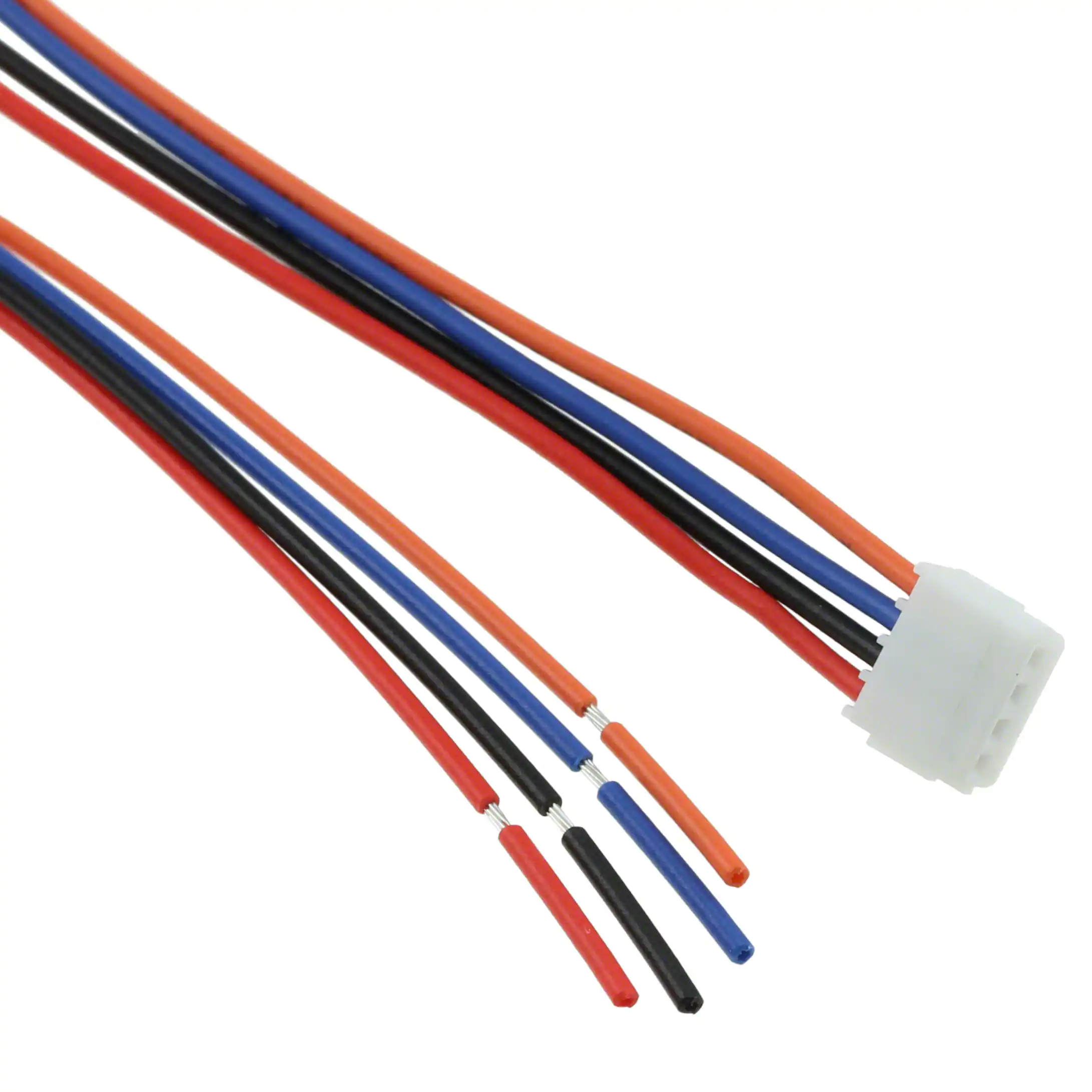

Inverted SMT Thru Board Connector Inverted SMT Thru Board Connector KEY FEATURES • Available in 2,3,4,5 and 6 positions • Accepts 2 thru 6 Position AMP Mini CT Connector • Eliminates wire dress management issues with discreet wire leads around the surface of the LED pc board • Custom length AMP Mini CT cable assemblies are available upon request • Low profile design • Rounded corners to minimize shadowing • Connector is positioned through cutout or notch in pc board • Surface mount hold downs provide stability during mating and unmating • High temperature material for reflow processing Description The Inverted SMT Thru Board Connector provides a means to bring power to LED aluminum clad and FR4 boards from the underside of the pc board. APPLICATIONS LED lighting controls Indoor and outdoor lighting fixtures General LED illumination fixtures Various non-lighting applications that require wire dress connections below the pc board Electrical Operating Voltage: 70VAC / 70VDC Operating Current: #24 AWG – 3A #26 AWG – 2.5A #28 AWG – 1.5A materials Housing : 94 V0 rated high temperature resistant thermoplastic Contacts : Tin over nickel plated copper alloy Standards and specs • Flat top surface allows for vacuum pick up 108-2376 : Inverted SMT Thru Board Product Specification • Tape and reel packaging for high speed SMT processing 108-60025 : Mini CT Connector Product Specification • RoHS compliant 114-13245 : Inverted SMT Thru Board Product Specification 114-5245 : Mini CT Connector Application Specification UL : UL 1977 File No. E28476 MECHANICAL Operating Temperature : -40°C to +105°C TE Connectivity I Inverted SMT Thru Board Connector Inverted SMT Thru Board Connector proDUct oFFerinG Connector P/N POSN “A” DIM “B” DIM “C” DIM “D” DIM Mini CT Cable Assy P/N 2106091-1 2 5.5 [.216] 9.11 [.359] 6.00 [.236] 4.10 [.161] 2058943-1 2106091-2 3 7.00 [.275] 10.61 [.418] 7.50 [.295] 4.85 [.191] 2058943-2 2106091-3 4 8.50 [.335] 12.11 [.477] 9.00 [.354] 5.60 [.220] 2058943-3 2106091-4 5 10.00 [.394] 13.61 [.536 ] 10.50 [.413] 6.35 [.250] 2058943-4 2106091-5 6 11.50 [.453] 15.11 [.595] 12.00 [.472] 7.10 [.280] 2058943-5 even position pcB Layout odd position pcB Layout For more information on mating AMP Mini CT products, please go to www.te.com keyword: AMP Mini CT Inverted SMT Thru Board Connector I TE Connectivity FOR MORE INFORMATION te.com/lighting TE Technical Support Center Internet: te.com/help USA: +1 (800) 522-6752 Canada: +1 (905) 475-6222 Mexico +52 (0) 55-1106-0800 Latin/S. America: +54 (0) 11-4733-2200 Germany: +49 (0) 6251-133-1999 UK: +44 (0) 800-267666 France: +33 (0) 1-3420-8686 Netherlands: +31 (0) 73-6246-999 China: +86 (0) 400-820-6015 Part numbers in this brochure are RoHS Compliant*, unless marked otherwise. *as defined www.te.com/leadfree te.com © 2011 Tyco Electronics Corporation, a TE Connectivity Ltd. Company. All Rights Reserved. 7-1773453-0 CIS 10/2011 TE Connectivity and TE connectivity (logo) are trademarks. Other logos, product and/or company names might be trademarks of their respective owners. While TE has made every reasonable effort to ensure the accuracy of the information in this brochure, TE does not guarantee that it is error-free, nor does TE make any other representation, warranty or guarantee that the information is accurate, correct, reliable or current. TE reserves the right to make any adjustments to the information contained herein at any time without notice. TE expressly disclaims all implied warranties regarding the information contained herein, including, but not limited to, any implied warranties of merchantability or fitness for a particular purpose. The dimensions in this catalog are for reference purposes only and are subject to change without notice. Specifications are subject to change without notice. Consult TE for the latest dimensions and design specifications.
