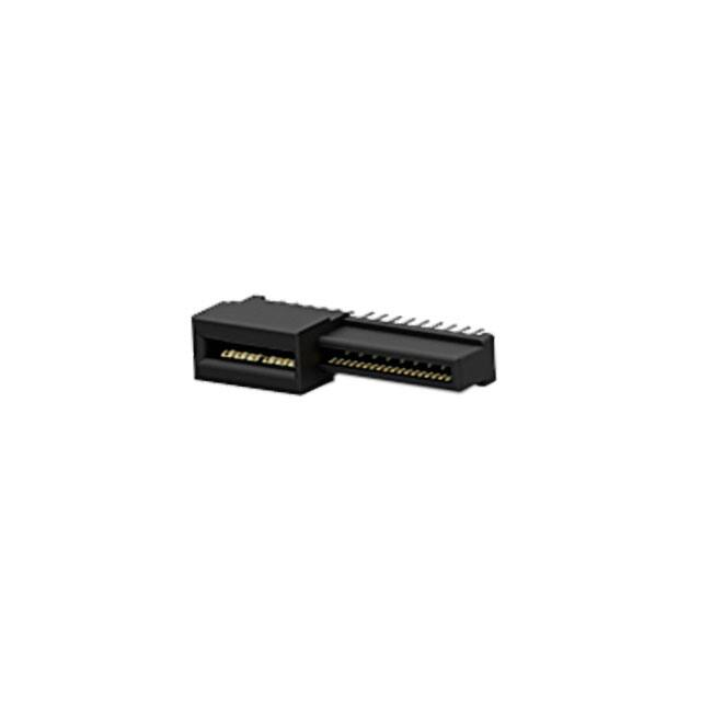

1.
HOUSING:
CONTACT:
D
A1
2.
DATE
DWN
APVD
INITIAL RELEASED
27FEB2013
AY
SZ
REV PER ECR-13-007783
13MAY2013
AY
SZ
GLASS FILLED POLYESTER, COLOR - BLACK,
UL94V-0 @ 1.50mm MIN. THICKNESS
HIGH CONDUCTIVITY COPPER ALLOY
D
FINISH:
CONTACTS - GOLD PLATE 0.76µm MIN THK IN MATING AREA
OVER NICKEL 1.27µm MIN THK.
SOLDER TAILS - MATTE TIN PLATE 1.27µm MIN THK.
3
DIMENSION SPECIFIED BY CUSTOMER
4
NO SHARP EDGES PERMITTED
5.
FOR INSERTION INTO PCB USE TE PRESS FIT TOOL PART NUMBER 2063547-1
6
PRODUCT SPECIFICATION 108-1548 APPLIES TO 36 CHAMP .050 SERIES SIGNAL
CONTACTS. PRODUCT SPECIFICATION 108-2202 APPLIES TO 4 SEC II POWER
CONTACTS.
7
APPLICATION SPECIFICATION 114-6061 APPLIES TO CHAMP .050 SERIES SIGNAL
CONTACTS. APPLICATION SPECIFICATION 114-13018 APPLIES TO 4 SEC II POWER
CONTACTS.

CONNECTOR ASSEMBLY, SEC II POWER,
4 POWER AND 36 SIGNAL,
PRESS FIT

45.76
4.48
1.23 0.05
-M-
D
D
7.62
P2
P1
& N
S1
S18
10.13
+0.13
-0.25
7.78
2.75
2.60
-NPOWER
P4
P3
S36
16.55 0.05
S19
5.78
+0.13
-0.25
2.75
2.60
24.10 0.05
-PSIGNAL
C
C
CARD SLOT ACCEPTS
2.36 # 0.24
PRINTED CIRCUIT BOARD
-N-
CARD SLOT ACCEPTS
2.36 # 0.20
-P-
9.12
15.49
5.54
6.05
10.07
4.12
1.52
-L-
B
-L3.18 0.51
0.40 TYP
2.81
5.63
SECTION
K-K
5X 2.54
BOTH SIDES
B
3.18 0.51
0.30 0.05 TYP
(3.04 )
0.32 0.01
TYP
1.36
TYP
1.27 TYP
4.57
1.36
0.84 0.03 TYP
TYP
4.57
1.89
SECTION
J-J
SECTION
(4.61 )
L-L
A
A

16.36 0.10
-T-
DESCRIPTION
DATE
SEE SHEET 1
DWN
APVD
23.66 0.10
1.36 0.05
2X 6.35 0.05
-M-
D
D
PAD P3
PAD P4
9.25
8.14 MIN
PAD S19
PAD S36
11.65
(0.38 )
4.88 MIN
4
1.33 0.18
C
(0.38 )
0.75 x45 $
0.95 0.18
30 $TYP
-S-
1.33 0.18
18X 0.81 0.03
1.89
C
0.95 0.18
(1.27 )
7.62
2.36 0.24
ACROSS PADS
4.48
17 SPACES AT 1.27 =
21.59
RECOMMENDED DAUGHTER CARD CONFIGURATION
SCALE
12X
-Z-
n1.07 0.03
AFTER PLATING
CONFIGURATION
P1
P2
3
B
2
3
1
2
S18
1
S2
S1
B
2X 4.57
5.62
S17
3
2.81
3
8:1
2
S20
P3
P4
3
1
2
1
.XXX
2X 1.36
S35
S36
S19
-X2.54 TYP
7.62
4.48
36X
n0.80 0.08
17X 1.27
3
.XXX
-Y-
A
1.89
RECOMMENDED PCB LAYOUT
SCALE
8:1
A
